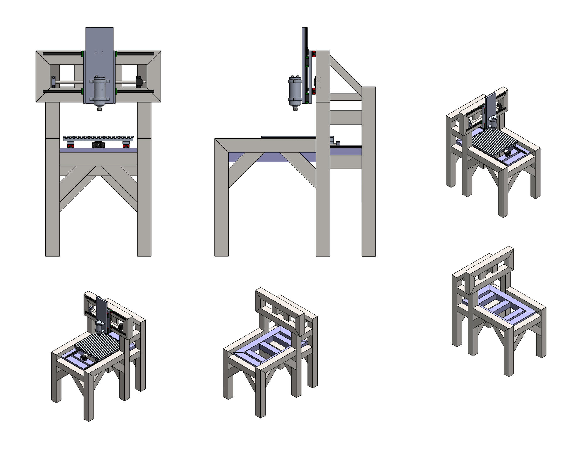

Sensible thinking on the others and credit to you for doing research before jumping in and having ago your self with design, wish others would do the same.!
Your design like you say is a little restrictive and complicated around the backside but it's not too far away.
Now for a long time I've been going to make something similair thou slightly larger but with a slightly differant design that in my opinion if done correctly will give best possible amount of strength at the tool where it's needed.
Now I've seen a few machines done in this way before but other day found this on youtube which will show you what I mean.
As you'll see the Gantry lifts not the Z axis. This gives some very serious advantages where it matters at the tool because your getting maximum support from the Gantry at the spindle with No Z extension so only extension from the Spindle is the tool length the chatter is greatly reduced. This allows either better finish or deeper/faster cutting or some of both.
The machine in the video could be done better regards the frame and it's got a crappy spindle on it so not showing it's true potential but it will show exactly what I mean.
If the frame was beefed up and Gantry counter balanced to allow faster Z movements plus take some of the strain of motors etc and obviously put a real spindle on it not a toy then IMO it would be a cracking little machine.
https://www.youtube.com/watch?v=4Bj6er322Dg
Re: Mill 480x500x180 RIGID
Very interesting design. Have not seen this approach yet.
What do you exactly mean by counterbalance?
First thing that pops into my mind is to add 2x rails for Z-axiz to other side of the gantry(cost and alignment issue). And maybe move spindle closer to center line of the gantry. But maybe move Z rails on the sides of the gantry at all...
I will put it on the canvas.

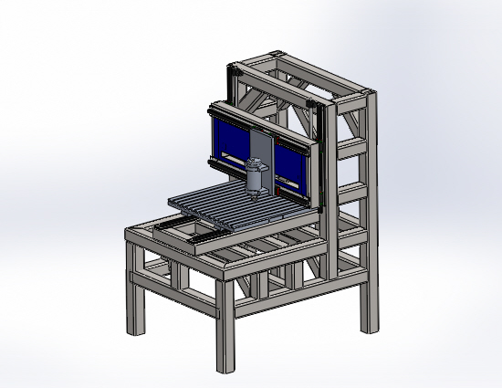

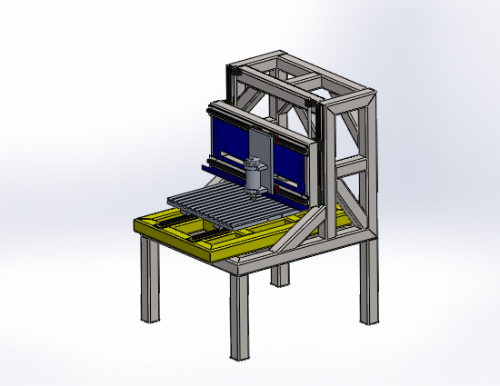

And almost a hole year later I am back. Despite not posting I have frequently visited forum and learned a lot more. Mean time some fantastic build logs have completed which have sent my mind wondering...
This is my fixed gantry next revision. Frame design is more clear and simpler now. Z is counterbalanced with gas struts. I decided not to limit my design with the random components I have. In near future I have possible projects for this machine - so then I can review the hole design and make needed changes in workarea or something else.
http://www.mycncuk.com/attachment.ph...id=14055&stc=1
Thats looking excellent and will be a very strong capable machine. Only thing I see that you dont show is any scope for adjustment between the moving table rails and the gantry upright rails.? (Or is that why the moving table frame is blue.?) They need to be perfectly perpendicular to each other.!
You wont easily achive this welding the frame so you need some form of adjustment building into the machine. !! PLENTY OF ADJUSTMENT IS THE KEY TO GOOD DIY BUILD.!! . . . I say this in CAPITALS because it's often missed and then regreted later.
The blue frame is separate from main frame and therefore adjustable. For now I`m not sure how the adjustment and rigid fixating of the bed frame will look like...
Welding the big frame together will take some time but. Wonder if there is any point creating subassemblys and bolt them together?...there is not any adjustment needed if I epoxy level gantry upright rails and bed frame is adjustable. It will be heavy fo sure.

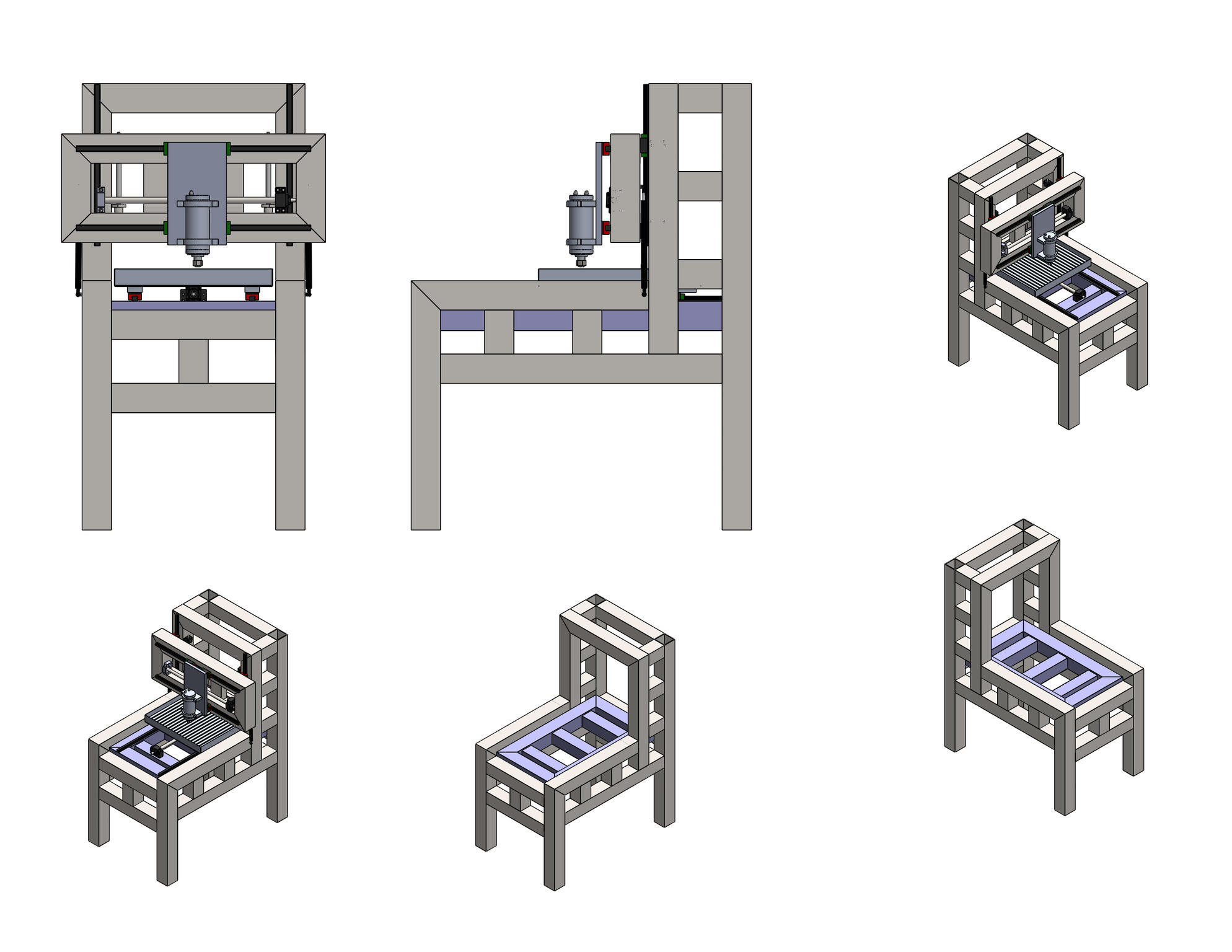

In search of a better/simpler/cheaper design I have come up with these versions. As pictures illustrate I did not succeed.
http://www.mycncuk.com/attachment.ph...id=14637&stc=1
http://www.mycncuk.com/attachment.ph...id=14638&stc=1
For the time being this fixed gantry design will come to a halt. As I have a need for larger work area and more general machine. Probably will go with something similar to Syliavski`s design.
This project is published in https://grabcad.com/library/fixed-ga...nc-460x500mm-1
Thanks for listnening!
It still looks a tadge wrong to me... :neglected:
I thought the big advantage of the fixed gantry was that you could localise the support for the bed where it was needed. You put your rails on the bottom of the bed and your linear blocks under the gantry. There is no point in supporting the bed anywhere but under the gantry, you are just introducing unnecessary overhangs :suspicion:
The machine should appear as a gantry with a bed sliding through it :thumsup:
Robin Hewitt
It is not perfect :)
I don't quite follow you though.
Do you mean fixing HIWIN rails to moving bed and bearing blocks to main frame?
Correct. You can remove a lot of unnecessary iron and make it stronger.
Remove the overhangs and put the support where it is needed.
