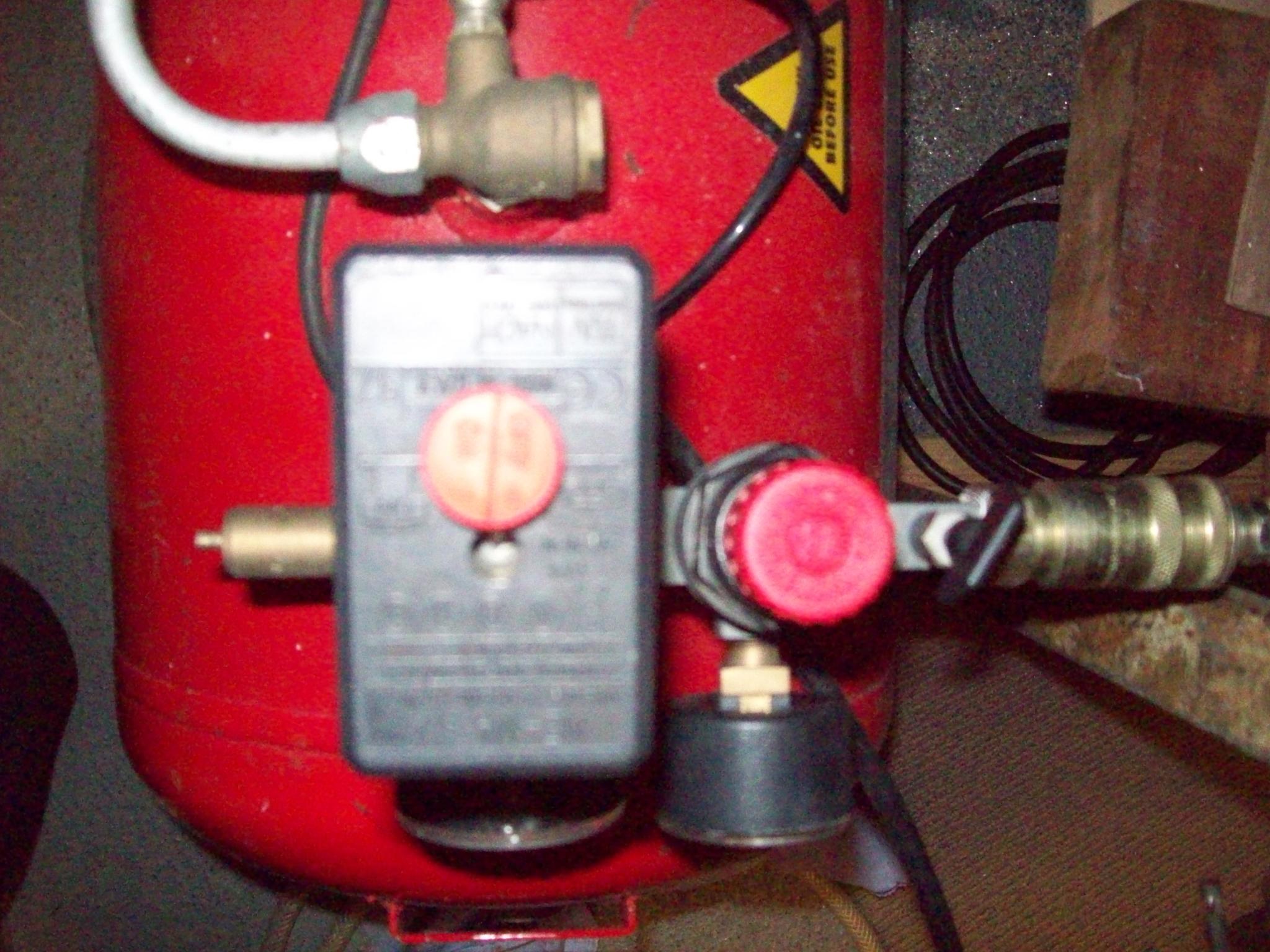

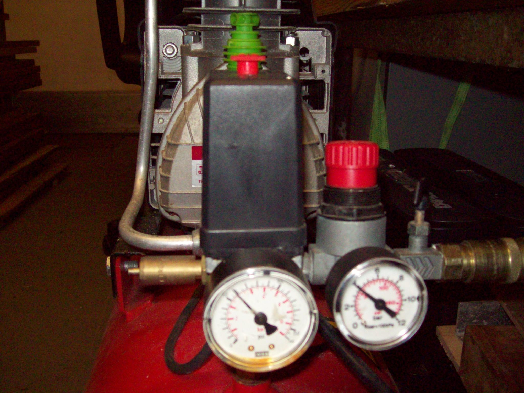

2 Attachment(s)
		Re: Tool changer needs 100 PSI  my compressor is not up to it, anyone know a good one
		Attachment 11922Attachment 11923Hi Ian, I hope these pics tell you something. It would begreat if the compressor could be set to kick in when it drops to 100 PSI andstill manage with the demand.
Many thanks
Suesi
		If you take off the cover ( with the red start stop button on top) you should see 2 screws to adjust.... ones max pressure (Stop ) the other to set the start pressure ....try to download a  manual from a clarke machine very similar switches on their machines

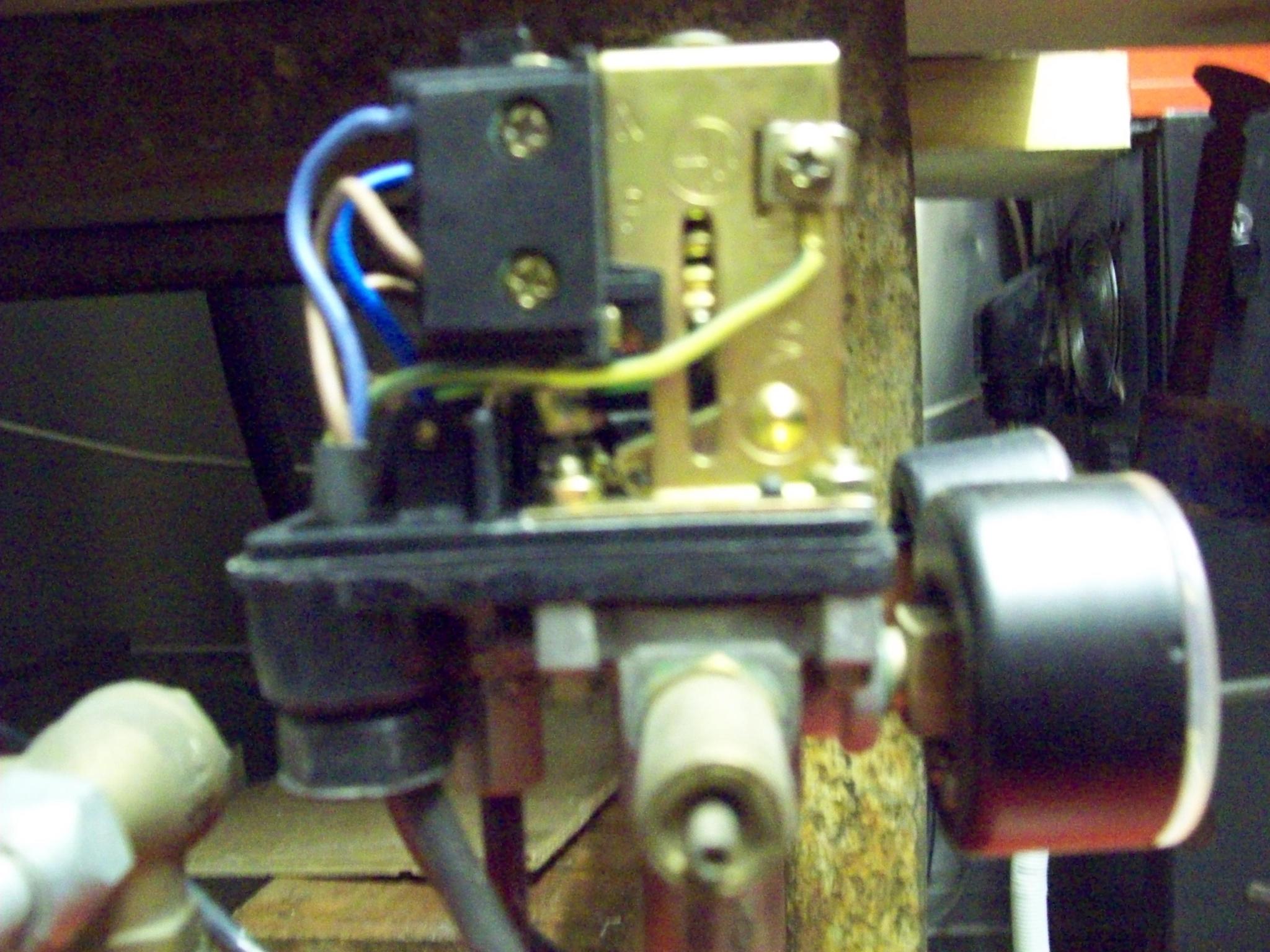

3 Attachment(s)
		Attachment 11928Attachment 11929Attachment 11927
Hi m_c, thank you for the reply. I am reluctant to try ata lower pressure as when I did use at lower pressure about 80 PSI there wereproblems and I am told from the chap who converted my mill that lower pressurecan cause problems. Here are some photos from under the plastic case. When I amlooking at new compressors none that I have seen mention what you can set theminimum pressure at!
		Suesi
look at this switch
Condor MDR1 Compressor Pressure Switch - Next Day from Airlines-Pneumatics
I've had a look at all my compressors and they all have adjustable differentials fitted
but they all british made quality compressors
I really cant see from your photos what they have can you take some in focus?
The top bolt head adjusts the pressure have you increased that?
it may go up to 140 psi safely then your kick in pressure may be raised to keep you over your desired 100 psi
your tank is rated for 150 psi certainly though check on the ratings plate

		Ian, personally I wouldn't recommend raising the maximum pressure beyond the preset pressure on these compressors, as they'll struggle to reach a higher pressure. They often struggle to reach the set maximum pressure, let alone anything higher!
By the looks of it, that MDR kit you link to, combined with the differential kit should do the job nicely for Suesi.
Set it for 7bar cut-in, and you should be able to set the cut-out for not much more, that way the compressor isn't having to reach too high a pressure before cutting out. You probably don't want the cut-in pressure too near the cut-out pressure though, otherwise the compressor will be continually starting/stopping.
		Hi Ian, yes my mate tried to increase the pressure but it has not got it to kick in right. I am reluctant to try doing that further due to fear of making hard work for the compressor as m_c mentions. I think perhaps it would be a good idea to go the part you gave a link for. Sorry the pictures were not great I see what you mean when I looked at them again! Many thanks for your help and the link and I think I may go down that road. Suesi
