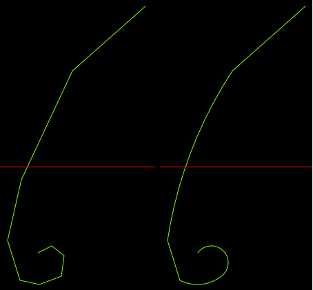

Re: Machine Slow on Curves
Hi Jazz, its a exc 200. I havent ridden it in over a year :( and im quite the amature at that.
Anyway these curves, well i realised they arnt curves anymore but a collection of very small straight lines that add up to make a curve!!!
Thats right, so for instance in one line of code for the curve there is only a X and a Z coordinate!
Is there anyway i can make cambam output radiuses to make the curves up instead of lots of straight lines.
Also jazz it is using G64, but this is used for the small corners in the roughing process, not in the curve process.
Post the G-code so can have a look.
Like as been said earlier seems Linux CNC as a quirk and if the P or Q parameter isn't stated then G64 will be ignored so if Cambam is just putting out G64 then chances are your not actually in G64.?
Try this copy the G-code file then Delete any reference to G64 or G61 from the G-code file. Next in MDI type G64 P0 Q0 then run the code again.
G64 will stay inaffect because it's Modal and will now be used for the complete program and the rest of the session unless changed by G61 or G61.1
You can make CamBam curve fit a polyline using the "edit/polyline/arc fit" menu option.
E.g.
Attachment 12011
You are prompted for the tolerance so you can choose the tradeoff between accuracy and minimising the number of curves.
CamBam has a very good forum for asking these sort of questions. It is also deceptively simple and it's worth (never thought I'd say this) reading the manual to find out all the things it can do.

Its not that i don't have an arc in cambam that is the problem. I do. The problem is when cambam creates the gcode it turns the arc into a series of lots of small straight lines. Im then having a problem with linuxCNC not giving a smooth output to the machine.
What i find weird in cambam is, you go to the postprocessor for linuxcnc, you then go down to 'Arc Output' and there are three options to choose from
normal
convert to lines
Helix convert to lines
So i assume normal would mean it makes a curve using lots of small radius. This isnt the case though :bull_head:
