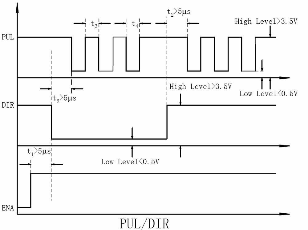

Re: My turn for help with Pulse multiplier for test rig.
The AM882 manual has this diagram, and it says
"In order to avoid some fault operations and deviations, PUL, DIR and ENA should abide by some
rules, shown as following diagram: "
Attachment 12157
So will a simple controller also have to obey these 'rules' ?
