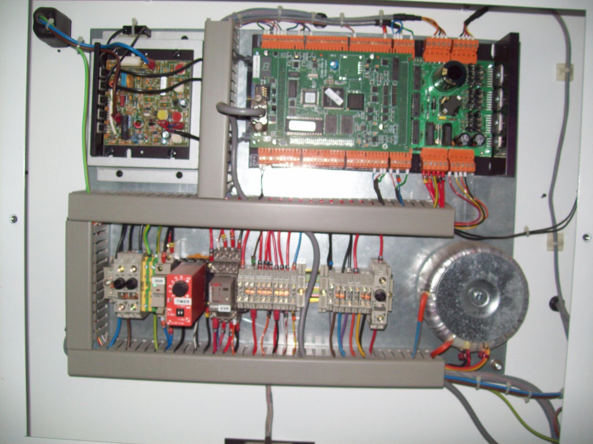

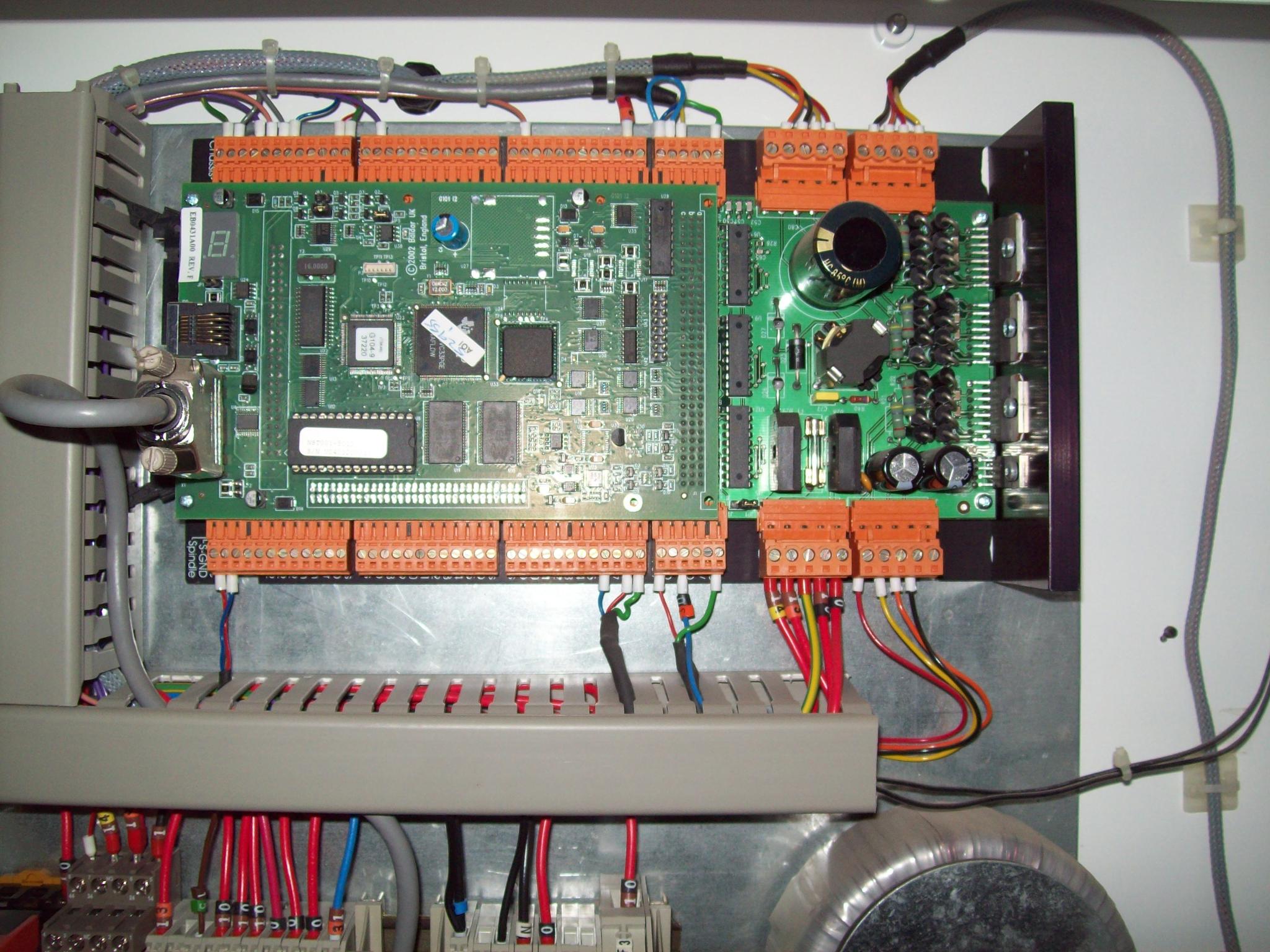

What may be the best way to convert my Denford compact router to mach 3?
Attachment 12230
Attachment 12231
Hi Guys
What may be the best way to convert my Denford Compact Router to mach 3?
It was made in 2004 and I would like to get it going on mach 3.
Here is a link to the manual for it section 8 is the electrical section. http://www.denfordata.com/bb/viewtopic.php?f=38&t=3675&sid=81ee33e232ce67280f94 9af69089a5a8
I have also attached two photos.
Many thanks for any help
Suesi

Denford use 24V logic in all thier stuff, so ideally you'd use a BOB/controller that is 24V tolerant.
Basic option is to just replace the main control board (the board with the serial connector plugs, which sits on top/plugs into the board with the terminals), trace the terminals and solder into the headers on the terminal board.
More advanced option is replace that entire board, with a controller and 3 new stepper drivers.
For 24V controller, the three I can think of just now are CS-Lab, KFlop+Kanalog, and PLCM (Zapp sell them). CS-Lab and PLCM would require some form of step to analogue converter for the spindle control board. There may also be an issue with the homing sensors that Denford used (they used to use NAMUR output, but I think they swapped to something a bit more sensible at some point)

Re: What may be the best way to convert my Denford compact router to mach 3?
If the spindle is a simple on/off, then you won't need an analogue output.
However the top left board looks very like a KB drive of some form, and there are wires connected to the terminals that would normally have a speed potentiometer connected (they can be controlled either with a potentiometer, or via an isolated 0-10V feed). IIRC the ID/Model label would normally be on the face of the heatsink pointing towards the side of the case/opposite side of the bit where the SCRs are bolted on.
And having just checked the wiring diagrams ( Denford Software & Machines • View topic - MicroRouter Compact 2002 - 2004 Circuit Diagram ), it does use a 0-10V analogue signal. The Baldor controllers that Denford use, are pretty good things and have quite a bit of Inputs and Outputs, including analogue. It's just a shame they cost so much. I think the cost of an upgrade from the model in your router, to the lastest USB version is over £1200. I happen to have the latest USB version in my Novamill, and I've got no plans to swap it as it just works with no issues, and I've just added a coolant relay with minimal hassle.
Another issue I notice in the wiring diagrams, is the micro routers don't have a 24V DC supply. They simply use 24V AC relays, and feed 24V AC into the Baldor, which has it's own onboard rectifier/regulators. Both my Novamill and Cyclone have linear supplies, so they must of gone for the cheaper option when doing the micro routers.
That creates the issue of getting a stable 24V DC supply for any new controller. Cheap option would be a 24V DC din rail switched mode supply, but the ideal option to minimise noise would be a 24V DC linear supply.
Rectifing the existing the 24V AC isn't that viable an option, as you would still need to regulate it down to a consistent 24V DC. AC stuff is usually far more tolerant of voltage variations than DC, which usually has pretty strict voltage tolerance.

The CS-Lab option is probably the best option. The other options would be KFlop+Kanalog, which is a far more powerful option with a much higher price tag and complexity, or the PLCM controller with it's own BOB, but I'm not sure on how much support they are actually providing.
I've just had a quick scan through the wiring diagrams, and going by the Next-Step connection diagram (sheet 3 in the previous link), the machine should have the followingn connections-
Digital Inputs
X Datum
Y Datum
Z Datum (you need to double check what kind of datum switches are being used, as they may not be basic switches)
E-Stop circuit
Guard Contact
Analogue Inputs
Feedrate pot (might not be fitted, but denford still show full options in thier diagrams)
Digital Outputs
SGR relay (Spindle Guard Relay - when machine is active, I think this should be non-powered to lock the door and allow the spindle to start)
Stepper outputs (the Next-step has onboard drivers, so you'll need to allow for 3 x step/dir pairs and an enable signal)
Analogue Outputs
Spindle Speed
A few key points I've noticed-
You'll need a 24VDC supply. CS stuff should happily run using a 24VDC din rail switched mode supply (I personally use RS ones, but others are available!)
The existing steppers are designed to run from rectified 24V AC via the next-step on board rectifier, so you'll need an external bridge rectifier and suitable capacitor to supply whatever drives you buy.
The Z-axis stepper has a brake, which is supplied from a half-bridge rectifier setup when the estop circuit is active, so make sure you don't disconnect any part of that circuit.
The timer seems to be used to hold the guard locked for a period after the SGR relay has been de-activated.
The SGR is a 12V relay, being powered from the 12V output of the Next-Step board. You'll need to check to see if the SGR relay will work on 24V (doubtful!) and if not, either swap it for a 24V version, or add a 12VDC power supply.

If your wanting to use the existing drives then you'd need to check out what they require. Thou I suspect you'll get much better performance and easier conversion if you upgrade the drives.
The existing drivers are built into what is essentially the Next-Step BOB. The Next-Step control board itself sits above and is connected by two large pin headers to a connection board with three stepper drivers and required power supplies built in. You can use the existing drivers by simply patching into the pin headers, but they're pretty basic drivers, although they're good enough for the machines they're fitted to. You will get better performance by fitting new drives though.

Hi Ian,
the big questions will be, how much are you willing to spend, what performance are you looking for, and how good are you with electrics/electronics?
The conversion can vary from a minimum budget cheap BOB and some wiring/possible soldering using the original stepper motor drives, through to a complete new motion controller, stepper drives, and stepper motors.
Off course, you can change things gradually, as the cheapest option may work perfectly well for you, and then upgrade later if you feel you need some extra performance.
