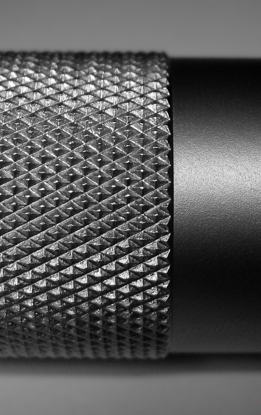

Hey everyone, I am posting this topic on MYCNCUK because I have found this forum to be very helpful in the past. This topic might not relate to CNC's as such but I am sure you guys will have some answers for me. Recently I purchased an aluminium round bar with an inch wide diameter and 400mm in length. I reduced the diameter on one end down to 16mm using my friend's lathe. This was done so that I could fit the rod in my pillar drill chuck. I am currently using a 60 grit aluminium oxide sanding paper glued on the surface of the rod for my ultimate sanding drum.
The purpose of this sanding drum is to sand the inside of the bamboo poles I use for making bike frames. Now the sand paper that I glued to the aluminium surface has started to smooth out already after my first use. So I am tying this topic over here to get some advice really as I am not sure what I can do to the aluminium surface to make more like a filing surface. If aluminium is not a good surface for that then I can always buy a steel bar to do the job, but I absolutely have no idea what tool or method could make a shiny metal surface into something that is rough like a file. Any help would be appreciated greatly at this point as I am running out of options now :uncomfortableness:. Thanks

you could knurl the ali bar, thou it might be more lasting if you did it to a steel bar and used that like a file.
Re: Trying to make an ultimate sanding drum!
You could maybe use a grade of steel that's easy to harden, machine it to just under the diameter you need on a lathe, knurl it, then harden it.
Attachment 12320
That's pretty close to a file. You could mill/grind some flutes so the swarf has somewhere to go.
Thanks Jonathan and Tornado, I think I have my answer. Will get a steel bar and knurl it. Do the knurling tools come with various pitches so that I can knurl it in such a way that the protrusions are long a sharpish? Thanks

i think my kit i have has 2 course, 2 medium and 2 fine kurl wheels.
the best one to get it the clamp type, that clamps on top and bottom of the workpiece.
the single wheels ones have to push against the workpiece and can stress the lathe bearings
Can you recommend a course wheels one please? Also can the top and bottom wheels reduce the wobble in my round bar too? Not sure why a think piece of ali is wobbling when it turns?
cant remember where i got my kit from. it was either rdg tools or chronos.
it will depend on what thickness bar your planning on knurling, just make sure it can do the thickness of bar your planning on using.
it wont reduce the wobble as the clamp type can move up and down as it knurls.
really the only way to get rid of that would be to put it between the chuck and a centre in the tailstock and turn it down.
unless you can bend it back the otherway to straighten it.

Hey Guys, I am back again. After trying my luck with knurling on to my ali bar I realised that knurls don't work well for something that is 400mm long and spinning. So now am looking for other solutions. One is that I buy a half round file (which is 400mm long) or try something even more insane. The insane idea is to mill (or ask someone here to help me) and produce a long version of this BLACK AND DECKER 90546472 POWERFILE 13MM ARM + PAD FOR KA900 KA900E | eBay. Now I know a sanding belt spinning at that sort of length is definitely going to cause many issues but i am running out of ideas. Can someone please help me figure this out? Any thing at this point would be of great help. Cheers
u need to face the end off, then centre drill it. then put it between the chuck and a live centre in the tailstock.
thats how i kurl long stuff.

That's exactly how I did it. Knurling is not the problem here it actually the knurls that are formed are not sharp enough to shave the bamboo off at low speed thats all
maybe because its ali bar. alot softer then steel.
T0rnado69
That's true but I am still not sure if the knurls would actually do the job? There is something else I have in mind though may buying a brake cylinder hone with an extension rod and trying that to see if that works. Any clue how good will a 180 grit stone perform on wood?
