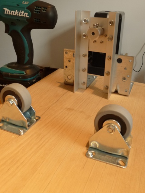

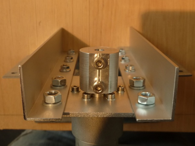

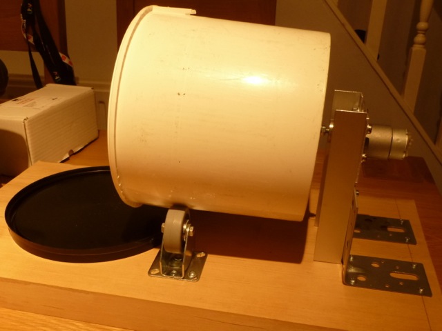

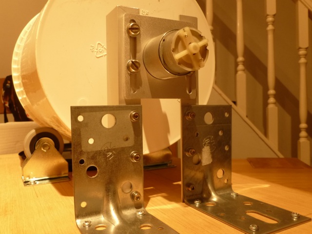

Hello all,
I'm currently building a small parts tumbler in which I intend to tumble aluminium parts amongst 3mm porcelain beads.
Some pics below:
Attachment 12364 Attachment 12363 Attachment 12362 Attachment 12361

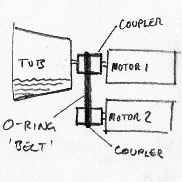

Although the 12v 350mA 20RPM motor spins the tub reasonably well (provided that the static friction remains low) I'm thinking of adding an identical motor below it and connecting it via a nitrile o-ring belt so that it's 'helping out' the motor that's directly driving the tub, like so:
Attachment 12365

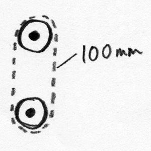

Now, let's say that an O-ring with an inside diameter of 100mm fits perfectly (un-stretched) around the two couplers:
Attachment 12366
I'm guessing that this wouldn't be ideal as there'd be very little traction or transfer of torque - so my question is: how much stretch percentage should I introduce to the o-ring for it to do its job as a conduit between the two motors? 10%? 20%?
Cheers!
Wal.

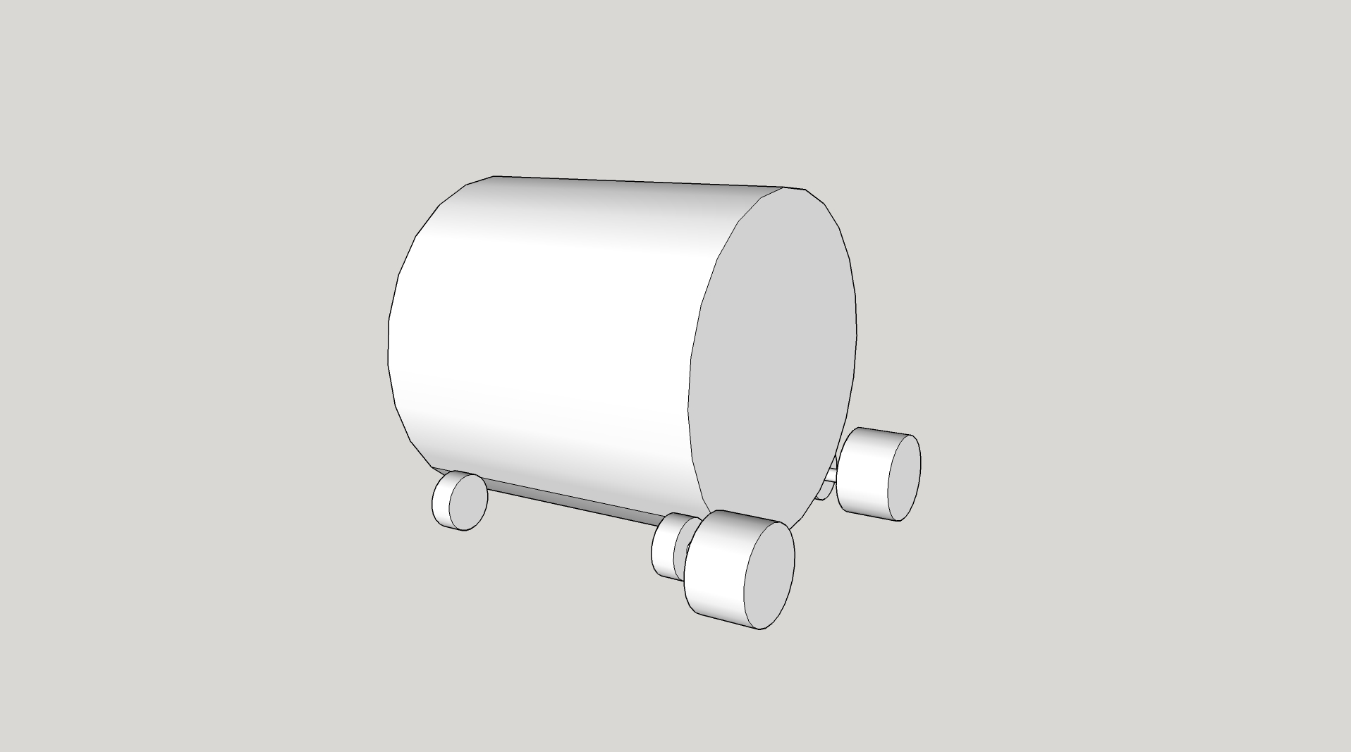

Would this be a better arrangement ? two motors at the back.
Attachment 12372

With any of these systems, do you not think the motors need synchronising?

Eddy - yep, I had a look at a driving roller and a second idling roller design, trouble is that the motors I have run at 20rpm - so the tub would rotate at about 2rpm in that config...
I didn't want to get into bigger motor territory - 12v small and quiet(ish) was the aim!
Nah... They'll take their power off the same source - there may be a smidgen of discrepancy when they start spinning, but as long as they're spinning at the same rate they should sort themselves out...
Wal.

Wal
Motor power rating is 12V*0.35A=4.2W at 20RPM so available torque=4.2/(20/30*pi)=2Nm. Roughly.
The torque is transferred due to friction between the belt and 'couplers'. So the way to work it out is to calculate the friction force and multiply by the coupling radius to get the torque transmission capability. The force depends on the spring constant of the o-ring, which you could measure by handing weights from it and measuring the deflection, or use the young's modulus to calculate it ... but that gets involved as it's an elastomer so doesn't care too much about Hooke's law (the modulus is only constant for small deflections).
So use the co-efficient of friction between rubber and aluminium (about 0.5 - citation needed!) to find the required force - I'm guessing the couplings are 25mm diameter, so F=2Nm/25mm=80N which means tension is 80/0.5=160N. That's about the weight of four domestic cats ... according to Wikipedia the tensile strength of nitrite rubber is (at least) 10Nmm^-2, so 0.25cats/mm^2 which means you need at least 4/0.25=16mm^2. That's a (16/pi)^0.5=2.3mm radius, so 4.6mm diameter ring. Roughly. Add a bit more to be safe etc...
Feel free to experiment, but I think you'd be better off with something more substantial.

Hehe, I see your point, Dean, but thanks and maximum respect to Jonathan for a) knowing this stuff and b) taking the time and effort to explain the technicalities - even if they are somewhat wasted on a pea-brain such as mine..!
After all that, it turns out (no pun intended) that the motor does have sufficient torque to spin the tub - just. I need to leave a part in there for a day and see what happens. I have a feeling that 15rpm on a smaller drum such as mine isn't going to be enough...
Wal.
