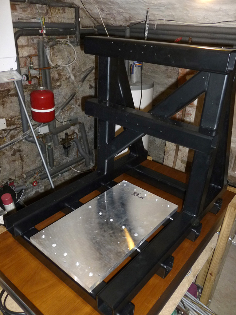

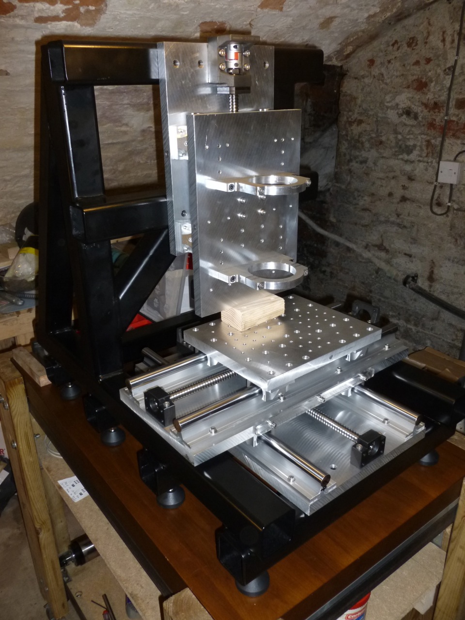

I used M6 threads into 60x60x5 square section to hold my plates.
Attachment 12407 Attachment 12406
A fair few of 'em, but I found no need to use backing - as Clive says, it would have been hugely impractical to do so...
