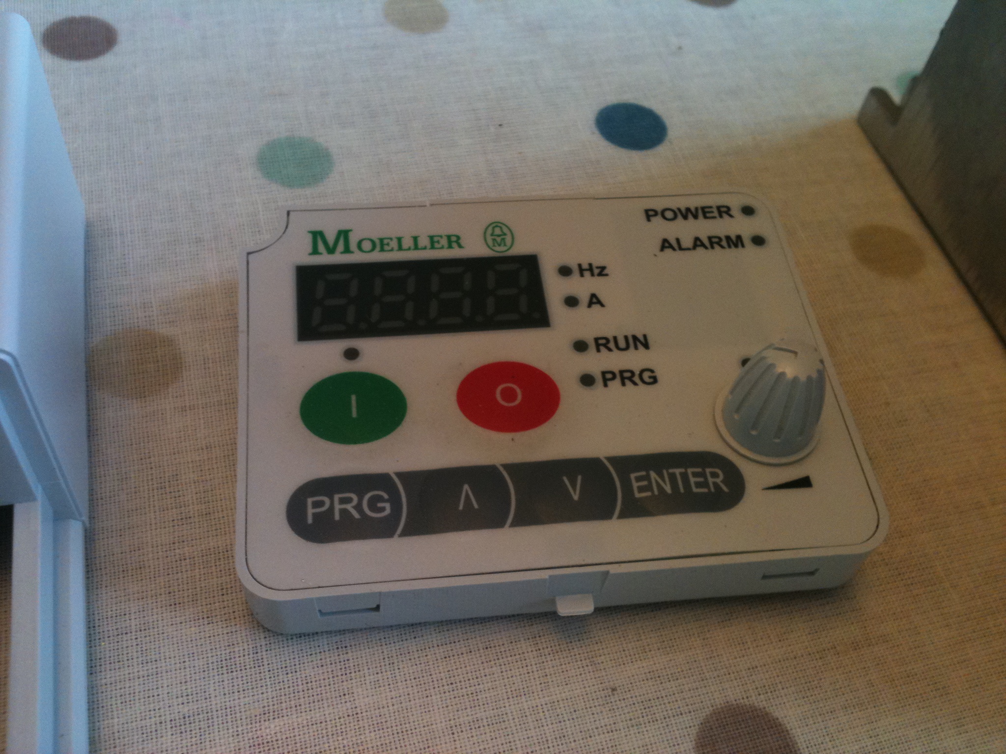

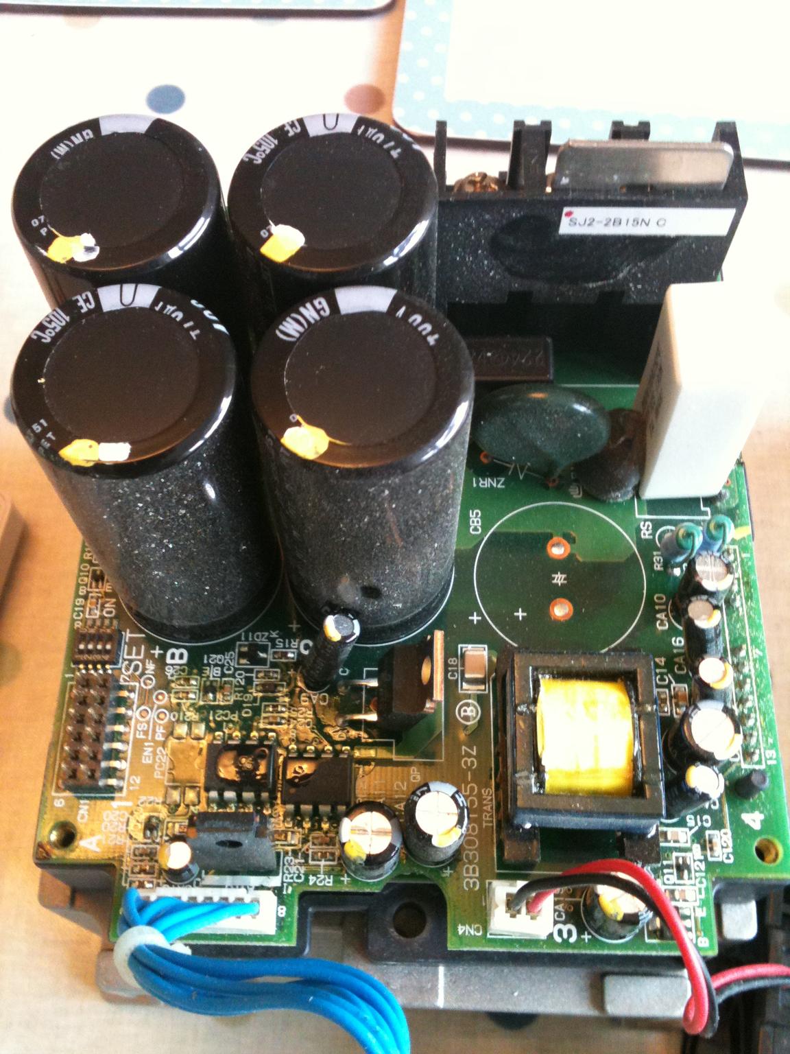

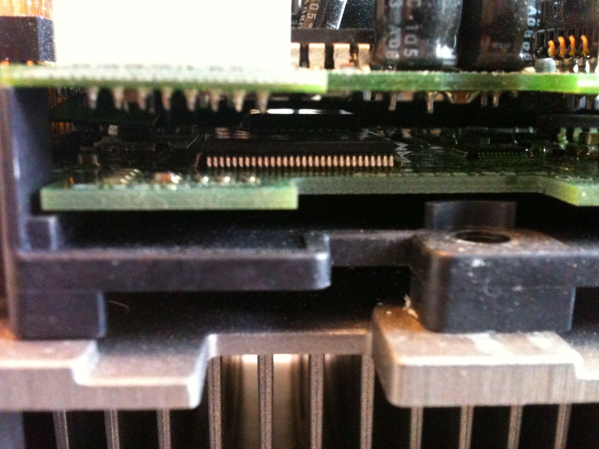

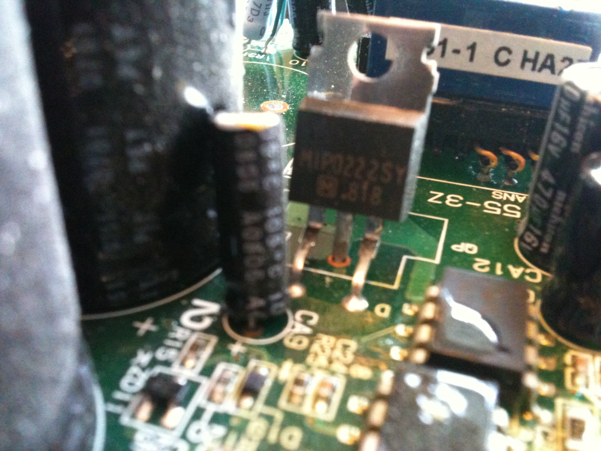

Now I can't start the VFD. It keeps telling me there is a fault (E14 - UVW to earth fault). It does this without the spindle connected, plus without the VFD cable connected. There is a reset procedure which involves briefly connecting a terminal mark P24 (24v?) to pin 5, which make symbols on the display goes round in little circles. But the error remains.
I've tried switching on and off many times, held the reset for a long time, nothing. Wondering about if there is a factory reset option. Also wondering if I've damage the VFD. It is a Moeller DV51.
Any ideas?
