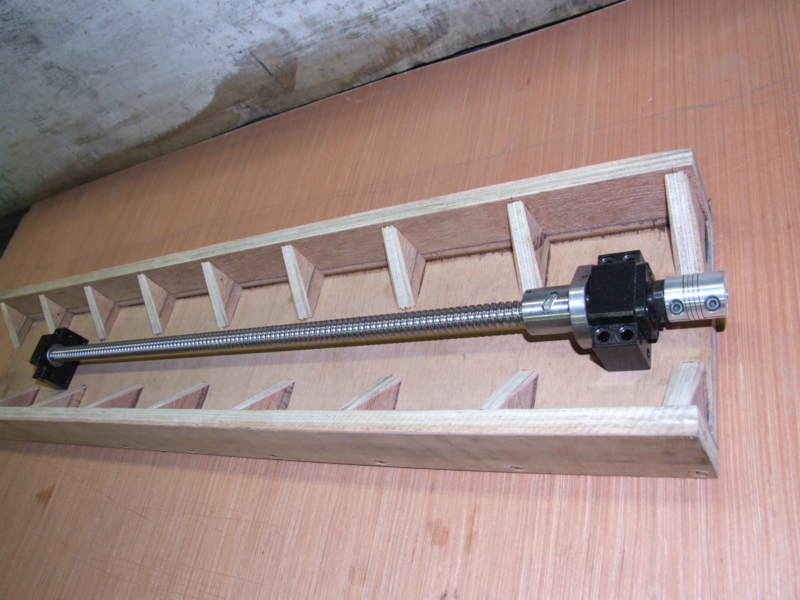

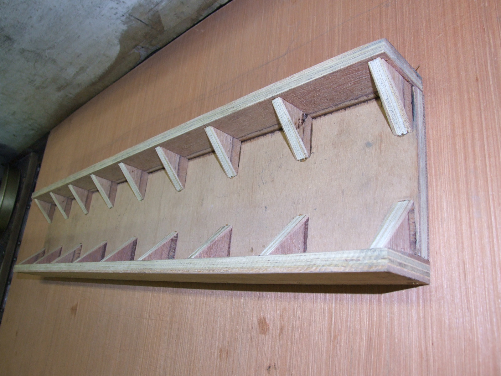

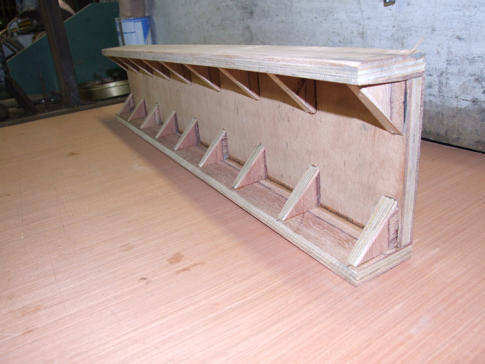

Here's the start for the gantry pattern. It's 19mm thick and longer than I need as I'm thinking about doing a kit and the gantry can be cut to size. All needs to be sanded smooth and all the inside corners need to have wax fillets put in.

I don't see why you would want to cast a gantry. The open back structure significantly limits stiffness.
If you compare it to a simple 80x160x4mm steel RHS section you would need to make the cast aluminum 'C' shape gantry have web and flanges of 60mm thick to match the bending and torsional stiffness.
Makes much more sense to cast the end connection down to the bearings blocks and ballscrew, with a neat interface to say a 160x80 RHS steel gantry.
But we're not limited to just one beam, so you could get the torsional stiffness by casting two beams in one piece. I'd go for something similar to the gantry design on my last machine:
Attachment 12545
The Y-axis rails may have to be moved and it would take a fairly big milling machine to mill the rail mounting surfaces.

Still haven't finished the gantry pattern as I'm flat out with work but I'm doing bits in between jobs.
I do know about shrinkage in casting, rule of thumb is 1/4" per foot,my alloy is 1-1.3%. It's accounted for in the pattern.
For anyone asking why? Here's why, I just want to cast it to see if it can be done and work.
The price of doing it in aluminium plate is crazy compared to casting it and once a pattern is made for casting you can repeat over and over. It'll all be one piece so no marking out, cutting and bolting plate together.
I can cut this to length, machine the ends then top and bottom for the rails and wherever parts are to be mounted. I might even bolt 2 castings back to back and make an "I" beam from them.
Don't bother with the I-beam idea - rubbish torsional stiffness.
Re: Cast aluminium gantry router
Jonathan
True, but to pick up on your initial idea of twin beam arrangements you could arrange them like this:
[] instead of ][
[] has similar vertical stiffness to ][, slightly better fore/aft stiffness, and massively better torsional stiffness. If you cast it then you can include baffle plates at intervals so long as you also bolt through these as well.
A simpler alternative is to do |] where ] is the cast part (with optional internal baffles or ribs) and | is a simple closer plate.
Still lots of effort all round but they are possible configurations and much better than just ].
