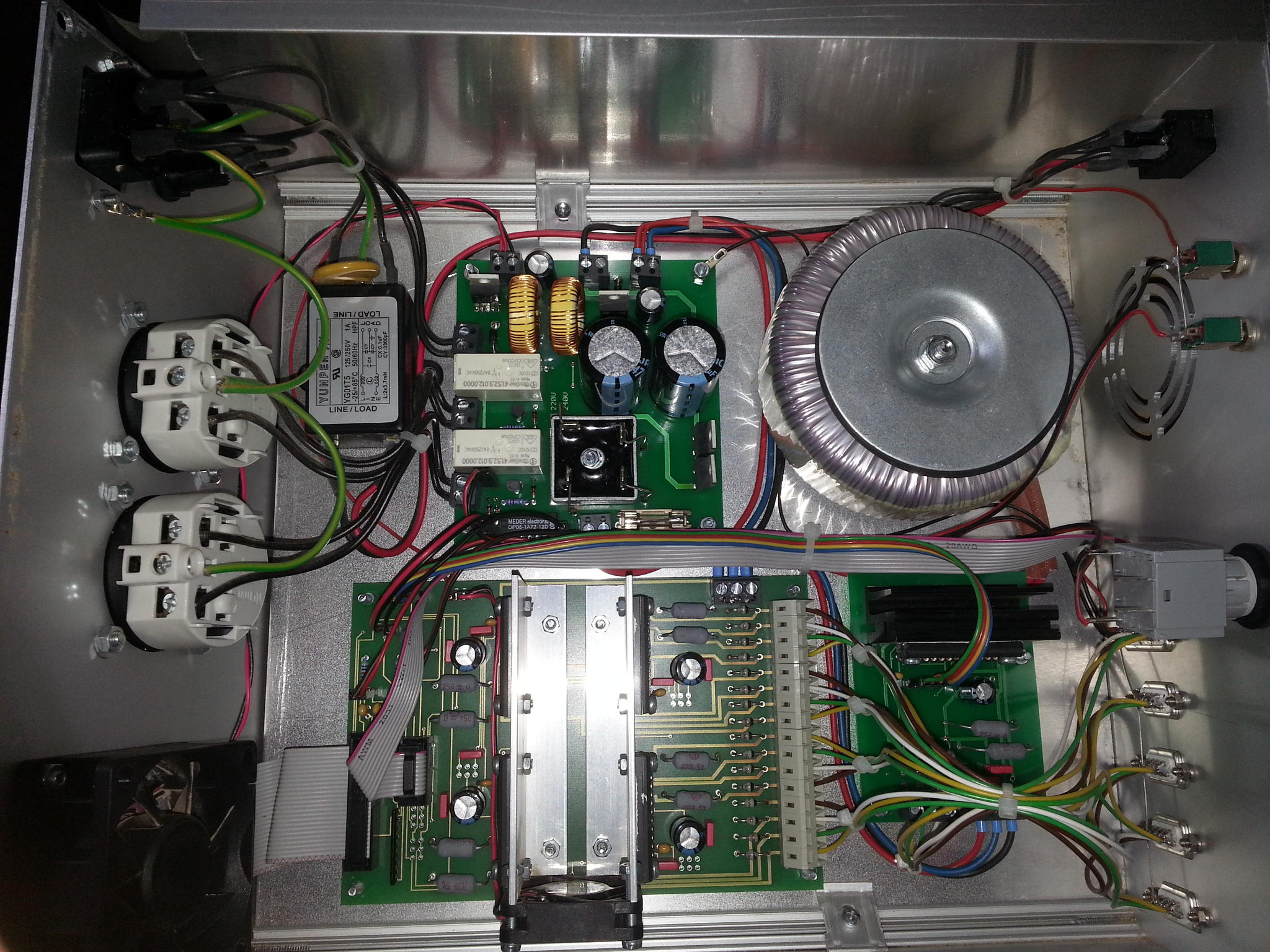

I am a bit clueless regards checking the input guys.
This is the inside of my control box.
The signal i assume comes in on the ribbon cable via the ST port on the right of the picture and terminates next to the parallel port.
Can anyone talk me through testing it so as i don't fry myself and the control box

		This will 99.9% be because you have the wrong Input number in Mach3. You can't trust Mach3 auto detect.
Try changing the Probe input to any of these. 10, 11, 12, 13 or 15. Getting it wrong shouldn't hurt anything, if the input is shared by another switch ie: limit or E-stop all that will happen is when you short the probe the limit will trip.
If you go to Diagnostics tab in mach3 on the right you'll see a bank of Led lights. When you touch the probe the Digitize Led should light up. If it's on already without touching then go back into inputs and change the active Low state.
If any of these input numbers don't work then you either have some wiring issue or the board input is not working. If you have limit switches then you could swap the probe with this input to check your wiring, you'll need to set the probe input to same input number as limit.

		Hi JAZZ, I set the probe to the z home/limit switch pin and sure enough when hitting the limit the digitize led changes, however when pressing the probe plate it does nothing.
The probe plugs into this machine via what looks like 2 core speaker cable and it plugs into a small contol box mounted on the side of the gantry.
I traced this back into the control box via a cable labeled as ST
I just did a continuity test to make sure both sides of the wire were making it through the control box and to the computer, this is about as far as my electrical skill goes lol.
Just so you know i was only using the auto detect in mach 3 as a means of testing, the digitize is setup on pin 15 and was when i bought the machine, the auto height worked when it was demonstrated to me and it has worked intermittently since and recently nothing.

		Bed time now but this is a very simple concept. When you touch the probe it just completes the circuit from Gnd to Input +
This is why if your input is working and setup correctly in Mach3 then it must be a wiring or probe problem. To test this and bypass the wire/probe then just put a short wire across the pins going to the probe wires.

		It is the wrong manual but the way I am reading it is.  The probe is connected to pin 1 on the 9 pin control plug which goes to pin 15 on the D25 plug to the PP.  Have you checked the continuity on the cable pin 15 to pin 15 each end of the cable going from the machine control box to the PP on the computer.  Or from pin 1 on the control plug through to pin 15 at the pc end of the cable PP.  Some more pictures might help.    ..Clive
		Re: Help Please With Auto Tool Height Mach 3 Problem
		Thanks Clive, yeah that's how i read it as well. I have done some more testing just now by jumping the probe pin and the ground pin, first checked just pc parallel port with mach 3 on diagnostic screen (digitize goes out), then end of parallel cable that plugs into output of contol box (digitise goes out), then to 9 pin input of control box ( digitise goes out) all good so far. then traced the st cable back to the what looks similar to an audio jack on the side of the gantry where the probe plugs in, i plugged in probe to the port digitise led goes out(which i assume is correct as it is now making a circuit waiting for the circuit to be broken by the touch off. however pressing probe does nothing as usual, then tried completely different edge finding probe and again this does nothing, (digitise doesn't change on diagnostic screen.
I then gained access to the box containing the port that the probes plug into and jumped both pins with the wire attached to the top of this port (digitise changes as it should) so my thinking is now that there is something wrong with this jack internally?

		Ok just did a test with an old set of in ear earphones, i  plugged them into the jack, and the digitise light went off, in my mind this should not happen as the circuit is not complete, so i am assuming that the circuit is being completed inside the jack and therefore a probe touch cannot break this circuit as it is not just being completed in the probe but in the jack as well
		thanks guys, got it fixed now, it was a loose terminal on the jack
