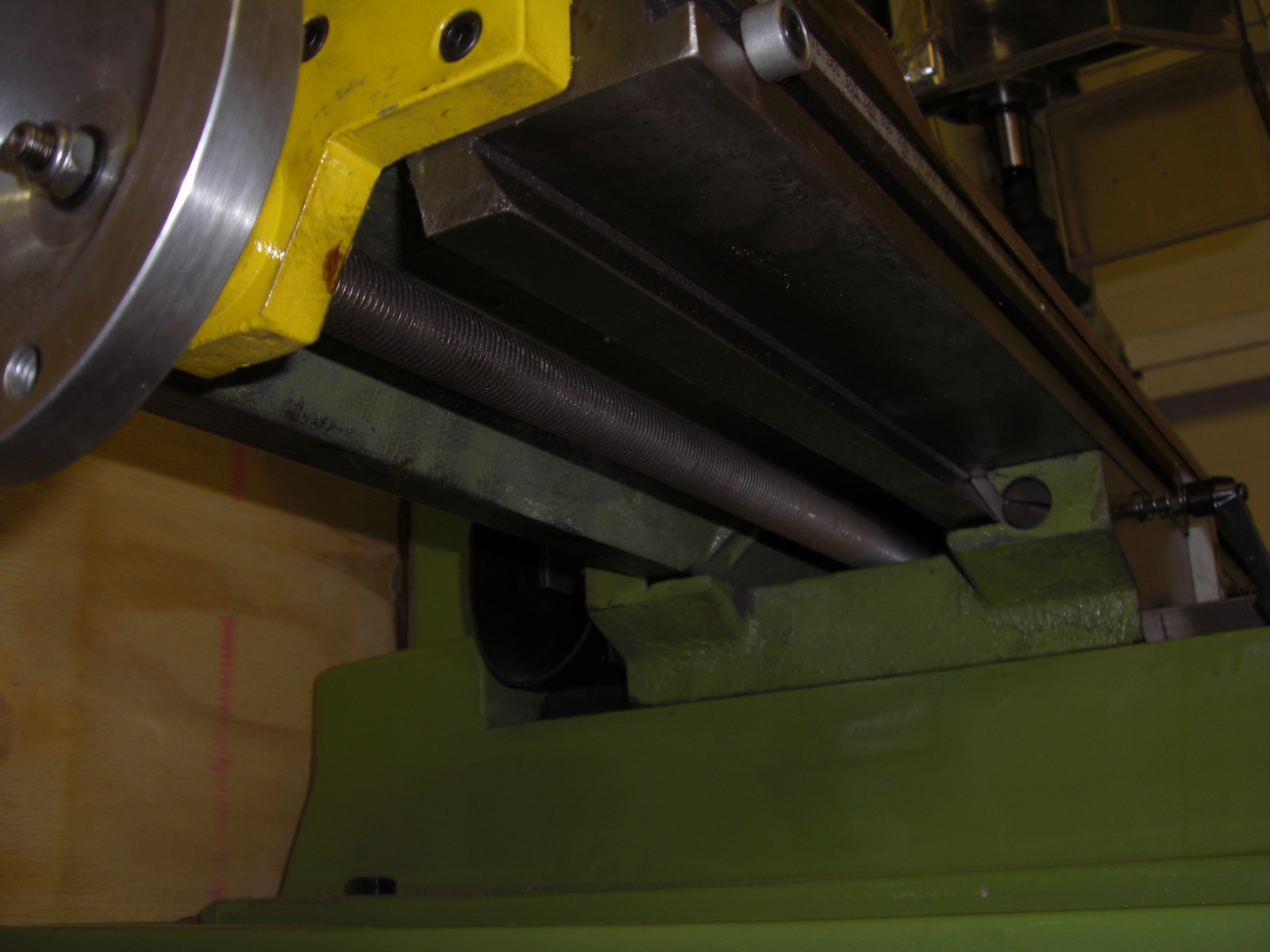

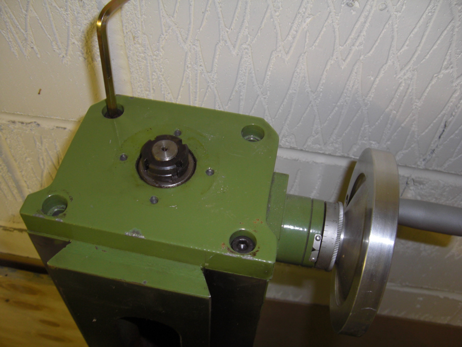

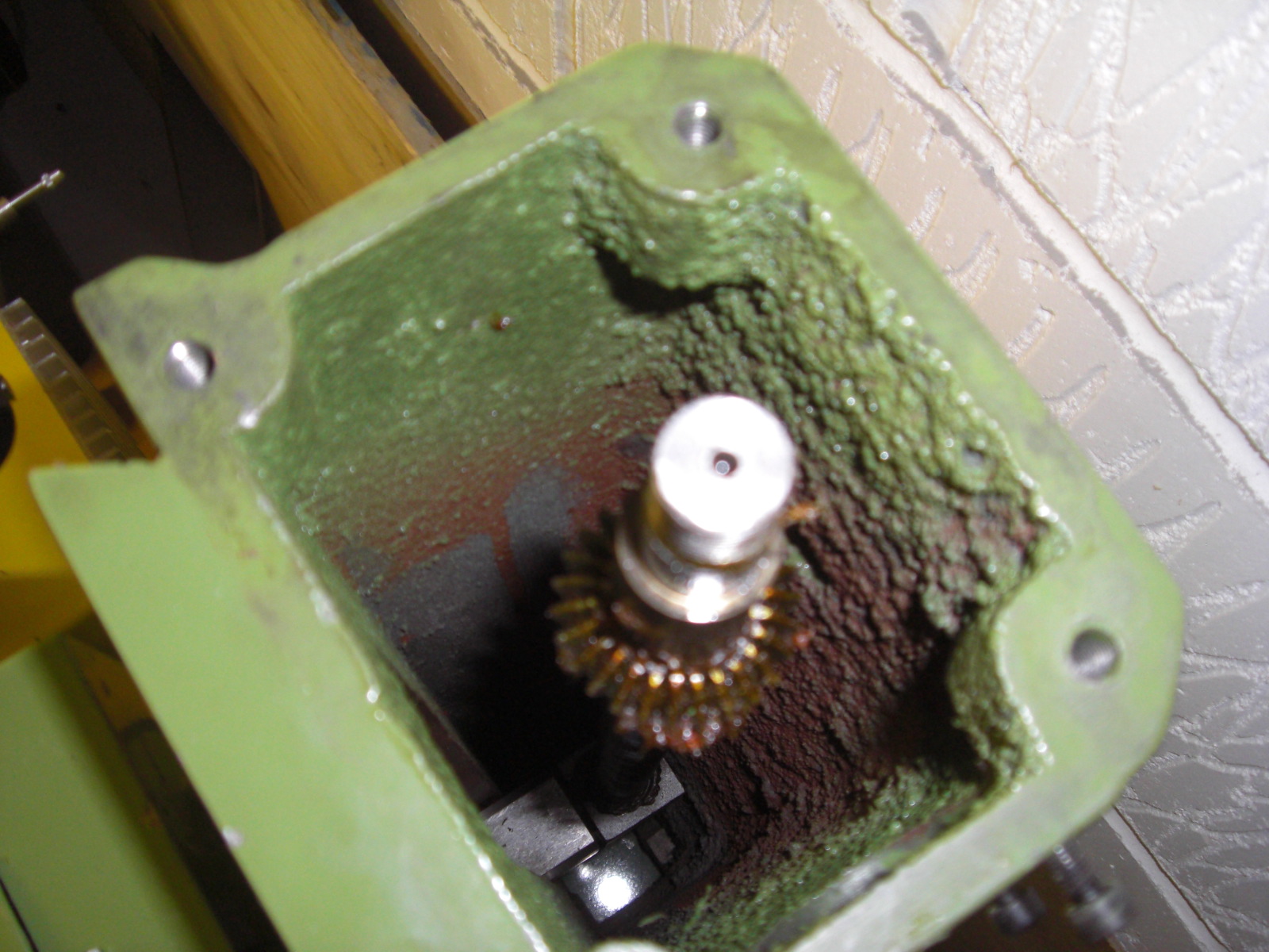

Hi Chris,

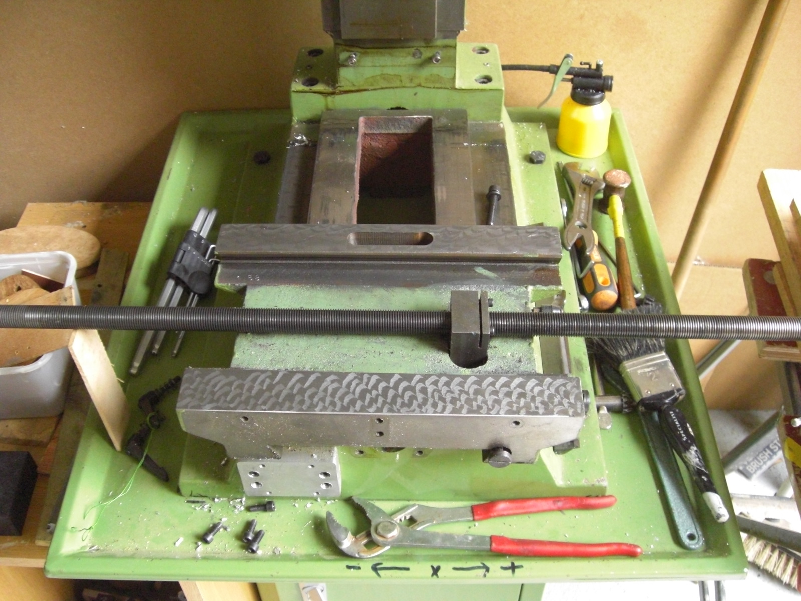

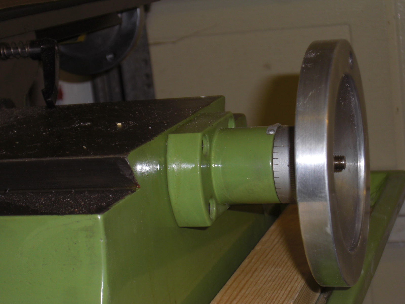

I'll take some pics in a bit and put them on here. The Z is manual feed....
Re: Milling Machine Advice
Thanks Neil
Those are perfect and looking at the lead screw mounts/bearing blocks I think those will be fairly easy to adapt to ball screws/steppers - clearance underneath looks a little tight, but I guess a custom coupling can be made also.
I'm guessing that a 1605 size would fit in there?

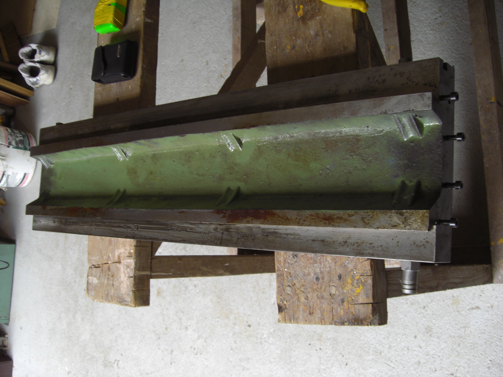

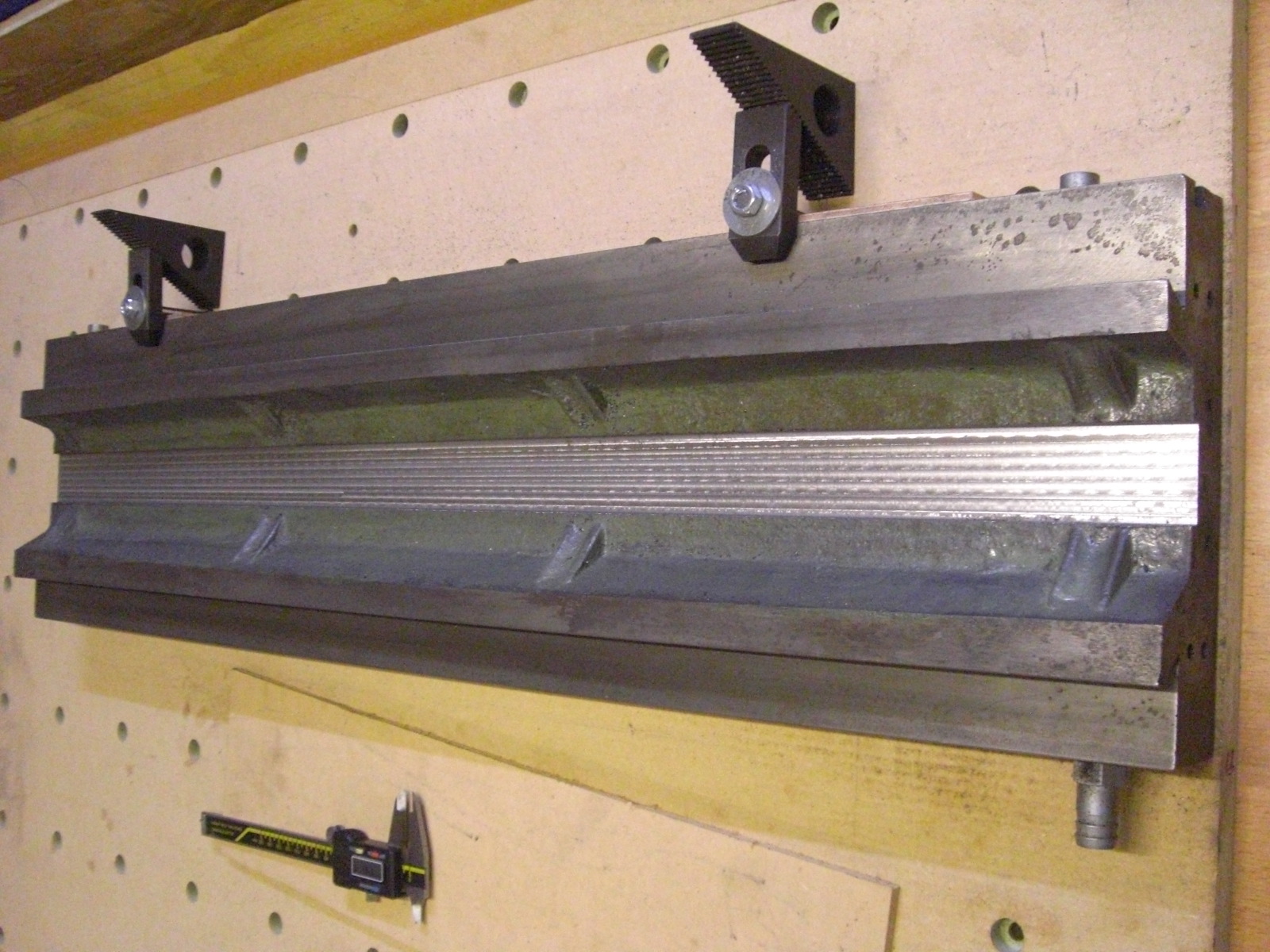

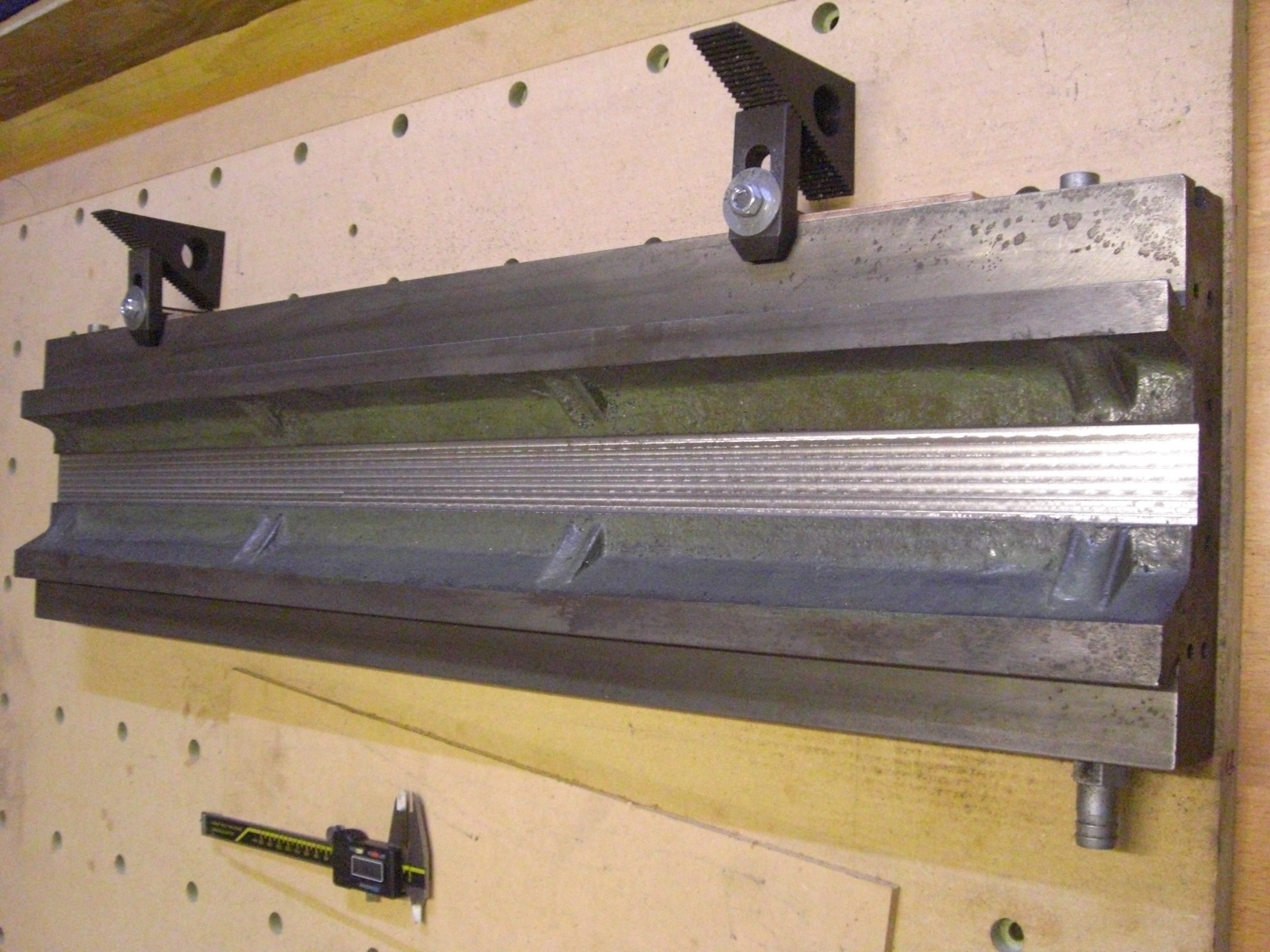

I converted this mill about 9 months ago using the existing screws. with 3.1nm motors and now
I am just changing the lead screws to ball screws if this helps on my Warco WM-18 mill I will be use 1605 screws.

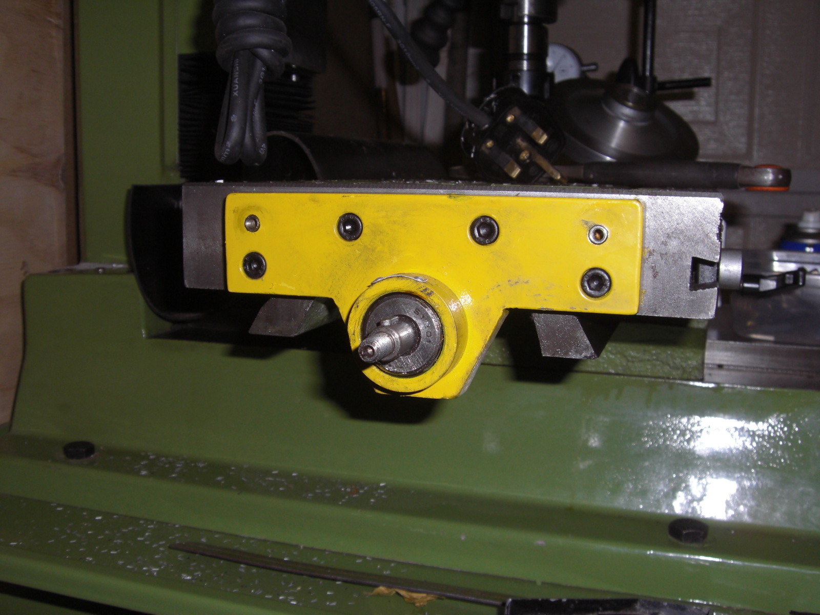

I machined a slot out under the X table with my router very slowly 1mm DOC 200mm/min with a 6mm carbide 4 flute at 5500 rpm.
The yellow endplate on the X table will have the boss taken off and the hole opened out to 42mm, then a boss will be made to insert into the 42mm hole.
The boss will then have a 32mm hole cut out for the AC bearings offset by 3 mm to bring the screw up into the machined slot under the X table by that amount.

The Y screw will fit using the original boss just opened out to 32mm for the AC bearing.
Then of course there is the Z to think about. ..Clive

Excellent pics Clive, thanks (do you have a build log?)
I'm assuming the slot in the bed and moving the replacement ballscrew up is needed to clear the Y axis carriage below it? I was rather hoping to get away without modding the main milling structures (beds etc.)
BTW - when you milled that slot were you using a 2.2Kw Spindle on your router? I've not tried running mine that slow as I thought you got torque issues below 6000rpm?
The Z axis looks like it could be converted by using a new top plate/bearing holder with a stepper/belt arrangement essentially strapped to the back of the column and abandon the "differential/bevelled gears" from the original?
Looking forward to seeing more progress shots.

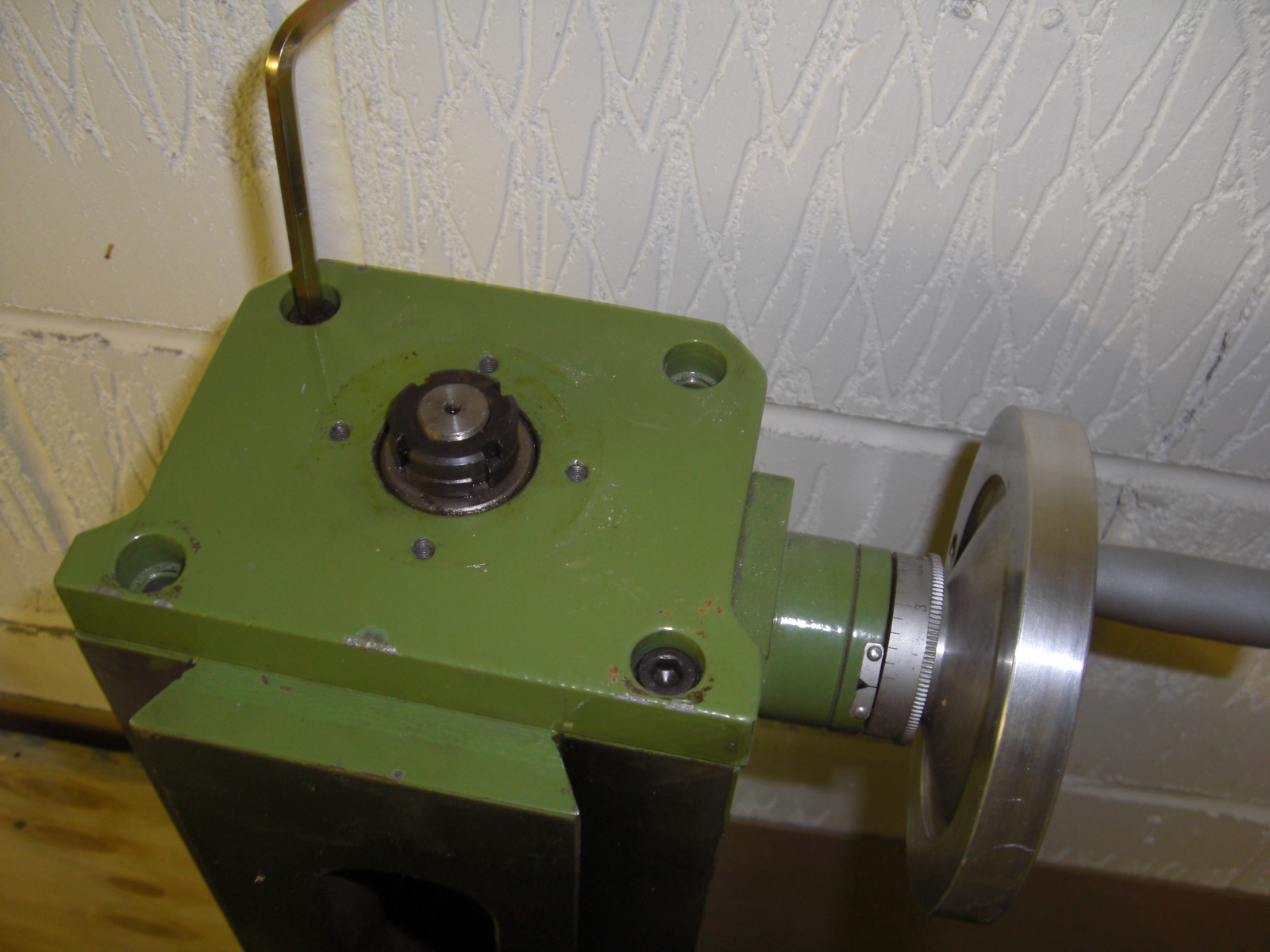

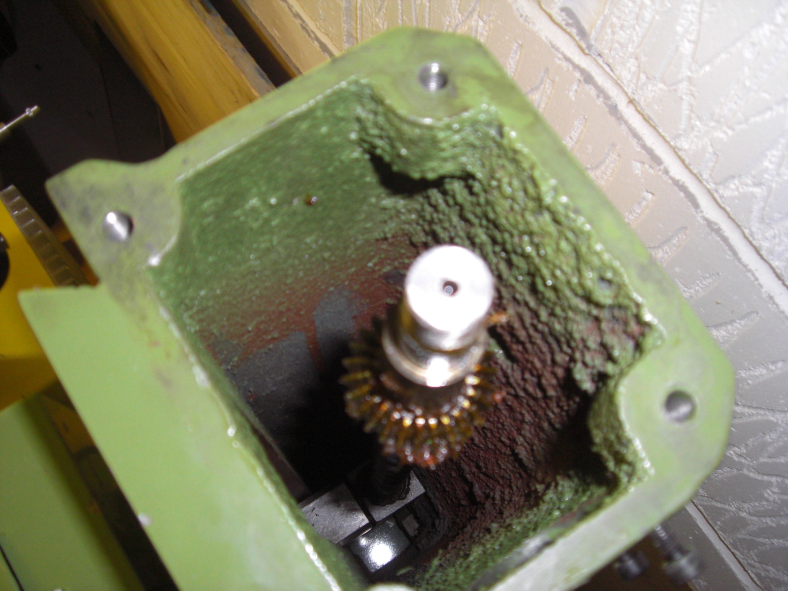

4 Attachment(s)
This is how it was converted with the original screws using the original bolt holes for the top plate. You can see the arrangement for the Y axis with the motor under the x carriage and the X Motor using the holes on the yellow endplate.
Regarding the spindle it is the 2.2Kw W.C. I did try it at 5K but was happier with 5.5K I have my spindle set up so that it won't go down past 3.3K I cut the slot with no issues.
I suspect that all beds are different underneath so the clearance will differ. I will post when I get the x screw in place but I have to get them first. ..Clive
Excellent (starts looking at the budget for earlier purchase :) ).
I'll have to play with my WC 2.2Kw on my router also given your experience and see what can be achieved, though it will have to wait until I have my rotary axis working.

Not quite sure what you mean by that, The flanged boss I am using is to enable me to use the original end plates on the X bed by machining the stub off then boring the 40 mill hole out to 42mm then the the new boss can be fitted with the bearings offset by the 3mm I need to get the screw in.
The flange is in the centre of the bearing housing ie stub both ends.
Do you have a link to that screwed nut? ..Clive
Clive S
BUT BUT BUT CLIVE dont you know Routers can't Machine Cast Iron they must only EVER be used for cutting compressed paper according to ROBINS law. :whistle:

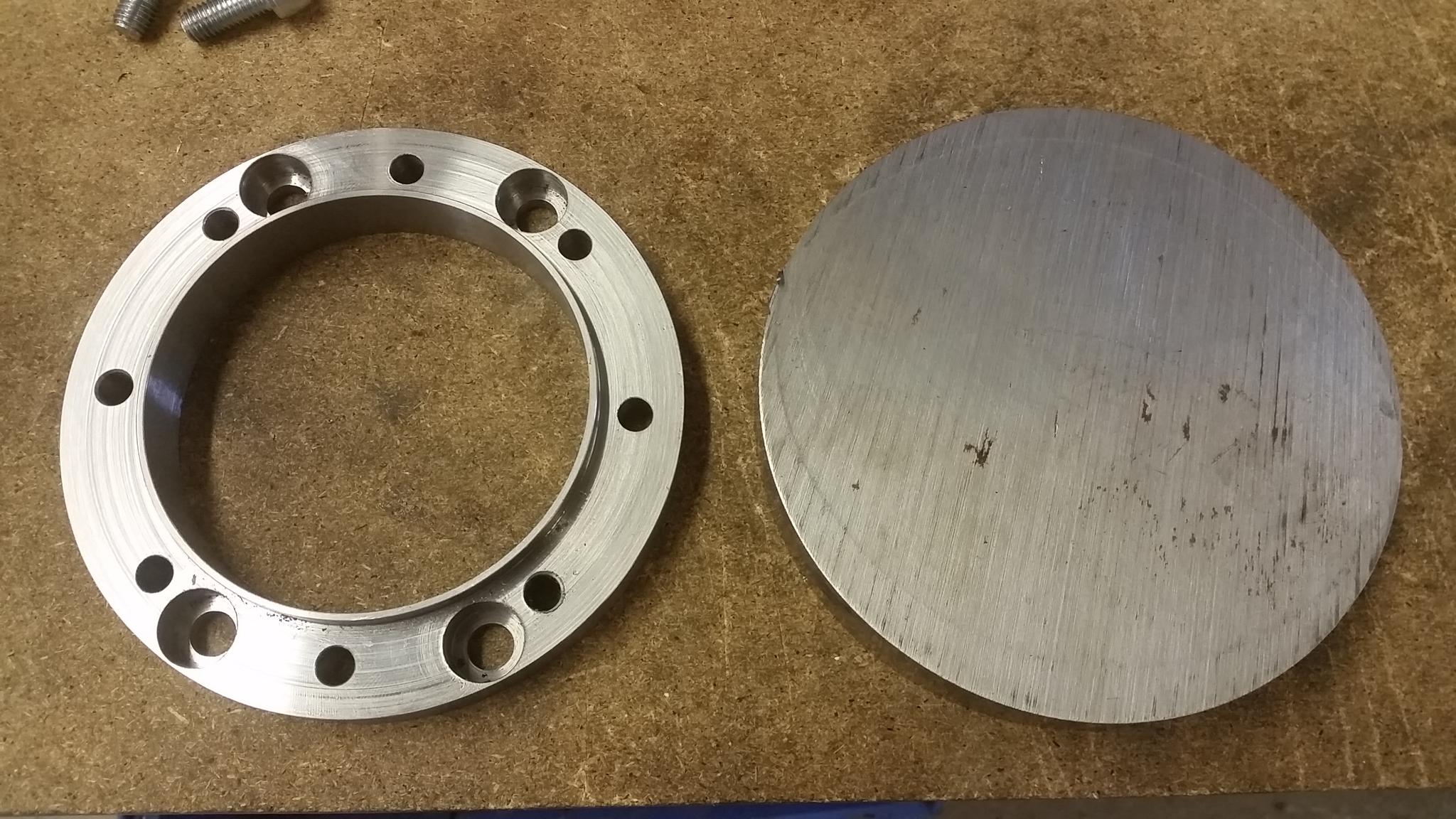

After using the mill (and lathe) to make a one off spacer and a couple of other bits I now wish I'd got a mill with a dovetail Z axis and not the round column!! We've got a BILZ tapping head that requires the headstock to be moved up to use and as soon as you move it you lose position so you have to go back to finding your centres again which is a right royal PITA. I'm going to get a cheap laser pointer and mill a 1mm notch in some white plastic and attach the laser pointer to the mill head pointing back at the wall at the plastic. Hopefully (if the plastic is truely vertical) then I can keep the head square. I've discovered that the rack for the head is only wedged top and bottom on the column and not secured in any way so it can flex as much as it likes.....crap design but I guess you get what you pay for. I can see the machine coming apart and the rack being drilled and tapped so it is fixed to the column to stop some of this flexing. Trouble is we seem to have sold a few "one offs" recently so can't do anything to it yet...
Pics of the spacer, the DRO is brilliant for doing PCD's...makes it easy to drill bolt holes.
