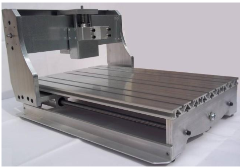

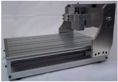

Hi Forum Members,
I am new to this forum and cnc world.
I have bought 3040Z CNC frame from china.
Attachment 12586
Attachment 12587
I would like to install my own stepper motors, Spindle and controller.
Objective of machine will be to mill some soft alloys and wood acrylic etc. Priority will be aluminum copper etc.
Please suggest the right motors and spindle.

Motors: Nema23 3Nm
Spindle: 2.2Kw Water Cooled
Happy Shopping :).

The Stepper motors are 1.5 kg each and the spindle is 5.5kg.
Will the machine be rigid enough for these. And for the spindle which vfd will be good. Someone has suggested me sinamics V20 inverter.

Wouldn't fit 2.2Kw to this machine has the Z axis is too weak to handle the weight and the machine can't handle the extra capacity the spindle allows Ie 12mm cutters. 1.5Kw spindle are better matched.
For the motor/drives and PSU then you can use 2Nm motors and 50V drives running motors around 44Vdc. BUT if you want spare capacity for future upgrades etc then use 3Nm motors on 70-80~Vdc drives running at 65Vdc. Slightly over the top for these machines but better being over spec'd than under.

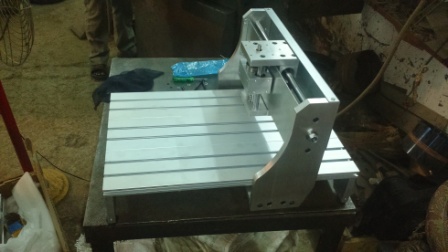

Hi every one it has been a week now. I have assembled the frame.
Attachment 12645Attachment 12646Attachment 12647
I am running Mach3 Version R3.043.066
Every thing is running fine, but there is a problem. when a program is running or the machine is idle, motors rotates randomly. The motion is for fraction of a second. This can happen any time even when the machine is not running any g-code. I am unable to identify the problem. Please kindly help.
Re: CNC3040Z Motor and Spindle Selection.
This will be electrical noise. Use shielded cable on all motors and signal cables and ground the shielding at one end only and take all grounds to a single point. Don't run single cables along side high power cables like Spindle power cable.
Don't fasten signal and power cables together using cable ties.
