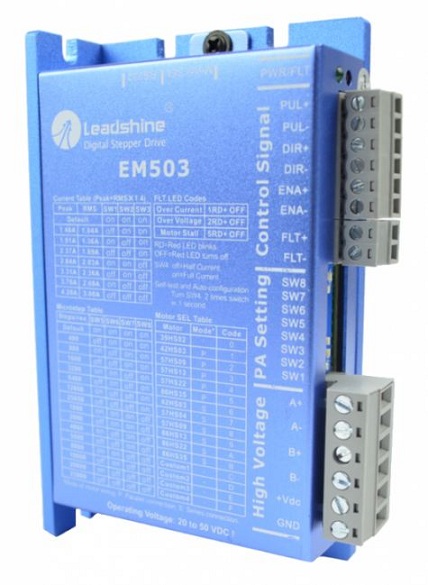

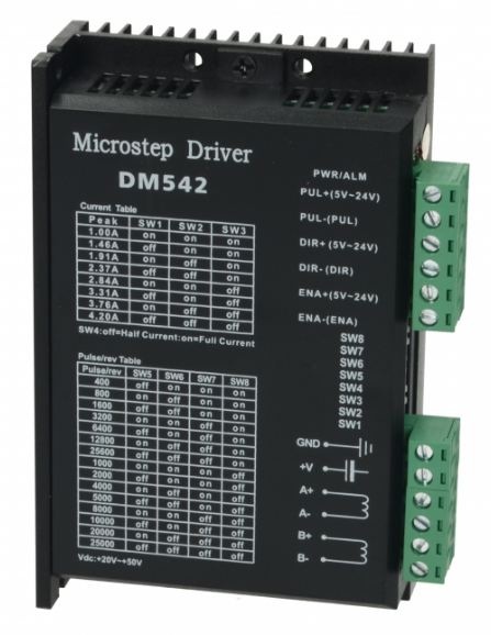

I use only good quality digital drivers like Leadshine EM503 and CSMIO/IP-M controller.
I agree some driver can't cope with accuracy and repeatability.
For example this heap DM542
Attachment 29335 cost 23% price of Leadshine EM503
Attachment 29336 with exactly same parameters.
I personally tested both drivers under same travel speed for torque value.
Motor 8 leads connected parallel (low inductance and higher torque @ higher speed)
Results:
Cheap driver was stalling with much less speed and can't hold same torque - hence the price difference.
My observation regards torque drops vs micro stepping were not according to what I knew from data.
I disregards motors tested on bench - only connected to the machine via 5M HTD belt and spindle not running.
There are few YT clip showing same experiment. I found 16MS 3200 will not drop torque to ~10% of nominal

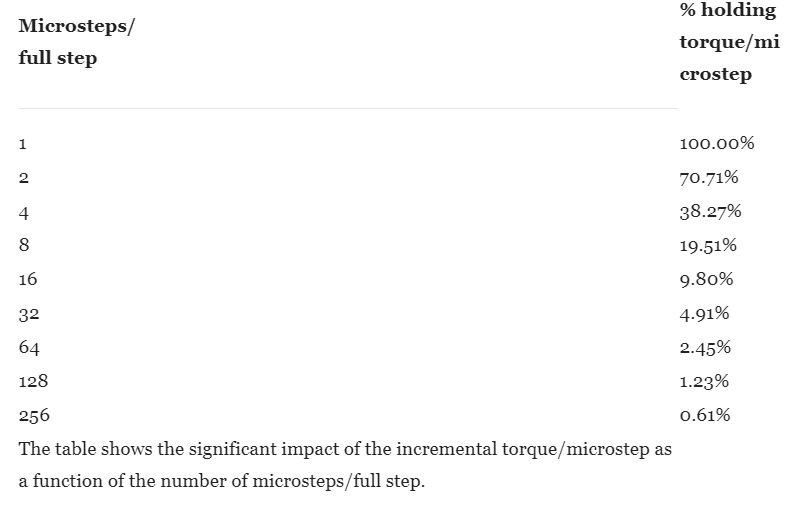

Attachment 29337
I think driver send more current to winding when micro-steps are used hence motor can lift much more than 10% of theoretical value.
Will try to make video when get proper torque gauge display or mini scale
		Re: Dip Switch settings on the M542 stepper motor drivers
		You don't understand that table.
Draw a sine-wave, and cosine-wave. Divide each quadrant by the number of micro-steps you set. Now step those waveforms by one for each step (in the number of micro-steps). That will describe the current driven into each of the X/Y coil (using the simple analogy of a 4-pole 90 degree stepper). Where as at 1/256 would present 0.006 x current on one coil, the other would be at 0.999 x current (just read off the sine-value and the cosine value along the graph, those represent the currents passed into each of the two coils). The extreme example of 256 micro-steps, applying force tangentially to the spindle, the 0.006 holding torque is in the one axis - the other axis is near full holding torque (0.999). the next step - the sine-wave value increases, the cosine-wave value decreases, and so on.This helps to describe the potential to lose accuracy with high microsteps as silly-small drive currents on individual coils cannot translate to linear motion under aggressive loads. If - "you think" the drive sends more current - to balance the forces across the coils to the rotor this would have to apply equally to both coils - and you'd quickly burn your stepper out.
