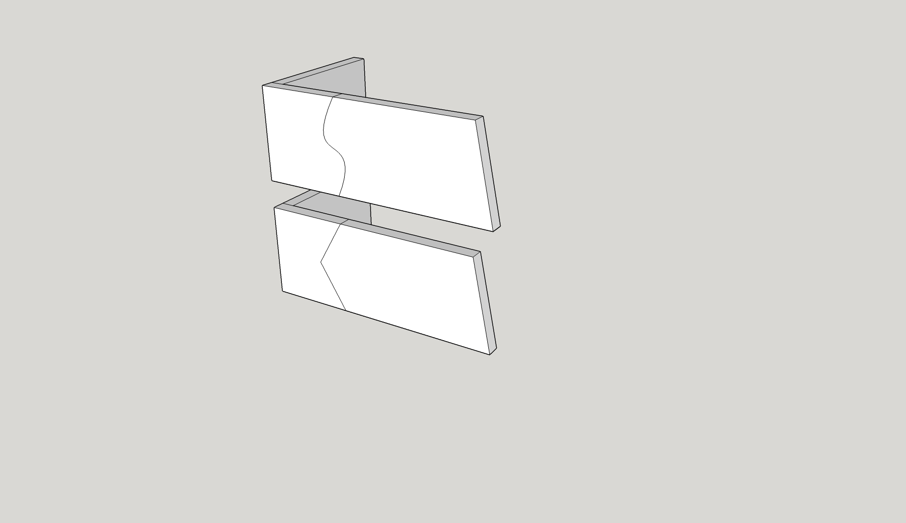

Gerry,
like this
Attachment 13193
Re: Is anyone interested in cutting dovetail joints?
That's a very poor joint that I would never recommend. Too much end grain to end grain.
Also, cutting joints like that with a router in solid woods is always problematic, as the wood will tend to chip where the bit exits the cut.
That's also an issue in the wood joints you PM'd me about. Cutting a lot of those joints in solid wood is very difficult, unless you are starting with an oversized stock in both length and width, to allow trimming off the chipped edges.
I was thinking about a loose tongue now, similar to a biscuit but full width and shaped like the joint, probably plywood, that eliminates the end grain issue.
The grooves in the end of the boards could be cut with a T slot cutter so they all lie flat on the table. but . . .
https://www.youtube.com/watch?v=ER1k4Pcyn0M
With regard to the other cnc joints, I would never make them myself and you are correct about oversize, I like to take at least one shaving off with a sharp hand plane.

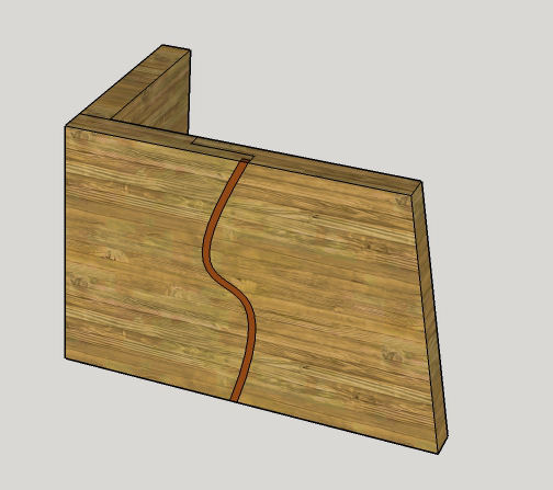

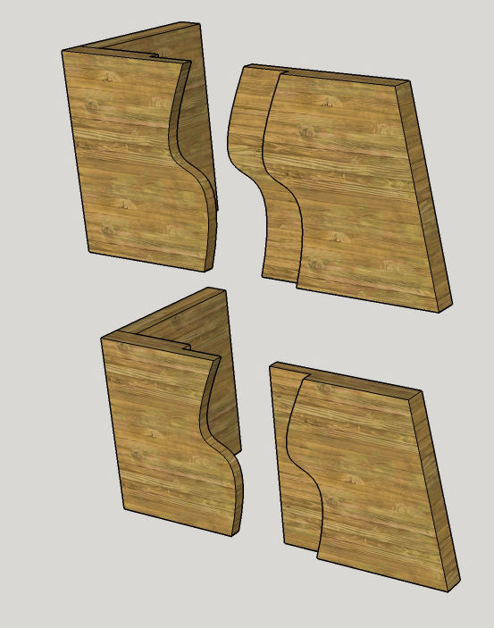

Gerry, try this.
Half lap
Attachment 13212
Same joint with decorative inlay
Attachment 13213

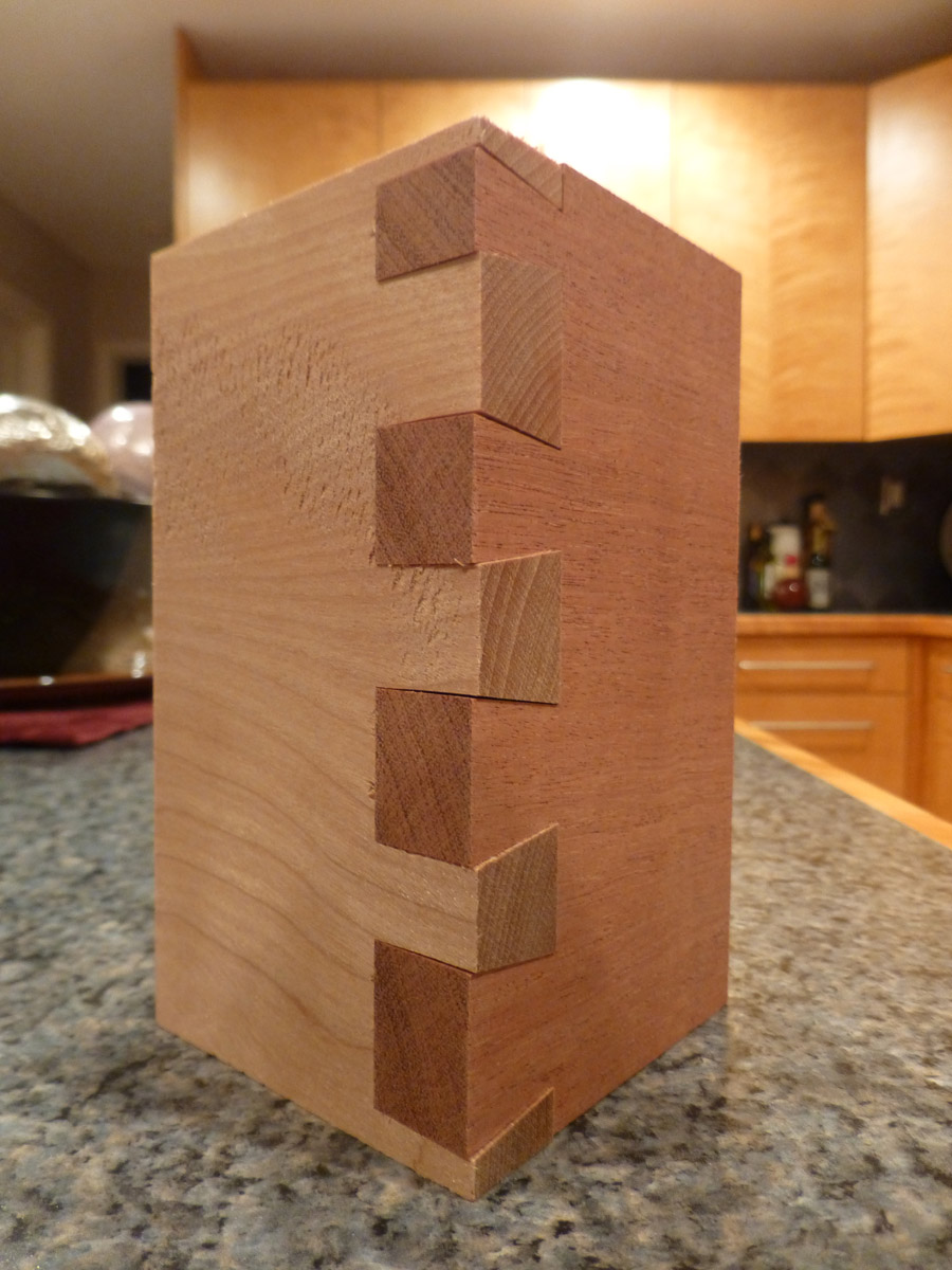

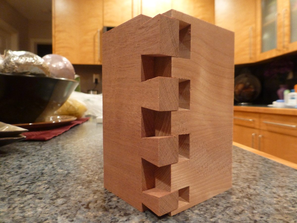

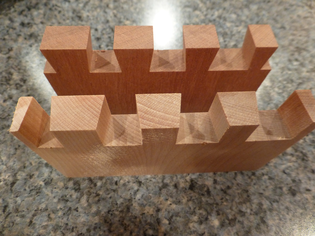

Cutting some hardwood samples to end up as website photos. African mahogany and flamed birch.
Very clean cuts, and very tight fit.
Attachment 13220Attachment 13221Attachment 13222
