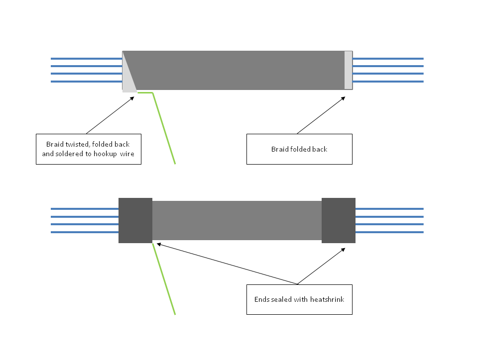

No. The screens are connected to the star point at the driver end. The correct way to do this is to separate out the braid and solder onto it some hook up wire (use 7/0.2 or 16/0.2) then fold it back and put 1.5cm of heatshrink over it to 'seal' the end. At the motor end cut the braid off and again 'seal' the end with heatshrink. Keep the unshielded cables as short as you can without straining anything.
Attachment 12734
Re: CNC newbie electronics query
Could you explain why the screen the is folded and also grounded in the following way. its just that it will help me understand the whole picture of wiring then.
thanks!!
Keeping it simple , the purpose of the screen is to keep noise out of the wiring it surrounds or to stop that wiring creating noise elsewhere. It is also protective in the case of high voltage wiring. The screen is connected to the system earth. It's important that the screen is as continuous as possible.
It's also important to understand that the earth is NOT the mains neutral or the DC side ground, and that those circuits must not come into contact with the earth else it ceases to be protective. You can think of it as extending the protection of the metal box further down the wire. As a general rule screens are only connected at one end to avoid creating 'ground loops'. The technique I've shown is a good way to connect the screen, avoid creating short circuits and provide some mechanical strength to the connection.
