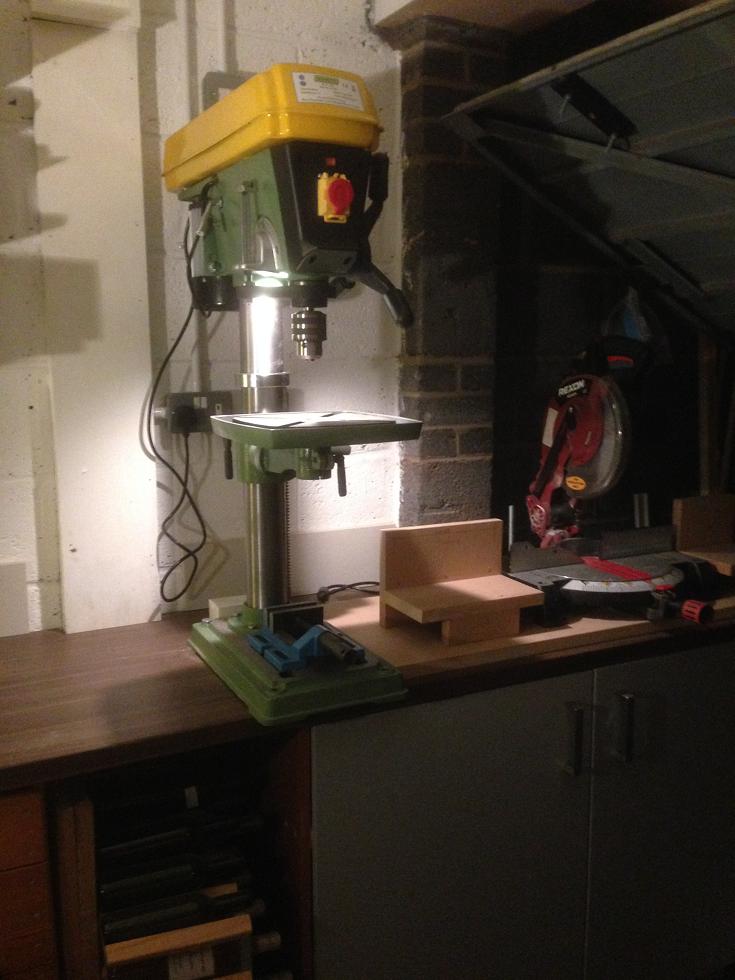

		1 Attachment(s) Re: metalworking pillar drill experiences
		To follow up on my original post – I bought the Warco 2B12 pillar drill in the end and have been using it for a couple of months now.
 http://www.warco.co.uk/drilling-mach...g-machine.html
 Attachment 14301
 Here is a short review:
 I must say just how impressed I am with it and wouldn’t hesitate to recommend it for DIY or light trade use.  It is really sturdily built with a great spec for the price.  The castings are reassuringly thick and heavy.
 I compared this to similar drills from Axminster and other places and couldn’t match it for price / specification such as the 80mm column (many have 70mm) and 16mm chuck (some have 13mm).
 First off the assembly really does need 2 people.  The motor head unit is VERY heavy and lifting it onto the column on your own is very difficult.  As I was on my own that day I opted for a different approach which was to lay the column down on the workbench (horizontally) with the column hanging off the end and pointing towards me.  I was then able to slide the motor unit onto it and tilt the whole assembly upwards into the vertical position.  Again I wouldn’t recommend single person assembly as it was all a bit perilous!
 After fitting the table, tightening the belts and so on I fired up the motor and found it pleasantly quiet.  Then it started hesitating and cutting in and out.  Turned out that the pulley cover lid was not fully home – you have to push it down quite hard to engage the safety cut out switch in the lid.  Then it was running sweetly again.  Finally I fitted the chuck making sure that the arbour was fully de-greased.
 I wiped over any exposed metal parts with duck oil, greased the table lifting rack and bolted the base to my work top.  Be aware that even with the drill pushed to the back of a 600mm deep worktop, with the motor unit almost touching the wall, it still overhung the front by about 30mm.  I’ll add a small extension to the worktop.
 Changing the belts is a fairly straightforward task although I need to use a step ladder to reach.  I may replace the screw holding the cover on to something with a thumb wheel then the whole process will be tool-less.
 After using the drill for a bit I noticed what appeared to be excessive run-out on the chuck.  After a call to Warco they assured me the one of the reasons they sell this unit is that the chuck is good.  So I measured the run-out on the arbour (chuck removed) and found it was about 0.05-0.07mm. Pretty good for a pillar drill.  I then re-fitted the chuck and put a small round bar in the jaws and measured around 0.1mm, which again I was happy with.  A bit confused I then rolled the drills along a flat surface and found that they were pretty bent!  The drills were a brand new (but cheap) set from ArcEuro.  I then chucked up my trusted 4.2mm tapping drill from Tracy Tools and switched on the drill.  The tip ran true to the eye so I went on the Tracy Tools website over Christmas and ordered what I’m hoping is a quality set of drill bits.
 But even with bent drills this makes light work of drilling holes in 20mm aluminium plate.
 I also bought a set of reduced shank drills up to 25mm.  I’ve yet to use them but don’t expect any power related problems based on current experience.
 I've bought a 100mm digital read-out which I intend to hook up to the quill to make accurate counter-bores for recessing cap heads etc.  I’ve got some rough ideas about how best to do it in terms of brackets etc but don’t have time for that project just yet.  If anyone has done something similar I’d be interested.
 I also plan to make a wooden drilling table, mounted to the main table, with an adjustable back fence to make woodworking jobs a bit easier.  Something like this:
 http://www.axminster.co.uk/axminster...FVDHtAodgE0AAg
 In summary a great pillar drill and well worth £295 including VAT and delivery.

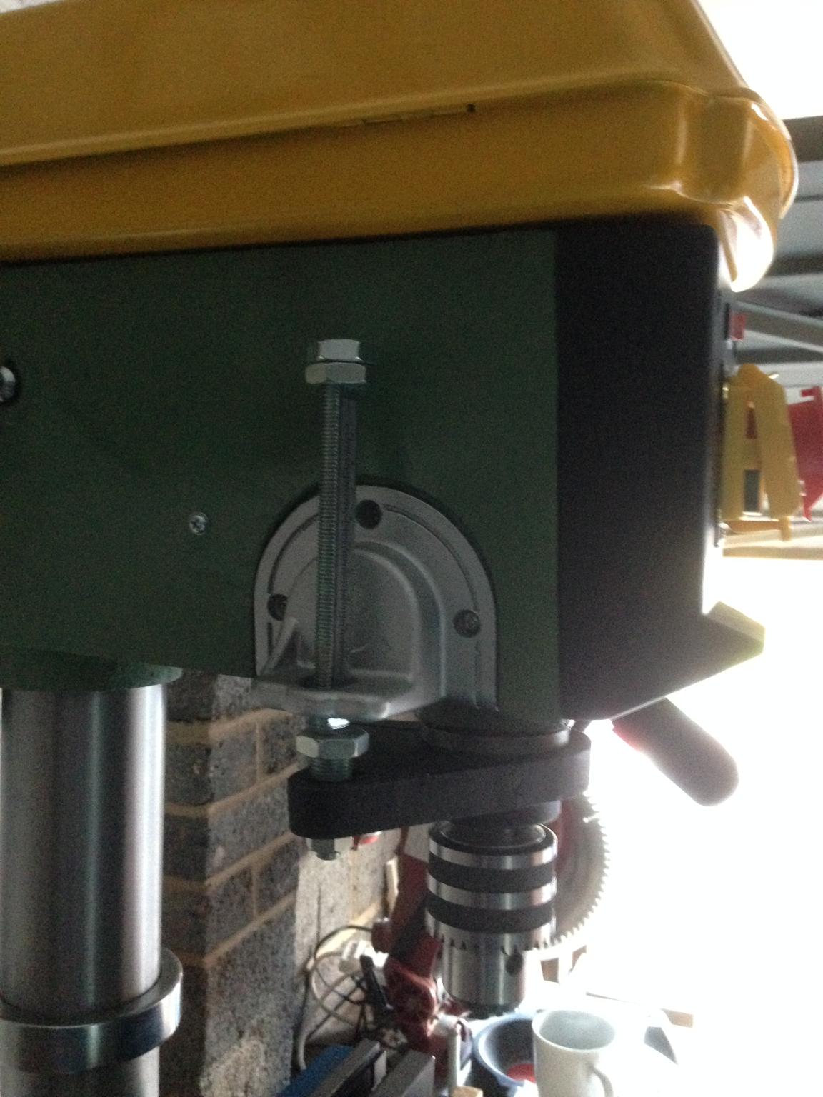

		I'm thinking about adding a few features to my pillar drill - DRO, quill hold, better depth stop.  I've got some ideas to make a nice package on the left side of the machine but before I do can anyone tell me if I take off the aluminium depth stop held on by 3 bolts will the spring and/or bearing fly out never to be put back?
 Attachment 16312
 The instruction sheet that came with the drill shows a fairly poor photocopy of the internals.

		11 Attachment(s) Re: metalworking pillar drill experiences
		Some updates.  First of all taking the cover off is no big deal - the spring mechanism is not affected:
 Attachment 16375
 I noticed that the casting was not great with some flash around the holes so I filled them flush:
 Attachment 16376
 Then I had a look behind the electrical box on the front - glad I did as one of the wires had been trapped by one of the plastic ribs:
 Attachment 16377
 I re-seated it so the cable was free.
 Then I drilled and tapped the casing to take an angle bracket, then squared it up with the chuck (to try to get them parallel to each other and keep the DRO accurate):
 Attachment 16378
 Attachment 16379
 Then I machined up a plate bracket, bolted a piece of extrusion to the plate, then mounted the DRO:
 Attachment 16380
 Then I used a couple of M6 rose joints and threaded rod to join the DRO to the quill depth stop arm.  This is because I couldn't be sure that the DRO would be absolutely parallel to the quill and didn't want to side load the slider.  Also there is a tiny bit of play in the quill when extended which would also load the slider.  Keeping the rod long minimises any error:
 Attachment 16382
 Here it is fully extended:
 Attachment 16381
 I had to cut a bit off the end of the spring cover / depth stop casting so it didn't hit the DRO slider.
 Works a treat - the quill can be locked off at any depth by setting the nut on the underside of the depth stop threaded rod, or a maximum depth can be set by the nut on the top side of the threaded rod.  Only probably is that the DRO readout slider resonates/buzzes quite loudly when the drill is running.  I'll have a look and see if there is a pre-load set screw somewhere to take out the play.
