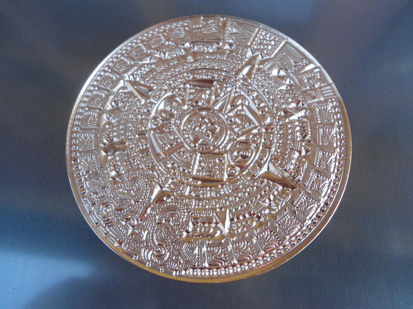

To give an example of the kind of detail 10mm pitch will get you see my aztec calender.
https://www.youtube.com/watch?v=wjDvimSdH8M

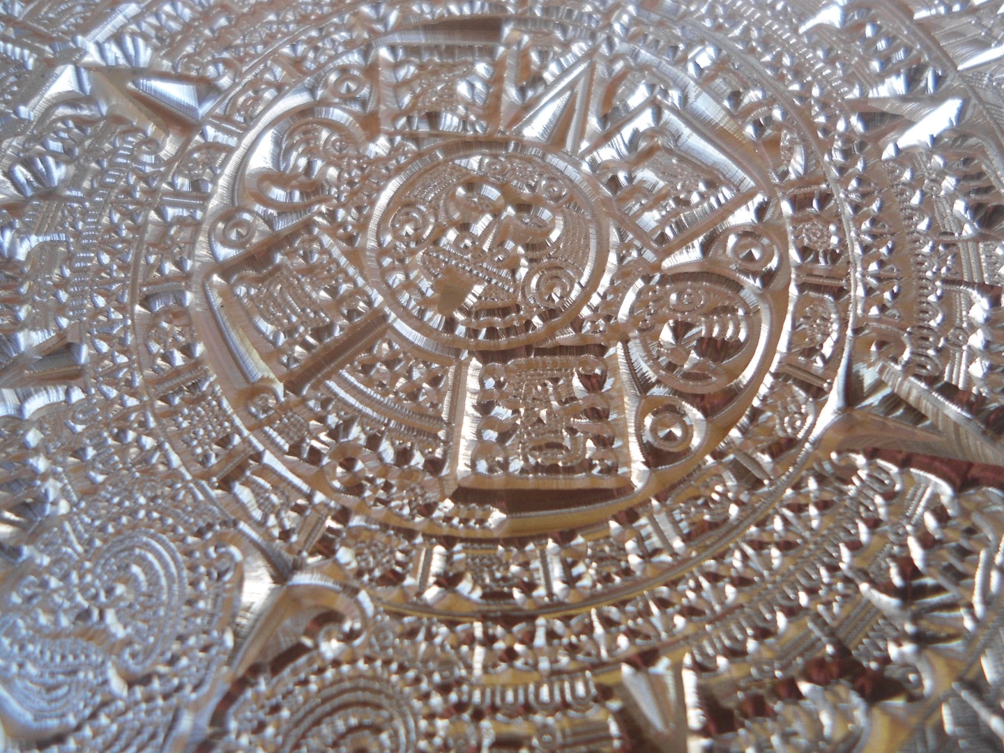

JAZZCNC
Now try one half the size:
Attachment 12787Attachment 12788
