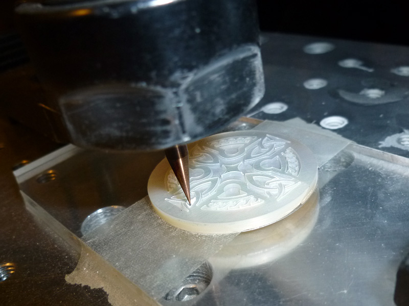

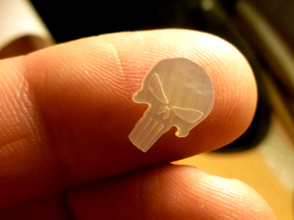

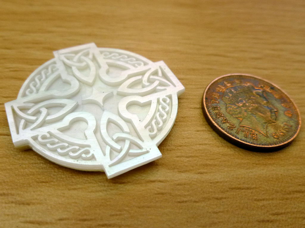

I've recently completed a test project in mother of pearl - it was an intricate inlay to be used on a guitar fretboard. Here are some pics:
Attachment 12778 Attachment 12779
I stuck the blank to a piece of perspex using double sided. As my XY 0,0 was in the middle, I'd milled out a very shallow pocket so that I knew where to stick the blank.
It went reasonably well, but after 16 hours of cutting (that's what you get for pocketing with a 0.2mm end-mill) the double-sided let go on the final cut-out pass. Managed to stop the machine before the cutter had a chance to ruin the work completely, but it meant having to re-align the stock manually to get myself an outer profile cut that was deep enough to manually grind back to (and under a bit) and maintain the illusion of a nice clean line. I did this with some level of success, but it's lop-sided and not good enough to pass as a usable piece.
Anyway, if I do this again, I'll essentially employ the same method (double sided) but this time I'll make that initial shallow pocket in the perspex deep enough to accommodate the majority of the depth of the blank, which will be a nice snug press-fit into the hole. I may also mill a smaller through hole in the perspex so that I can 'poke' the finished work out from behind, should it need poking.
Any other suggestions..?

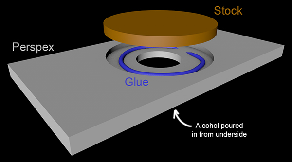

Do you mean like this, silyavski?
Attachment 12802
How easy is it to ensure that the stock stays 'flat' (perpendicular to the cutter) when seating it on the glue..? The mother of pearl show-face is usually ground flat (already pretty thin) and bonded to a rough stone substrate which gets surfaced parallel to the show-face before starting the job. If there's too much of a rise in the stock once it's glued then it might be problematic... Hey, but good suggestion and worth a try for sure.

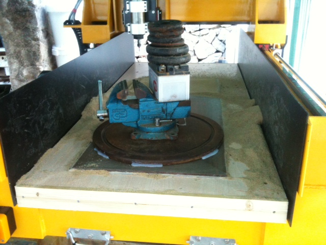

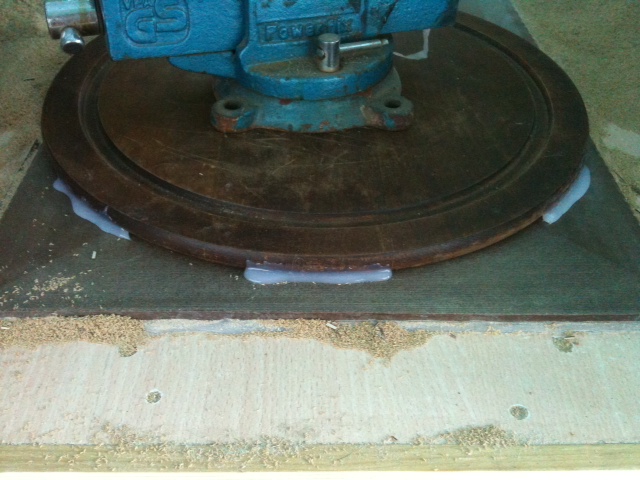

No glue below. Fit it in, then glue around. Once you know the hot glue, you can stick anything with barely just enough glue to hold firmly and at the same time to remove it very easily.
In case like yours, where fine elements can be damaged by pulling by hand or lifting with screwdriver/that's what i do/, so use alcohol.
I can't imagine a life without hot glue :-)
See some example, just right now what i have on my machine. The wood is bend, that's the weights are for. See how little glue i use. you do the same, just your element will be a little inside the fixture hole :
Attachment 12803 Attachment 12804

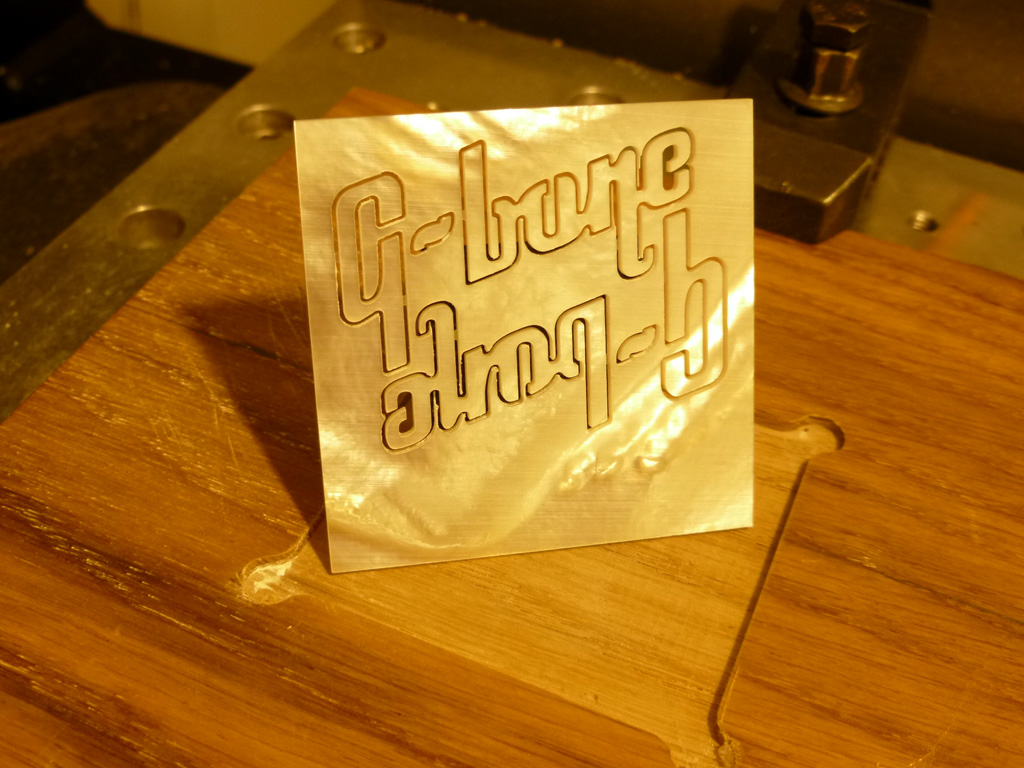

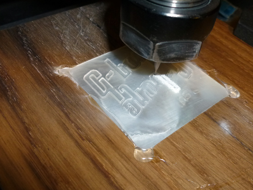

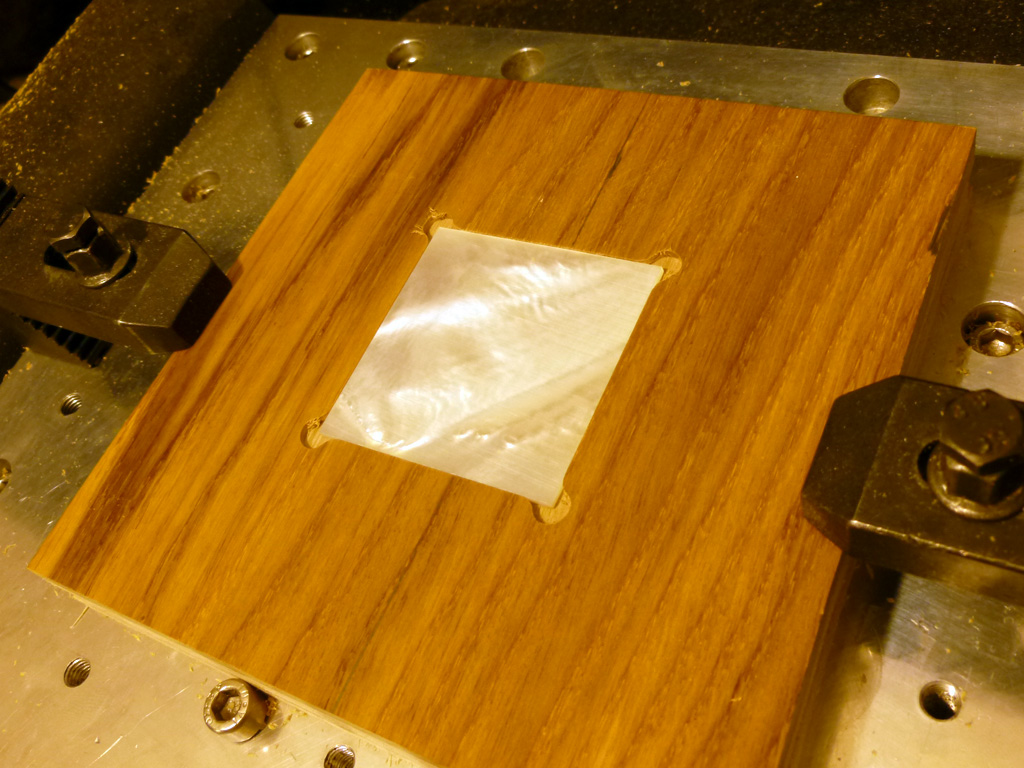

I recently made a couple of custom logos in MoP. Based on earlier recommendations, here's how the (this time very successful) work-holding went:
- Machined a pocket in a flooring off-cut to hold the stock (very snug press-fit). Also used a bit of double sided tape and a couple of dabs of hot glue to help prevent the work lifting. Note the access points at the corners to aid in lifting out the work.
- Once cut, I shaved off the glue and then dabbed a few drops of meths through the shell and onto the double sided tape which let go straight away.
http://www.mycncuk.com/attachment.ph...id=13516&stc=1http://www.mycncuk.com/attachment.ph...id=13515&stc=1http://www.mycncuk.com/attachment.ph...id=13514&stc=1
I guess it's basic stuff, but if it helps someone out on a first job, then so much the better.
Wal.

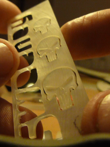

That is a strong piece of tape..! What's it like removing the work..?
I use a generic double-sided tape, not a bargain-bin brand but not engineering grade either. It's pretty strong but to be honest, for the smaller pearls stuff I'm mostly just using hot glue around the edges of the stock nowadays.
Less fiddly scraping off the tape..!
Attachment 17134 Attachment 17133
