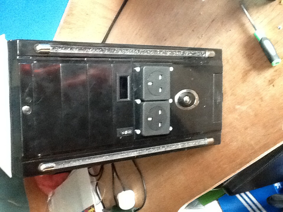

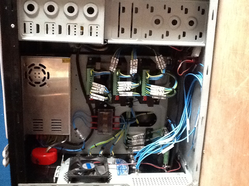

This is my controller so far
still need to hook the limit switches up

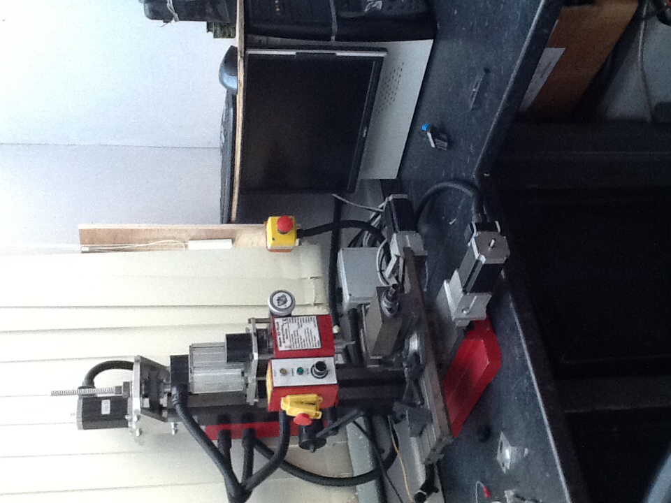

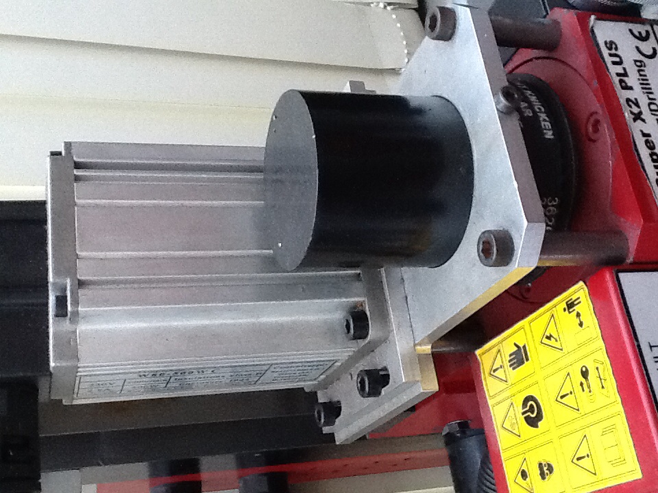

This is my machine
the controller is in the house at the moment so I can draw a nice wiring diagram for safe keeping and sharing

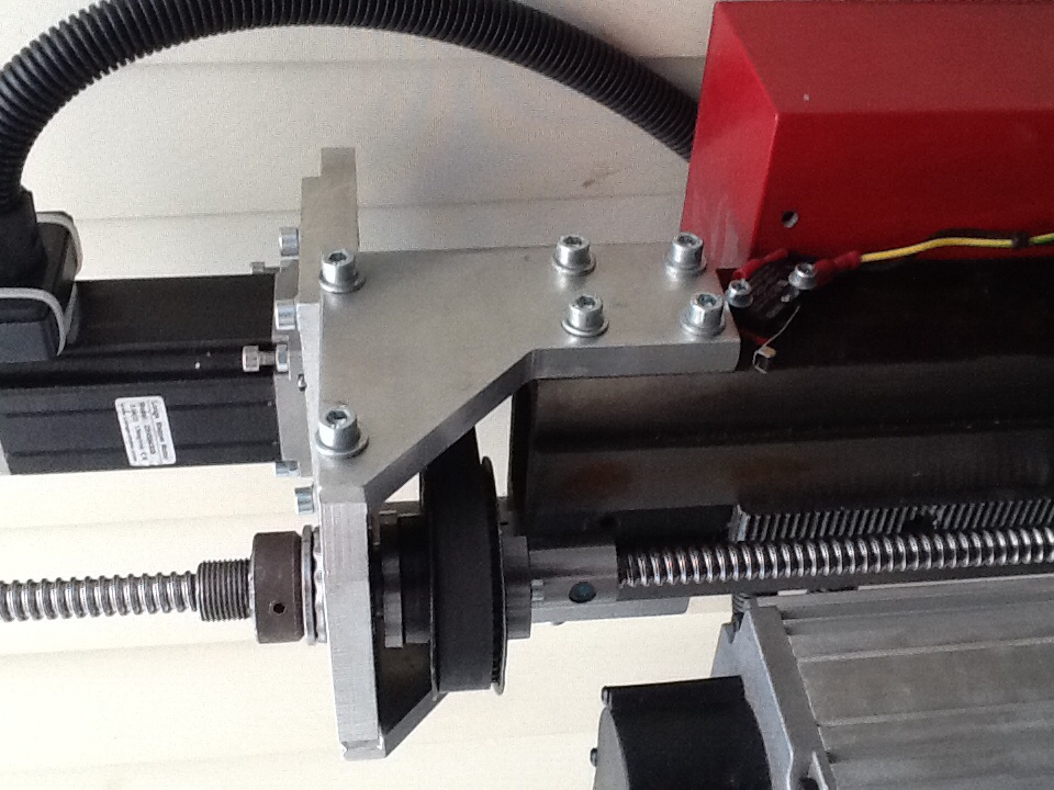

http://www.mycncuk.com/attachment.ph...id=13436&stc=1

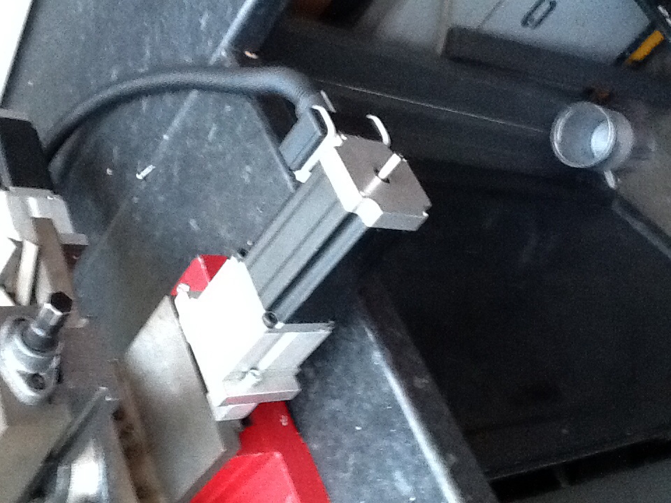

My z axis mounts all made manually on this machine and ballscrew
And nema23 425oz stepper
I also had to move the spindle motor forward so I got a shorter belt of fleebay and made new mounts
http://www.mycncuk.com/attachment.ph...id=13437&stc=1
Got the X and Y motor mounts of eBay and had to make a 6mm spacer to compensate for the length of the lovejoy couplers

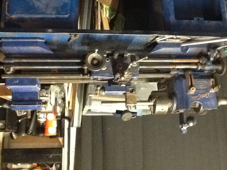

Just got a lathe cheaper than what people where offering to end machine 2 leadscrews for me :cocksure:
So over the next couple of days I plan to clean this bad boy up and machine my leadscrews for my sx2

does anyone have any info on this lathe as I have never heard of the name
Raglan Little John lathe
thanks

Www.Lathes.co.UK/raglan
Stick with the 3phase motor and get a VFD, you'll regret going to a single phase.

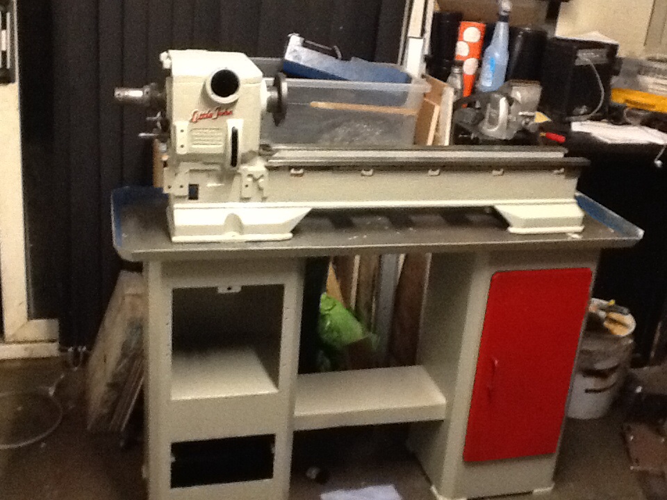

Started cleaning the lathe and got a bit carried away lol
i had some paint of a steel structure I fitted in work and it's fire rated paint so I thought y not
Need a good vfd for a 0.5 hp 3 phase motor any suggestions?
where can I get a tool post also as the ones that came with it are home made and don't look good?

Finished the lathe up to now I have put a misubishi vfd controller and a 3 phase motor on it an it runs well. I can control the speed easily
I bought new bronze nuts for the top slide and crossfeed and a new top slide leadscrew
