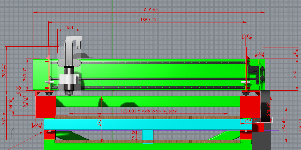

		G'day Everyone!
My name is Richard and I live in Melbourne Australia. I have very much enjoyed reading the various threads on building DIY machines and probably like many on this forum have found and very much enjoyed the learning curve in getting to understand the issues and parameters in building a CNC machine. Unlike many on this site, I have limited experience in building machines, but I am quite a handy person and accustomed to getting my hands dirty on DIY projects.  I am waiting for delivery of my TIG / Stick Welder, so my practical learning curve will start with improving my welding skills.  Meanwhile I've been on a steep learning curve getting familiar with Rhino as a CAD drawing package (also to be used in designing Kinetic Artwork).
I have created this thread hoping that those more experienced will be able to guide me on my build. So here goes....
1. My Machine Parameters
I plan to build a CNC Router, with the flexibility to use it for Plasma or Laser cutting of steel. It is intended to be a general purpose machine with a high degree of accuracy (if I'm going to the trouble of building something bespoke, then it may as well be accurate).
The main material I will be cutting is timber (plywood up to 25mm thick) and some aluminium (aluminum) to create Kinetic Artwork (wall art etc).
It will initially be a three axis machine, but I intend to build in capability to expand to a 4th axis to turn table legs, carving etc. If I honest with myself, I suggest that the challenge (and resultant satisfaction and no doubt accompanying frustration) of the build outweigh practical applications.
The general parameters of the machine are:

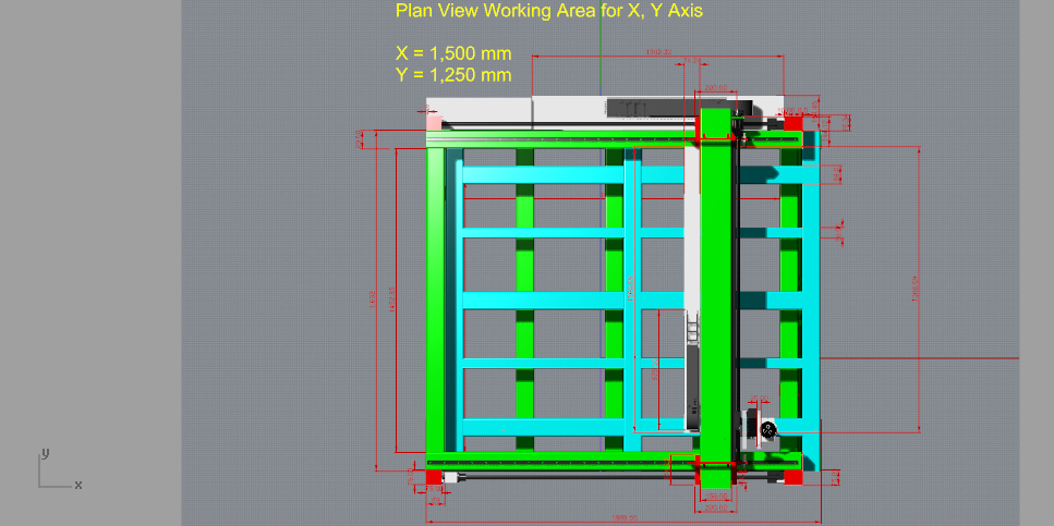

1.1 Working Area
X Axis - 1.5m
Y Axis - 1.25m
Z Axis - capable of 220mm travel, but anticipated generally working to 154mm
4th Axis Capability - Removable working platform to accommodate greater Z depth of 350mm (total) for an additional axis
As the machine will be residing in my garage, I need to make is as compact as possible (car parking will likely be a casualty!).
1.2 Router /Laser/ Plasma Capability
I intend to install a 2.2kW water cooled router as the main cutter.
I have designed a holding water tank and support to be able to cut steel. I understand that compromises are made to do this, however as it is as general purpose machine, speed etc. are very much a secondary consideration. I'm not sure where my Kinetic artwork will take me, so flexibility needs to be built in.
1.3 Frame / materials
I intend to build the majority of the frame from 89 mm SHS, 3.5mm thick.
The Gantry will be manufactured from Steel RHS (150 x 200 mm) reinforced with 10mm Steel plate to sit on the carriages for the X Axis.
I attach a spreadsheet showing the calculated weights expected to be carried by the X, Y & Z axis, which:
X = 112kg
Y = 27kg
Z = 19kg
For obvious reasons I wish to ensure that the removable Steel/MDF platform is robust to ensure accuracy. I have read threads where some members suggest simply building a removable MDF platform to vary the Z depth. Given the depth of the Z axis and flexibility to do some Plasma/ laser cutting, I have swayed away from this, but equally, I am conscious of the additional Steel / weight / work my design requires. Thoughts on alternative variable Z axis designs welcome! My requirement is to ensure accuracy prevails (no movement).
1.4 Motors/Drive
Having read in detail a number of threads relating to similar designs, I have landed on a design which utilises:
Ballscrews - still to calculate / determine whether I need 20mm diameter or can get away with 16mm when considering lengths of:
Y Axis - 1,694mm
Z Axis - 1,762mm
Z Axis Actuator - I will probably look to purchase one for the Z axis, believing that something 2nd hand may be more accurate than anything I will build.
Guides - Looking at LM guides for greater accuracy from the likes of THK or suitable alternatives.
1.5 Drive Mechanism
All Axis (perhaps with exception of Z Axis depending on Actuator used) to be powered by belt drives to reduce vibration and provide flexibility in changing gearing ratios if need be. Initially, I intend gearing to be a 1:1 ratio, but final calculations may dispel this notion.
I intend utilising stepper motors for their greater torque range, and wish to explore the use of an encoder function to provide a closed loop system reducing errors if steps are somehow missed.
Based on earlier research, I expect that I will be utilising something like NEMA 23 motors with outputs around 3 to 4 kN (424 to 566 oz/in) outputs.
I have purposefully held off on this hoping for some feedback on my draft design of the frame (gantry) suggestions on shaft diameters, etc., before calculating final requirements.
I am not sure what cutting speeds I should design to (and hence input for motor requirements). Speed is not essential as I will not be into major production runs, but neither do I wish to watch a job completed at a snails pace. Any input on appropriate / realistic tool speeds for cutting MDF (25mm) or aluminium (aluminum plate say typically 20mm) which I should aim would be much appreciated.
Plasma or laser speeds could presumably be much faster??, but router work should drive the design.

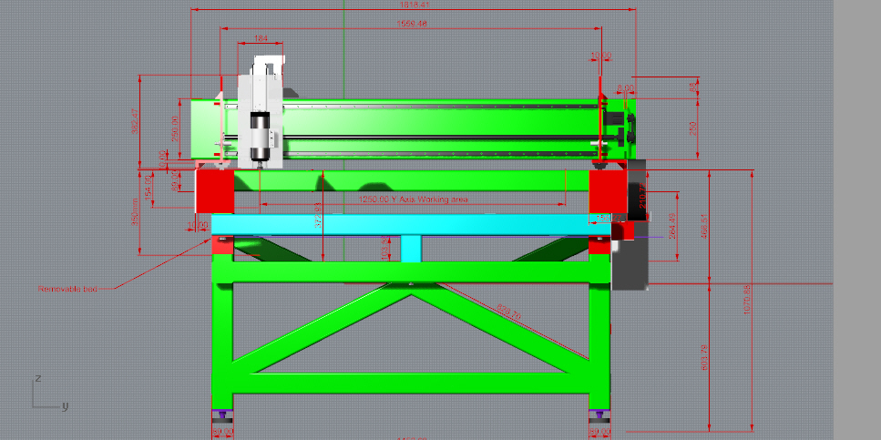

 2. Drawings and Spreadsheet

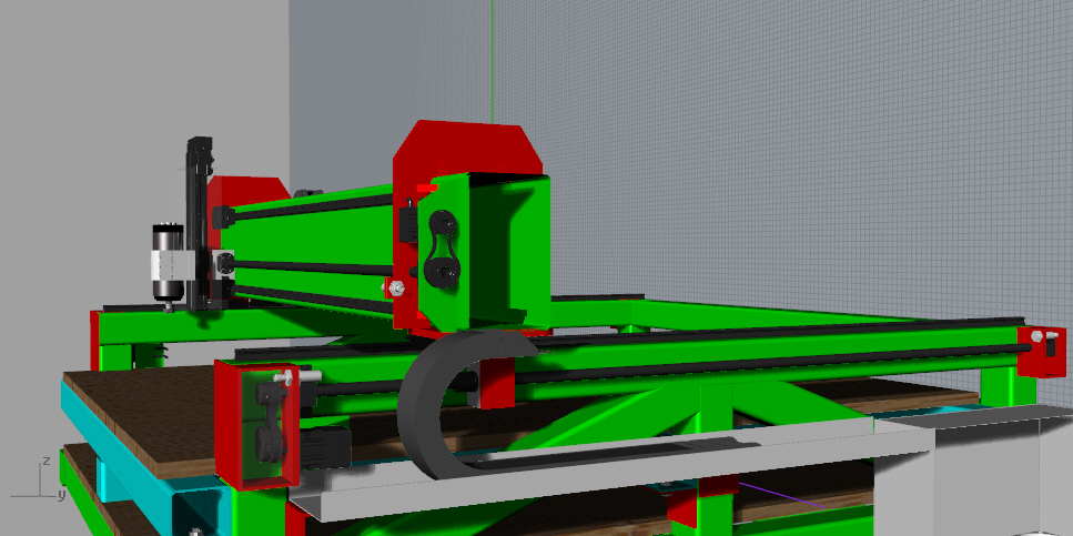

For reference I attach various views and closeups of my draft drawings and spreadsheet showing materials and weights.
I am not totally sure how some components for drives/ LM / ballscrew Nut anchors should be attached, apart from the general understanding that everything needs to be adjustable to tweak tolerances (I/m sure my soon new found welding skills will challenge the need for this!). Thoughts / photos on how items should be bolted together or how I should alter my design to provide for this would greatly assist.
3. Your input
I now lay myself prostrate, seeking input from members who have the skills and experience in building such machines on matters raised or any other items which my design raises.
Please note that I have a thick Aussie hide and welcome your constructive feedback! My first objective is to order steel to build the frame, but also understand that I should have ordered and received guides, shafts etc, before starting cutting to ensure concept and practical application marry up!
Richard
PS The site wont let me upload images. Will post once sorted.

Re: Router/Plasma CNC Build From Down Under
IMO you should reconsider some main points:
1. Z axis travel, bed depth ,4rth axis, gantry
-Z 200mm is ok and going more will lead to another problems, which would need reinforcement, that would l lead to more weight and that to servo motors.
I am doing a  similar build so 200mm is ok for all, even for plasma, as i intend to do also.
-that singular gantry beam contradicts with the 200mm Z travel. 2 beams, say 100x100x4mm welded together will be better. Vibration wise.
-that removable bed you have drawn is mistake. Either make it proper removable bed like some designs here make it, not with angles but bolted directly side of the beams, or calculate the correct bed depth for 200mm axis and make it fixed. For a fixed bed, depending on design you need more or less 300mm from gantry beam when all mounted.
-4rth axis is no problem with say 300mm deep bed/from gantry beam/.  The most ridgid 4rth axis worth for that  type of machine, could be made from mini lathe, as i intend to, and it enters in 300mm bed from gantry, or you could make the axis inside the bed if you intend to spin things bigger than 300mm OD
2. Z
you should concentrate on the Z, draw it strong in all directions and all will start from there. Rails on the moving plate,  and so on. Then the gantry, then the gantry sides...
3. Now that you have all this clear, you should decide how to move it. If you decide on servos, go back and make it as much strong as its reasonable.
4. Check if in real life the ball screw on the long axis will allow to be mounted  like this. Will it pass once all welded.
5. As far as i read 4 inch deep plasma  water bed is ok, so that will be removable, no need to be bolted onto anything.
Once you have it clear which way you would go, especially the motors, everything will speed up.
		Silyavsksi,
Thanks for your feedback. I've learnt much from your posts (don't know how you keep up with them!). I'll attempt to address each of your points in the order you have raised them.
			1. Z axis travel, bed depth ,4th axis, gantry
The Z travel I have is 220mm, which is a standard length by THK Actuators, so presume you are saying this okay. The THK actuators at this length are very accurate, so I need to concentrate on the gantry to ensure it is robust enough/will not flex. I'm not sure what it will cost me, but I still feel it will be more accurate than what I will construct, with less effort!
http://www.mycncuk.com/attachment.ph...id=13511&stc=1
I wander if this is over engineering it?   My gantry (pictured above) is RHS 250 (height) x 150mm (wide) x 5mm (thick), reinforced partially by two welded 10mm steel plates over carriages for X axis. I have utilised RouterCNC's extremely useful stiffness calculator posted, and using my dimensions and cutting aluminum, came up with deflection of Z = 6.3um and Z - 1.6um, which I find more than acceptable. Using the new Stand-alone Z axis calculator, at the extreme Z Axis extension of 220mm (which I would only use for wood turns), I get a deflection of 4.185um. Unless I am using this tool incorrectly, I would think this accuracy is more than enough for most builds?
Perhaps there is good reason to make it more robust. You mention vibration. Is this a similar consideration to deflection, or something else that needs to be factored?
I've attached the spreadsheet below.
 Thanks. I inserted brackets for greater accuracy so that the removable bed could physically sit on something solid (I am concerned that side bolts will have play and the removable bed would shift considerably when removed and then re-attached (without resting on something solid (i.e. bracket) - bolts move)). I could also bolt the removable shelf to the main frame for greater sturdiness. If there are sturdier and easier designs can you point me in the right direction?
The fixed bed is already there for the maximum Z axis / 4th axis (approx 373mm distance from tool).
			-4rth axis is no problem with say 300mm deep bed/from gantry beam/. The most rigid 4rth axis worth for that type of machine, could be made from mini lathe, as i intend to, and it enters in 300mm bed from gantry, or you could make the axis inside the bed if you intend to spin things bigger than 300mm OD
 Thanks. I think we have similar designs in mind, but I do need to give more thought on what the 4th axis will be (phase 2 of the build which needs more thought now!). I've discovered your dialogue on your most recent build which I'm absorbing!
Again, many thanks for your interest and input!:adoration:

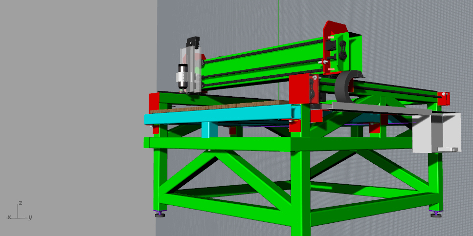

		Nice drawings.
I can't compete with silyavski on the frame design but I did notice the spindle is cantilevered well out, have a look at this diagram where it shows the spindle should ideally be inside the footprint of the bearings at each end of the gantry. http://www.cncroutersource.com/do-it...NC-router.html
		Thanks Eddy. I thought my design was too simple. Now I know why! Thanks for the link. It was extremely helpful in explaining COG and design considerations. Conceptually, I will look to draw the shape of a RHS section at right angles to my gantry to move COG back towards Y axis rails.
I've noticed that a number of designs have placed Y axis screw on top of gantry (my design has it on side of gantry between rails). Placing it on top would help marginally with moving COG back. Is there an inherent preference for placing screw on top? Is my design inferior or not practical?
Tinkerer
 It makes sense to have the screw central to avoid twisting forces, for example mine is central but it's on the back. Sometimes people make a gap between two gantry beams and mount the screw in there.
You have the rails mounted on your gantry front face, moving these to top and bottom would also move the COG back. Things look great on a drawing but when it comes to building it you have to consider how to align everything so it's accurate accros the whole working area. If you go through that setting up stage in your mind, such as how to get the two rails on your gantry ligned up in all planes, then that might help steer the design.

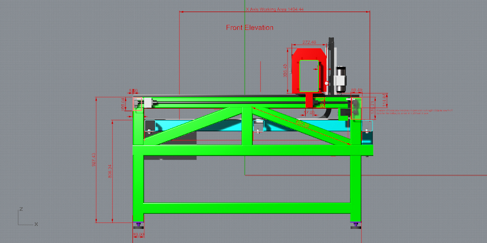

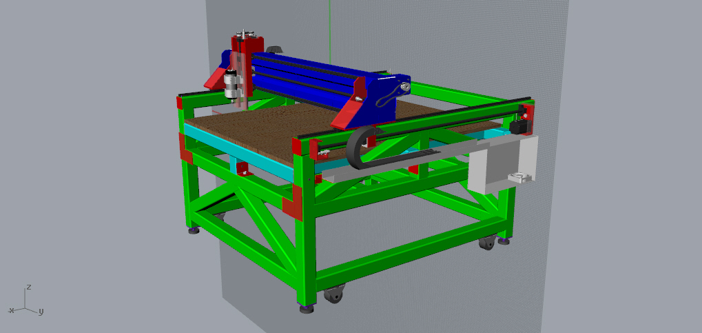

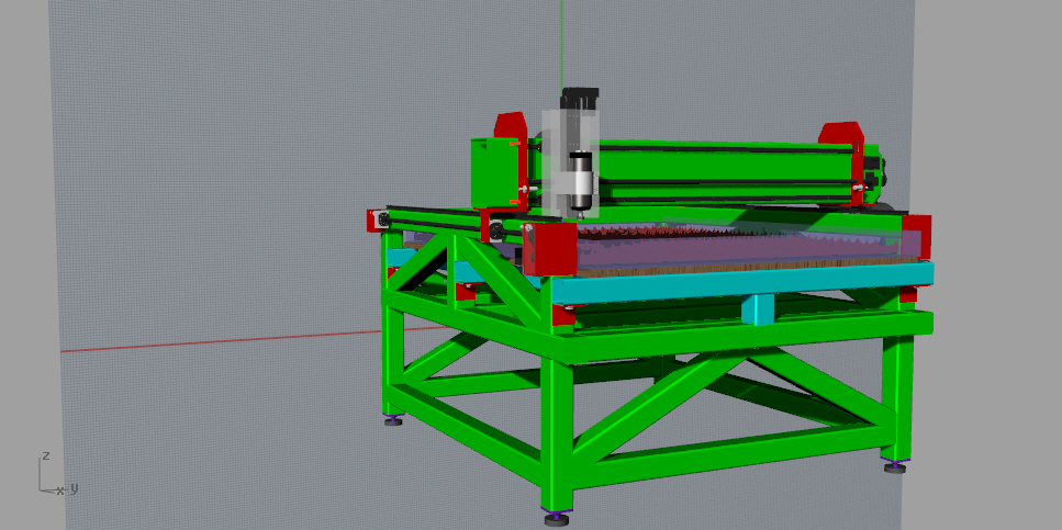

		Hi everyone, I've been off the air, school holidays, etc. I have taken on board comments from Eddy and Silyavski and embarked on a substantial redesign after spending literally days going through numerous design iterations, stiffness calculations, etc. The resulting redesign now has the following inherent features:
1. Frame
Largely unaltered, however, removing cantilever from the Z Axis (thanks Eddy!) required Y axis lengthening one side and reducing on the other.
I have shown inserted bolts for the removable bed. I have used a combination of bolts as well as angle to attempt to remove and play movement when removing and re-installing it.  I've review some other designs on the forum which appear to just use bolts to the side of the frame. I feel these designs would result in a significant shift in the bed from the original leveling. If I can avoid needing to re-level the bed, it would be a major advantage.
http://www.mycncuk.com/attachment.ph...id=13554&stc=1  http://www.mycncuk.com/attachment.ph...id=13556&stc=1 http://www.mycncuk.com/attachment.ph...id=13560&stc=1
As regards the Frame, most material is SHS 89mm, 3.5mm thick. I have gone to 6mm thick on the top where I need to weld brackets for motors, bearings, bolt Rails on X Axis. Can anyone advise whether 6mm is thick enough to directly tap (thread) and bolt bearing supports and rails to it?

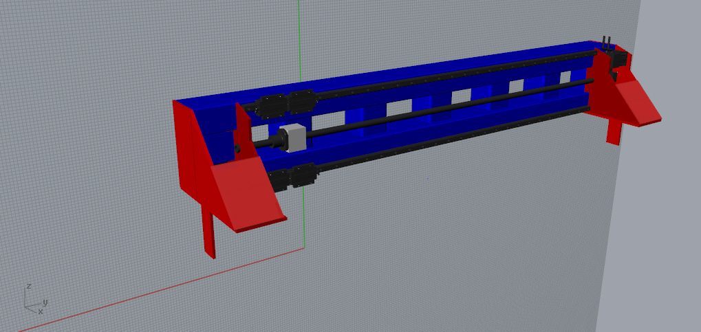

2. Gantry
I was initially wedded to the simplicity and robustness of my RHS Beam - 250 x 150mm. After comments from Silyavski, I recognised the weakness of the extensive cantilever in my design. After several designs (utilising welded steel plates in triangular shapes) to reinforce the Gantry (to remove cantilever), I then had a further look at the RHS beam I was using.
Although the beam was certainly robust enough, I grappled with the issue of the square face, necessitating me installing the ball screw shaft on the same front face (per my original design), thereby increasing the Z Axis overhang / cantilever by about 25mm. I then looked at placing the Y Axis screwball shaft on the top of the Gantry, thereby eradicating the increased Z Axis overhang.  I had considered this in an earlier design, and for all purposes it is a better design (for Z axis), however placing the screwball behind the Y axis rails adds another leverage point, this time, on the Y Rails. I am sure this wold have been fine, but I knew that the ballscrew was better placed between and in line with the Y axis rails to avoid any leverage.
So,  I came to the conclusion many here already know, and that is, my Y Axis Beam needed to be formed (welded) to provision for the Y screwball shaft behind / under the Y rails. Silyavski, I looked at your design and thought there was way too much welding in it (like you I am a relative novice!). I experimented with all manner of available steel materials and eventually came to a close solution to yours. That is, after eventually discounting the following designs largely because of their added weight, with flow on impacts on motors, etc:
Considered Gantry Designs (subsequently discounted)
a. RHS 200 x 150, with 2 RHS 65 x 35 welded to the face to lift Y Rails away from beam (preferred solution as less fiddly/welding/cutting but added another 15kg+)
b. Silyavski design - Two SHS 100 stacked high with smaller welded tube (75 SHS) to create the void for the Y axis. This would (and has) worked well for Silyavski, however I preferred utlising lighter material and therefore reinforced the X direction by utilising RHS (see final solution)
c. 2 x RHS 150 x 100 separated by SHS 75 along the whole length (less cutting/welding). Again too heavy with too much unnecessary continuous length.
My final solution - Utilising 2 x RHS 125 x 100 x 4mm, separated by 7 cut SHS 100 x 4mm  (I have used 9mm for the end SHS separators to give more meat to tap into to bolt the Bearing Supports for screwball shaft).
http://www.mycncuk.com/attachment.ph...id=13557&stc=1 http://www.mycncuk.com/attachment.ph...id=13558&stc=1  http://www.mycncuk.com/attachment.ph...id=13559&stc=1
So Silyavski, I looked at your design and thought I would be able to improve on  it/ create less work for myself. Ultimately, I have no doubt gone through the same process as you, and although I have changed some of the materials, I ultimately came to the same conclusions as you and intend to build a similar design (just not as bomb proof as yours!). Where you have opted for SHS 100 10mm thick, I have gone for 4mm, but increasing thickness to 9mm where bolts are to be fastened. I have used some RHS 125 x 100 x 4mm to strengthen the beam in the X direction due to use of lighter thickness.
You have used 20mm and 12mm plate I think. I have opted for 10 and 8mm plate believing it to be more than adequate. I have checked most against the stiffness calculator and believe there will be relatively little movement below 10um in all cases whilst cutting aluminum.

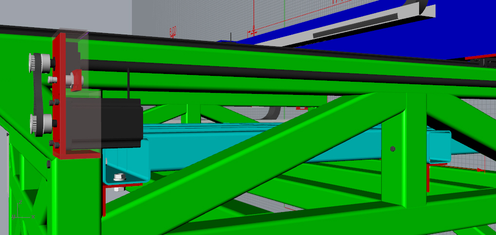

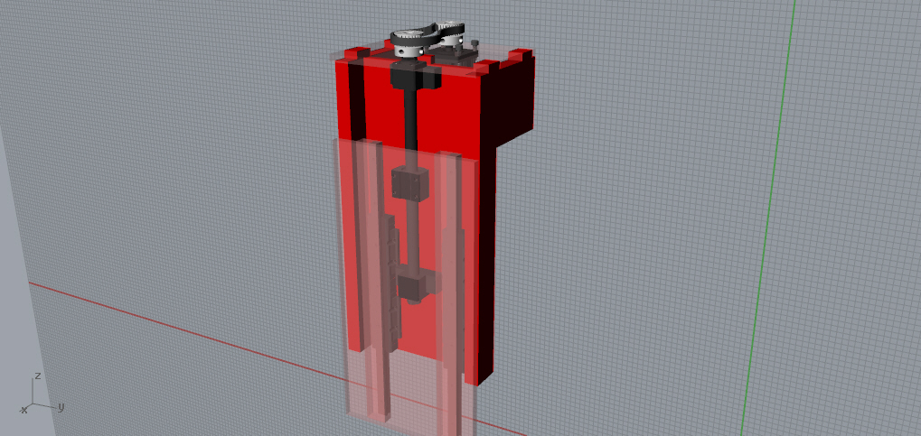

Z Axis
I was looking for a simplistic solution, researched and found actuators which I could largely bolt onto plates, etc. There are a number of Actuators in the market from THK and others and I resolved that they would be able to manufacture a far more accurate product than I could. Feedback from Silyavski caused me to delve into designs a little more thoroughly and yes Silyavski, they are all quite flimsy, using thin walls and I believe would never have withstood cutting forces for a router.
I spent considerable time playing with the stiffness calculator mentioned in my first upload.  To get reasonable accuracy with up to a 100 - 200mm Z axis travel, I have needed to utilise Steel plate with perpendicular reinforcing ranging between thicknesses of 10, 20 and 30mm. I got myself a little challenged with the material stiffness calculator, as its design is really for gantries, but I think I was able to interpret it to apply to the Z Axis.
So with my easy purchase solution ended in tatters (bug.er!), I embarked on more research to understand how Z axis work (I confess to initially glossing over what pieces were attached to each other - I thought I'd get to that once I purchased one!), looking at numerous designs and then designing my own.
So, you will all be somewhat relieved to know that I now fully understand what parts move ( are driven) and are to be fixed to create a working Z axis! That is unless anyone advises me that I have got it all wrong!
Here are views of my design. All steel construction. Yes, more welding and I think I will have to get at least one plate machined.
http://www.mycncuk.com/attachment.ph...id=13566&stc=1 http://www.mycncuk.com/attachment.ph...id=13562&stc=1  http://www.mycncuk.com/attachment.ph...id=13563&stc=1  http://www.mycncuk.com/attachment.ph...id=13564&stc=1
Okay, after many many hours of toil, I lay myself open to criticism/comments from everyone. As I have found out, there is no easy way getting into this build. For me it has all been a big, but enjoyable, learning curve, and all the shortcuts I had hoped to take are not available for good reason. So, in time I expect top be able to provide you all with a few laughs - welding has me a little anxious, as is putting together the electronics. All in the fun I suppose.
As always, I welcome any comments, but I will slash my wrist if I have overlooked something fundamental. This is a time consuming process which has taxed the brain and resulted in many hours of drawing and getting to understand Rhino software (which incidentally is great)!

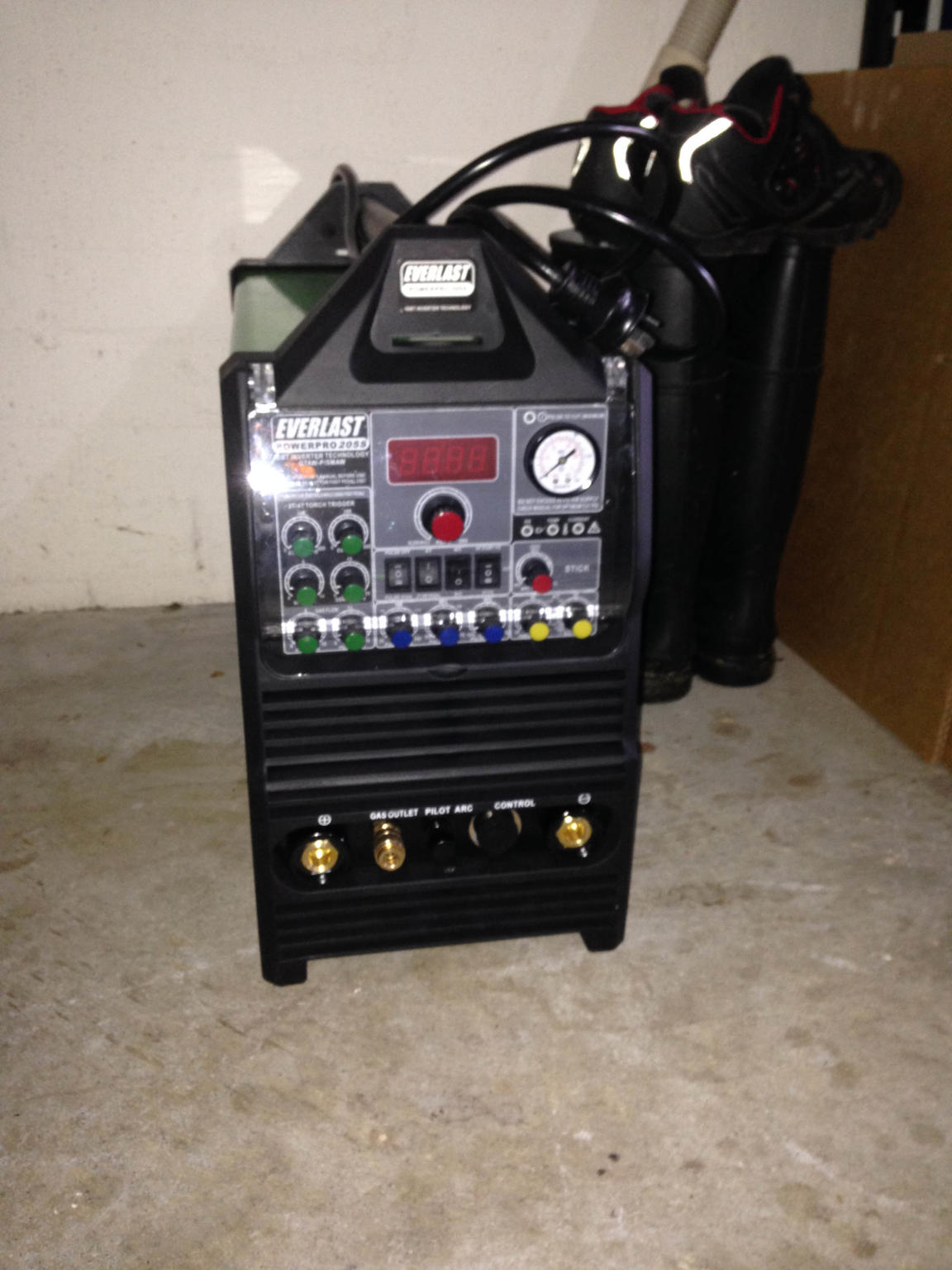

1. Bought my Everlast Welder and purchased (rented) my first bottle of Argon and consumables.

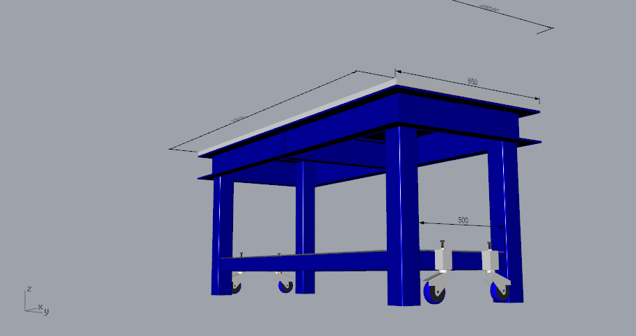

2. Designed my steel workbench, which will be built first to get into a bit of welding practice and to assist in having a good surface to square things etc. I had in mid to utilise this to also act as a stand/ frame for my Router (to minimise workshop space), but eventually dispelled that notion when I realised my 'portable benchtop' router was a little heavier than expected!

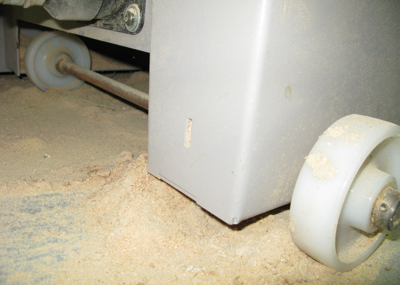

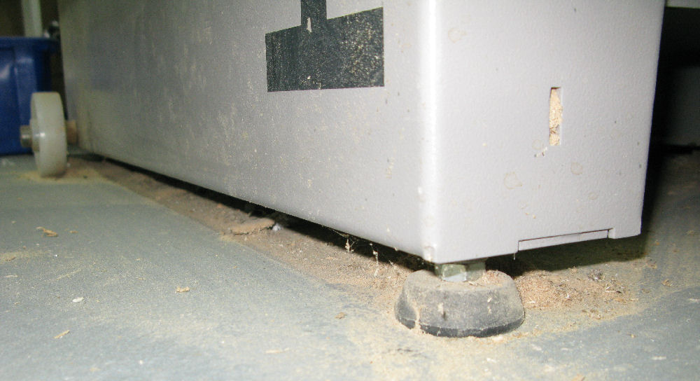

On that note, if anyone has got a good design for attaching raising/lowering wheels so I can move both router and bench around, I would be most appreciative. I have designed wheels utilising an inner and outer SHS, with a bolt,  Contemplated inserting springs which can carry the load when bolt released, with springs compressed (and wheels up) when bolts tightened? Not sure how practical it will be?

5. Portability
Designs or solutions on wheels for moving workbench and router around. Will post bench drawing separately. At my 10 image limit.

2 Attachment(s)
		Pictures of phase I, steel workbench and welder - it looks too clean to use. Will be having a play with welder this weekend.
 http://www.mycncuk.com/attachment.ph...id=13570&stc=1 http://www.mycncuk.com/attachment.ph...id=13571&stc=1

 Thanks Eddy. It looks like a simple solution, but I would not want the machine sitting in wheels all the time for rigidity. I need a simple mechanism to raise and lower the legs or remove them. How do you remove the two rear wheels?

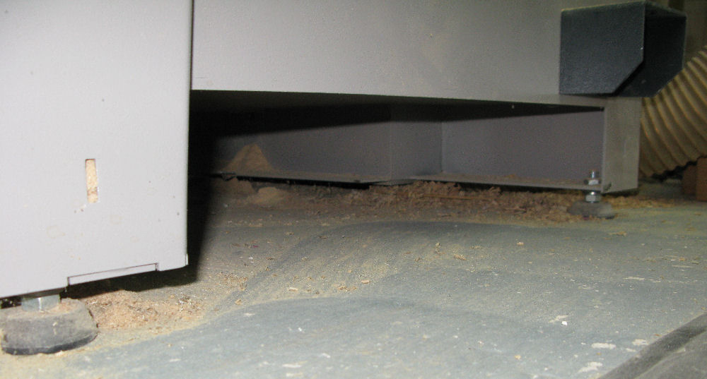

3 Attachment(s)
Tinkerer
 The wheels are solid nylon, they sit on a solid shaft across the back of the machine, there is no movement of any kind when it's sitting down. There are several feet at the front and side and the wheels are positioned such that the machine is level when it is sitting down on the feet, in this position the solid wheels also act as feet because they do not swivel or move sideways, it's rock solid.
Attachment 13599 Attachment 13600 Attachment 13601

Here is another attempt at the pictures. In uploading these, I advise that I have undertaken considerable re-design of a few items (after many days thought) and looking up physical sizes of required components. A summary of changes is given.
1. Gantry
I now have two designs:
A. A design similar to yours (Silyavski) which utilises welded RHS and SHS (per pictures previously posted but not seen),
http://www.mycncuk.com/attachment.ph...id=13603&stc=1
this utlises 125 x 100 x 4mm RHS (top and bottom) and SHS 100 x 4mm (8mm at ends where I intended to bolt bearing supports but now moving towards bolting supports to Red Plates).
Note Y Axis will now be moved to back of Gantry (see below).
and
B. A single bespoke RHS shape, made out of 5mm plate (using 8mm for sides) which utilises key slots and tabs (some refer to this as 'toy slots' resembling construction of early steel toys. Beam is reinforced by two internal welded plates in the structure.
This later design appeals to me as the components fit together for greater accuracy and welds are more focussed. A draftsman friend of mine told me about the significant inaccuracies (twists, etc) inherent in extruded beams (apparently manufacture starts from a round shape which is then forced into a rectangular or square shape?). He works for a large American firm and they apparently fabricate most heavy industrial components (for heavy waste removal trucks etc) out of plate using this method.
I would have to get components for this design laser cut (he says this is relatively inexpensive - he works for a corporate who pays the bills - will see whats this means to a private budget!). Meanwhile I perfected my technique of drawing Toy Slots.
About to investigate the cost, but waiting feedback from my friend and others before doing so.
http://www.mycncuk.com/attachment.ph...id=13604&stc=1
1.1 Gantry Drive (Y Axis)
Well the added weight has forced me to consider NEMA 34 motors. After looking at the increased footprint, I decided that I should mount the motor on the back of the Gantry like some other designs. This would marginally improve COG as well, but not a big issue.
2. X Axis
Larger motors and a more careful look caused me to make some minor modifications to brackets. Silyavski, I compared what you built on your first build, and I have headed towards a similar design.
I also moved the motors to the back of the machine, away from the operator and closer to the control box.
http://www.mycncuk.com/attachment.ph...id=13605&stc=1
3. Z Axis
More or less the same, but I have also included 'toy slots' to facilitate easier fabrication/more accurate assembly.
http://www.mycncuk.com/attachment.ph...id=13606&stc=1
This design is all steel and requires laser cutting/ machining. The front plate carrying the Rails has 2 of 20mm x 20mm support beams to provide rigidity with the balance of the face plate 10mm. The side plates are constructed of 20mm plate. All 'Toy slotted' and welded. Top plate 10mm thick.
Using the Siffness calculator I believe this will give me a reasonable stiff structure with deflection below 20um in various directions cutting aluminum. I think! It certainly has added to the weight of a purchased actuator which is now a scrapped notion due to their weak structures.
Happy to listen to any views how to do this differently.
Perspective View of Machine
http://www.mycncuk.com/attachment.ph...id=13607&stc=1
Hopefully these pics are now viewable (I know I got close to the limit last time I posted them and perhaps why they did not appear?). Please let me know if problem persists!
If anyone can consider these with questions posed in my post of #16, I would be very grateful.
One additional question is to do with attachment of support bearings. As mentioned above, I am leaning towards bolting the supports to the plates at the end of the shafts, rather than to the side of the frame/gantry. My rationale is I can control spacing easier (or perhaps not), and that plates offer a flatter, 8mm surface to bolt to. What is the preference/others' experience?
Pictures look good I'm told. Proof of competency will be the building of it! :acne:
Richard
