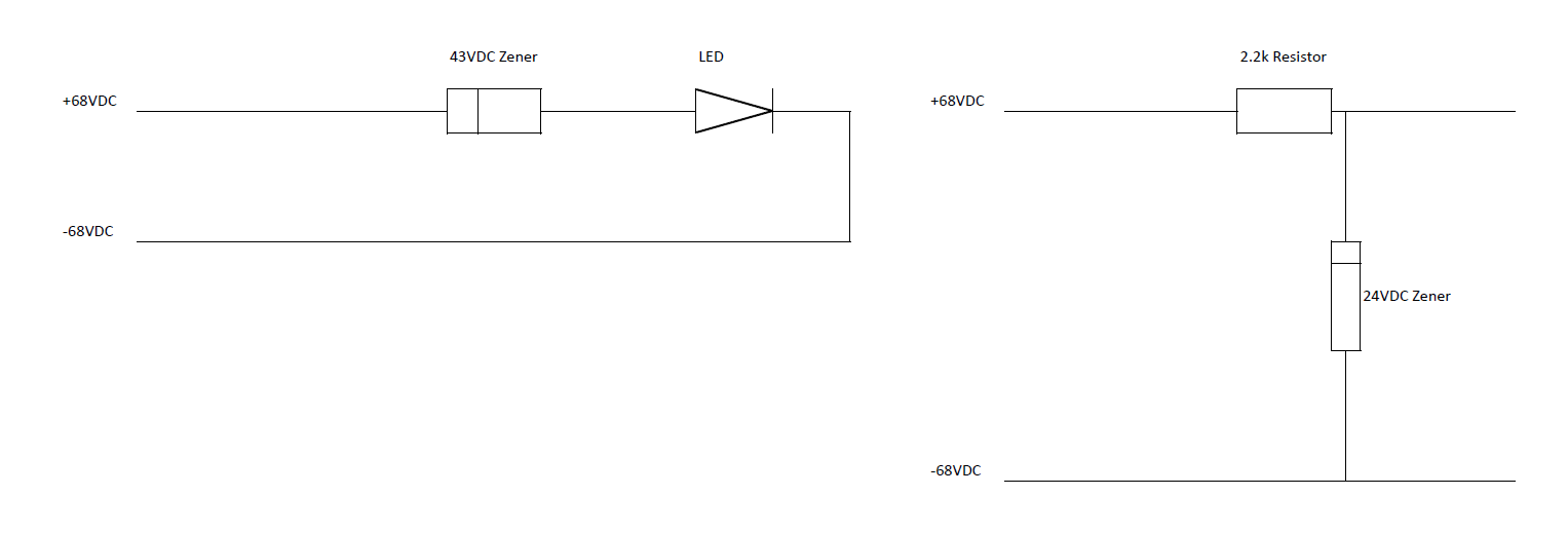

This might be daft but I'm trying to wire two LED indicators (http://www.farnell.com/datasheets/629825.pdf) and I'm struggling a bit. I've got one which is 230VAC, this is pretty easy as it's simply just wires directly into a 230VAC source, which in my case powers an SPS705 68VDC PSU. The other one was supposed to be used as a DC 'power on' indicator for the 68VDC PSU, so I wanted to wire the 68VDC into a 24VDC version of the indicator. This is what's proving tricky as the voltage is plenty to just dissipate over a resistor. Any ideas on what can be done to drop the 68VDC to 24VDC so it's safe to use on the 24VDC LED indicator?

Well a series resistor could be used.. 68-24 = 44v @ 20mA = 44/.02 = 2200ohm and 44 * .02 = 0.88W so need a 2200ohm, 2W resistor.
Alternatively could use a 43v zener diode like this which might actually be cheaper since can be bought 1 off whereas resistors generally need to be bought 10 off. When using the zener the end with the band goes to the + side of the supply. Get it the wrong way round and both zener and LED will fry faster than you can say magic smoke!
For heat dissipation purposes the zener should ideally be mounted on a bit of single sided circuit board approx. 60mm x 30mm. Make a single 2mm cut across the copper 40mm from one end to create two electrically separate areas. Form the leaas of the zener so it sits flat and solder the lead from the banded end to the larger area, keeping the lead full length. the body of the zener should just straddle the cut. Solder the other lead to the smaller area. If possible mount the board vertically to aid convection.

These usually take between 12mA and 20mA, as you say a series resistor would do.
Say it's 12mA
R=V/I
(68-24)/0.012 = 3.7 k ohms
watts = IxIxR = 0.54 watts
Say it's 20mA
R=V/I
(68-24)/0.02 = 2.2 k ohms
watts = IxIxR = 0.8 watts
So I'd start with a 3.7k 5watt resistor and measure the voltage across the lamp, if it's too low then try a lower value resistor.
Ah ha, Irving just beat me to it :encouragement: I chose 5 watts having come through the 'brick shit-house' school of engineering.

Irving, good idea using zener but should the connection go like this ?
supply +ve to lamp +ve
banded end of zener to lamp -ve
plain end of zener to supply -ve

I thought there's two ways:
http://www.mycncuk.com/attachment.ph...id=13490&stc=1
I might be wrong though:)
T.

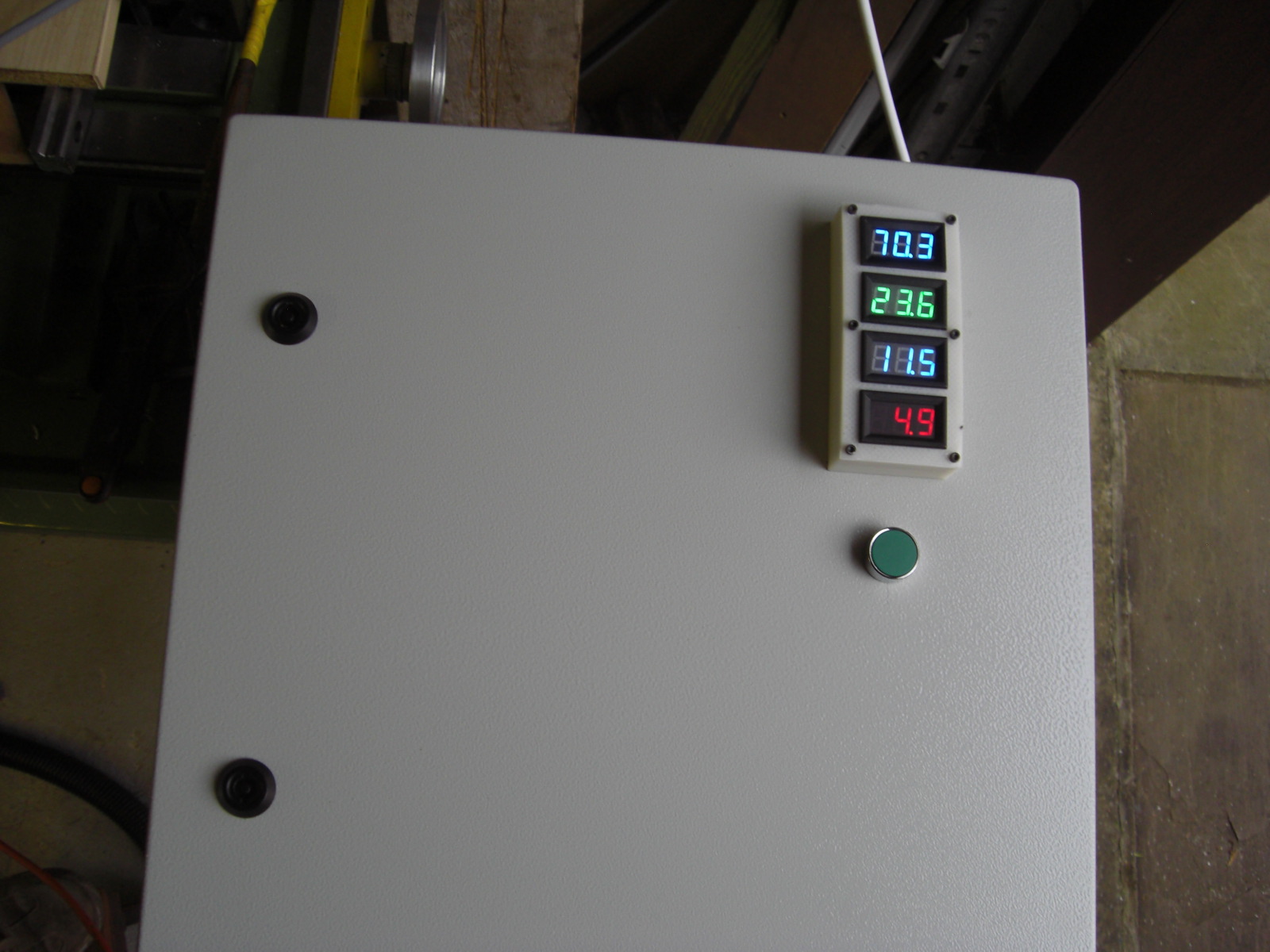

Or you could use one of these:- http://www.amazon.co.uk/99-9V-Digita.../dp/B008KXMNTU ..Clive
T.
Umm.. the first way is correct - the resistor and zener are interchangeable in this diagram, just different ways to drop the volts.
The second is unnecessary as uses two components when one will do. LED doesn't need regulated supply so the zener is unnecessary.

Originally Posted by Clive S
You could, but a pain to mount, unless you're CNC'ing the panel and overkill :lol:
Re: daft question on LED indicators and high VDC
Mount like thishttp://www.mycncuk.com/attachment.ph...id=13491&stc=1 ..Clive
irving2008
The second provides a solid voltage on the zener regardless of the load, which is different to a standard resistor divider. I'll go with the first one, it's 36p for the Zener vs. 9p for a resistor but as you said before minimum order quantity is 10 (doesn't really matter as I need to go over £5 for the order anyway).
Those 7seg displays are pretty neat considering the voltage range on them. I'll have to stick with a small LED indicator as I'm tight on space as it is.

Just a quick update, I've tried both the resistor and the diode, both get rather hot, although the diode seems to handle it better. Done some checks with a TC and the resistor sits at around 80degC whereas the diode goes up to around 60deg. The ideal solution would be to change the PSU to a 48VDC, but with the current solution costing less than a pound I don't think I'll bother:)
T.
Did you mount diode on a bit of board as I suggested? It's running a little hotter than I calculated. Junction temperature will be around 120 degC, still less than the maximum allowed of 150 degC, but 20 degC more than I'd like.

I've made a small PCB 62mm x 40mm, it's got a larger section of copper on the banded area, roughly 38mm x 40mm. Just ran some tests and it levels at around 56degC, so better than before, but not massively.
I do like the NUD chip, the issue is it's SMD (can't solder those) and for 68VDC and a single LED it's over it's power limit anyway. I guess I might have to get that 48W PSU anyway...

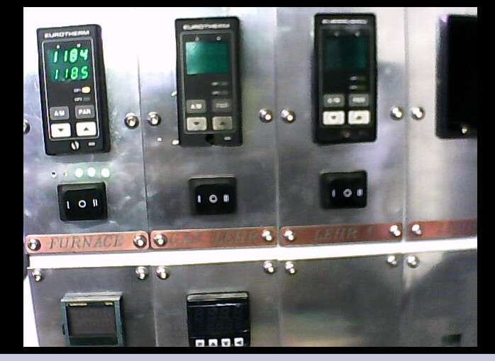

I have just made and installed a control panel for a glass blower friend. The labels for the modules are fibreglass circuit board. If you put LEDs behind them the lettering shines though beautifully. Next phase of project ??? I might even go full steampunk. maroon and green with gold striping and ornate Ibis carvings in the blank areas of the panels and , of course I would have to change the stainless metric button head screws to whitworth bronze slothead.
http://www.mycncuk.com/attachment.ph...id=13619&stc=1
The picture btw is a screenshot of an IP camera set up to view the panel from anywhere.
