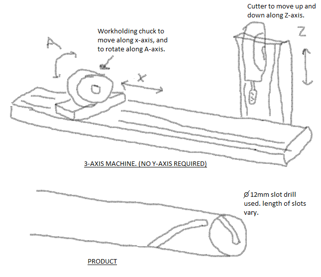

I will try and draw something up to explain it better. Im sure we could all understand a few drawings :smug:
Re: Need expert guidance on rookie DIY build.
http://www.mycncuk.com/attachment.ph...id=13602&stc=1
Apologies for the very basic drawing using MS Paint. But it should show what I have in mind regarding the machine, and what is required for the product.

Plasma is what you need. The forces to cut steel, even with Slot drill are much more than you probably realise if your suggesting to use Dremel type spindle.
The spindle will need to be slow spinning with plenty of torque. The Milling head will need to be very strong and clamp the pipe tight to handle the forces involved.
While Plasma cutter will cost more than spindle the cycle times for jobs will be much faster if you used plasma and the overall machine strength can be lot less as there are no cutting forces involved saving money on the build. These two things alone will outway the expense and pay back down the line.
No brainer to me Plasma is the way to do this.! . . . . . Just look around every machine doing this job uses Plasma or Laser.!!!
I agree with Jazz. With a slot drill you'll need a couple of fixed steadies either side of the cutter and you would have to traverse a 6m bed, to machine a 3m length, which would have to be extremely rigid over its full length.
With plasma the work holding is much simpler, the workpiece is static in X supported on some v-rollers which are easy to fabricate, the lightweight plasma head moves in X along a 3m rail, probably using rack and pinion drive, so relatively easy and cheap to build.

Righteo. Yous are the boys with the experience, so I will take heed.
So my machine will still need to be 3 axis, right?
I do recognise that practically every other pipe profiling machine out there uses a plasma or laser. But as I am a rookie in this field I was simply making an assumption based on.. well nothing really.
So plasma it is.
What is the cheapest plasma cutter available, capable of cutting 5mm mild steel?
