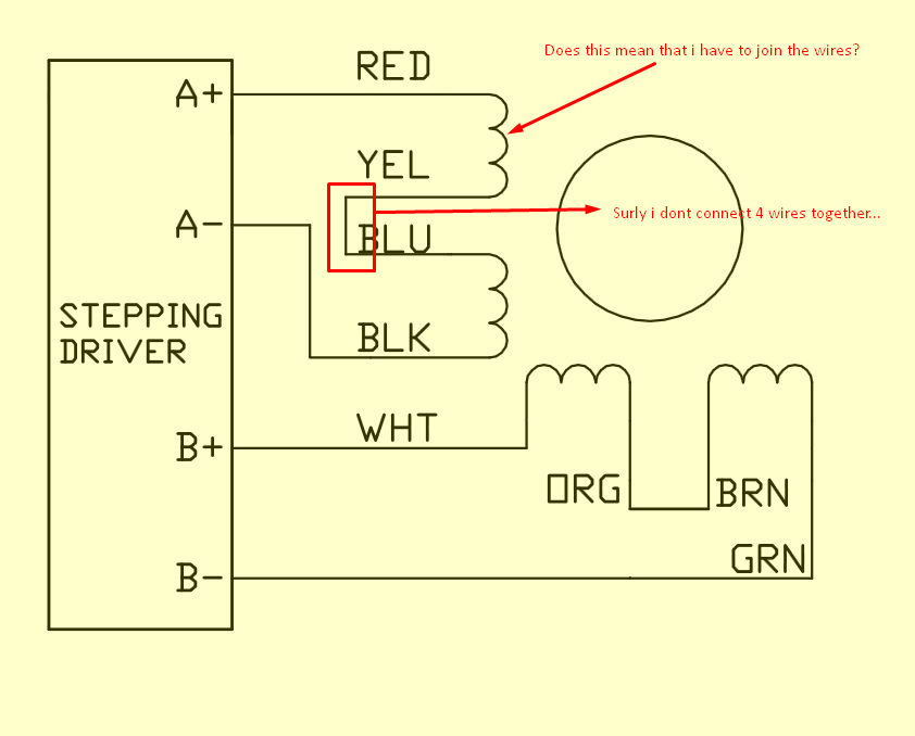

I normally have a good friend of mine building my control boxes so ive never had the chance to see how its done. my question is to you good guys how the hell do i wire these things up, or more importantly can you explain the diagram for me?
Could someone please explain the attached image please so i can try crack this once and for all ..
Driver : PM452
Motor : Plantry gearbox with CNC4you - 60BYGH301B
Please guys before you sit back in your chair and snigger about my question please consider we were all here at one point - maybe some of us more clued up than others :hysterical::hysterical::hysterical:
http://www.mycncuk.com/attachment.ph...id=13646&stc=1

Hey d-man, those curly bits are the windings of the stepper motor. So from your pic you would join the YEL and BLU together and the ORG and BRN. Then run the remaining 4 to your stepper driver.
I'm sure someone who has a clue what they are talking about will be along shortly with better info so best you wait for them!
Jim

however my current setup runs 4 pins and this one will work out as 6, or are you saying that the joined wires dont go to anything which would result in 4 pins :)

Are you sure you want to use that way to connect the motor ? that's a series connection, most would recommend the parallel connection.
A+ Red
A- Black
B+ White
B- Green
Yellow & Blue, connected together but going nowhere, just insulate once joined.
Orange & Brown, connected together but going nowhere, just insulate once joined.

Well it was just to try get my head around it Eddie, then i looked at the parallel connection and started to smell smoke (From my brain!) Parallel connection here http://prntscr.com/4wyek3
Cheers for that Eddie appreciate it

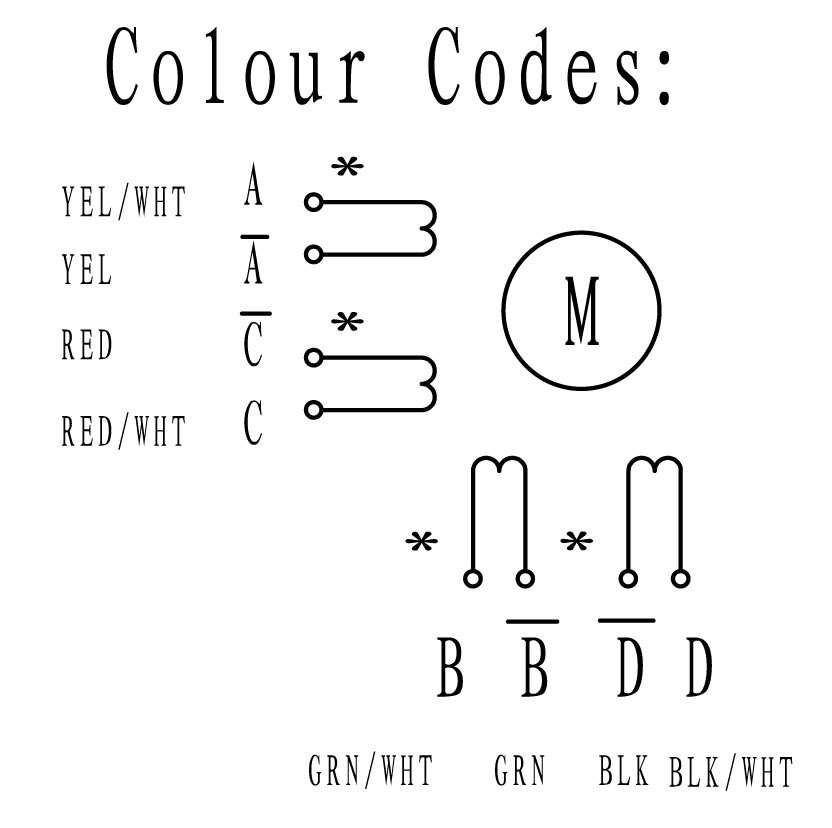

Im using the MSD542 drivers with the Nema 23 SY60
Motor diagram looks like this...
http://www.mycncuk.com/attachment.ph...id=13648&stc=1
However the Driver datasheed does not give colour codes http://www.motioncontrolproducts.com...ing-driver.pdf
I have the wires joined, its just getting the 4 coupled wires into the A+ A- & B+ B- if you know what i mean.. how do you determine what double wire is for where

A+ yellow/white & red
A- yellow & red/white
B+ green/white & black
B- green & black/white
see diagram on page 7 for parallel 8 wire connection
http://www.leadshine.com/UploadFile/Down/AM882m.pdf

No, it was just a diagram I knew about, it's the motor drawing that matters.

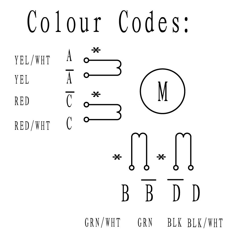

Using the standard diagram;
Attachment 13681
For any colour scheme with parallel connections use this; (I've just used -A etc. to represent A with a bar on top (not A))
A+ (A to -C )
A- (-A to C )
B+ (B to -D)
B- (-B to D)

Using the diagram above
Parallel
A+ (Yellow/White to Red)
A- (Yellow to Red/White)
B+ (Green/White to Black)
B- (Green to Black/White)
Series
A+ (Yellow/White)
A- (Red/White)
B+ (Green/White)
B- (Black/White)
(Yellow to Red) not connected to any terminal, just connect together and insulate.
(Green to Black)not connected to any terminal, just connect together and insulate.
Re: Wiring a motor - as a newbie!
Ok so when in parallel you pair the 8 wires (4pairs)accordingly and then they would go strait to the terminals on the driver were as in series you just have 4 of them paired (2pairs) and the other 4 go to the driver?
