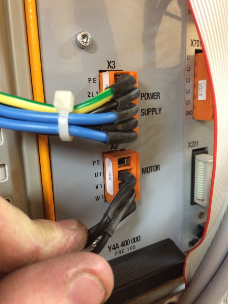

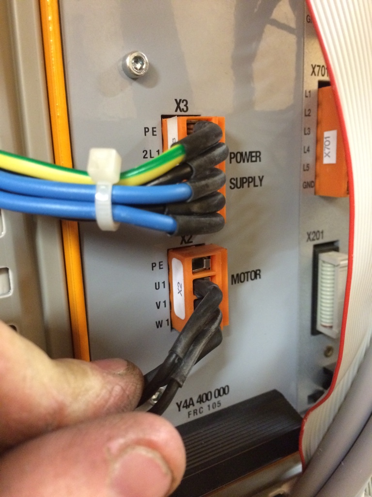

Thanks for reply, i can install steppers fairly easily and the other electronics, my main problem is making sure i have everything wired corectly plus my big problem is how to run the spindle with speed controll, i have no idea what i need or how i need to do this, the kit i have bought is a digital stepper setup with all the bells and whistles , BOB etc from CNC4U, ideally i am looking for someone to help hands on with the conversion as i am a bit out of my league and dont want to blow anything up

Is there any info on the net regarding the electrics of your machine as it is now ?
Re: Emco pc mill 55 upgrade
The machine kind if works now as i bought it with pc an a fanuc control but its all very dated and possibly problematic if there are problems now or in the future so iv opted to retrofit with all new internal electronics and druves so i can use standardised software etc, but, i am very limited in my knowledge of all this so "here i am" [emoji4]
Ideally im looking for someone locally to me, midlands, who i could pay to come and help out/advise etc as a wrongly wired up anything could be costly

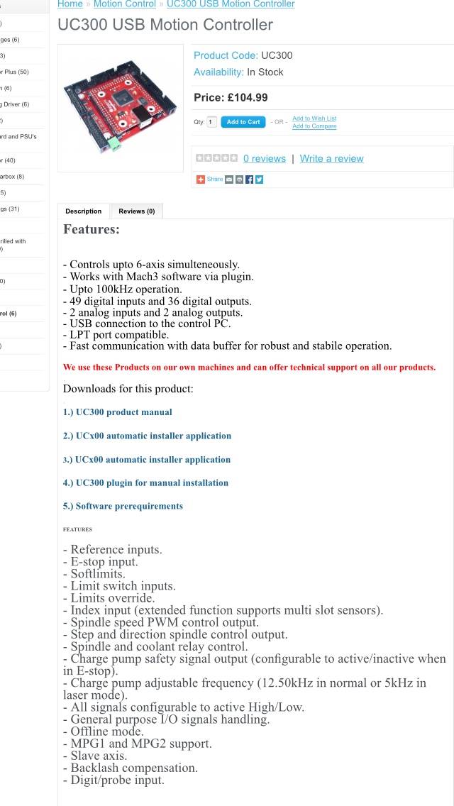

Yes a vfd would be required, I got this from a UC300 manual, this would be ideal because the easiest way to control the vfd is via the 0-10v.
"The analog output 1. signal can be used for SP PWM (Spindle speed PWM), setting the
SP PWM checkbox assigns the analog output 1. signal to the spindle speed PWM
function. If this checkbox is set the proportional analog Voltage of the actual spindle speed
PWM signal will appear on this analog output pin of the device. The range of the signal is
0-10Volts"

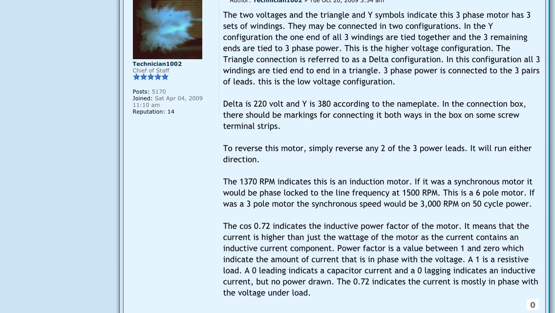

You do need to know the parameters of the motor such as voltage, current, etc. can you get a photo of the motor rating plate ?
Wish i understood the terminology lol [emoji15]but ill get there, took a pic of motor plate for you if it helps, where about are you located ?

Here's some vfd's as example; https://www.inverterdrive.com/group/...r=Power|0.37kW
The max revs shows 1370 RPM so as not to take it past it's working range that should be about the maximum speed to run it at and that's at 50Hz.
The problem is that reducing the speed will also reduce the power so there's a limit to how slow it will usefully operate at.
The vfd needs to be like this;
Input 230V ac single phase
Output 230V ac 3 phase
Power 0.37 kW (minimum)

Hello all again, i am at my whits end with the cnc project i started, everything i can do via wiring diagrams and advice is done but still nothing works, i need help as all i have at the moment is a very very expensive paperwight, i am more than willing to pay for someone to come take a look and give me some help

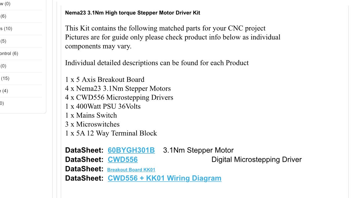

Jazzcnc, my mill is an Emco pcmill55 and its a cnc4you digital stepper kit plus a uc300 motion controller board , http://www.cnc4you.co.uk/CNC-Kits/Di...3.1Nm-x-4-Axis, i wired it up to the diagrams as far as i can figure, i have fitted and powered up a jaguar vfd but not wired into bob as i dont know how to, i have a demo copy of mach3 on an older windows xp pc, it is all connected up as i think it should be but when i try to move steppers via mach3 nothin happens, im guessin i have somethin wrong in software but as i am a complete novice to this an there isn't any real instructions to these things i have hit the wall now and need some assistance from a pro, inwill take pictures and post them for all as to assist future builds etc, where abouts are you based ?

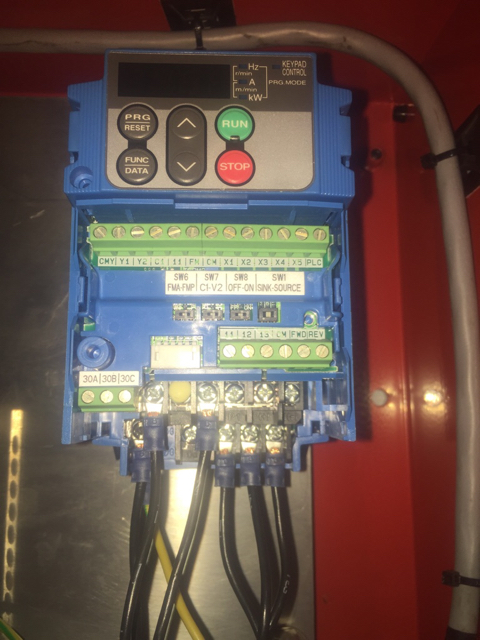

Vfd is a 0.4kw jaguar cub VXR
I have downloaded full instructions but as with the cnc stuff i dont understand the tekno speak

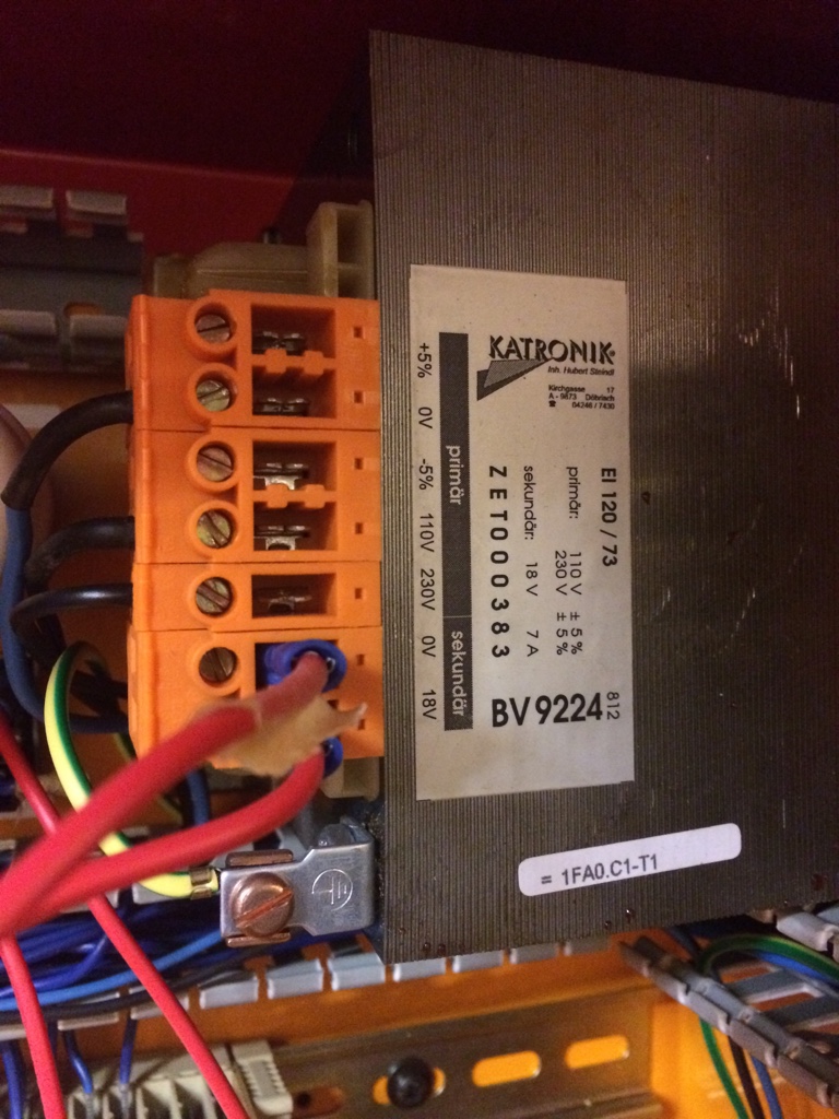

10 Attachment(s)

Ok Craig well I know we are speaking via phone which isn't a problem but for the sake of others I'm going to post here as well.
So looking at the pics and speaking to you i'm confident you have it wired correctly. So this will 99% just be a setup issue.
This could be 2 second fix and soooooooo simple you'll scream.!!Lol (Or 5min and you'll still scream)
I'm going to presume you have setup the Motor output pins and Input pins in Mach3 as per Cnc4you instructions.
This could be 2 things that are the same really.! Your E-stop should be NC switch type so this would mean the Input the Active state would be Low.
To Mach this means if NO voltage on that pin then E-stop machine ie E-stop active when pin voltage goes LOW(zero). You have NC switches so the circuit should complete voltage will flow and all be well provided you set the correct pins. (Check the E-stop isn't pressed. .Doh!!)
Now if Mach3 is in charge of the inputs then the thing that could stop Mach3 resetting is if the active Low setting is wrong. In this case it would be correct if showing the (x) meaning Active when Low. If it's ticked then this is your problem. 2 sec Fix.!!! . . . . . . . . .Now take a deep breath and try.! . . .Then scream.!!
But I think the UC300 plug-in could be in charge of inputs here and it's Active State is reversed (Active High) and when it see's Voltage it's saying to Mach E-stop.!
Easy way to tell is push the E-stop button and Mach should reset as the Uc300 pin will go LOW.
In which case you'll have to go into the Plug-in settings and change the Pin state to Active LOW.
So first quick test to see who's in charge of inputs mach or UC300 push e-stop and try resetting mach. If no joy then check the Active state of the E-stop pin in mach3 inputs. No matter which state, Ticked or unticked, toggle it to opposite and try reset again.
If none of these then we'll look deeper.!
