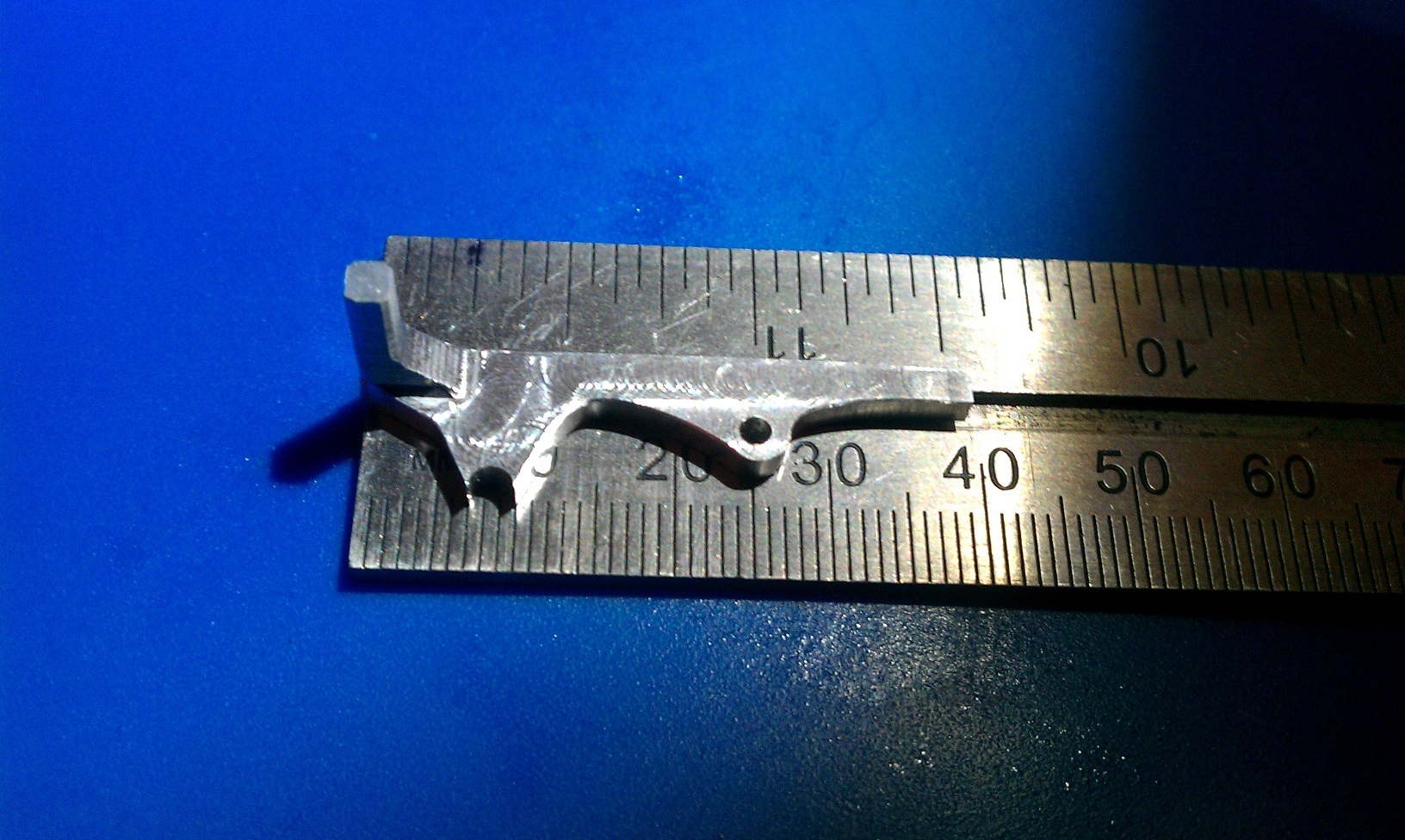

Yep I can and you where in luck today as I had to setup a machine so you gave me something to do. Here it is.! Pm me your address and I'll send it you.
Only differences are there are some 1.5mm radius in corners as smallest endmil I had was 3mm.
Attachment 13857

For anybody who wondered how or what went into doing it then here is the simulation. Never thought to do video.!!
Not much too it really 7 operations with 4 tools. Total machine time with tool changes and filp 16mins and 6 tool simulation time 11mins.
OP 1 & 2 clearence with 6mm endmill.
OP 3 holes with 2mm drill
OP 4 & 5 Ramp & hole pocket with 2mm ballnose used to clean up holes.
OP 6 profile 4mm endmill
OP 7 flip and 0,35mm surface to break loose with 4mm tool.

To be honest Geoffrey I like the change from doing boring run if the mill Z axis and gantry parts etc i'm always doing. Small parts I find rewarding and challenging because they are hard to hold with very little room for error. Worst bit is tool changes can take longer than the Op's it's here where a ATC would be nice. . .Lol

Just got the parts last night (two identical), but unfortunatley, my design skills have let me down and the part needs a little adjusting... Time to break out the dremel! :p
Once i fix the part and test it, ill adjust the design and re post it in case anyone else wants to use it to make their own.
Big thanks to Jazz for forseeing my stupidity and sending a spare :p
