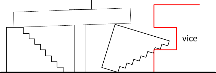

I need some advice on how to clamp my vice to my milling table.
I bought a "Precision Tool Vice Type 2" from Arc Euro Trade for my little milling machine and eventually got a clamping kit to go with. Links for vice and clamps (24 pc kit). Sadly the hold down clamps they sell are for the smaller vices.
My first thought that was I should use the clamping bars to fit in-between the grooves that run up the side of the vice but when the clapping kit arrived I realised the clamping bars that come with the kit are too fat to fit in the groves. I phoned Arc to ask and they said to just use the bolts and t nuts to hold the vice to the table.
Its take me a while to find some free time to have a look, but as I suspected this is completely impractical... the bolts are also too fat to fit in the groves properly and to get them to make any sort of contact they need to go in at an angle. When I try to tighten them they just slip right off the vice. Maybe I misunderstood them and if so does anyone have any suggestions on how to actually hold this vice down? I wonder why this vice does't have a break in the groves so that the bolt can pass through and then bolt down that way... every other vice does!
Picture attached at my attempt to do what Arc was saying... Any help much appreciated.
David.

Deff don't clamp the way you are, not practical has you no.
Can you mill your own slots in the vise, make your own clamps out of some plate and machine to suit the vice. Or mill the kit you bought to fit the vice, prob only need a few mm machining of the top to fit in the vices slot.

What you propose is essentially what mechanik suggested, make your own clamp plates patterned on the ones you already have, out of 10mm plate milled down to 9.5mm at one end. Personally I wouldn't go to the trouble of making hold down blocks.

I emailed Arc to see what they said and they were kind enough to give me a call to try and explain their solution involving the stepped angle blocks from the kit. To be honest I didn't understand what they were saying. I would happily recommend Arc to someone. They seem like good people who don't mind giving advice over the phone and their stuff is very well priced, but I got the feeling that although there maybe some way of using the kit, I'm not sure if its a particularly good one. They did suggest that I could mill my own clamps at one point - chicken and egg type situation, a little frustrating - can't make something like that until I have a vice that clamps down!

To be honest the clamp shown in the photo you provided is a far better option and just needs on hole drilling in a piece of plate that can be done on a pillar drill. The type i described are so easy to make also, i have 4 that i use in conjunction with various lengths of stud iron to clamp stuff to my lathe cross slide when jig drilling holes ect, pack the ends with some coventry die chasers.

You could use a stepped block, I'd hazard a guess they were suggesting something like this, though you'd need to experiment and you may need something under the back edge of the upturned stepped block to force it to rotate down onto the vice.
http://www.mycncuk.com/attachment.ph...id=13889&stc=1

You don't use the stepped blocks like that, you would just use the one on the end set to the appropriate step height.

Just thought i would add before i get corrected, re stepped packing blocks.
they are actually designed to be used as a pair leaving you with a parallel surface to clamp off and so they are usually used on tall jobbies so are not really suitable for your application, was not being pedantic.

Sticking with what you've got, you could grind/machine down the top side of the end of the clamp fingers so they fit in the vice groove. The grinding/machining doesn't have to be pretty, as long as the underside is still flat.
As a temp fix, get some longer bolts and use the clamp set to clamp on the top of the vice, be that either on top of the jaw(s) and/or on the top of the main body provided there is enough room behind the moving jaw.

Yes I know, I wouldn't use them like that either, I'd have just made some new dogs out of 10mm plate. I was trying to second guess what arc had suggested to the OP!
