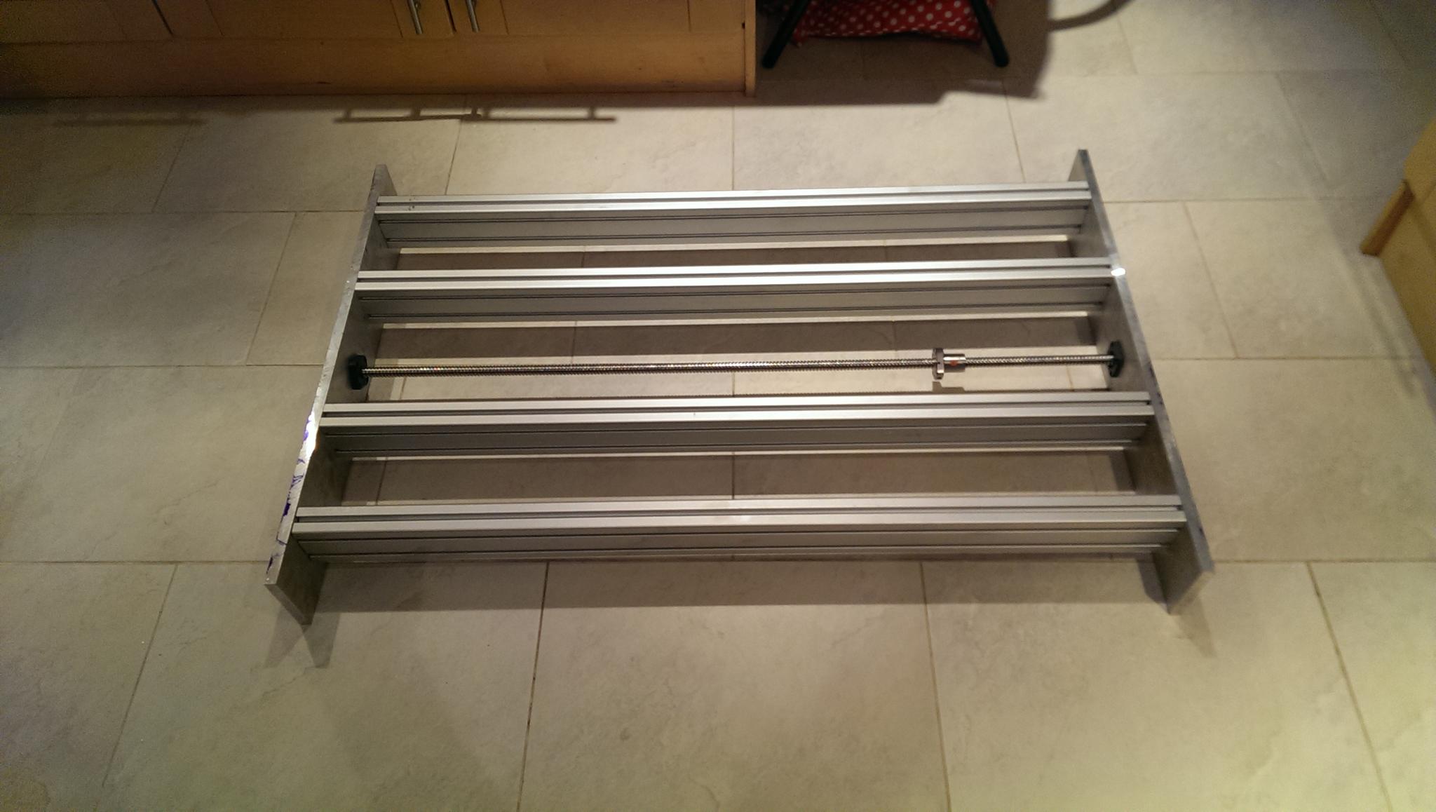

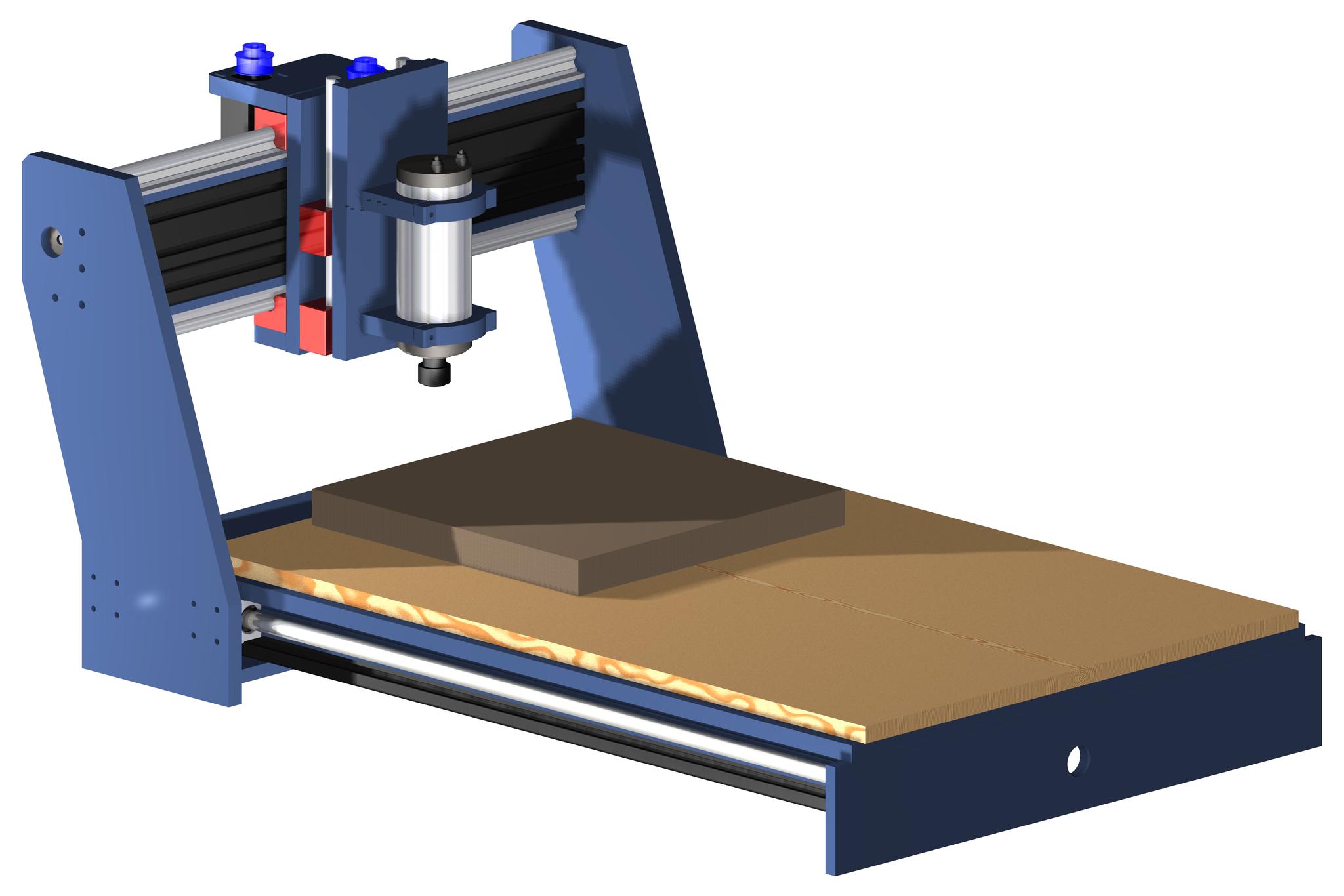

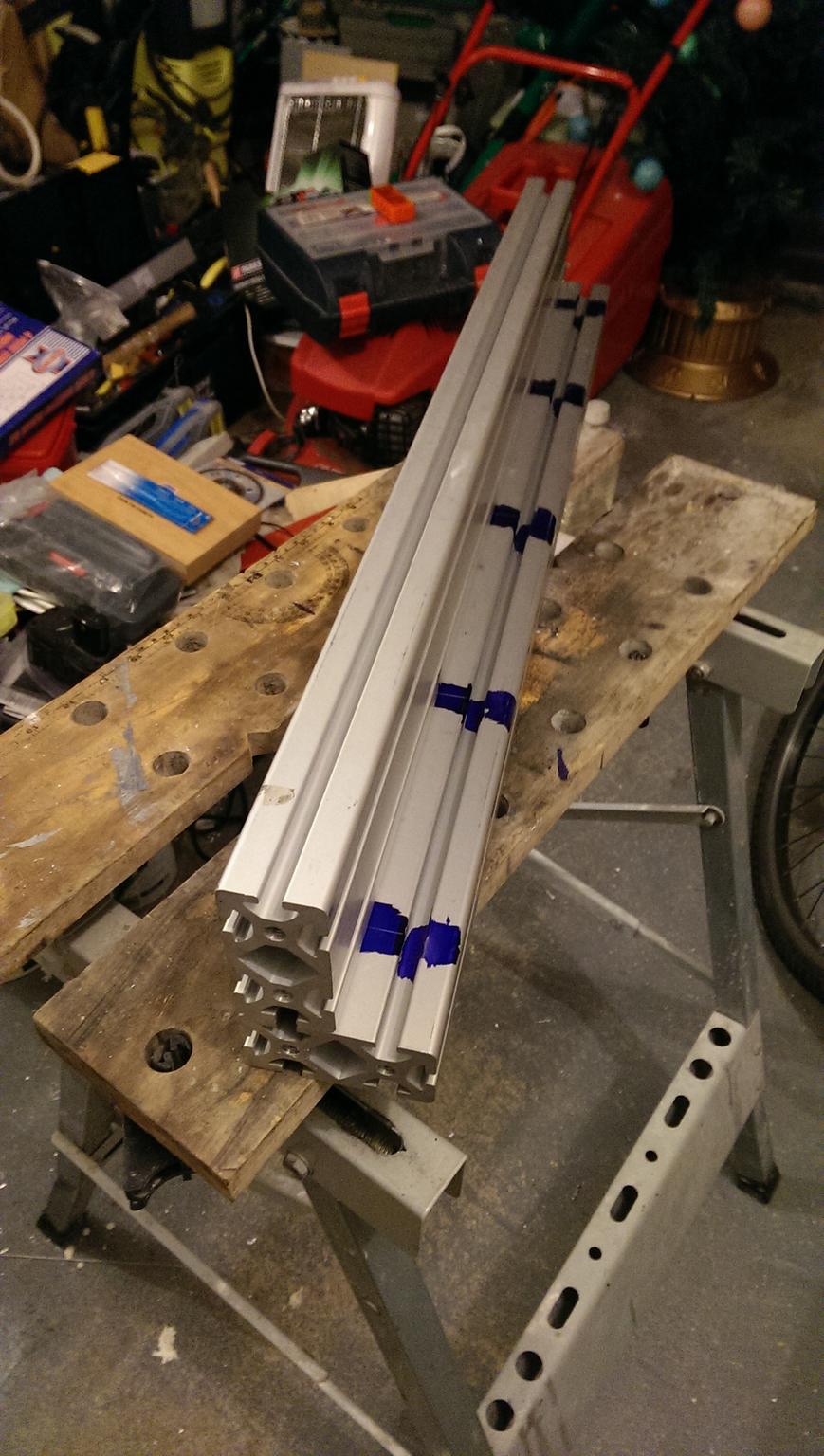

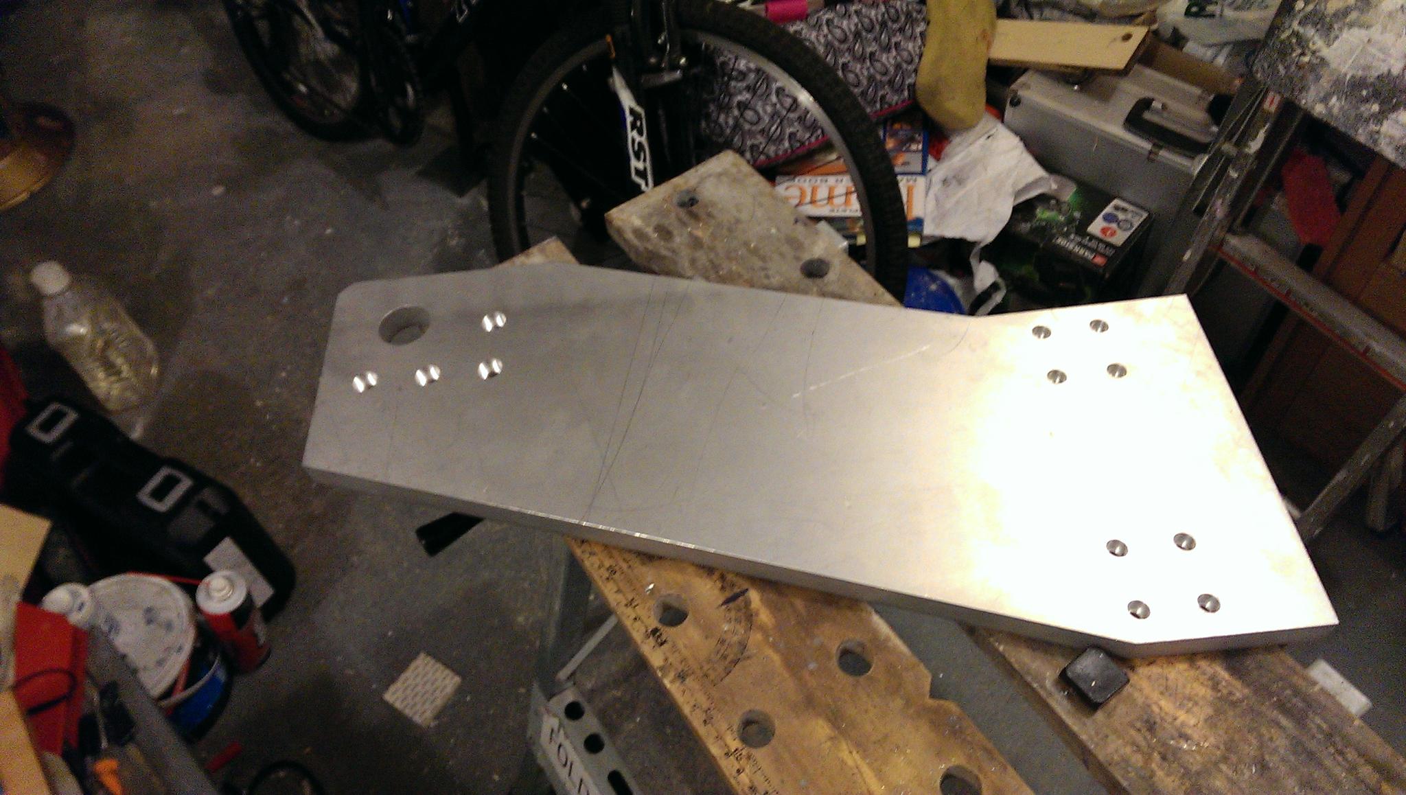

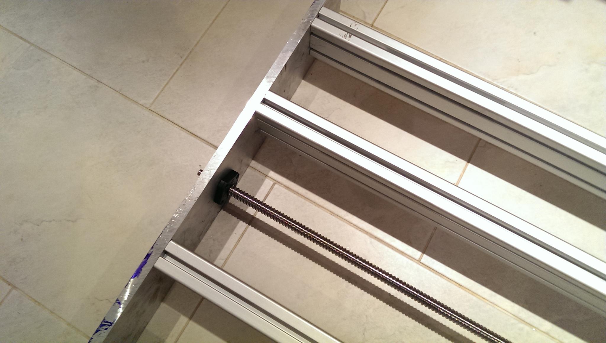

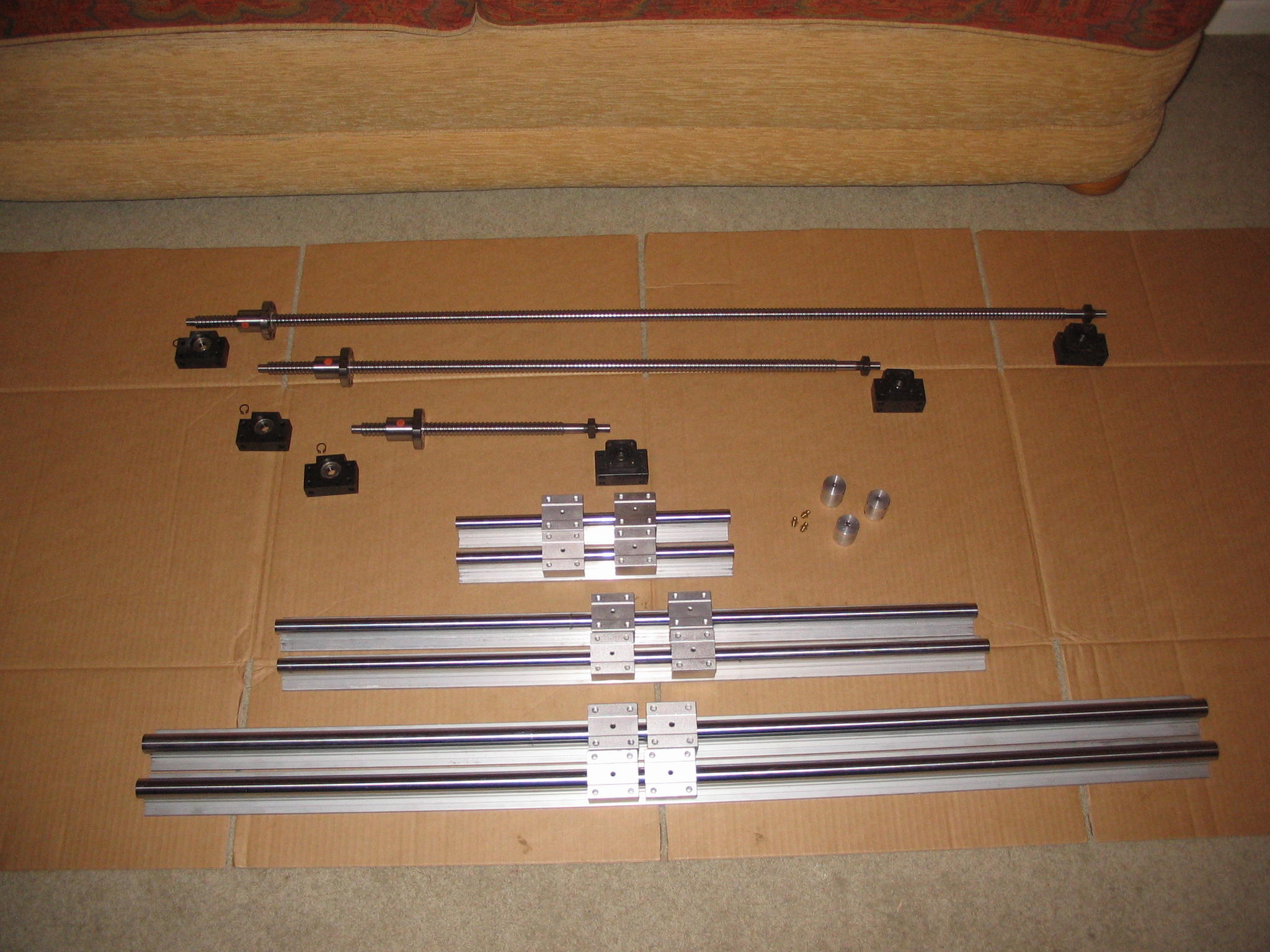

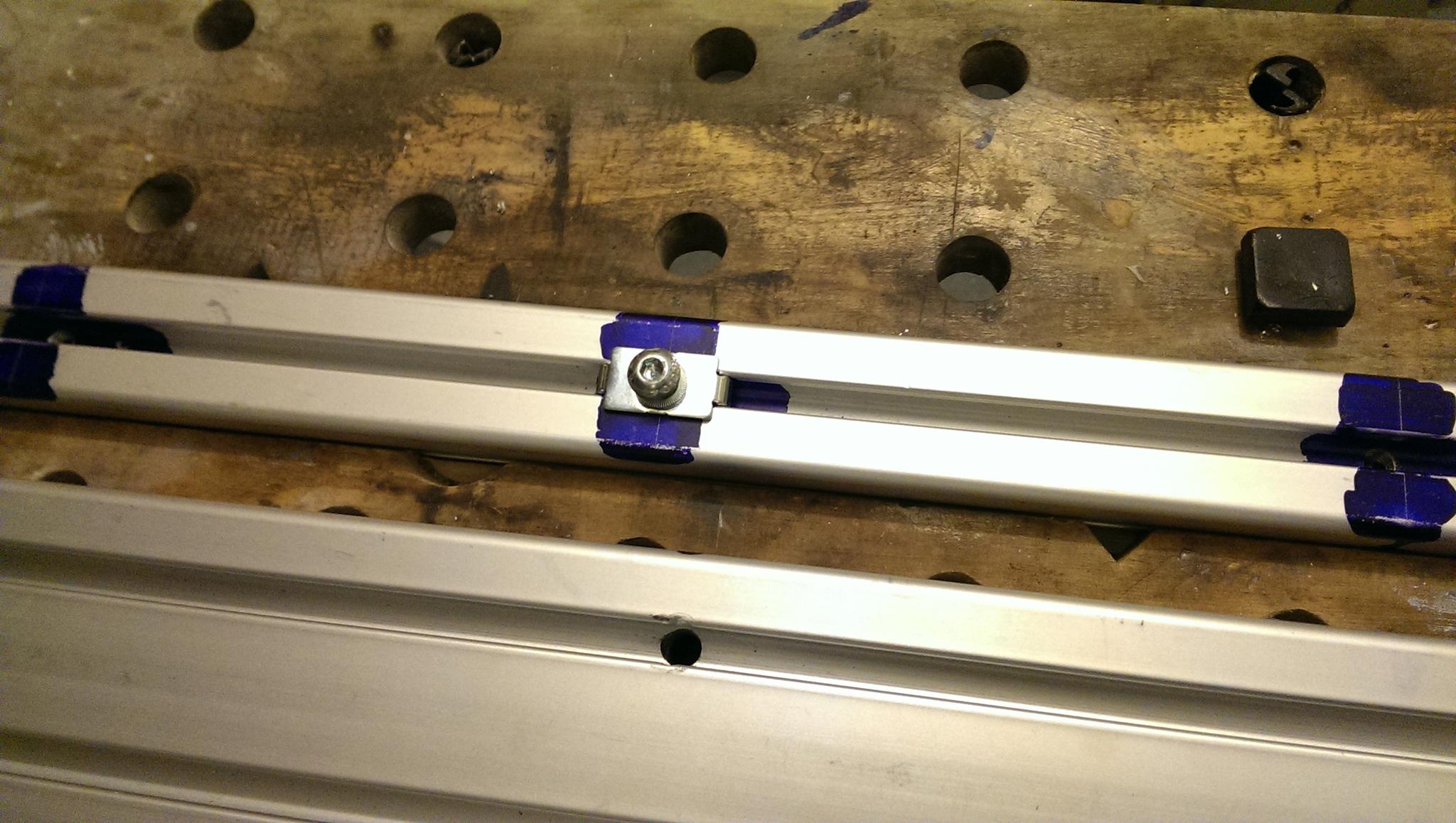

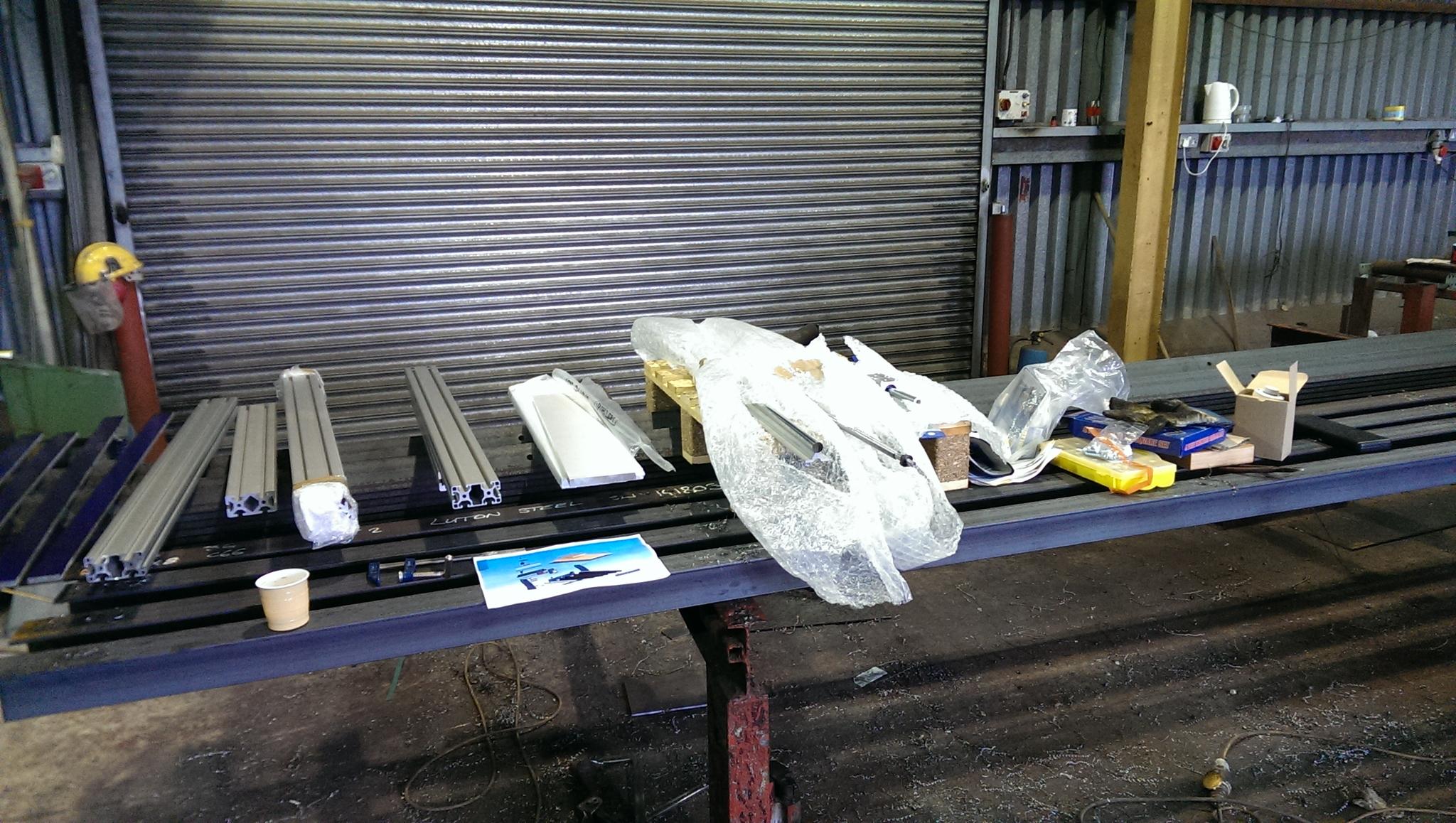

Ar last!!! Started my Gantry 3-Axis CNC Build
The day has come and I have finally started my 3-axis Gantry router build. I've been lurking on the forum for too long now and its time to do this. Firstly thanks to all the forum members who have contributed to the design - Jazz, John & HiltonSteve who inspired me with his build all those years ago. Attached are some 3d renderings and pics of stuff. Currently doing lots of drilling holes and counterboring in ali strip and plate for the bolts etc.
Basic machine specs are:
3-axis 1100 x 700 x 300 ballscrews.
SBR20 on X SBR16 on Y & 7
Frame from 80x40mm heavy and intermediate extrusions (2.8 and 4kg/m)
Plate - Gantry sides 20mm cast plate 5083
Z axis - Tooling plate cast 5083
Frame Ends 15mm plate 6060
3.1Nm Steppers CNC Kit 1 from Zapp
Photos taken in a unit my neighbour has - did'nt trust the runout on my pillar drill with M8 clearance drill.
Watch this space for more pics as build progresses
Mikehttp://www.mycncuk.com/attachment.ph...id=14043&stc=1http://www.mycncuk.com/attachment.ph...id=14044&stc=1http://www.mycncuk.com/attachment.ph...id=14045&stc=1http://www.mycncuk.com/attachment.ph...id=14047&stc=1

Nice little wood cutting machine. Don't forget the energy chains. You might just fit one under the X rail on a shelf bolted to the extrusion.
With the single ballscrew on X try to cut jobs on the centre line of the machine to reduce racking.
Re: Ar last!!! Started my Gantry 3-Axis CNC Build
routercnc
Nah there will be no problem cutting off centre in wood with this design at this size. I've built several know using almost identical design (probably because mikey copied most of my router design. . Lol) and they don't flex while cutting woods, even hard woods.
That said I wouldn't use single screw for cutting aluminium or really deep DOC cuts in hardwoods as then there is potential for some racking.
There is just enough room for energy chains between profiles but needs certain size. It also doesn't need a shelf as nearly half the chain can be supported or bolted to the profile and the remainder easily handles the weight of cables etc.

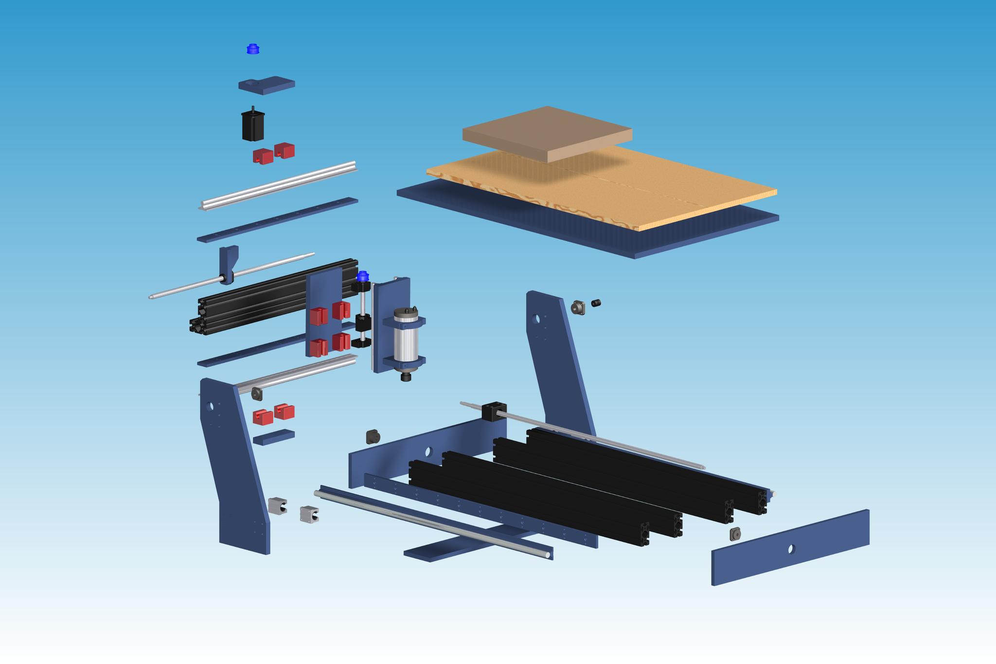

So you saying you haven't copied anything from the L shape profile gantry Gantry or the offset drop Z axis Layout or the profile base with aluminium end plates I use.?. .:hopelessness: . . .Ok.!!!!
If thats the case then sure you must have accounted for the gotcha's that I see and encountered.!!
JAZZCNC
Hi Jazz
I have to ashamedly say "yes" but good design and good principles are always worth following!
regards
Mike
MikeyC38
Hi Jazz
regards
Mike
No problem and it's fine by me. If didn't like it copied I wouldn't let it out in the public domain.

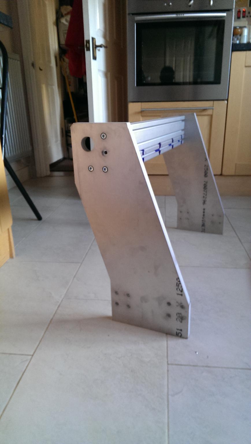

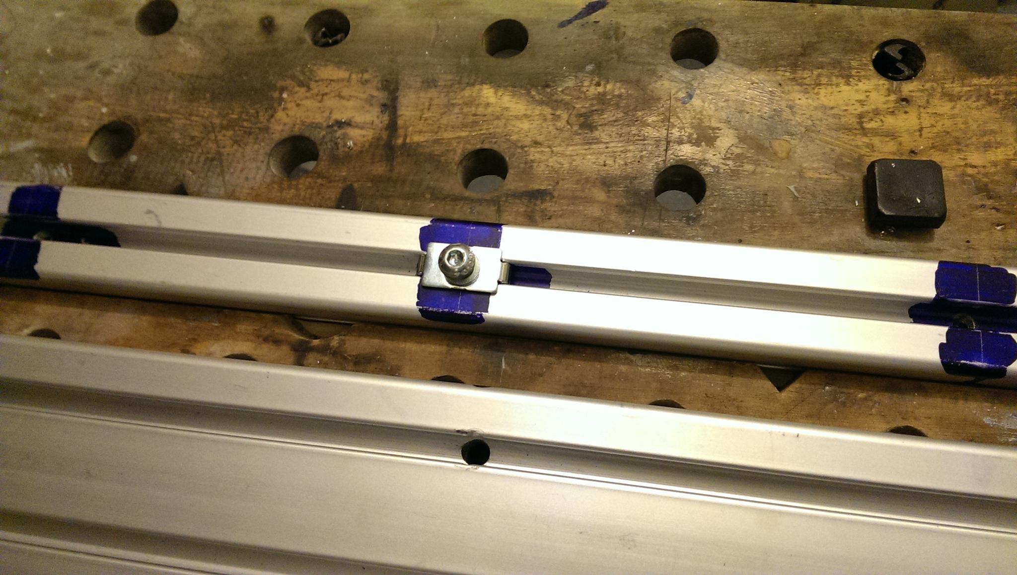

10 Attachment(s)

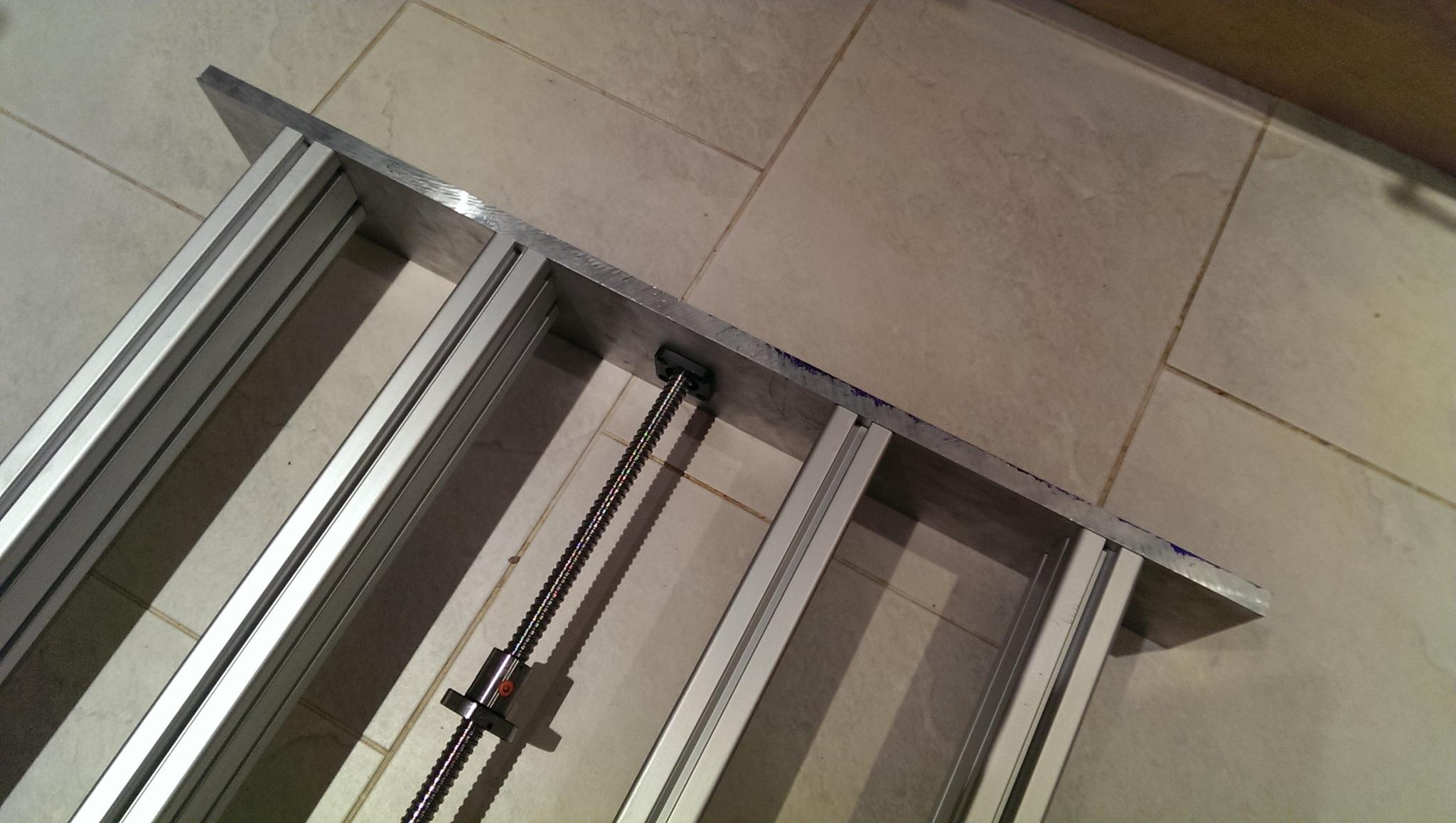

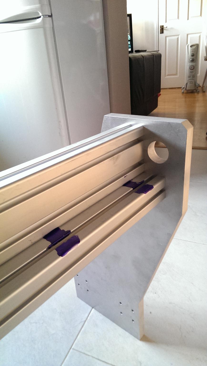

Hi Guys
Sorry to be so tardy with postings and updates but I have been working on this. One of the things you discover when building a CNC from extrustions is the amount of drilling and thread tapping you have to do! Thanks to my neighbour who is a retired tool maker, he advised that I use spiral taps and these are brilliant when used in an electric drill! My top tip of the day! Attached are some photos of progress. You can see how the L-shaped Y axis inspired by Jazz was done. I have recently completed the drilling of the "thickner plates" which are used to mount the round supported rails because the material in the extrusions is too thin to directly mount the rails. Also I now need to clear out my garage so that I have space to assemble and check the machine!
http://www.mycncuk.com/attachment.ph...id=14541&stc=1http://www.mycncuk.com/attachment.ph...id=14549&stc=1http://www.mycncuk.com/attachment.ph...id=14548&stc=1http://www.mycncuk.com/attachment.ph...id=14547&stc=1http://www.mycncuk.com/attachment.ph...id=14546&stc=1http://www.mycncuk.com/attachment.ph...id=14545&stc=1http://www.mycncuk.com/attachment.ph...id=14544&stc=1http://www.mycncuk.com/attachment.ph...id=14543&stc=1http://www.mycncuk.com/attachment.ph...id=14542&stc=1http://www.mycncuk.com/attachment.ph...id=14550&stc=1

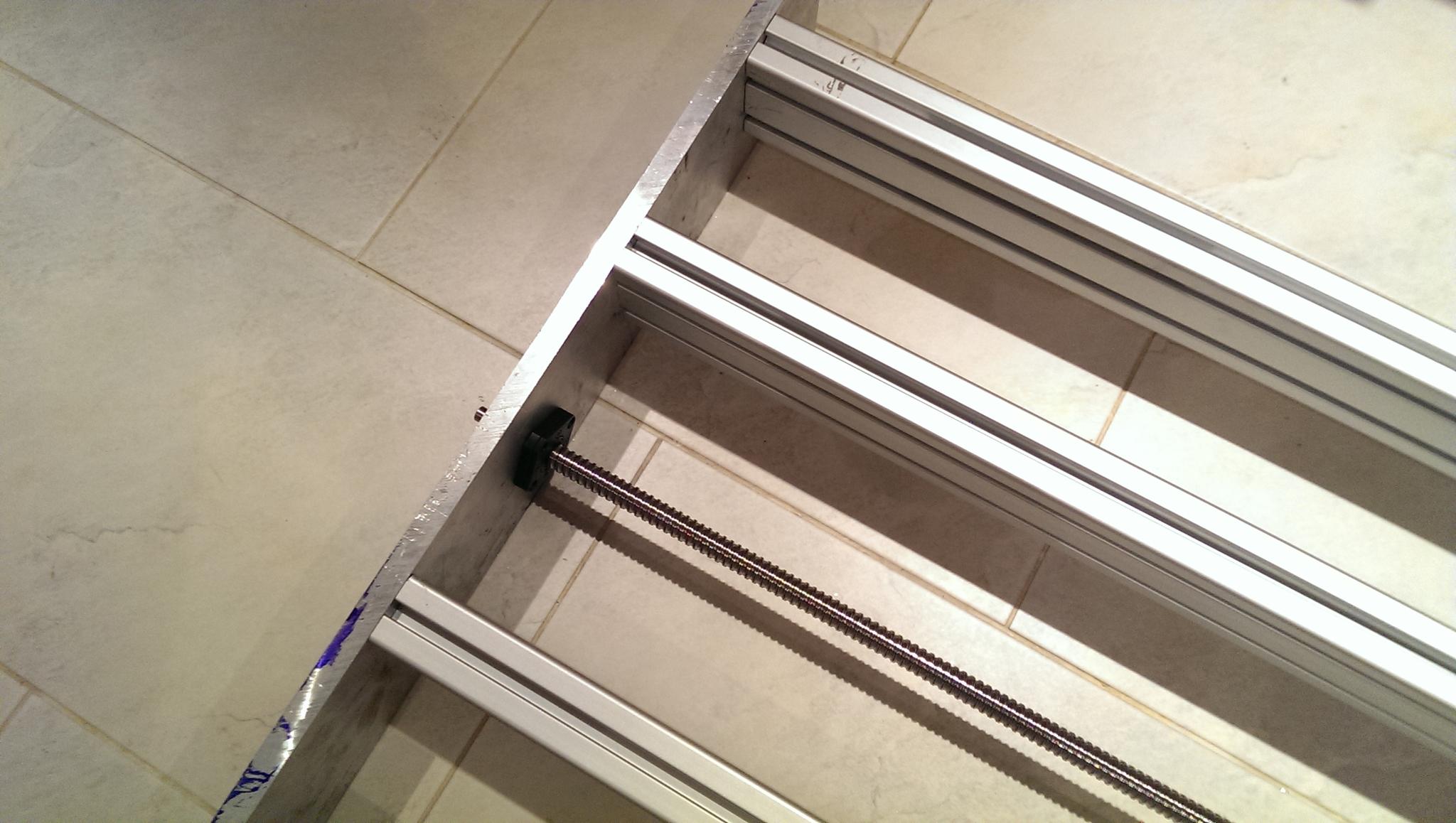

2 Attachment(s)

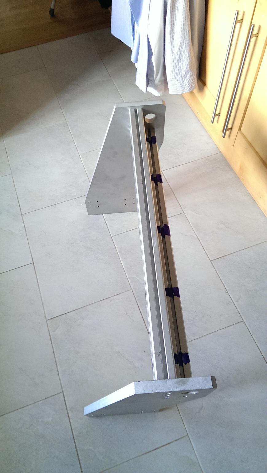

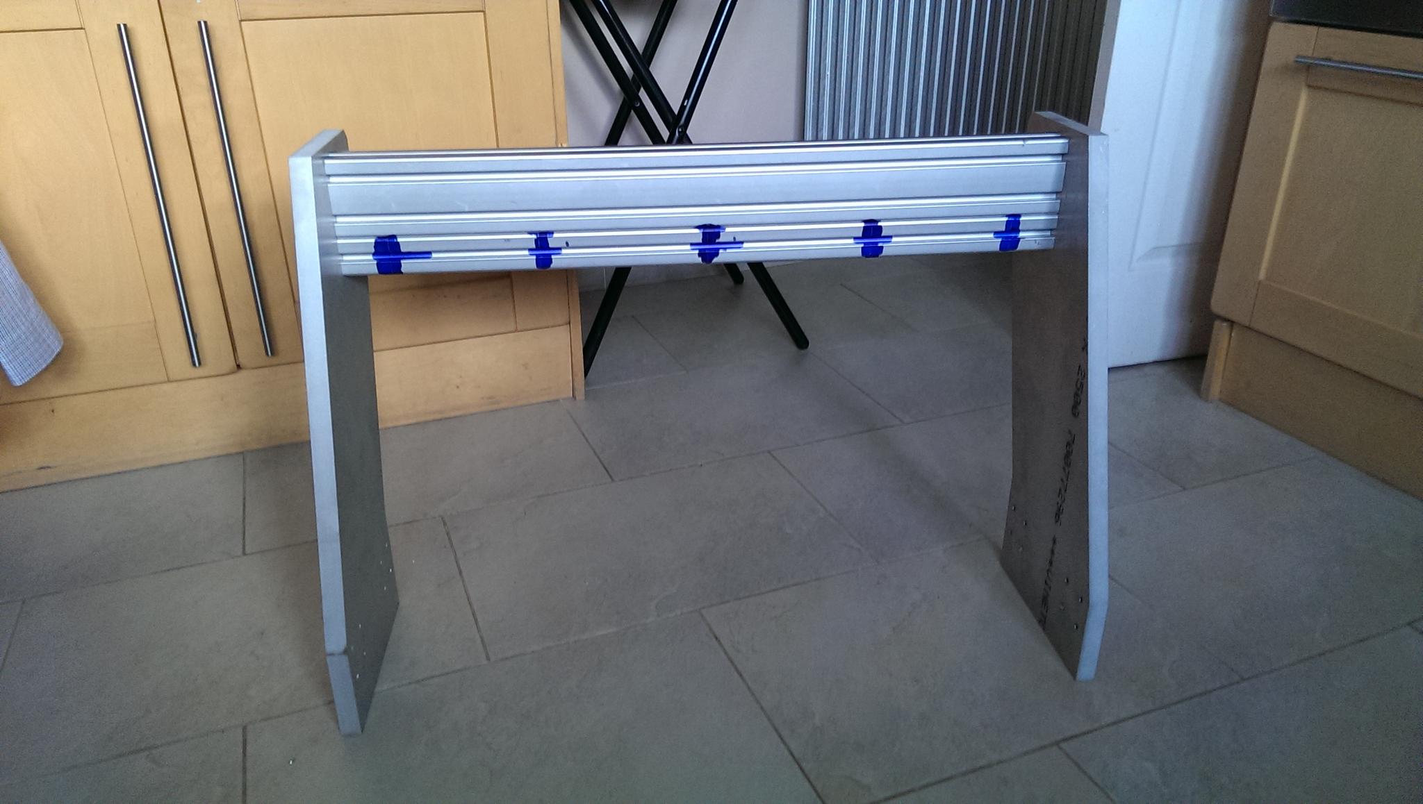

Hi Guys
Making somewhat slow progress on this but the attached pics show the gantry trial assembled. Runs really nicely on the supported round rails and I detect no binding anywhere! However I have invested in a pack of steel shim material because I expect that stuff will need it to get everything square and nice! The biggest step now is to get the plate holding the z-axis stepper manufactured. Hoping that the local FE college will help here as I don't have a milling machine :upset:http://www.mycncuk.com/attachment.ph...id=15698&stc=1http://www.mycncuk.com/attachment.ph...id=15699&stc=1
Also does anybody have or make some clamps for the 80mm water cooled spindle? I thought Jonathan was making these at some stage but can't raise him via the forum?
Any tips on what lubricant to use on the supported round rails? I will be using Mobilux EP2 for the ball screws (via the ball nut)
Mike

Looking good Mike!! I've used a 50mm round linear rail bearing housing (bought it from Zapp) which can be picked out quite cheaply on ebay. Jyst take out the circling holding the bearing in and press put the bearing, cut through one side and when you tighten it down it clamps the spindle....
http://images.tapatalk-cdn.com/15/07...a01577b4ff.jpg
njhussey
Thanks nj for the tip. Trying to keep the gantry weight down as it will approach 30kg when fully loaded with spindle z-axis and rails.

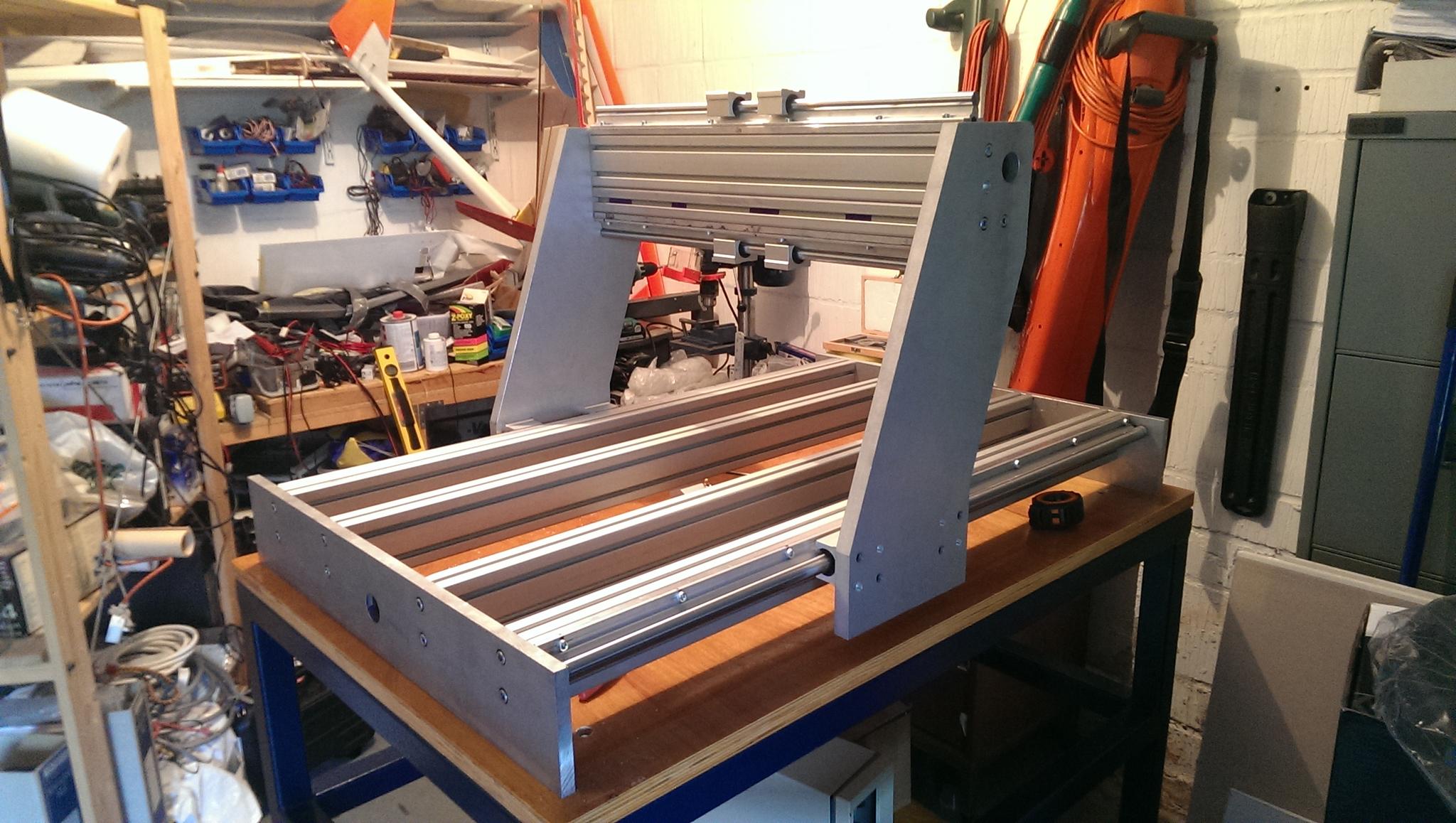

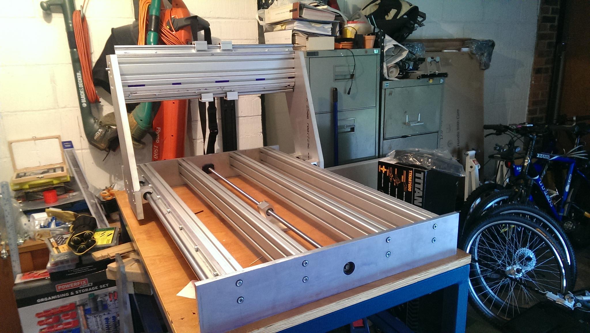

2 Attachment(s)
Some more pictures of the build. I've been ill since September 2015 and thus made no progress until March 2016. But the Z axis is in place and moves nicely in the Y axis!
BTW does anybody know if SBRUU linear bearings have to be lubricated? and if so, with what type of lubricant and how frequently?
Thanks Everyone for the help and inspiration so far!
Mike

Hi Sherpa
I don't know about the cut quality yet -still fiddling with basic calibration and wanting to fit Jazzcnc's relay based e-stop system before really "going" for it. There may be some racking issues but if I cut in the centre of the board, this should reduce it. I guess if (or most probably when!) I do this again , then twin 1610 ballscrews, belt driven (avoids problem of twin steppers de-synchronising but I don't want to start a flame war here!!!) 68v stepper drivers and a different design for the gantry and precision profiled rails. But I'll wait and see how I get on with this one. It's taken me long enough to get to this stage!!!
I have to admit I'm impressed with the current stiffness of the gantry but cutting will be the true test.
Mike
