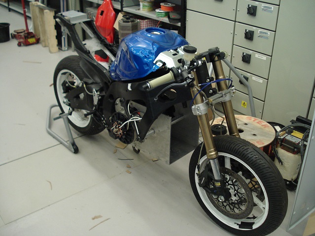

This was not a project particularly relevant to this forum, but since it involves machining and is generally an exciting project, I think people here might be interested in hearing about it...

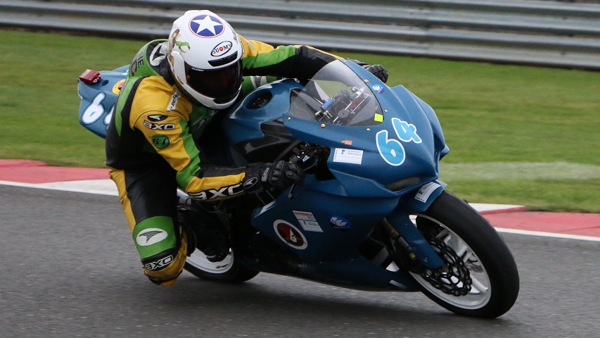

Over the summer this year I was involved with building and racing an electric motorbike, for the University of Nottingham PEMC research group. We started with an existing motorbike frame (Suzuki GSXR-600) which had been raced as an electric bike previously, but stripped down so we started off with a heap of parts:
http://www.mycncuk.com/attachment.ph...id=14075&stc=1
1 month later:
http://www.mycncuk.com/attachment.ph...id=14074&stc=1
Our rider was Jeremiah Johnson, a professional rider from Hawaii. He arrived in Nottingham shortly before the first race and stayed for the whole season. The bike was not quite finished when we had to leave for the first race in Assen, so the finishing touches, connecting all the batteries and battery management system, were only completed in the early hours before the first race in Assen. During practice Jeremiah told us that the bike had much less power than expected. We found that this was due to a fault with the motor controllers, which after working late into the night again we managed to fix in time for the race, securing 3rd place.
The subsequent races, in Anglesea, Hockenheim, Donnington and Silverstone were just as eventful. After each race we fixed any broken parts and made improvements. The first upgrade was to lighten parts of the frame, by cutting metal out where not needed and replacing some parts with carbon fibre. Another member of the team put a lot of effort into the bodywork and painted the fairings - something we didn't have time to do before the first race. Later on I added ducted fans to increase the airflow over the motors in the hope that this would let us extract more power from them.
Racing was quite an unfamiliar experience for most of the people involved. Compared with having plenty of equipment in the lab it was a stark contrast to be at a race track with only what we had remembered to take. This meant there was much improvising to keep the bike working whilst at the track. The electric bike racing attracted a lot of interest from some petrol racers and fans. I was frequently asked what the top speed and range of the bike were - about 105mph and 120 miles, though not at the same time! The race at Donington included petrol bikes on the track at the same time as us though in a separate race. It was good to see the electric bikes proving they were competitive against petrol, though less good when a petrol rider blocked Jeremiah on the penultimate corner, preventing him from taking 3rd place.
We achieved third overall in the race series, which was pleasing given the short timescale available to work on the bike and considering also that this was our first racing experience! The race series has given us valuable experience and data which we can use to improve our standing next season.
For next season I have negotiated a sponsorship deal with Parker for the motor and the plan is to race the bike in the Isle of Mann TT Zero in 5 months time. According to my simulation the new motor should get the bike to approach 180mph without much difficulty, for short periods at least.
I have got plenty of pictures of the bike, inside and out, so if people are interested I will post them. There are some videos and interviews featuring the teams that participated, including us, here on the IET website.

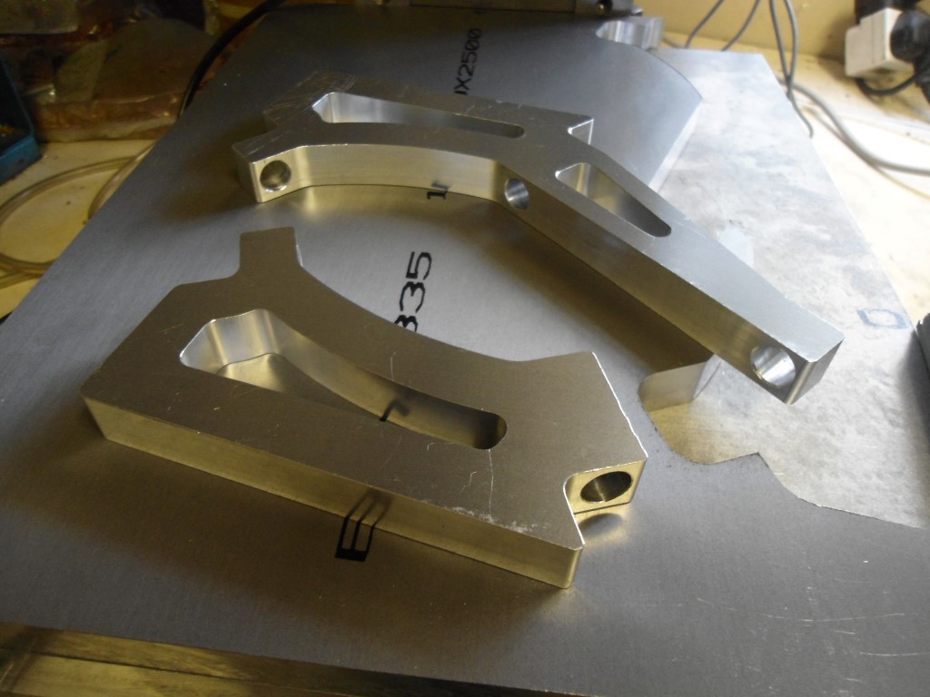

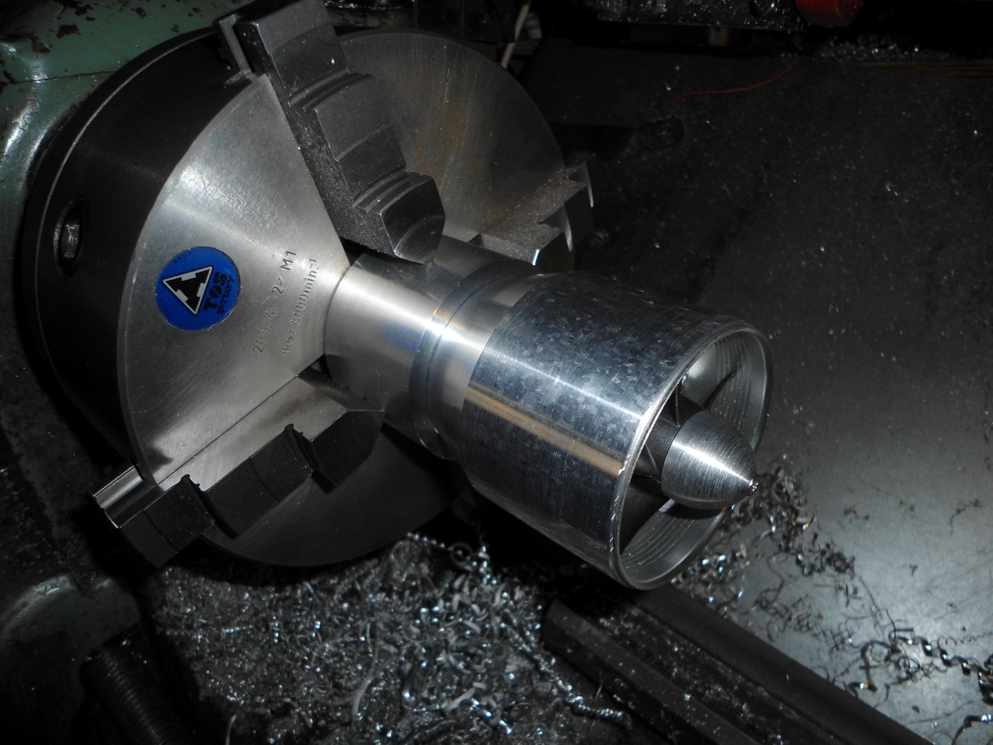

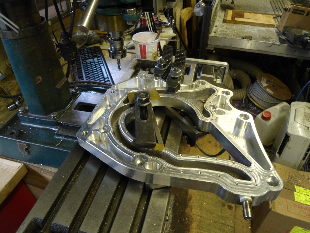

Here's one part I machined for the bike. I didn't actually machine many parts as the health and safety rules prevent me from using the workshops at uni, so I mainly did electrical stuff. The part is a heatsink for the speed controller on the ducted fan that helps cool the motors - one on each side. Wall thickness is 1mm or less:
http://www.mycncuk.com/attachment.ph...id=14147&stc=1http://www.mycncuk.com/attachment.ph...id=14148&stc=1http://www.mycncuk.com/attachment.ph...id=14149&stc=1

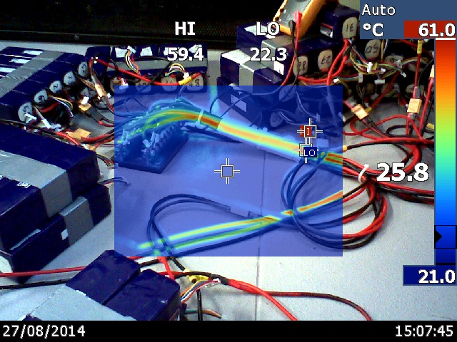

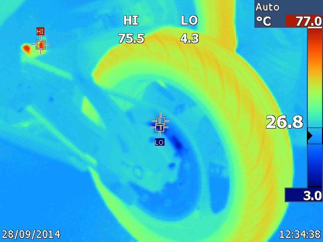

Thermal image from after a race and testing batteries:
http://www.mycncuk.com/attachment.ph...id=14150&stc=1http://www.mycncuk.com/attachment.ph...id=14151&stc=1

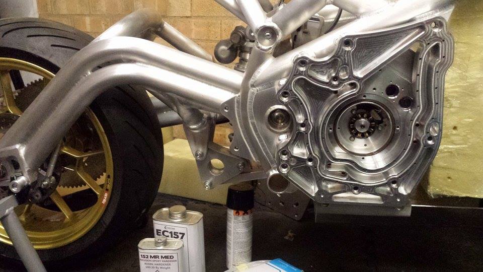

Can anyone spot the bits I made ;)
Re: Electric motorbike racing
Jonathan
Would that be for hanging onto.?

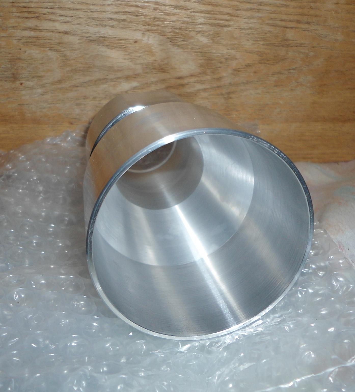

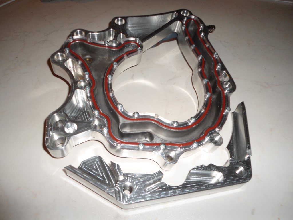

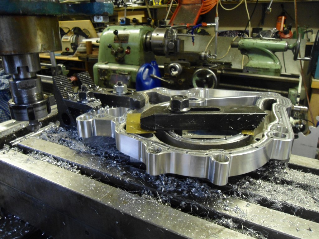

Yep, I also made the water cooling block below by borrowing my friend's CNC router. We were nowhere near finishing so we took my mini lathe in the van. Almost everyone who passed our box said 'look, they have a lathe!'... you'd think they'd never seen one before. The lathe proved just as useful to other teams as us - I think I helped out 5 different teams with it, including skimming a shaft from a sidecar.
http://www.mycncuk.com/attachment.ph...id=15515&stc=1

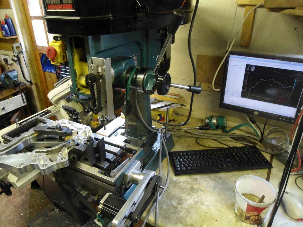

Here are some more parts I machined for the bike - some sprockets:
http://www.mycncuk.com/attachment.ph...id=15525&stc=1http://www.mycncuk.com/attachment.ph...id=15527&stc=1http://www.mycncuk.com/attachment.ph...id=15528&stc=1
They were surprisingly easy - I just used a 6mm cutter for the main profile and a simple V-shaped tool I made from silver steel for the chamfer. Next time I will add some pockets to save weight. For these I was in a hurry so didn't bother.
They worked, but were a bit wobbly as the aluminium plate wasn't terribly flat! The bike has done about 100 miles on the TT course and the 6082T6 aluminium hasn't worn much at all, so it doesn't seem worthwhile splashing out on 7075 grade. I think I'll just order some tooling plate to guarantee sufficient flatness and make plenty.

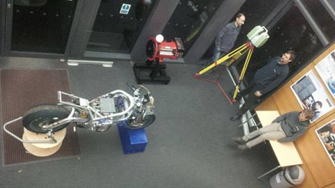

Today we found the lazy way to draw your motorbike:
Attachment 16635
Expecting a point cloud soon...

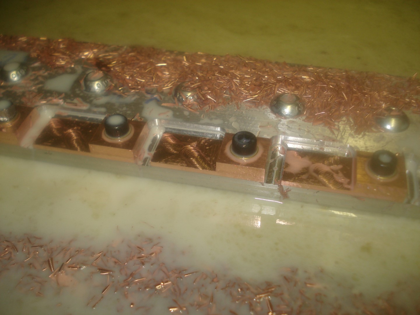

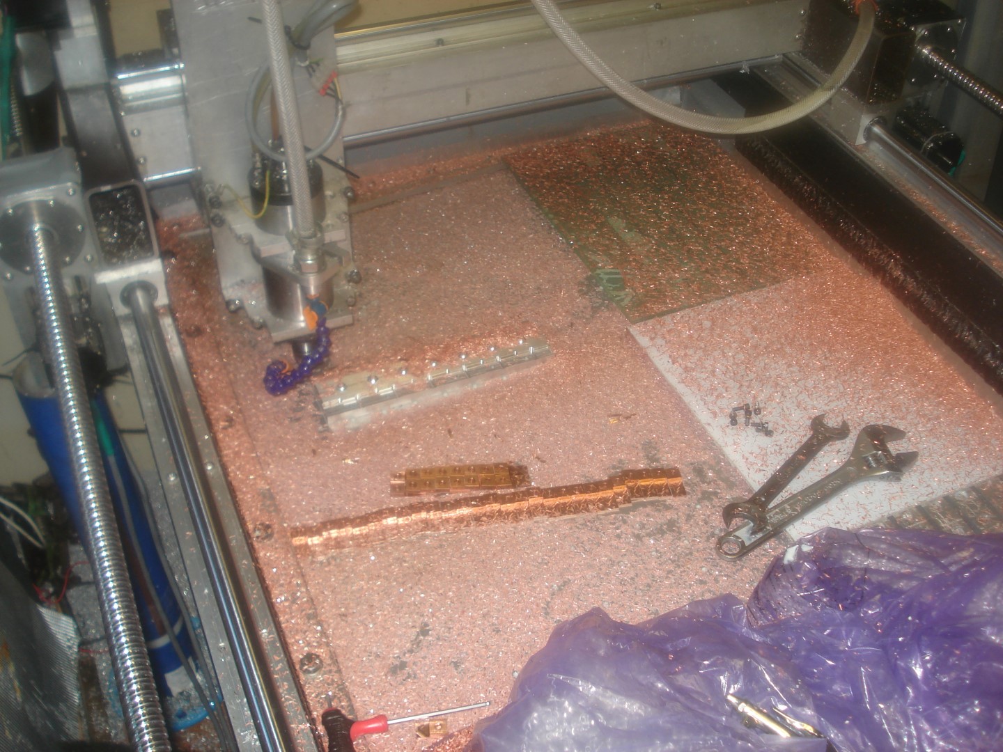

6 Attachment(s)

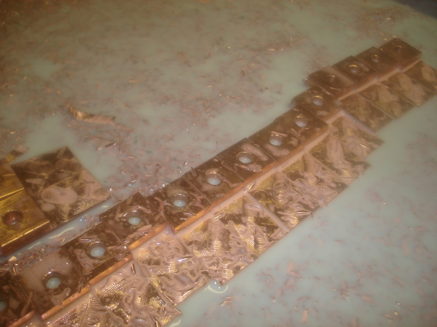

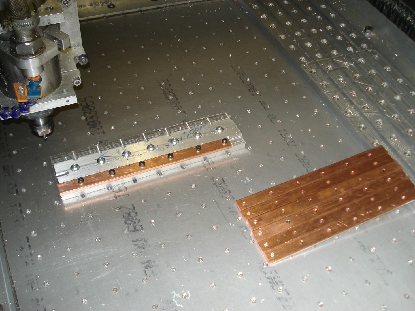

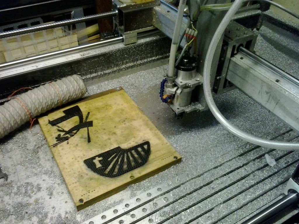

The bike project is getting going again. One of the nice things is getting to machine some more interesting materials, e.g. a £300 piece of titanium bar for the motor shaft:
Attachment 17762Attachment 17763
I chose titanium purely for the 'easy' weight saving. We're getting the motor core length a little longer for more power, so the increase of weight from this will be offset a bit by lightening the shaft. My lathe seems to be coping OK so far. I first made sure the tailstock was properly aligned as the tolerances are pretty strict on this one and spent the rest of the weekend doing the roughing cuts.
More fun than millions of battery terminals:
Attachment 17764Attachment 17765Attachment 17766Attachment 17767
I programmed those using Octave (though just about any language would have done), parametrically so I just have to enter the dimensions and the rest is worked out. It seemed worth it to get an efficient toolpath - probably wasn't, but more interesting!
Next thing will be some parts from aluminium and carbon sheet to make a new tail unit packed with batteries.

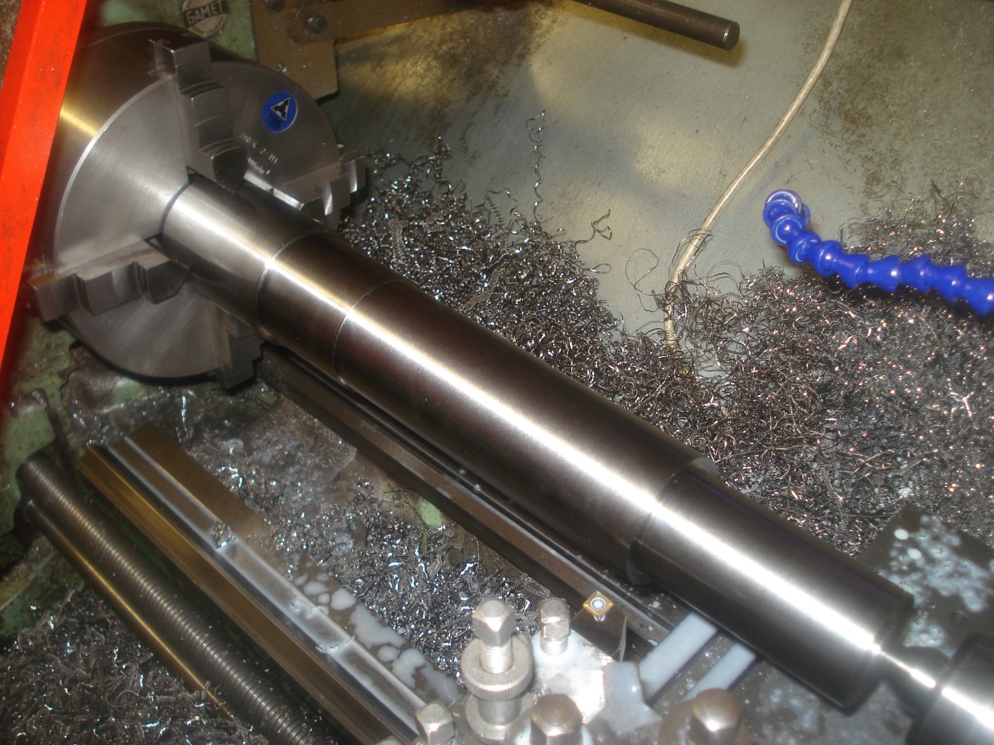

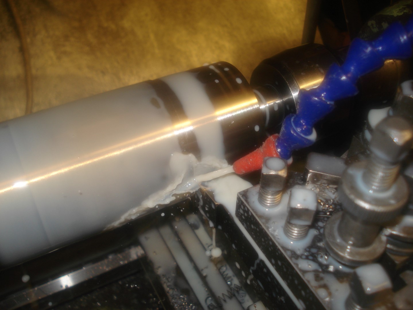

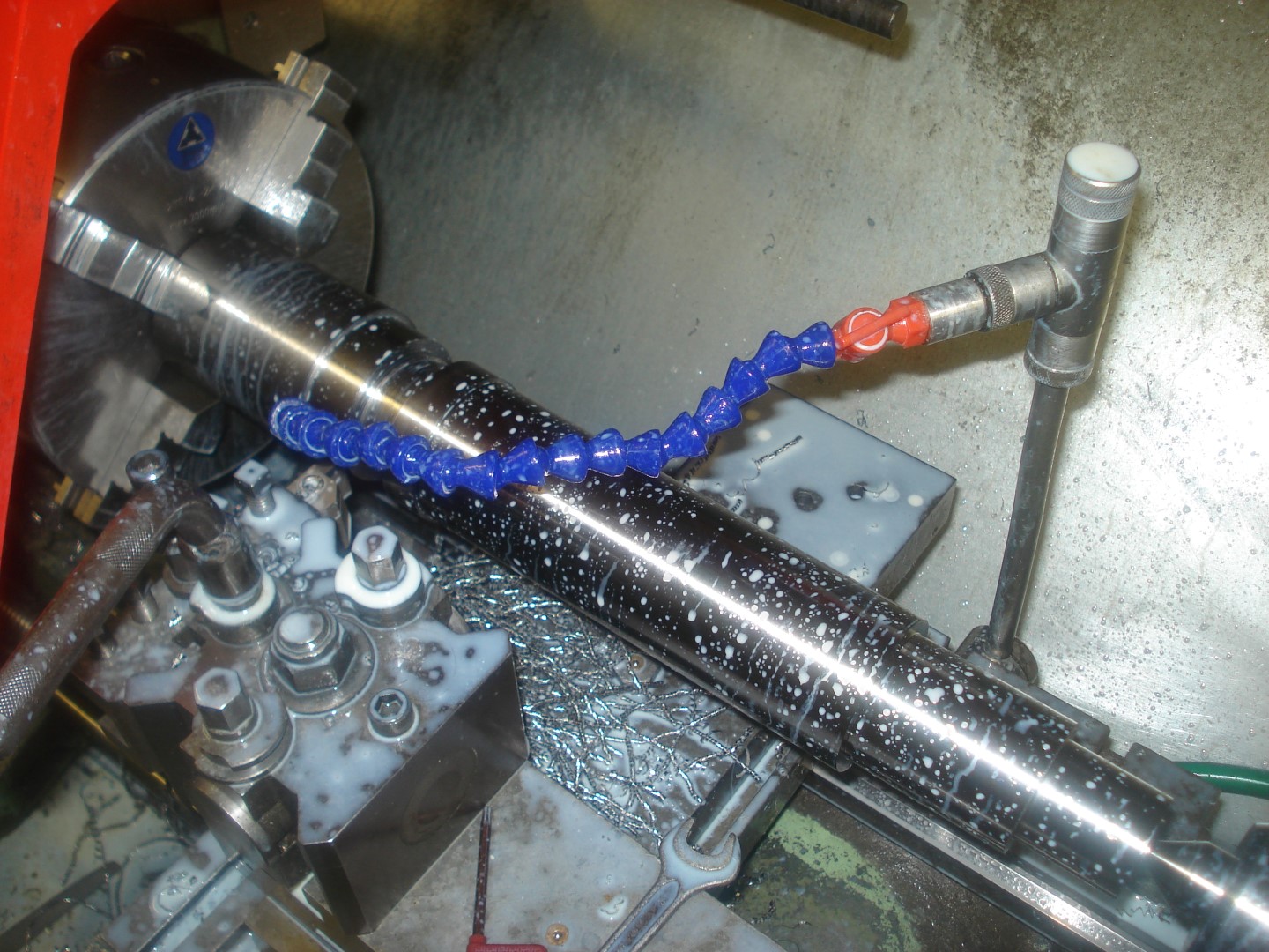

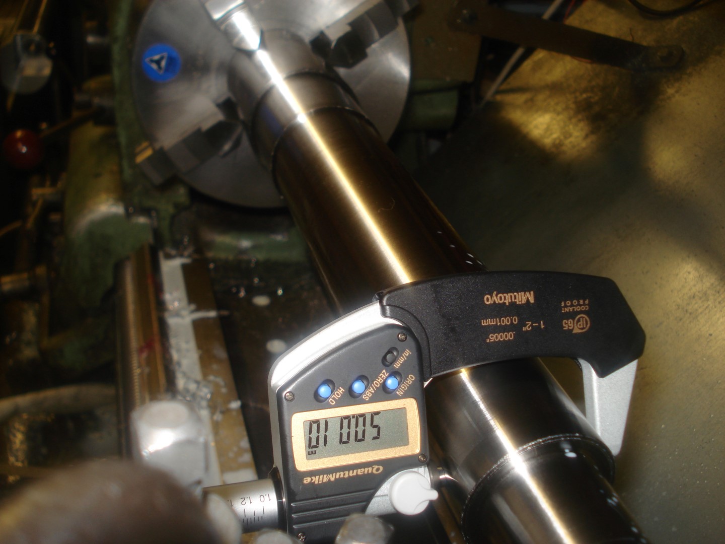

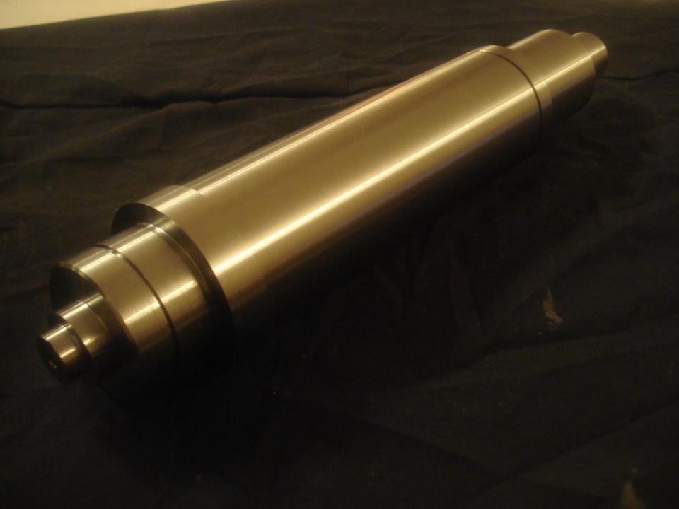

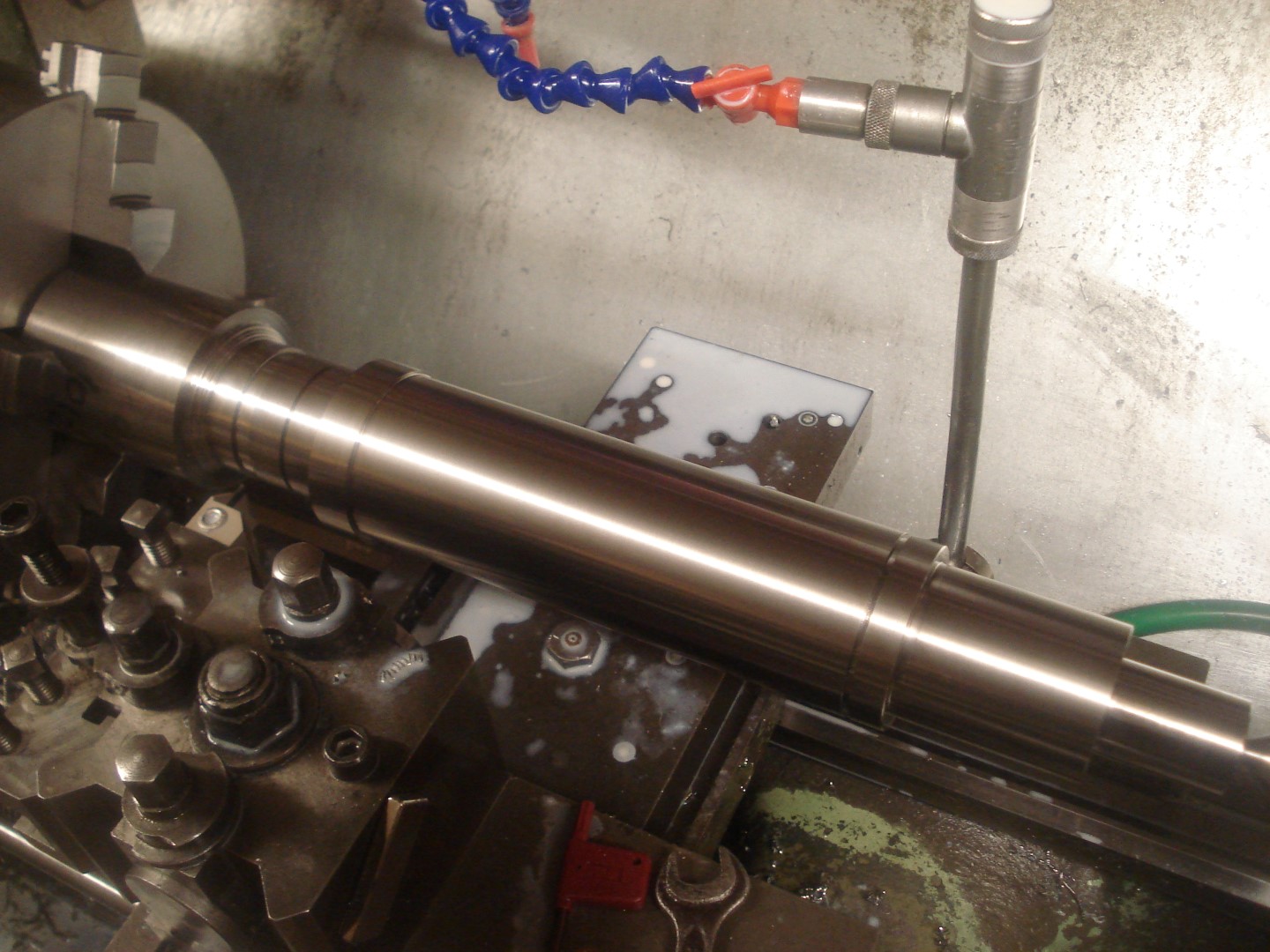

Quick update, I made some progress with the titanium shaft this weekend. I almost finished the lathe work:
Attachment 17927Attachment 17928Attachment 17929
I used a CBN tip for the finishing as it was able to take extremely light cuts, so no "hand finishing techniques" required. The tolerance on the part measured above was 50.003-50.015, so I made it to 50.010 as the young's modulus of this material is lower than the steel that fit was specified for, so making the interference slightly greater seemed the safe option (though it probably wont matter in reality).
Next weekend I'll do the last bit of turning on the other end, then it needs a few slots miling and some holes drilling to mount the sprocket.

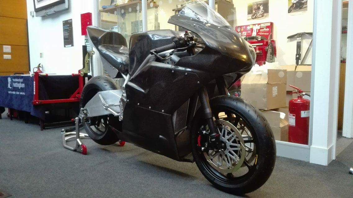

In other news, we should be getting the new bike frame delivered within a week, so watch this space. Race dates have also been confirmed, so I'll be in Belgium, Germany, the Netherlands, Portugal and the UK!
Famous last words ... took me most of last weekend to actually finish the turning:
Attachment 17983
I double checked all the diameters now it is off the lathe and it's well within tolerance - e.g. the longest diameter is 0.011mm different from end to end, but the drawing specified up 0.04mm here.
Next step is to mill 3 keyways in it and drill some holes for the sproket.
We also got some new brakes delivered from PFM. Apparently they're really good ... I don't know about brakes.
