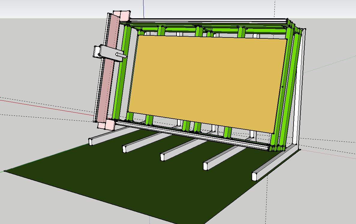

I am building the machine for a friend, who will use the machine for cutting sheet ply. I started this end of last month and I aim to have it ready for start of January
The requirements for this build are as follows
* It is required to cut 8x4 sheet ply, 18mm thick with a 6mm cutter
* It needs to be wall mounted (work will be screwed to the sacrificial base)
* The room is 3m x 3m in which it will be used. So needs to be assembled on site.
* Its a start-up company therefore finances are tight, it must be as cheap as possible.
The design is very similar to my other builds (same ali gantry design IL, thick 6mm steel frame) except this time Ive bolted the entire frame to allow for adjustment
Ive cut all the steel using his three phase suds cooled industrial chop saw; which enabled me to cut the steel extremely accurately. I achieved squareness by doing minimal welding, and lots of "bolt" fixing; measuring from corner to corner.
2510 fixed ballscrews with spinning nuts (thans jonathon)
cheap chineese 860 drivers
heres the lazy design anyway (no ballscrews, or triangulation on frame)
http://www.pensys.co.uk/chris/plan1.jpg
http://www.pensys.co.uk/chris/plan2.jpg

Just thinking, are those SBR bearings designed to work on their side ?
Re: 8x4 Wall Mounted; Upright ply cutter
EddyCurrent
probably not!!. will see how they go!!. I only put them on to wind dean up... :D as I know how much he adores them.
only joking... they are like toys compared to hiwin type ones (now that I have used them to compare them)
it was only when (in another thread on here) the other day somebody pointed out how cheap the "proper" rails are now, that I started wishing id used them... oh well! next machine il use them.

What size of steel profile was used? Whats the total weight of the machine? Did you thread the profile for the connections or the bolts are pass through?
JoeHarris
Just one question - doesn't all the crap fall into your X axis bearing,
YEP!!!. Im working a anti-gravity machine.... or... mounting it upside down on the roof!...
Seriously; The extraction system will have a bottom rail to catch any falling dust.
my greater worry is the x bearings being used on their side...
silyavski
* 60 x 60 x 6 and 100 x 60 x 6
* Yep threaded hundreds of holes (got w*nkers wrist!)
* I Dont believe any "nuts" are used.
Nobody has pointed out any faults?? I was expecting a wooping.... this is only techically mk1... mk2 Il learn from the mistakes on this one.
So; il be honest.
1.) The biggest mistake... I should of had the ends (both) of the X ballscrews threaded; so I could put them under tension. They do sag a bit under their own weight.
2.) linear bearings being used on etheir side? X???
3.) The Z movement is way too much... it probably only uses half of the travel available (so unnecessary weight on gantry)
4.) really needs twice as many bed support braces. The distance inbetween them in launghable... space for twice as many
5.) No water cooling yet for spindle in video
6.) No emergency stops; panic buttons etc
7.) Need to add proximity for auto-square; but where I had mounted the brackets didnt account for quite how tight the fit into the room would be. Il have to re-think.
Where would you like me to begin!. . . :hysterical: . . . Only Joking mate for it's intended purpose of chomping ply it will be fine.!
As your about to findout going vertical is great but there's a few areas that need protecting and designing around.
Z axis one area as the crap will settle on the top edge and build up so make a cover or angled guard.
Also in your case using rotating nuts at top then crap will also fall into the bearing housing so cover that ASAP.
With lower bearings then you (know whats coming here) throw the crap away and get the real thing.! (thou that will test how accurate the frame is.!!)
For catching and moving crap Make an angled slide that extends from bed to just below gantry then crap falls over the rails not onto them. Put a wiper on edge and it will wipe the gantry plates.
I would have have put a slight angle on the machine rather than being 90deg as it helps with holding work and stops large sheets or pieces faling forward.
