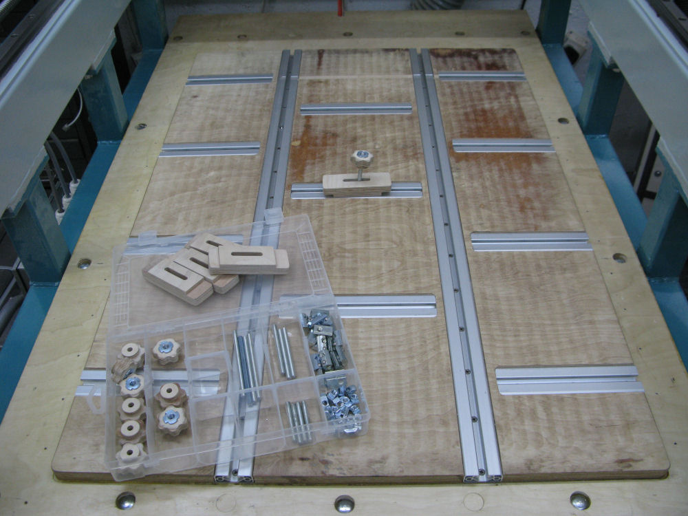

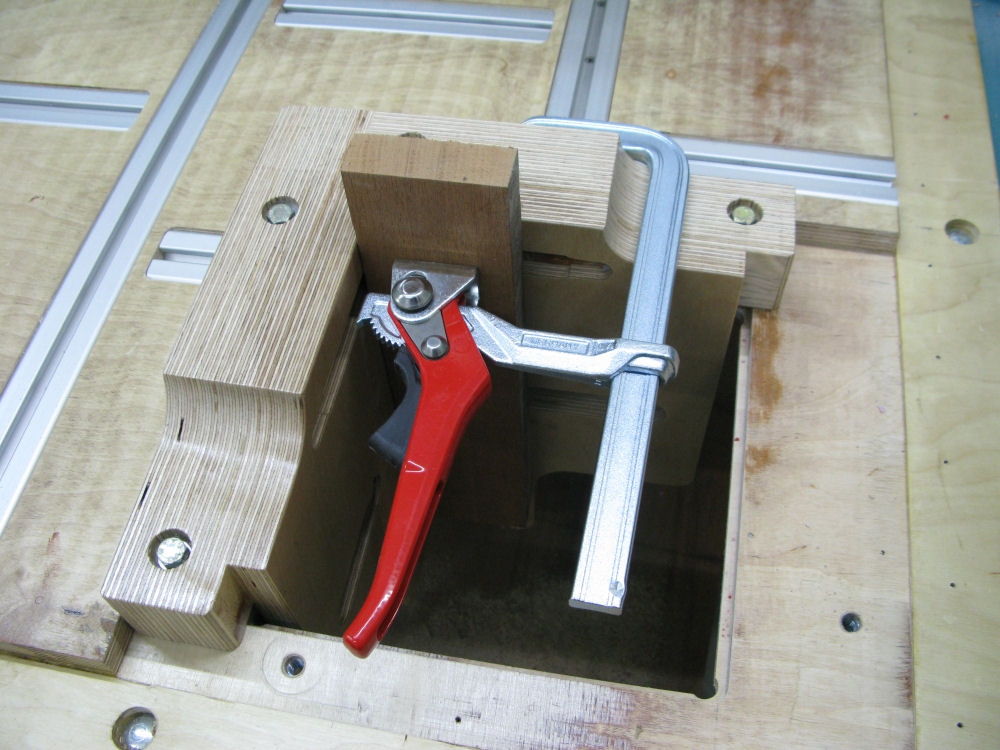

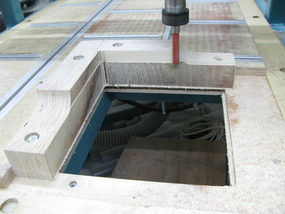

Router Modifications to Allow Cutting of Woodworking Joints
This follows from my build log discussion on the subject; http://www.mycncuk.com/threads/6565-...4514#post64514

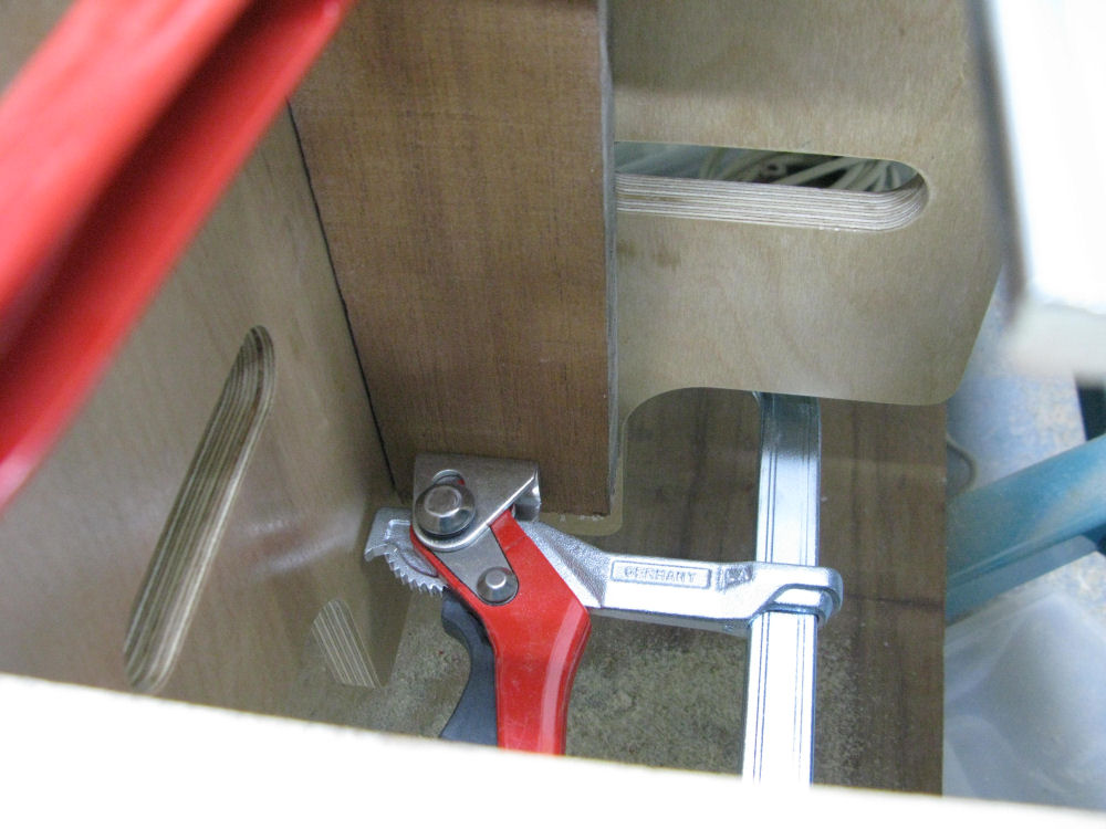

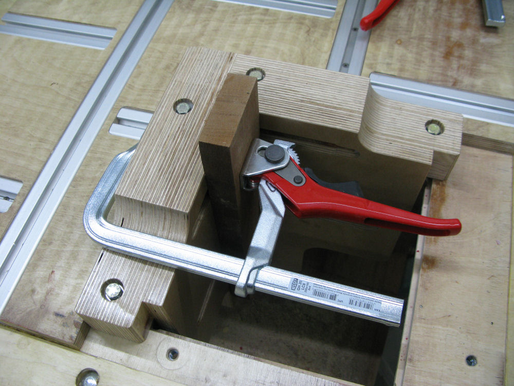

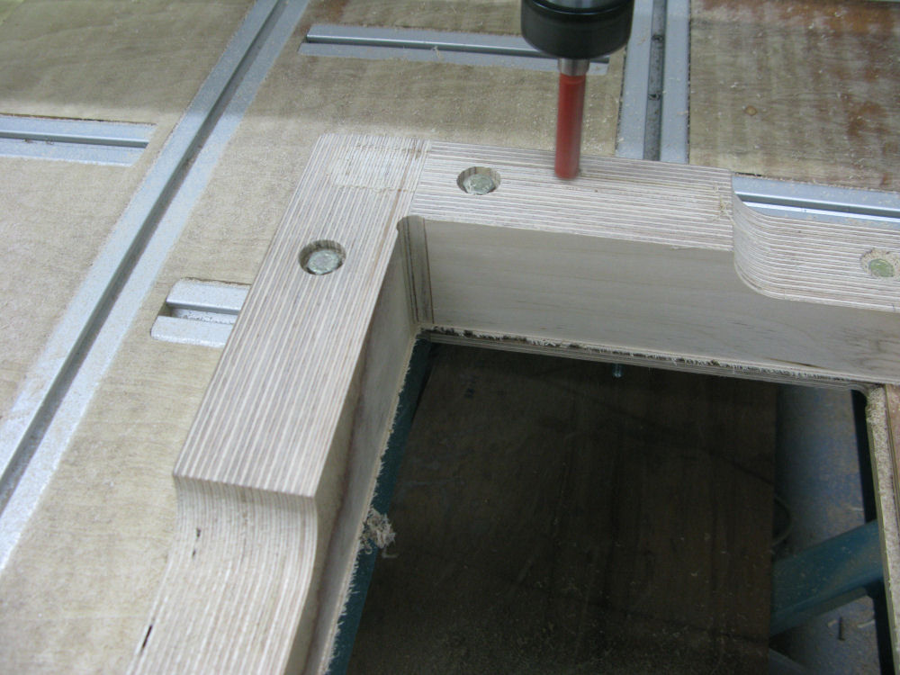

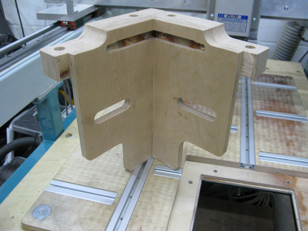

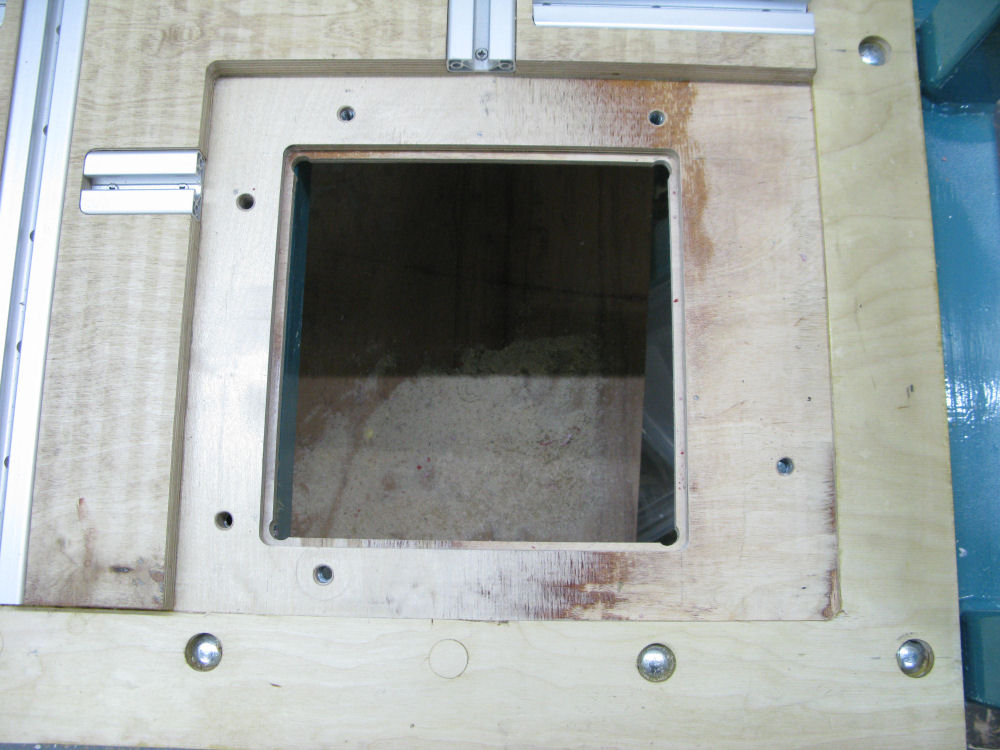

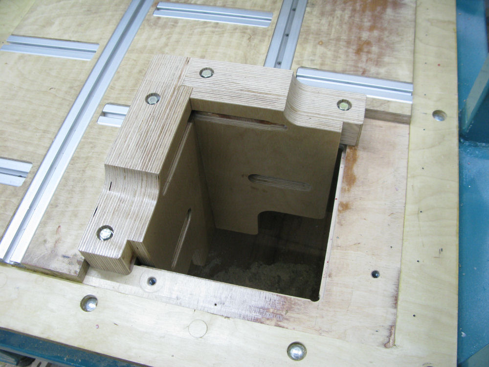

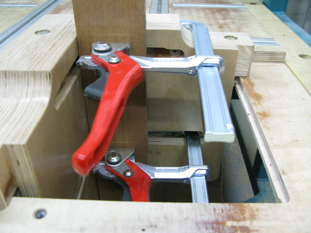

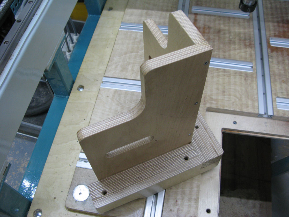

Sequence of events;

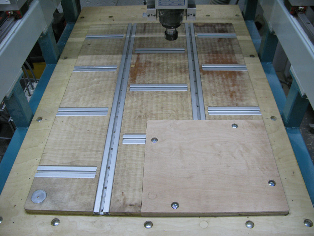

1. cut hole in table to leave approximately 200mm square hole for workpiece.
2. Make table insert to restore bed to one flat surface.
3. skim top of table insert with router.
4. manufacture plywood support arms, 50mm wide, 70mm high
5. drill all mounting holes using machine while keeping same zero datum point.
Holes in, table, table insert, support arms. Counterbore support arms holes and table insert holes. Fit 8mm threaded inserts into table.

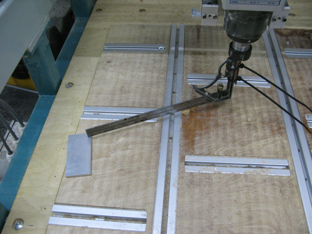

6. Check machine to ensure spindle is vertical in all planes. I attached an engineering square to a 1/2" cutter and used a piece of 6mm plate as a feeler gauge. Checked all round 360 deg. circle.
7. bolt support arms to table, skim front faces and top using machine.
8.Cut out and attach workpiece support cheeks. Cutaways allow 100mm throat clamps to be used for both narrow and wide workpieces. Three clamping positions are available and workpiece can be positioned in X direction or Y direction.
9. Check support cheeks are vertical using a straight edge from spindle and try-square from table top, glue and screw in position.
10. Seal all bare wood with clear lacquer.
The not so nice looking slots near the top of the support cheeks are to allow fixing of a T slot rail, which is not yet in my possession, this will allow attachment of jigs such as a 45 degree ramp.
Changeover from flat bed to jointing jig and vice versa is under 1 minute (assuming socket and screwdriver are on hand)
I lost some of the T slot due to this modification but it's not really a problem
Before.

Eddy thought that ages ago before building machine it was mentioned about making the gantry go past the end of bed so edge work could be done. Didn't you do this.?
Or have you got another reason for doing it this way.?
Re: Router Modifications to Allow Cutting of Woodworking Joints
JAZZCNC
Can't remember seeing that, or thought it wasn't needed, anyway didn't do it. I don't have a big use for this but it was a good little project.

Bet you can't to same accurecy and do it repeatably for say 12 draws.!
Regards your fixture Jig do you realise that you can create and save a Fixture offset for this so you don't have to mess around finding Zero.?
JAZZCNC
Yes, plan using G55

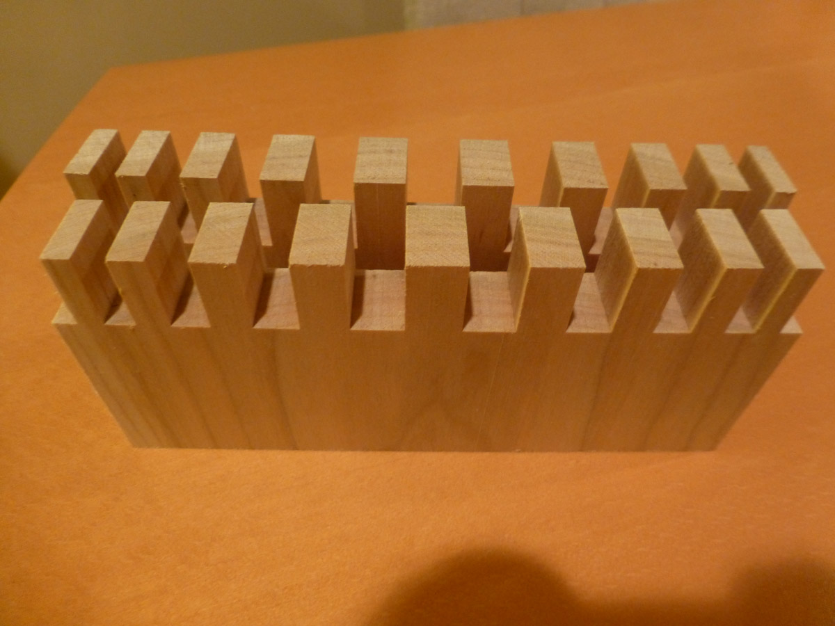

3 Attachment(s)

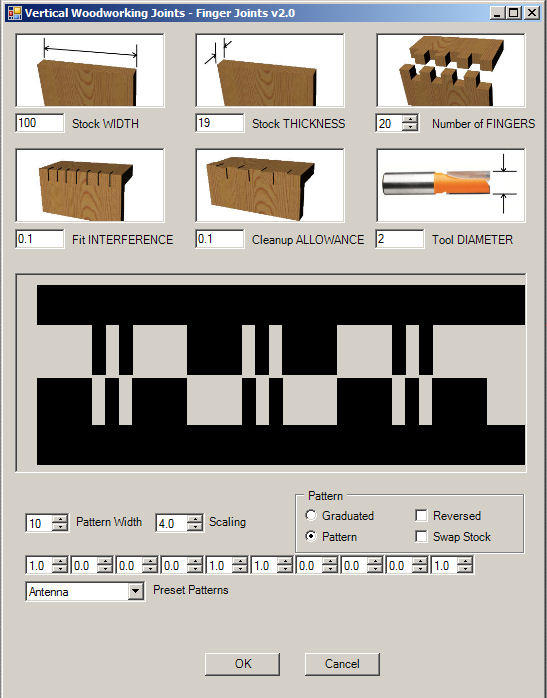

I've been getting back into some programming after a very long time, I forgot how much fun it was so haven't been in the shed for a week.
Anyway I've written a script for CamBam for cutting Finger Joints or Comb Joints and hopefully there will be more to come.
I've attached it here but any future updates need to be downloaded from the CamBam forum; http://www.cambam.co.uk/forum/index.php?topic=4269.0
Just look for this title; Woodworking Joints - Finger Joints Script
The zip file should be extracted to your CamBam scripts folder where it will create a sub folder with the form images in it.
Attachment 14297

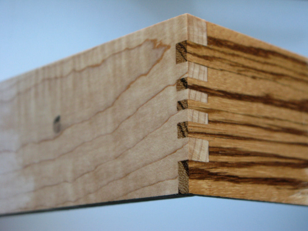

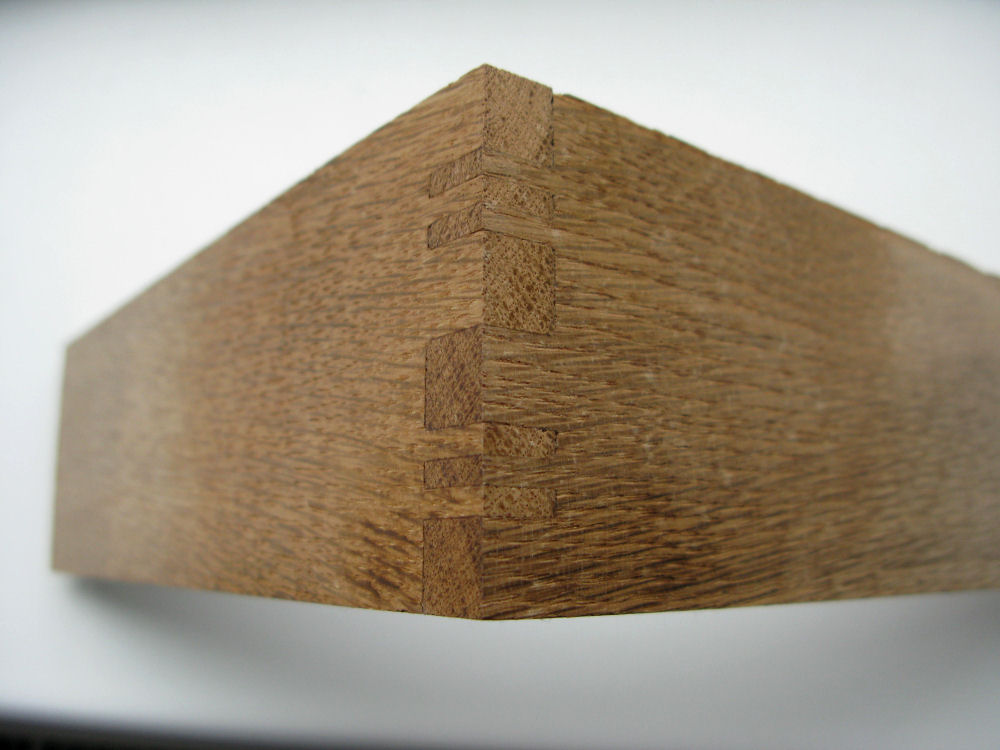

Second attempt, very pleased, this was the 'Antenna' preset pattern across a 58 mm width, 10mm thickness, cutter size 3 mm diameter. cutting time 5 minutes total.
Attachment 14304
Looking good Eddy nice work, a tip to avoid any break out on the back edges. Like at the top edge on the right hand bit of timber shown in the pic, use a bit of scrap even MDF to support the timber edge that is being cut. Another thing is to leave the finger slightly longer then sand down flush after gluing up.
Try doing something like a dovetail + finger joints, I would be interested to see how that comes out.
Mike :)
longy
Mike :)
Yes, thanks, I didn't bother about breakout this time because it was just a test and I didn't think it would turn out so good. I did leave an allowance for sanding flush, it's called Cleanup Allowance in the script, I left 0.1 mm but next time I might leave 0.2 mm.
Dovetails might be next but I think these days they are over rated, I read that the only people who look for them are those interested in making them, that's why I went for finger joints, thinking the pattern was more eye catching to your regular punters.

2 Attachment(s)
Interesting video here; http://www.finewoodworking.com/how-t...ngth-test.aspx
Also I've updated the script, it does stock with different thicknesses and can work in the X or Y axis, here's a test today. I keep forgetting to specify an odd number of fingers in order to get a symetrical pattern on each piece. :stupid:
Attachment 14345Attachment 14346
