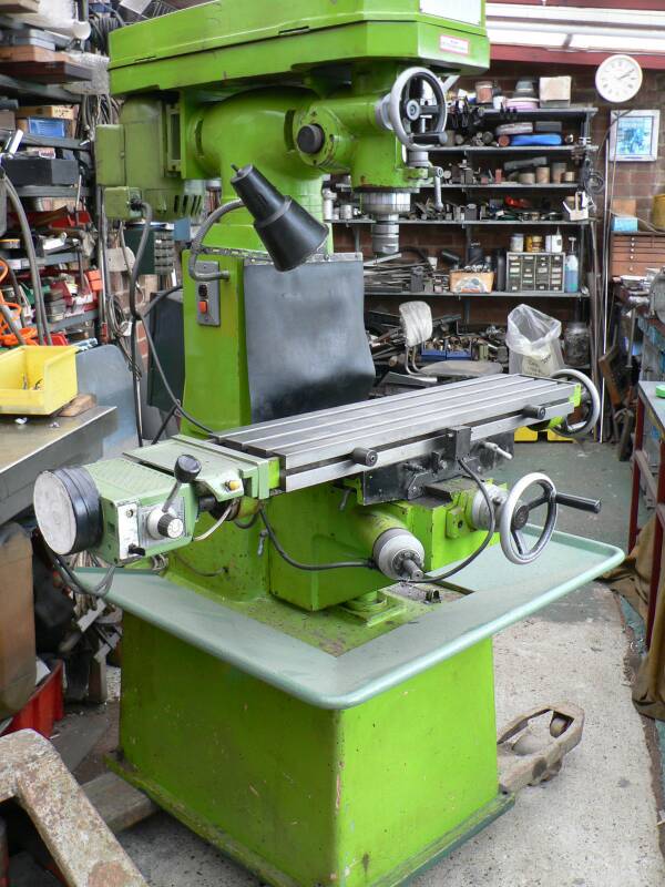

So this is my Warco Knee Milling Machine. Just as a project I would love to convert this machine in to a CNC Milling Machine and hopefully make some money off that machine or just use it for projects. I have now had some experience in constructing the electronics after building my custom power supply for another custom CNC router. I know i should convert the leadscrews to ballscrews however money is tight so Im gonna expect some inaccuracy. Im pretty comfortable on how I will be attaching the steppers and driving the axis', however Im not too sure what size motor to go for. I know that the three main contenders would be the Nema 34 or 42 or just not going for a stepper at all and going for a servo. However, as I have already mentioned this is a project and not a Job therefore money is tight. I have found a good kit for the Nema 34 with DM860A drivers and 60v/350watts power supplies at a really good price. Im slightly concerned about the holding torque. I know that the handwheels on the mill atm are easy to turn by hand so I guess you don't really need much holding torque. Any suggestions on the size of stepper would be wonderful. I don't wanna make a mistake buying inadequate steppers.
Also any suggestions on good suppliers of timing belt pulleys in the uk or aboard (with cheap shipping) would also really help.

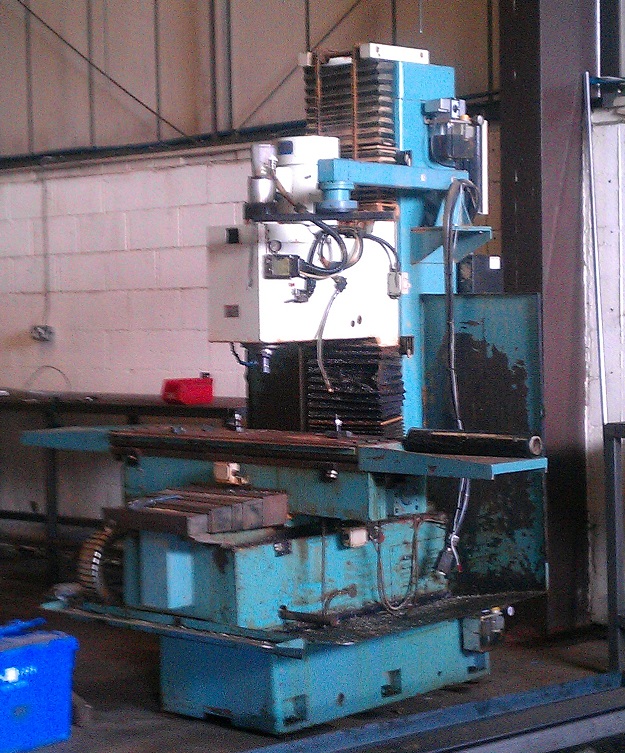

Nice machine Jazz. Where is the controller?
Re: Converting a Warco Mill to CNC
JAZZCNC
Nice Semco bedmill there Jazz, is it an 800 or 1000. I have 4 x 600's, great machines the first vmc's.
Web Goblin
In that blue box on floor in front of it. It's Anilim controller which normally hangs off that arm on side, DC Drives etc are in cabinet on rear. Now redundant to be replaced with Servo's and Cslabs controller.
i2i
It's 1000 and cracking machine or it will be when it's done. Still under cover at minute waiting for my attention when weather breaks and I eventually get some free time for my self.

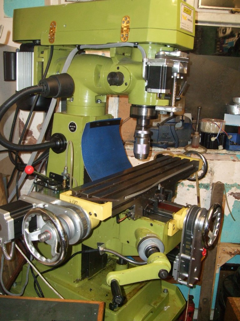

Like this.
http://www.mycncuk.com/attachment.ph...id=14322&stc=1http://www.mycncuk.com/attachment.ph...id=14323&stc=1http://www.mycncuk.com/attachment.ph...id=14324&stc=1
Works quite well for a my uses.
Some of the parts used
Stepper motors
http://www.ebay.co.uk/itm/German-Shi...E:L:OC:GB:3160
Stepper driver
http://www.ebay.co.uk/itm/Single-Axi...item2ed842f005
Although I have blown 2 up. One was by turning the Travel handle while it Was moving.
With careful treatment they now seem ok. I would like to try something better. May be a Gekko....
Ball screws on X Y X
I bought 2 Chinese Ball screws with 4 Ball nuts , and had the machine the ends to 16mm, then made suitable sleeves to fit the bearings.
http://www.ebay.com/itm/2-anti-backl...:X:RTQ:US:1123

Nice Job. Did you not consider higher voltage drives to run the nema 34 motors. ..Clive
thorphar
In light of this recent discovery. I have re done my basket.
I use to use AM882 however, after looking around online someone mentioned the DQ860MA Driver being ok instead of the AM882. Im just worried about the lack of sensor less stall detection not being on the DQ860MA. Thoughts ?
Stall detect only works after 300rpm so it's not such a big deal for a mill. But what is bigger deal is how they handle resonance better and give smoother running motors. The DQ860ma are not as good in my experience so I wouldn't use them over AM882 or better still the updated EM806.
ZX12RUSH
Very nice looking build! So apart from blowing a few drives, any other problems?
