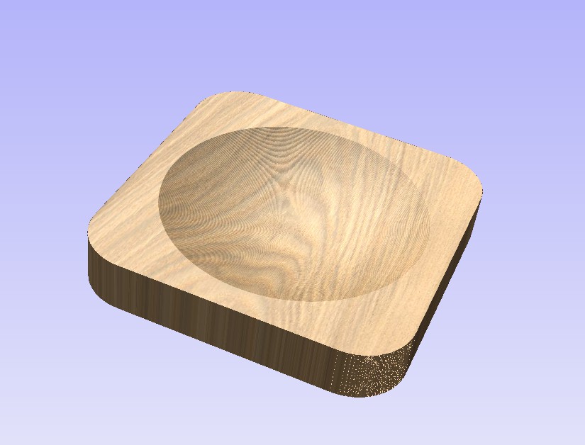

OK so I'm back looking for help.
The Mrs has now suggested that she would like me to make her a square oak block with a bowl carve in to it so she can put her jewellery in at night.

I have tried but all I get is a round hole with flat sides....
Any ideas ......

Is it something like this you are wanting ?
http://www.mycncuk.com/attachment.ph...id=14362&stc=1
Only took a minute to design and tool path up im not sure about vcarve pro as im using aspire 4 but i can send you the gcode or maybe stl if i can figure that bit out
That was exactly what I wanted to make thank you for your help i will be in touch.

I would draw a circle the outside dia. and then cut it with a 'Z Profile' the shape of the bowl cross section using a ball nosed end mill.

You can't just run any old code on any machine, you'd have to say what cutter you want to use, what rpm your machine can run and what controller your machine has.
Speed and cutter must be specified in CAM to generate the moves, the right Post Processor for your machine controller must be selected to generate the correct "flavour" of G-Code for your machine.

I think you need to do a cad course (Online youtube is cheapest) ASAP there is nothing to this design not dissing Jester I'm sure he'd tell you this is a 2 minute mock up.
How I would do it draw rectangle, extrude, chamfer corners, create sphere, adjust height of sphere until appropriate then subtract from solid (Extruded rectangle), wrap with texture is optional, job done! If you did a cad course you'd learn to make this after the bacon sandwich but before the morning coffee.
