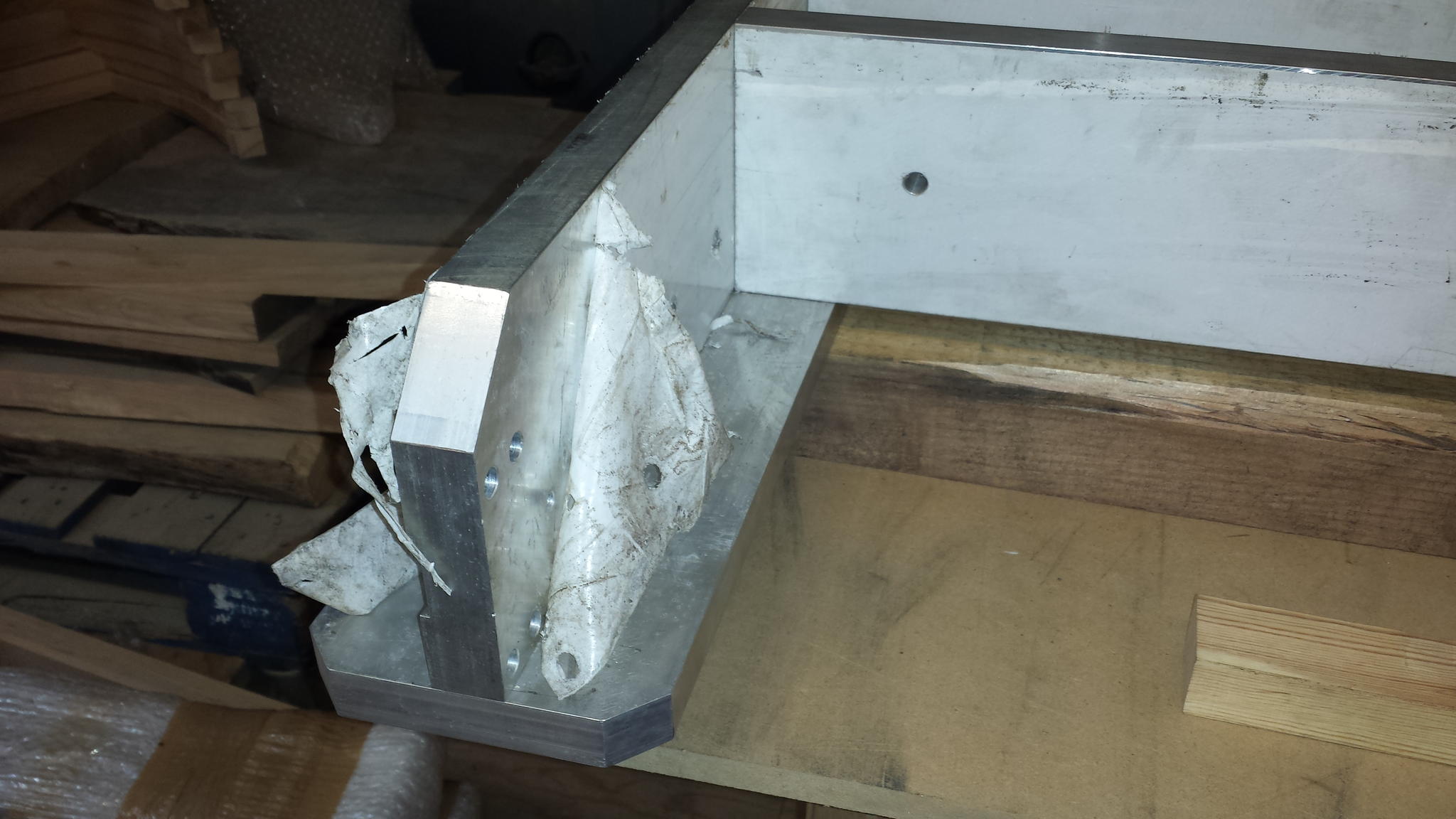

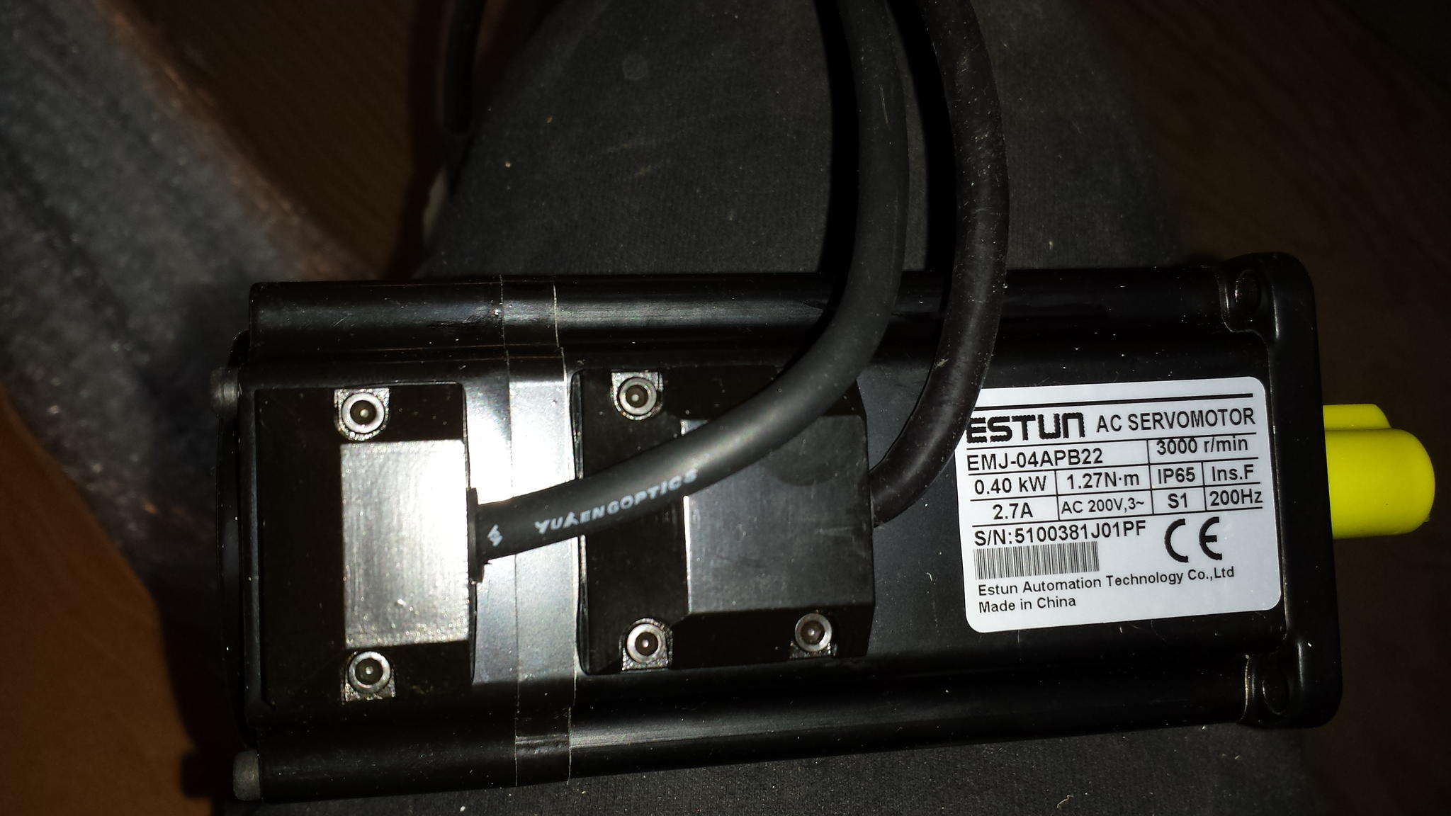

Well not at all what I was expecting! I was talking to a friend about a build and the conversation has ended up with me adopting a partially completed build.
The machine was started as a project by a precision engineer friend and has been abandoned because of lack of time and his moving overseas for work... I still find it hard to believe he is allowing me to play with it.
Not much detail yet, I am still waiting for the original drawings so I know what the partially finished parts are for and what machining is still needed...but collected a few bits last week.... probably 350kg of them...
A pallet full of parts, some machined, some partially machined and some waterjetted.... the visible ballscrews are x axis and 32mm!!!

30mm hiwin x rails, 20mm for y &Z
most of the frame is 30mm aluminium... gantry is extrusion, sixes to follow
everything except the BOB in the electrics... servos and controlers etc...
2kw watercooled spindle
extruded aluminium table

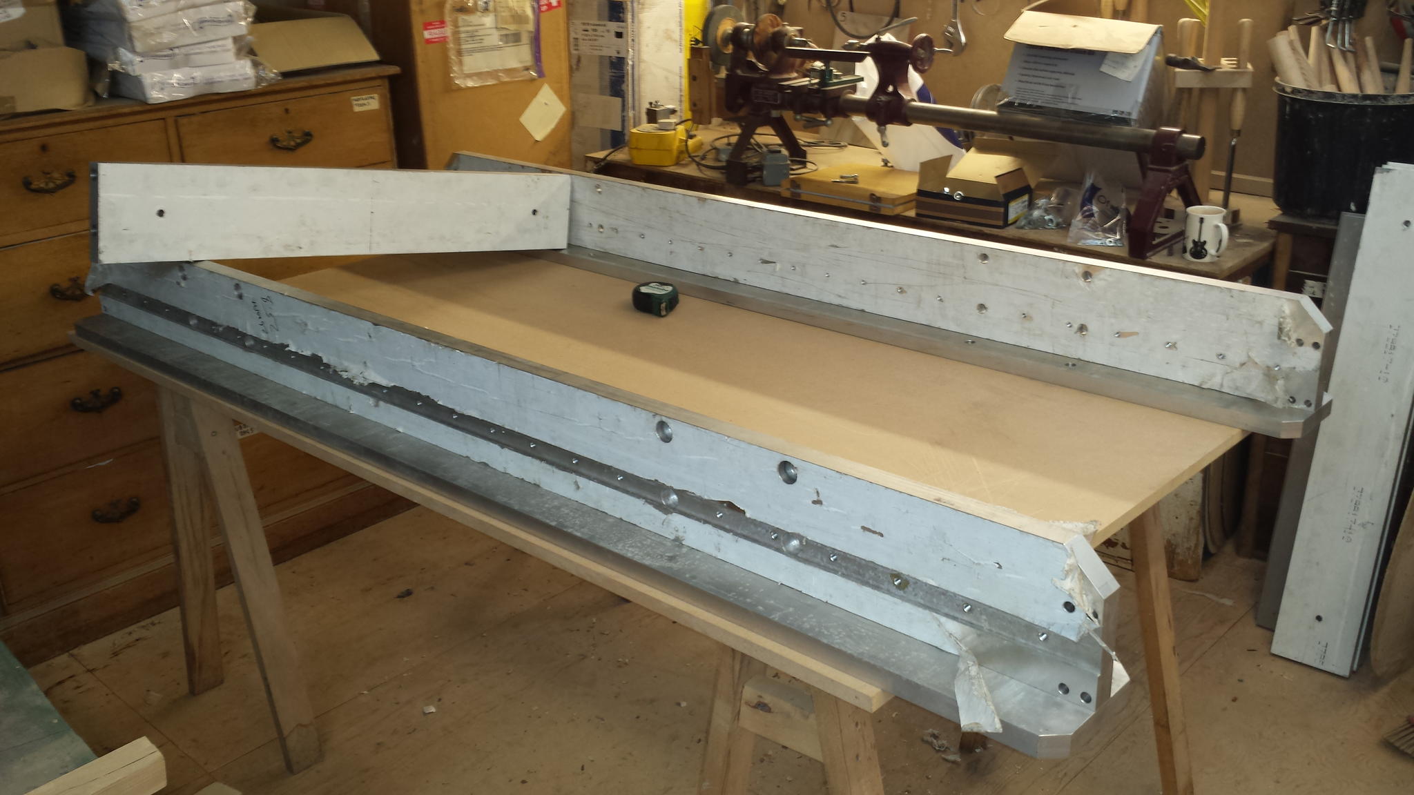

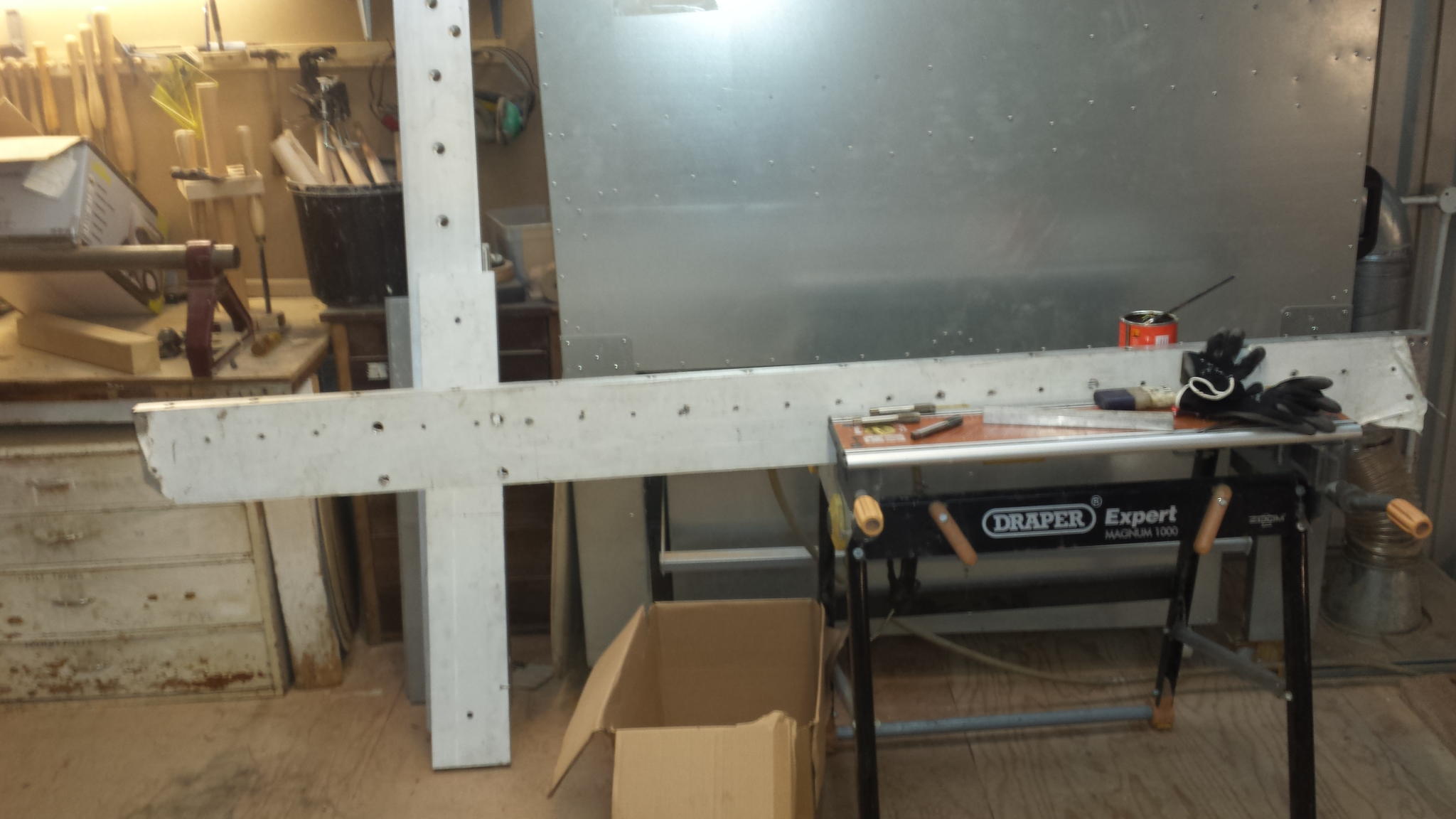

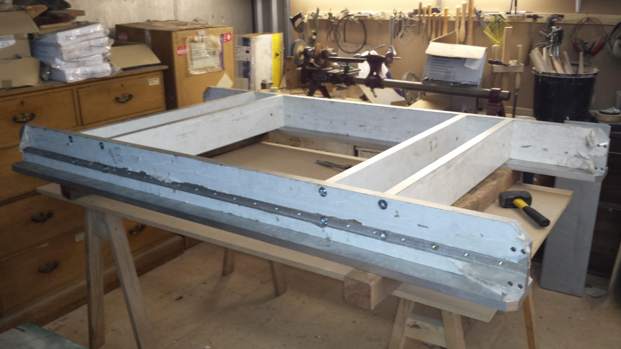

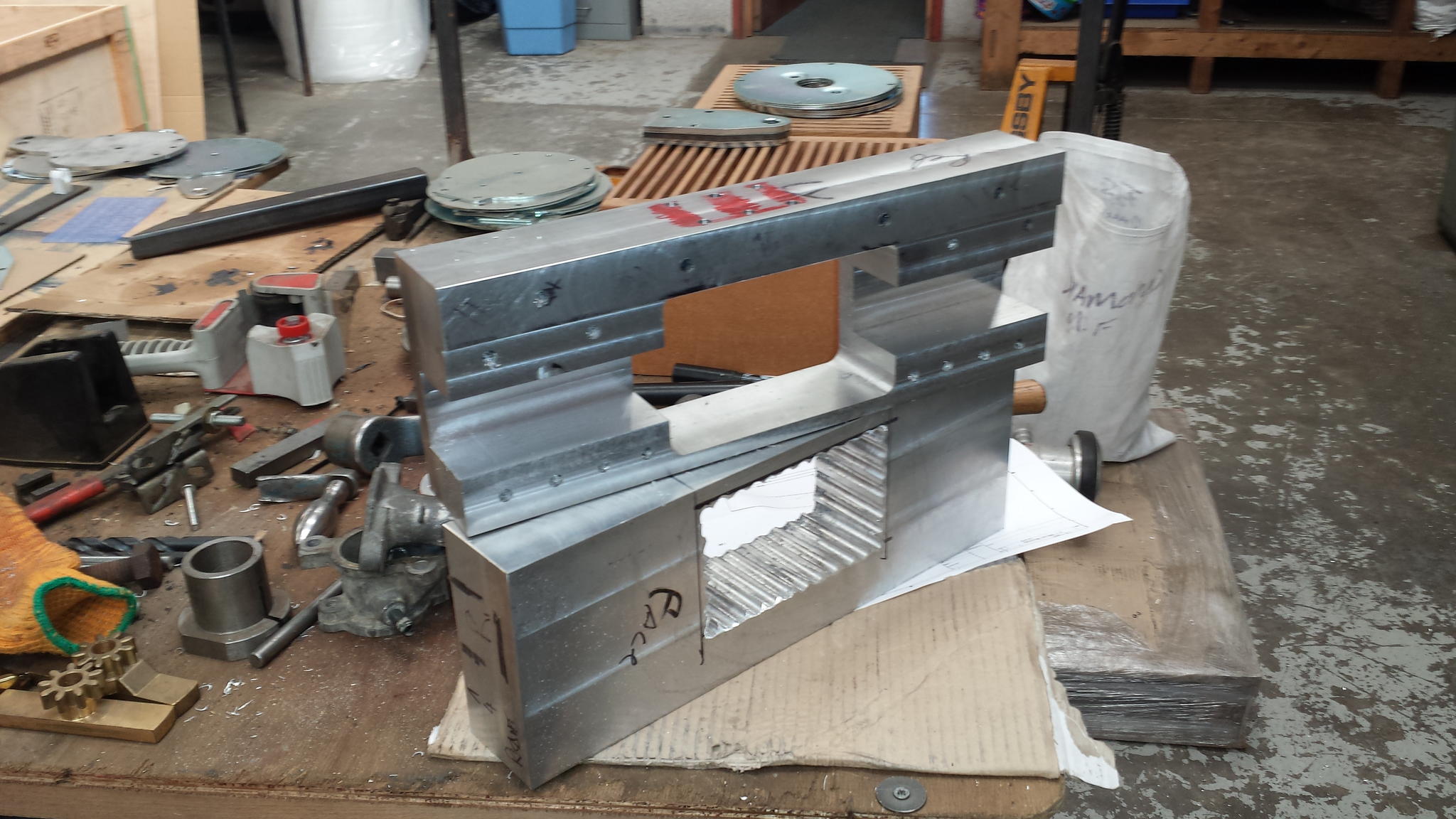

Got a little bit done this week, finding it helping with my rehabilitation as I need to use both hands for most of it
28 m16x50 holes tapped, 48 m8 tapped holes for the rails, all by hand as the company that did the original machining "forgot"... thanks for that:livid:
http://www.mycncuk.com/attachment.ph...id=14498&stc=1
test assembly... I now know the approximate size is 2m x 1.1m between rails, and first problem... one of the cross rails is drilled about 2mm out, still thinking on how to best fix that, any suggestions gratefully recieved
http://www.mycncuk.com/attachment.ph...id=14501&stc=1http://www.mycncuk.com/attachment.ph...id=14500&stc=1
nice chunky assembly, 160x30mm plate
http://www.mycncuk.com/attachment.ph...id=14502&stc=1

Interesting machine
The cross rail being drilled about 2mm out- if I understand correctly then I think you need to slot the through hole. If you don't have a mill then you may be able to use a router and carbide bit or pillar drill with counterbore bit plus some filing.

not an ideal solution, but I think it will be adequate, there is a 3rd bolt for each end from underneath so plenty of fixing, and the counterbores are going to be covered at some point with something to keep the ballscrews and rails clean

What about filling the holes with stuff then drill new holes.
https://www.machinemart.co.uk/shop/p...inium%20repair
Re: Adopted Build - my first CNC router
I would worry doing it that way eddy, as the new hole would mainly be in the filler... and is 50mm deep
only alternative is to drill out to about 24mm tap & plug, pin it and then redrill & tap.... but holding this vertically to drill will be a right pain.
think it will end up on the inside and ream holes to suit in the side rails

i would use a propane torch, melt some aluminum and pour it in the hole. then machine it again. i have done it, it works. 15 min fix.
I would just plug the hole, then do a new hole...if you can machine the plug to fit snugly of course.

Just slotted the holes in the end.. far easier and really no need to mess further, especially as no one will ever see them once the covers are on

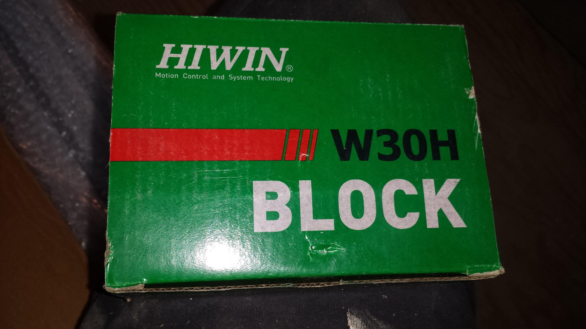

basic question I guess but not one I have managed to find a satisfactory answer to....
Hiwin rails and bearing block fitting (and hopefully removal)
I need to trial fit some of the carriage parts to check a couple of things work as we want.... so I need to temporary fit the rails & bearings. Reading the manual it seems the rails must be horizontal when i fit the bearings... ie bolt holes up, slide on using the plastic packing piece as a guide and I assume ball bearing keeper?
Is this the only way to do it?
can I remove the bearings using the reverse ie sliding off the rail onto the plastic packing piece?
are the balls free to fall out if I get it wrong?
thanks

The Hiwin bearings I used needed the plastic keeper in place otherwise the balls fell out, I found out the hard way. I found that by being careful the bearings would slide onto the rail if it was horizontal or vertical but in all cases the plastic keeper must be kept pressed up against the end of the rail leaving no gaps for the balls to escape. I can't remember if this applied to both the 15 and 20 sizes but it certainly applied to the 15's. Having them well greased helps to keep the balls in place.

thought that would be the case... thanks eddy
removal the same way?

Yes it is.

I've slid my blocks on to the rails and removed them multiple times while setting up, using the plastic retainer pushed against the end of the rail each time. No problems so far, although I just know I'm going to have a wobble some time...
