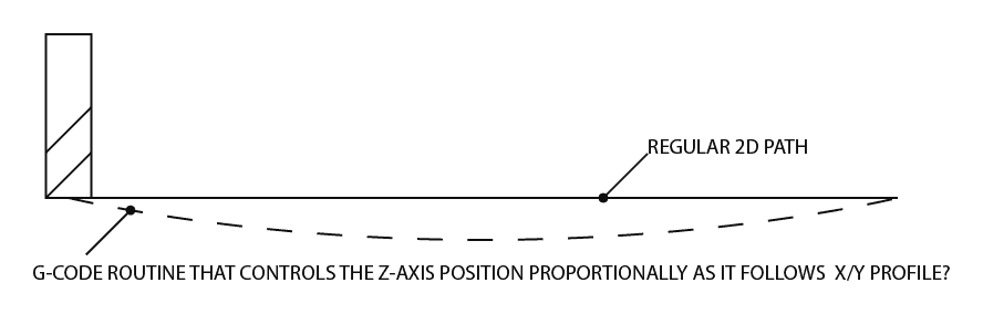

Code to plunge Z gradually and then retract along length of a profile path.
Vectric's Cut 2D does an admirable job of generating 2D tool-paths, but I'm wondering if there's a bit of G-code that's available to add in which will plunge the cutter to a specified Z depth as it travels to it's halfway point along the 2D path and then retracts the cutter as it travels along the second half of the path. I imagine many of the programs that carve letter-forms into wood use this technique, but is the Z-depth explicitly specified in each line as the G-Code is generated, or is it controlled by a clever bit of programming at machine level?

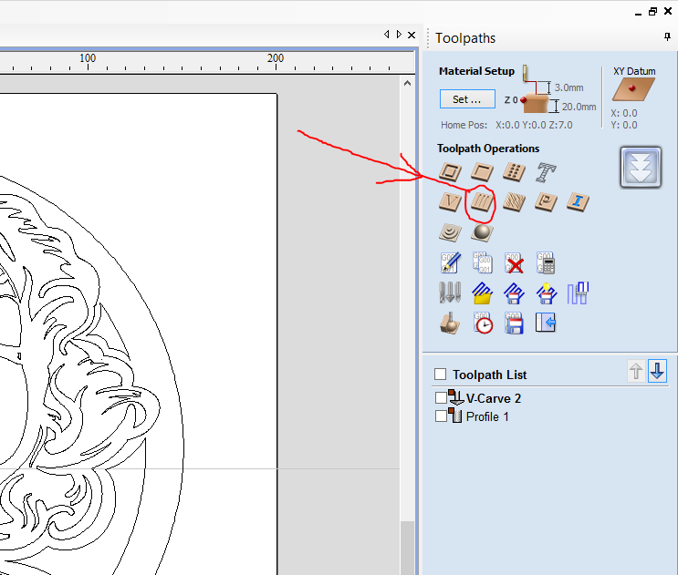

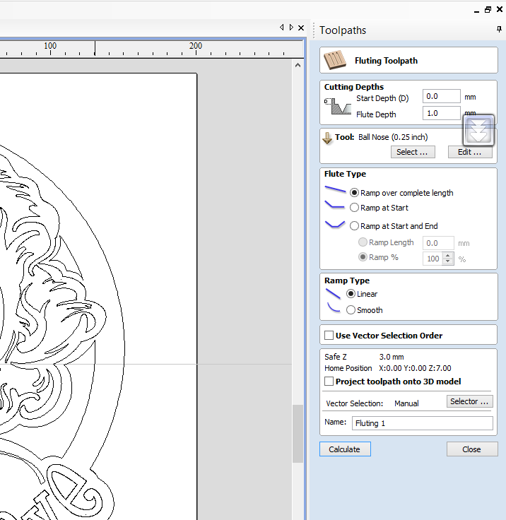

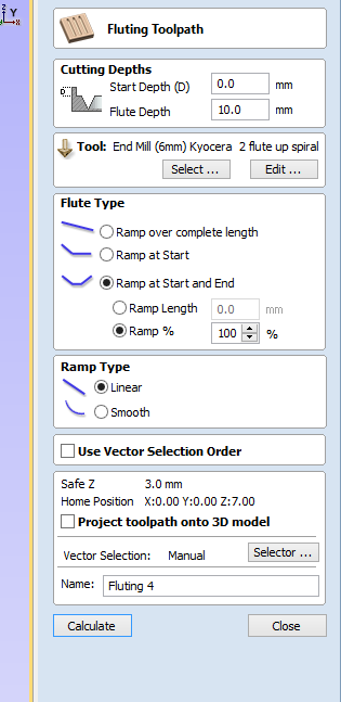

>Vcarve Pro and Aspire have it.
Indeed they do, but I'm not using either of 'em... I was after a manual tweak that I could make to my standard profile code. Any chance you could output me some G-code for a fluted straight and a fluted curved line to see how it's being done? (If you could do examples of a linear and a smooth ramp that would be cool!)

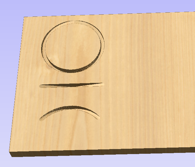

Re: Code to plunge Z gradually and then retract along length of a profile path.
Quick answer is that the gcode instruction to cut a straight line (G1) generally has up to three coordinates included. If you are cutting in 2D, then these are the X and Y coordinates to which the tool should move; no Z coordinate so the tool stays at same height. If you want height/depth of cut to vary along the path, then you add a Z coordinate and the motion control software will calculate the tool path so X, Y and Z all vary at the right rate to get to the end point in a straight line. So the answer to your question is that yes, the Z move is part of the generated gcode. Aspire, vCarve, etc, all do this when generating 3D cutting gcode. If you were really keen, I suppose that you could find all straight cutting moves, and edit them to include an intermediate point with lower Z point plus original Z value in the original point. Doesn't sound like an easy job to me! Probably why Cut3D costs rather more than Cut2D...
Cheers Boyan. Much appreciated! As Neale said - new z value on each line, which is what I suspected.
