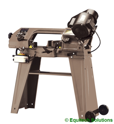

Sealey Metal Cutting Band saw Saw
http://www.mycncuk.com/attachment.ph...id=14671&stc=1

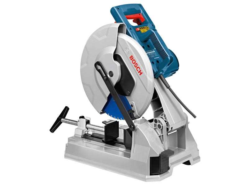

Bosch Dry Cut Metal Cut-Off Saw
http://www.mycncuk.com/attachment.ph...id=14672&stc=1

		Bandsaws of any kind do tend to wander sometimes, especially if the teeth on one side are more worn than the other. Also which has the cheapest consumables ? blade band vs disc'
I imagine the bandsaw could cut bigger cross section material, but if all you want is 60x60 than both would do.

		i have the clarke version of that bandsaw
and found the stand was made from 2mm sheet
and bent where the rear wheels where.
great for cutting big stuff as you can just leave it to get on with it.
without having to hold the handle etc.
but as eddy said. they do tend to wander.
for straight cuts i got an evolution rage 2 cut off saw.

		I   have both similar band saw and the RAGE 2.
I use much more often the Rage. Its faster.  However my advice will be to get the Makita, Dewalt or Bosch dry saw, as the Rage is a hype, nothing more than geared Chinese crap. Its flimsy, the base is twisting when loaded with 100x100, no fast lock clamp. I knew that before but there a was a momentary monetary weaknes, so i bought it against my better judgement. Well, it payed itself on my first machine, so who cares.
Apart from steel the dry cut saw cuts aluminum and wood like a butter.
However if i had 500-600 quid budget, i would look at second hand pro liquid cooled dry cut saw or a bigger real liquid cooled band saw. cause these are toy really for a serious workshop.

		I've got a rage 2 and whilst its not the highest quality bit of kit, for the price it's awesome and when patient setting up I've cut within a fraction of a millimetre with it.

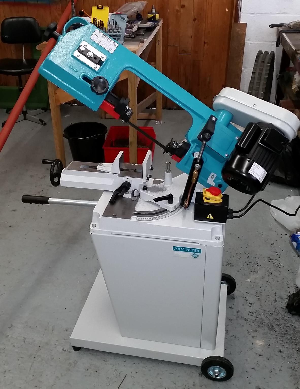

		I got this horizontal band saw http://www.axminster.co.uk/axminster...utting-bandsaw which I use for chopping up small billets etc.  You've got to set it up and keep an eye on it bt it's pretty accurate.  Advantage is that it'll cut at angles too which comes in handy and you can leave it going whilst doing something else.
Attachment 14675
If you're cutting lots of 90° cuts then a cut off saw would be better.

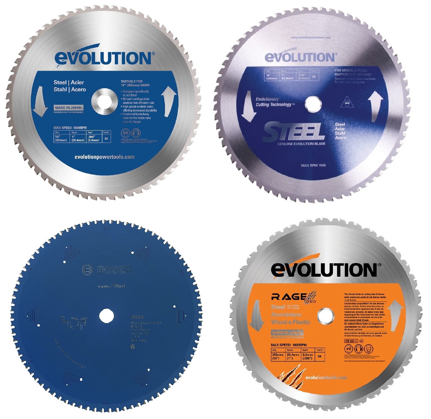

		Hi all,
I intend to build my own cut off saw and now I'm searching for a good blade primarily for steel cutting. I am looking for a 355 mm dia. blade.
I see that the Evolution steel blade has a new model at half the price. On the expensive one is written "made in japan". 100 vs. 50 EUR.
The Bosch blade is 90 EUR reduced from 264 EUR on amazon.de
I am confused about these price changes.. Could be that the "made in japan" blade will last twice as long as the cheaper one (probably chinese)? Is the bosch blade a better option? As I intend to occasionally cut other materials than steel, should I look for the evolution rage blade? Bosch says that their blade will not cut aluminium.
Any thoughts are really appreciated.
Attachment 20383

Dangle_kt
			I'd be interested to know though if anyone has successfully fitted one of the steel blades (like above ^^^^) onto a chop saw that runs an abrasive disc currently?
 As far as I know the abrasive discs needs much higher RPM with lower torque. For a 355 mm steel blade you need 1400 RPM

		These saws are not more dangerous than an angle grinder or any other machinery . Provided you wear the proper protection. I wear face shield and ear  protection.
The difference between the blades is that the orange one is multi material blade, look tooth profile. I still have the original one and its been sharpened at least ~7 times already. It has ~5 more lives. The teeth that are in between the cutting teeth should be be lowered also after 3-4 sharpenings.  I pay 12 euro  and is done on a pro CNC sharpener, not diy.
Bosch on other hand as CMT / Freud/ in woodworking are the best blades, especially the multi material ones. I would not doubt the Bosch blade.
IMHO buy the cheapest, if they say its for that machine, then its a no brainer, half the price or not.
I remember myself bragging about creepy chinese cutter 2 years ago. Now i use mainly chinese carbide cutters and i can assure you the quality now is 100% as brand micrograin carbide ones, if not even better in some cases, what i found in real life. Of course i look from whom i buy.

		[QUOTE=Boyan Silyavski;87734
I remember myself bragging about creepy chinese cutter 2 years ago. Now i use mainly chinese carbide cutters and i can assure you the quality now is 100% as brand micrograin carbide ones, if not even better in some cases, what i found in real life. Of course i look from whom i buy.[/QUOTE]
Hi Boyan, I cannot fully agree with you.
There are a lot of different grades of micrograin carbide. You cannot say that a tool made of chinese carbide has the same quality as a Swiss or Japanese one. Even with the same carbide grain size and amount of cobalt used, the difference in manufacturing techniques will give different results of the properties of the resulting material.
I bet that your Rage blade is the "made in japan" version :joyous:

paulus.v
 I used mainly 3mm and 6mm bits on my CNC for a couple of years/ now 12mm mostly/ . 6mm Kyocera micrograin carbide which is maybe the finest example of carbide tool and super polished, was my golden stabndard. will cut as 5 times as long as Freud similar tool. Now i buy chinese ones that cut as 1/3rd as more than the Kyocera. Kyocera 25-30 euro per bit new. Chinese 4 euro.
But just FYI now i try to use mainly insert tools. OMG, they last forever !!! The best carbide possible, look at CMT. And cut perfectly.
