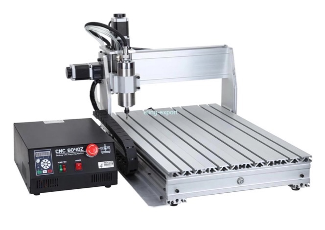

I cannot get the spindle to spin under computer control even when running gcode.

Eddy, there is some confusion from Kendrick here - I have spoken to K on the telephone and he has a 400hz vfd and a 24k spindle. I do not think that he can control the spindle speed with his software (only from the vfd and he is quite happy with that), he is unable to stop/start the spindle and I think he should be able to do that if someone can advise him. I can't help because I use dedicated controllers on both of my machines (commercial system, not mac), but I am sure someone on here can point him in the right direction. G.

Starting/stopping the spindle is often done using a output which controls a 5V Relay who's contacts connect to the VFD run Signal.
Often the BOB will have Dedicated on board relay connected to output.
Reason for the Relay is that the VFD run signal will probably be 24V so can't be directly controlled using the 5v Output.

No the BOB is short for break out board. That second link showing the Guts isn't what you have because it shows a USB Motion control card and you had Parallel port based box. The BOB will look very similair to the USB card in the picture.
NOW BE WARNED.!! Messing around with BOB without knowing the pinout and numbers is sure fire way to KILL it.!!
BOB's and esp a cheap one that will undoubtly be inside this box are fickle creatures at best of times so don't mess unless your sure what your doing.

There is a kind of problem I have, when I first got the Cnc going it was not that fast but liveable with, after calibration it now moves super slow fine for cutting but not from getting from a to b when not cutting. Surly if the original speed could be achieved to start with why can't it use it now, I tried travel speed on the mach3 screen with no luck I can slow it dow even more but not speed it up to its original speed. I can live with the speed if I have to but a faster travel speed between cuts would be nice.

Kendrick57 I am sorry but I find it very hard to read your posts as they seem to jump all over the place. I think it might be better if you address just one point at a time (ie one point per post).
Now if you can get your cutting speed (G1) as fast as you need then there should be no reason why you should not get your "travel" Rapid speed (G0) faster.
How about you posting some screen shots up of your Motor tuning from Mach3 and a short sample of your gcode ( say the top 30 lines) this might help to see what it is you are trying to achieve. ..Clive

The biggest problem I have I suppose at the moment is speed Now I never expected it to be super fast, the speed it went at when I first got it going I could live with but after calibrating the machine to move the correct distance(to start off with it thought 10mm was 31mm) the speed of the machine went from a tortoise to a snail. if the motors could move at one speed before the calibration it should be able to after.
It feels like a problem with speed of travel somewhere in mach3 the travel speed has been set at a set speed in mm per second.
:smile::smile: MIRICAL APIFINY OR WHATEVER YOU WANT TO CALL IT :smile::smile:
I solved the problem, it was in the Mach3 settings under Motor Turning in the config tab in the top menu
http://www.mycncuk.com/attachment.ph...id=14718&stc=1
Its the setting marked in red that is the killer, it controls travel speed it was set to 120mm per minute I will keep increasing it until the gantry does not move any faster I've set all 3 axis to 999 the largest number it will accept, changing the acceleration number to a higher figure helps as well from one corner of the cutting area to the other by positioning by hand in the far corner with the other corner as home and hitting goto zero it took 43 seconds I think that is very respectable now I just have to confirm cutting speed is still ok.

Kendrick Motor tuning is the heart Mach 3 and if not set correctly you will get inaccurate cutting and poor performance. Not sure what you mean when you say setting marked in Red but I'm guessing you mean Velocity.? With you using motion control card you should be able to much higher than 999. So this indicates to me something is wrong with your setup.
First check what units Mach is set too, Metric or imperial.? This makes a bid difference to settings in Motor tuning.
Then if possible post some screen shots of the Motor tuning screen. You will need to click on the individual Axis on the left side and take a screen shot of each screen. You must select the axis before you can make any changes then click Save Settings before moving to next Axis else any changes are lost, also push enter after making changes before moving to another setting.

Hey Kendrick, I've got the same machine with diferent control box. 43s corner to corner sounds about right for 999mm/min. I run mine at 1200mm/min. I have had it up to 2000mm/min but that's too fast for me, I only cut small parts.
