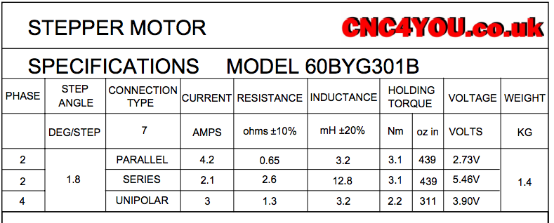

motors Nema 23 3.1nm / 60BYGH301B
http://www.mycncuk.com/attachment.ph...id=14858&stc=1

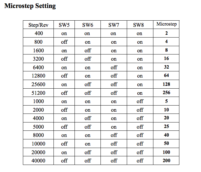

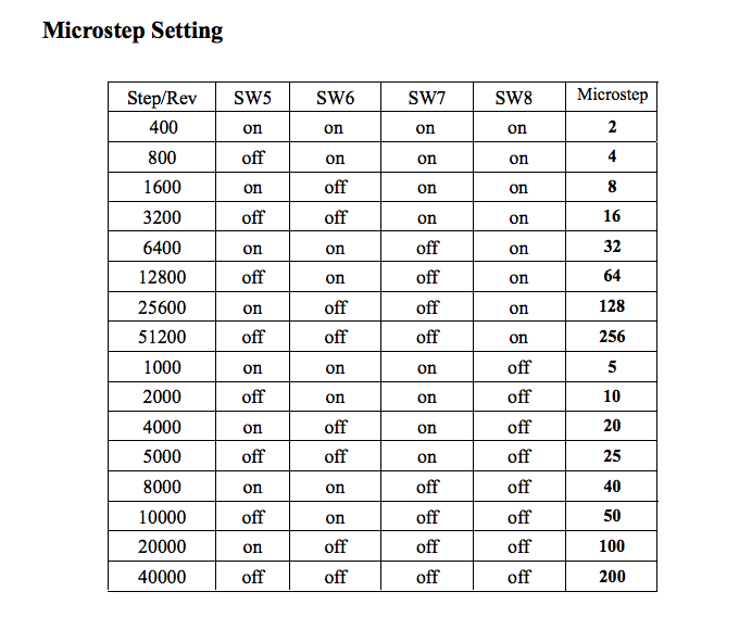

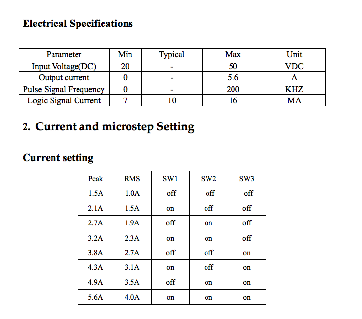

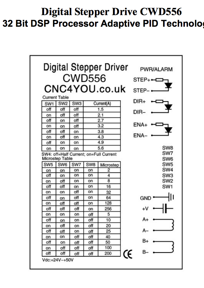

Driver CWD556 digital driver - switch setting chart below
http://www.mycncuk.com/attachment.ph...id=14859&stc=1
http://www.mycncuk.com/attachment.ph...id=14860&stc=1
http://www.mycncuk.com/attachment.ph...id=14861&stc=1

I set mach3 up in mm during the install wizard. It is not so much that I wish to tune the motors to correct mm measurements along the axis etc, it is rather that I need to set the correct switches on the driver but am confused as to what they do. I see from the spec that when wired in parallel (which is what I assume they are since they are not in series) that the current should be 4.2 amps. There is no exact setting for 4.2 amps on my drivers - the closest is 4.3 which I assume is fine. That is sw1 on, sw2 off, sw3 on - if thats all I need to do and it's correct I am fine with that. I also get that sw4 is an option in that it determines whether the holding torque of the motors is 50% or not - I have sw4 set to "off" since that sounds "sensible" to me.
It is sw5, sw6, sw7 and sw8 that confuse me - I dont know what microsteps are or what effect these settings will have - so I cant make a guess at which setting to choose from the chart above and how this affects the "steps per" value in mach3 "motor and tuning setup screen". The default of steps per was 2000 - I reduced it to 200 as per the advice above but I still dont know why exactly. The following chart shows even more info...
http://www.mycncuk.com/attachment.ph...id=14862&stc=1
Am I to assume from the above chart that the "step/rev" column of values is what I should be entering in the mach3 "steps per" field? If so, whay am I choosing one lot of settings over another? What's the difference?

Starting with motors and series or parallel wiring.?
This is a choice based on how you arrange the 8 wires. In your case for parallel wiring they should be as below.
Phase A+ = Red + Blue
Phase A- = Yel + Blk
Phase B+ = Wht + Brn
Phase B- = Org + Grn
Setting the drives:
SW 1, 2 , 3 you are correct about and understand correctly.
SW4 Reduces current to Half the Motor current (sw 1,2,3) but only when motor is stood still. This reduce heat build up in motors and should be used so OFF.
SW 5,6,7,8.!! . . . Now this is where it gets interesting and little more complicated. Your motors have 200 FULL steps per revolution so 1.8deg per step.
Micro stepping breaks these FULL steps down into micro steps.
It's here where it gets confuddling for people due to the fact they state 2,4,8,16 etc Microsteps on the drives.??. . . What this actually means is each revolution is ie 8 x 200 = 1600 micro steps per revolution.
Now Micro stepping is often misunderstood by people thinking that it's used for increasing resolution, which it does to some degree, but it's most useful use is for smoothing motor performance. You'll notice your drives can actually Micro step down to some silly figure like 256 so 256 x 200 = 51200 micro steps per rev.
Setting to this degree is pointless as typical stepper motor can only resolve to around 3200 and make real use of them the rest are wasted.
Not only are they wasted they also put excess stress on the PC or Motion control device. This is because more Pulses are required by a factor of the microstepping amount to turn same one revolution. ie 8x micro stepping needs 1600 pulses for one revolution 256x needs 51200 pulse for same revolution.
