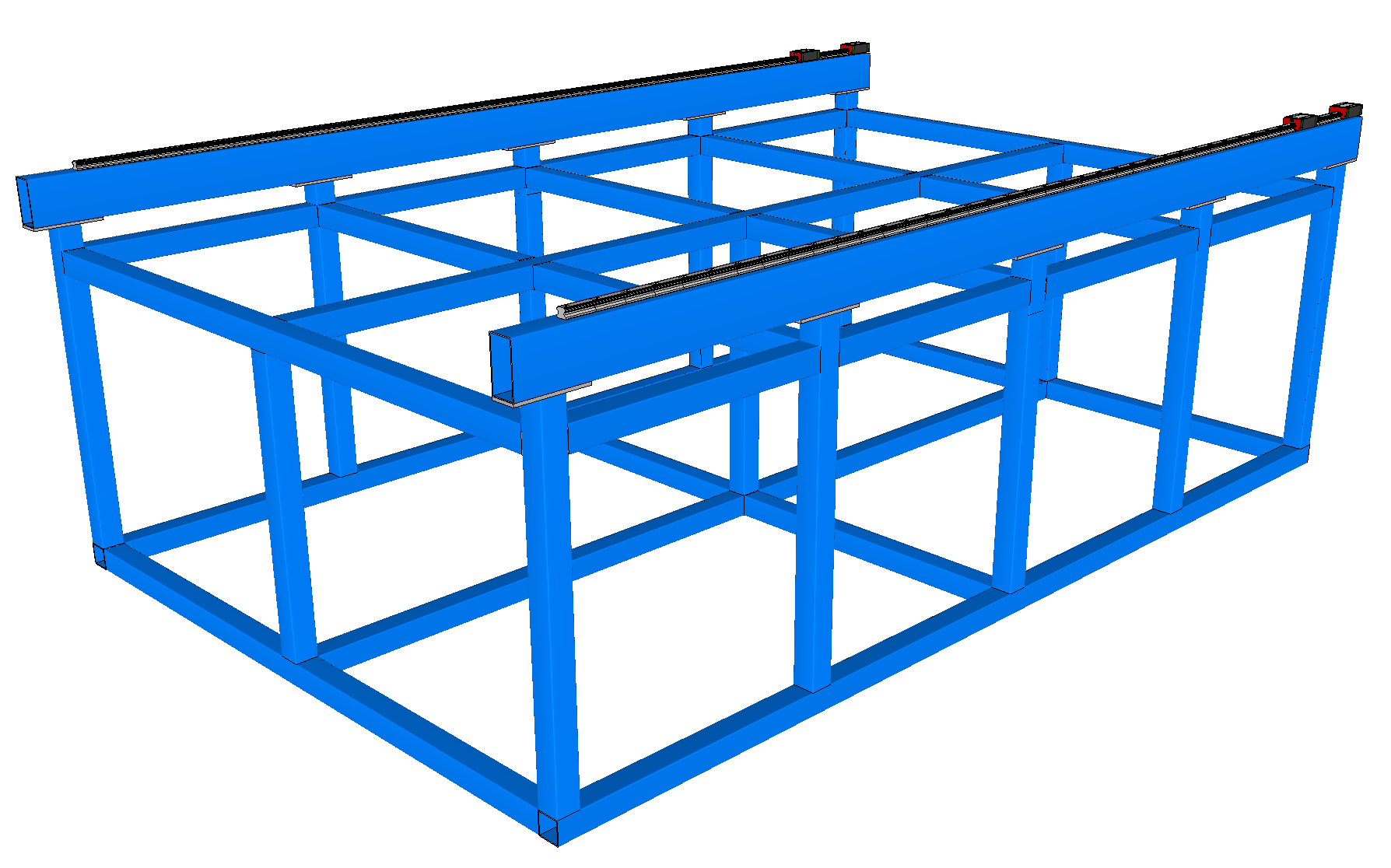

Hi All,
I have been reading this forum with interest and busily designing my CNC machine.
It will comprise of a steel frame, steel gantry and aluminium Z axis.
I want it to be as accurate as possible and will be cutting acrylic, plastic, wood and hopefully light aluminium.
Over all the machine size will be 2600mm x 1500mm (8' x 5') with a cutting area of 2200mm x 1150mm (7.5' x 4').
I have already purchased 2500mm linear rails for the X axis and will mate them to dual HGH20 linear blocks on each side.
The Y axis will use linear rails with HGH20 blocks also.
I have read with interest the threads that use bolted top rails for the X axis and I am thinking of using epoxy to level the top of the rail between the linear rail and the top rail.
I will have a rack and pinion system on either side of the X axis mated to NEMA34 stepper motors. I am going to use the R&P drive systems from CNCRouterParts.com
Here is the frame design as it stands at the moment:
http://www.mycncuk.com/attachment.ph...id=15369&stc=1

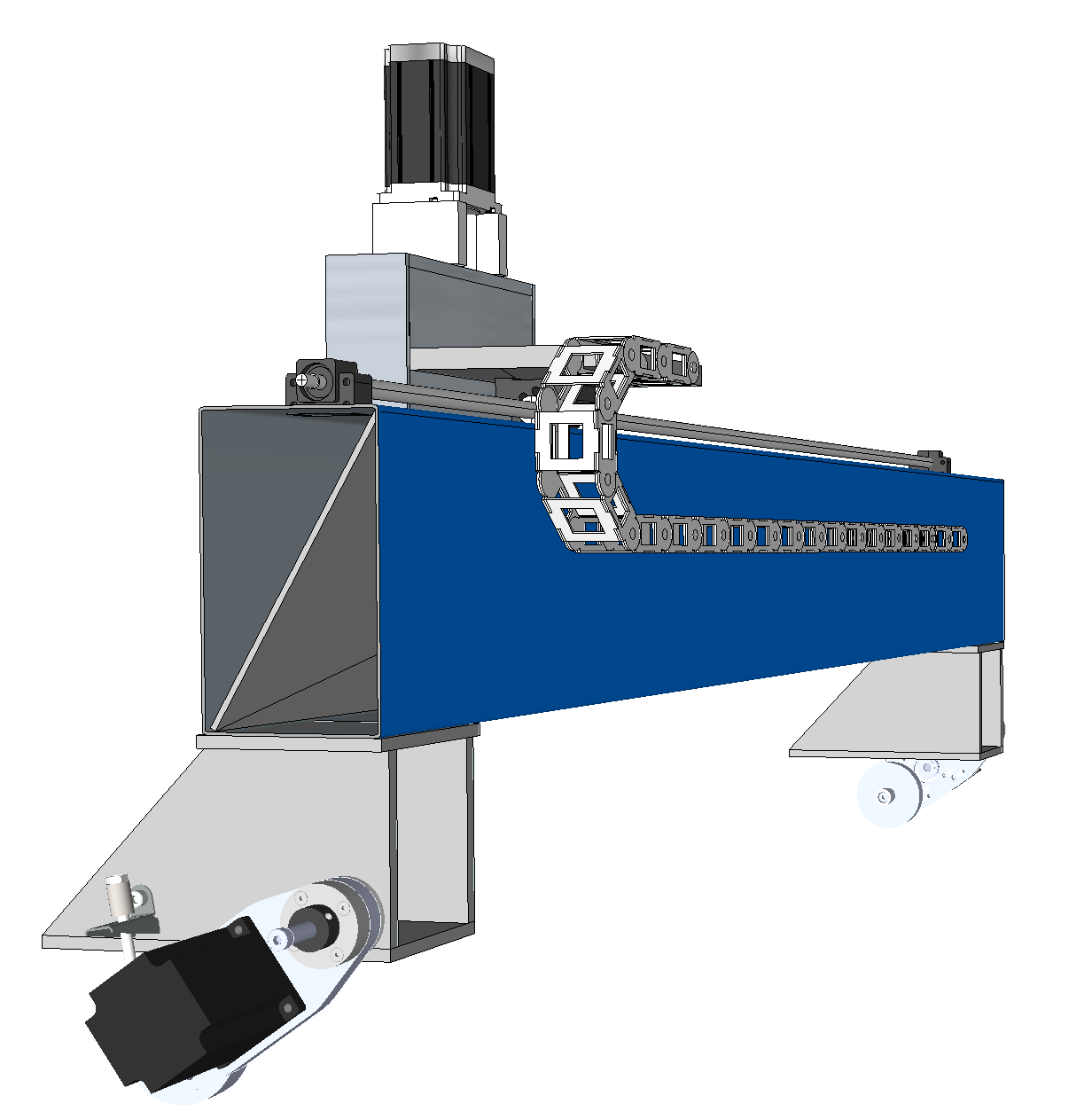

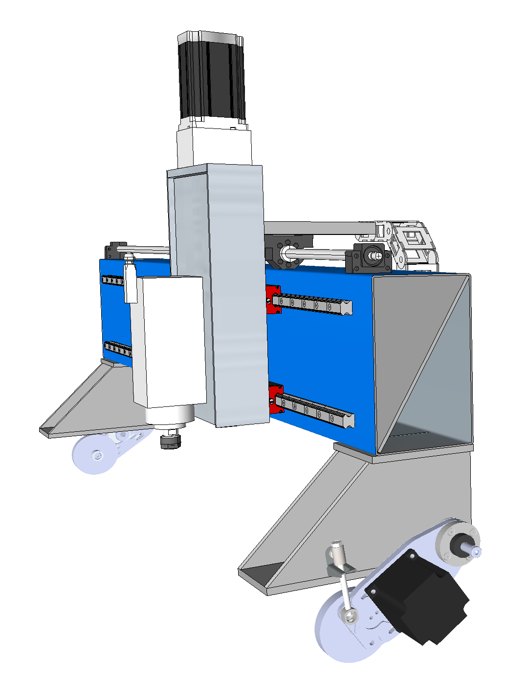

The Gantry will be made from a 250mm x 150mm RHS steel beam and I am going to add a flat plate inside the bean to strengthen it.
I am working out whether to use a ballscrew on the gantry or to use a R&P system here as well.
Here it is:
http://www.mycncuk.com/attachment.ph...id=15370&stc=1http://www.mycncuk.com/attachment.ph...id=15371&stc=1
I would like to hear peoples opinions on the frame as this is what I will weld up first.
Re: Steel Frame 8' x 5' CNC - Advice Sought
IMO:
- Dont add plate inside, add it at the back and bottom if you feel that its necessary
- Use ball screws as much as possible if budget permits it. So maybe even rotating ball nuts for both sides of the gantry.
- Add some more short supports left and right, 3 each side is too low for such long rails
Good luck with the build!

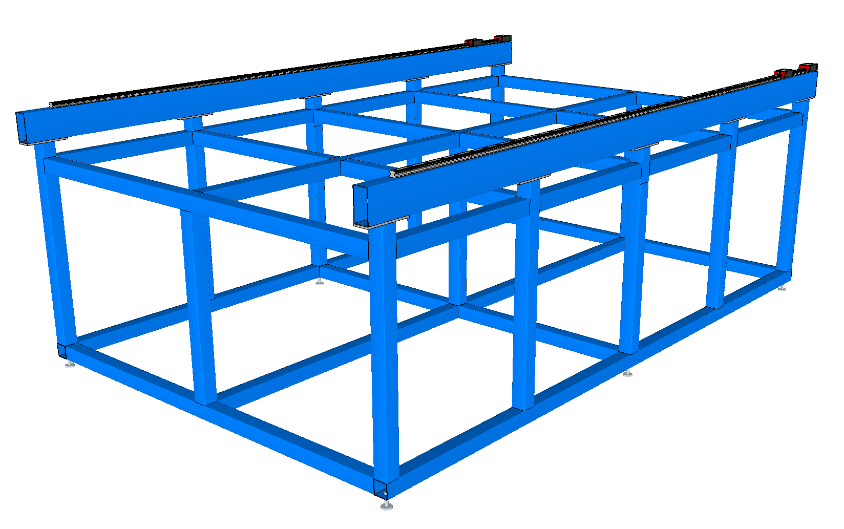

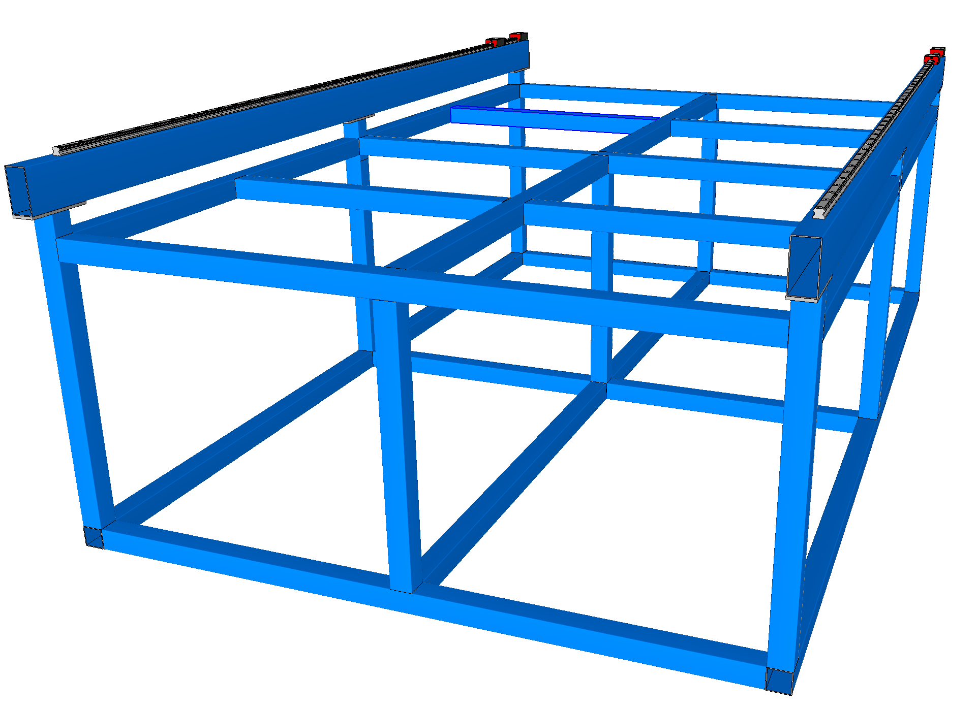

Ok, here is my updated table design with the extra supports in place.
http://www.mycncuk.com/attachment.ph...id=15416&stc=1
BrentonSpear
I personally would not put a rail all around the bottom and I would add triangulation in.
I would have it sitting on say six legs, that way it would be a lot easier to set up on an uneven floor. Also make it out of 4mm or 5mm box section then you will have enough thread depth for fixings.
It might be worth thinking about having heavier cross rails and ditching the centre supports to be able to use the underneath to store sheet materials. ..Clive
Hi Guys,
I was looking at using 50mm x 50mm x 4mm SHS steel tubing for the frame.
Silyavski, that is an interesting thought. I suppose I could do it in 100x100x4mm SHS. I will have to do the price calculations. I am planning to get all the pieces cut to the required lengths at the place I buy the steel so the size of the SHS is not really an issue.
Clive S, I had always planned to add feet to the frame.
Here is the updated design with the feet in place.
http://www.mycncuk.com/attachment.ph...id=15417&stc=1
For the gantry I am going to look at how I get a ball screw between the rails of the Y axis.
I think I will put an I beam inside the RHS beam and then remove material to make a void. I have seen other person do this and it looks doable.
What sort of span will I get with a 100x100x4mm beam? Could I get the full 2500mm?

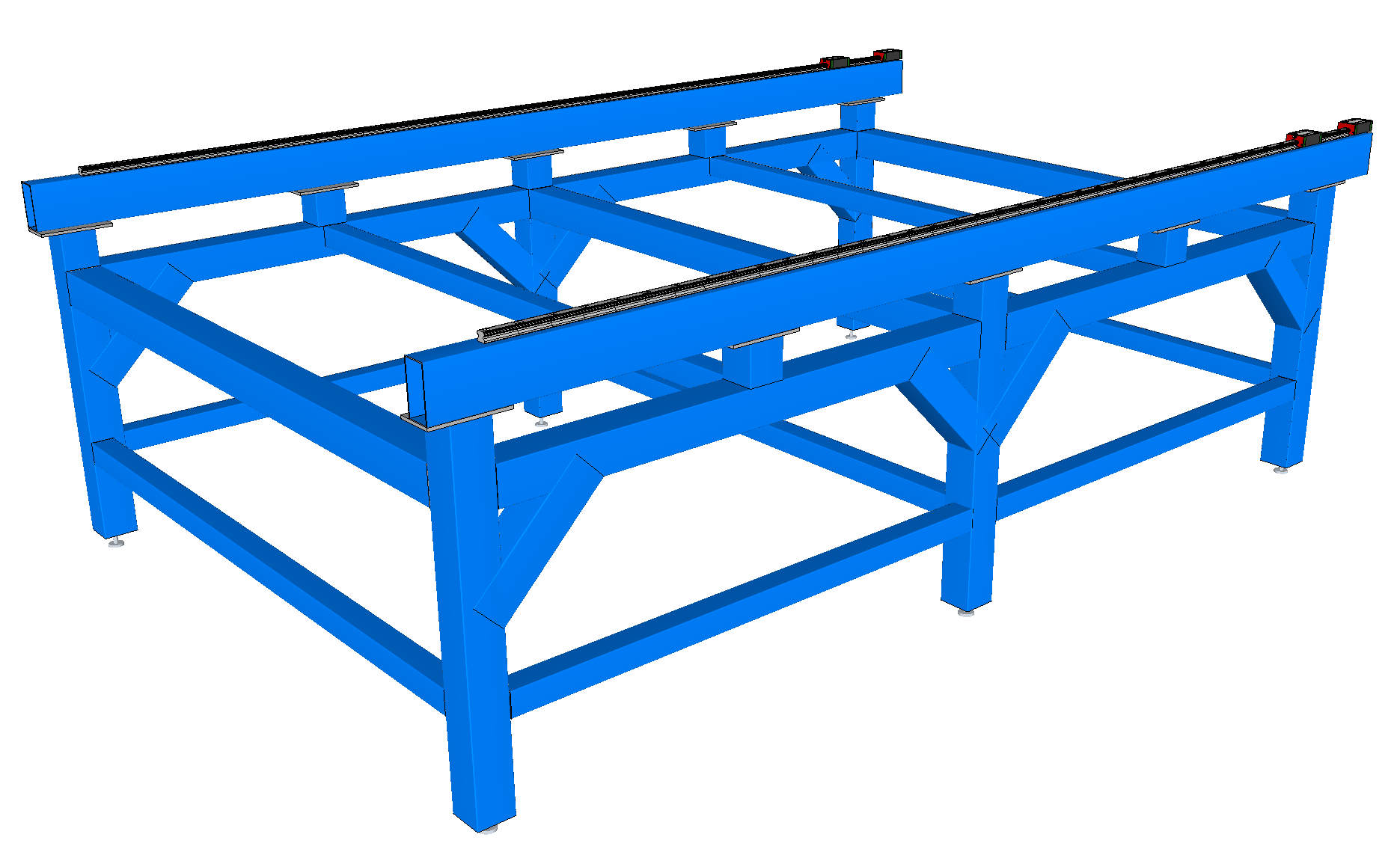

I have had a rethink on the steel size and now modelled it on 75x75x4mm SHS.
http://www.mycncuk.com/attachment.ph...id=15418&stc=1
Add some more inner pieces for the worktop area and you have it nice and clean
BrentonSpear
That is much better now with the triangulation bits put in and heavier steel section. Good luck with the build. ..Clive
Hi Brenton,
As the table looks like its coming together I'll make a few comments on the gantry in post #1. If you simple space the Y axis rails further apart so that they mount nearer the corner you'll get a big stiffness increase. At the moment they are part way along the flexible face of the RHS. Also helps as bit with racking of the Y axis due to the wider spacing of the bearings.
When I've sketched out that type of layout I've aligned the upper & lower faces of the carraige with the top & bottom surfaces of the RHS, which puts the rails slightly inboard so that the fixing bolts don't hit the top or bottom surface.
You also talked about inserting an 'I' beam and chopping back to get clearance for a ballscrew between the rails. I can see where you are coming from but its alot of work. I remember some commercial machines welding a solid spacer under where the rails will sit (full length of gantry, wider than the rails, and say 6 - 8mm deep to suit) to give clearance to the ballscrew. Probably would need the seating face grinding true to recover any distortion from the welding prior to seating the rails. Although it's an offset from the gantry, some of the small loss of stiffness would be recovered by the spacers. Just another option that is relatively simple to implement.
The diagonal plate inside the RHS would be difficult to attach wouldn't it? Unless you are cutting periodic holes in the RHS to tack weld through.

Here is the revised gantry with the spacer.
I redid the measurements and a 15mm spacer from the Gantry face to the rails is enough to clear the ball screw.
http://www.mycncuk.com/attachment.ph...id=15441&stc=1
Yes, that was the basic idea on the spacer approach. I was looking into this a while ago (been thinking about a gantry upgrade) and you can reduce the spacer offset further with:
Custom ballscrew AC bearing housing +
Custom floating bearing housing +
Removing part of the flange on the ballscrew nut
You'll have to decide if it is worth the effort for a few more millimeters.
The diagonal plate down the centre is not worth it if you only weld at the ends. Better would be a shear panel set into each end to blank off the section. You could set the stepper motor with slotted adjustment holes into one of the plates (i.e. motor inside the section) to keep it tidy.
