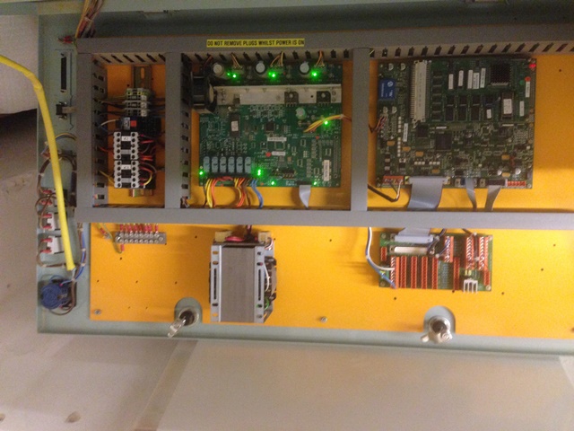

Hi I have a Boxford A3HSRi which keeps diving into the work and aborting saying "Axis overtravel, machine requested to move to x= 123...
I have also noticed the spindle collet and casing getting hot - nearly too hot to touch. The spindle clamp and gantry get warm but not hot.
Boxford say its a motherboard issue. £1500 to replace so thought I'd see if anyone had experience of this before I spend money!!
Ant comments gladly received!

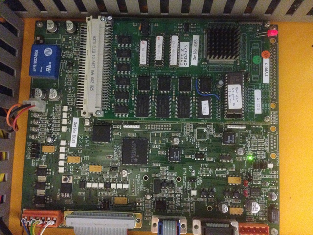

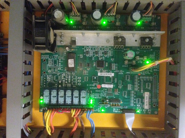

Now, now, you will need schematics for the machine, but it seems the board with the green lights is the motor drives combined in one board, the one at the right side is the motion control board and the small one should be some termination boards for inputs and out puts.
So at this stage you are pretty sure the board is faulty, right? No way to take it down send to them and they repair for cheap?
If the answer to previous is no, then you need to ask them for the schematics so we see what type of signals it sends to drives, at what voltage and so on, also what else it does and what cables enter and go out from the board. Now somebody experienced with retrofits in your area could figure which is which and what is what very fast.
If they don't send you the schematics the thing to do is see motors name plate, figure motor size, figure at what voltage are driven / transformer output/ rip all out and fit all in one board like that MX3660, its breakout board and 3 drivers integrated. Its LPT compared to the one i said before which is Ethernet but has drives integrated and from all reports is a very nice combo.

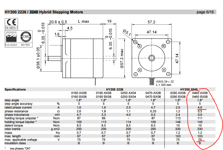

All 3 motors have these numbers in common: 190\500ST-MTR
X axis has more info....Y200-2240-0410 AY04. no idea if thats any clearer.

No such big deal as you think. from all it seems the original board is so expensive, as its separate stand alone motion control.
Ok, at least for now we have the motors identified and know at what V/A could be driven,
HYBRID STEPPING MOTORS HY / HS / HN Series
http://www.mycncuk.com/attachment.ph...id=15429&stc=1

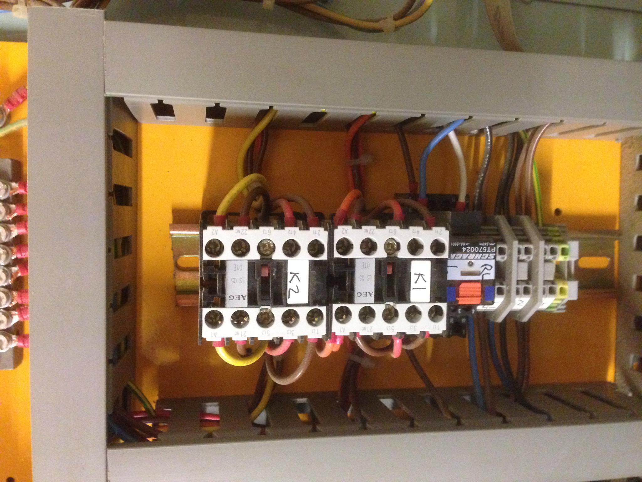

Tom sounds like you have a few issues going on here. I can help but it will mean you trying one thing at a time giving clear replys to my questions and not going off at tangents.
Has this machine ever worked correctly while in you owned it. Or have you bought it like this.?
Can you run the spindle without CNC side being turned ON so we can identify if the spindle is getting hot and transfering heat to machine.
I don't see any speed controller inside the Control box you showed so I'm presuming the spindle has manual speed control or fixed speed.! Which is it.?
OR is there another board or electronics your not showing.?
Need you to CUT air WITHOUT the spindle running and at the normal feedrate. But I want you to NOT turn on power to the machine until last minute. Then quickly load program and start cutting air.
Take a note of the Stepper temps and check at intervals while cutting air to see if they get hot. And how long before they do. It's not unusual for steppers to get hot while stood at rest so this is why I need you to start from cold and check temps.
While cutting they should be just above warm to mildly hot, and when at stand still for ten to fifteen minutes be like holding a cup of tea or coffee after minute or so off boil.!! . . They shouldn't burn.
Try this and let me know.!

Hi JAZZCNC,
thank you for your reply.
I think this is the only other pic I have so including the previous - thats the guts of it.
http://www.mycncuk.com/attachment.ph...id=15433&stc=1
Pretty sure its fixed speed spindle.
I will do the actions you describe today.

First with all the Flashing going off I suspect some settings have been lost and the drives are not set correctly for the motors. Or the Hardware is set wrong on it's switches. This will cause the Motors to get Very hot if current settings are wrong.
The Heat from the spindle is building up inside the enclosure transfering to mechanical parts. This could be causing some excess mechanical binding and friction.
The frame it's self will also heat up and this houses the electronics so excess heat could be affecting electrical Hardware. Excess heat in the cabinet will also affect the steppers badly if their current is set wrong.
So I think you have a machine that is over heating.!! . . . BUT what is causing the Heat could be a mixture of few things.

I will test the stepper temperature next. Am I right in thinking the stepper motors v rarely go wrong?

Wow Lad slow down.!! . . . I wouldn't go buying anything new yet. I certainly wouldn't replace it with original type spindle as there are far better and probably cheaper options.
Yes Steppers motors them selfs V fairly go wrong. It's the electronics they connect to that go wrong mostly.
To be honest I don't think you have a board going faulty I think your machine is setup all wrong. Either thru software or more likely on the boards it's self.
I certainly wouldn't be replacing any original boards for new ones. Like as been suggested you'll be much better replacing with new modern electronics.
This will free the machine of the restrictions placed on it by overpriced under performing Hardware/software Boxford force on you. When converted with modern drives these machines perform like the Old hardware could only dream about.!!
