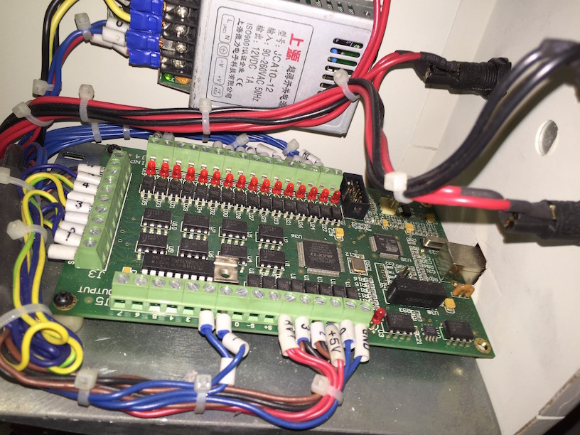

Ahhhh, guys. I must admit I haven't been keeping track of this thread... and I'm sorry I haven't :calm:. I assumed it would be dead and I was waiting until I actually had a proper update on the problem.
Lol. Soooo... I was considering bridging out the estop on the control board. I ran a multimeter to check for continuity at the guard switch and at the estop... all seemed fine. Before I bridged the circuit I wanted to eliminate a few other things.
On Wednesday I plugged in w/laptop and it wouldn't come out of estop, so I went to considerable effort to lug my f'in huge workstation style PC out to the shed to settle the possibility it could be the laptop. I also switched out the USB cable and on the recommendation of the smallcncsuport guy (John Stevenson... maybe its John S who kicks around these parts?) I added a 400ms debounce to the input signals in Mach. I also replaced the guard cover.
It came out of estop straight away, and I was already to eat my own words regarding the laptop but sadly my happiness was short lived when the same thing happened on the PC... half way through-ish a small op the machine went into estop and wouldn't come out. It just about broke me and then I almost went nuclear. So I just packed up and went inside. Didn't get a chance to try the bridging thing.
I was already to try this evening when I plugged in and once again all was fine... I thought I'd give it one more chance to make it all the way through a small part and it did. So I have my first part (ish...). Only then I went on to realise a much different problem... I wanted to do a little drilling on said small part and relaised that two of the MT2 ER16 collet chucks I have don't fit my machine! Wrong thread. Just can't win.
I went back to have a look on eBay to check and the listing now says "These chucks are threaded for drawbar but unfortunately we cannot confirm the threading size or pitch because each batch might be different." I was well aware my machine has an M10 thread so I am dubious it said that when I bought them (it was back in the spring), but I guess I'll never know now.
I'm still concerned the estop is a problem and worried about doing a bigger part. Only time will tell I guess.
For anyone interested here is a shot of the internals of my machine showing the controller card:
http://www.mycncuk.com/attachment.ph...id=15459&stc=1
It appears to be this one: http://www.automationtechnologiesinc...breakout-board. Known as an AKZ250 or Xulifeng. Looks like an FPGA at the heart and some kind on Atmel SAM (i.e. ARM) based device for usb coms.

Hi LAN,
Yes John Stevenson is John S and that's who I was going to call on your behalf. If you speak to him again Mention Jazz was Kicking off again he'll laugh and call me not nice names which I can't say or they will be deemed OFFENSIVE . . LOL.!!
If you have a Galil card then I'd swap it in a heart beat as Galil is industrial strength Controller and will knock the spots of that AKZ250. Yes I agree you shouldn't have too but sometimes it's just easier to bite the bullet and get cutting reliably. Esp if you have such a quality Card already.!
The next best thing is sort the noise causing the issue. Debounce is a bodge to get you going. Removing the noise is the cure and easy enough done.
For a start check all the Grounds are correct with a Star setup and separate signal wires from Power wires. Often this will cure the problem if it doesn't then you'll maybe after look at other ways. Like Caps across the inputs. Thou to be honest I've never found them to work very well if noise is bad.
To test if it's noise thru the switch then just remove the E-stop and put a jumper across the inputs. If it does it again you'll know it's not the E-stop as it can't be noise on the e-stop line.
Personally I prefer 24V to run trhu my E-stop and controlling a Relay which shuts the machine down. The 5v input signal is then just run thru Relay contacts to inform Mach3 E-stop occured and with a very short wire run you'll never get noise on that input.

I'm not sure if it's just how you've explained it, but (ignoring the initial problem which we can probably attribute to the guard switch) there seems to be a pattern:
The machine is running, but then gets itself jammed in e-stop, so you turn everything off, leave it for a bit, then when you come back, it's working again. If so, that sounds suspiciously like it could be an EMI (interference) problem.
The prime suspect for EMI (as always) is the spindle drive board and spindle, so it's probably worth checking if you can reliably get through the motions of a job with the spindle off/driver board disconnected, but not with it running. That I can't see a shielded cable between the spindle driver and the breakout/motion controller does make me particularly suspicious.
If disconnecting the spindle board doesn't fix things up, you'd move on to checking if it was the stepper motors and so forth. It's probably better just to link http://www.cnccookbook.com/CCCNCNoise.html at this point; although, some of it's recommendations are more practical for people making machines from scratch.
BTW, I think your link suggests that your motion control board is powered from your PC, so if it does get in a huff, it's only going to get power cycled when the USB port loses power. There's a tendency for PCs and laptops to sleep, rather than switch off and they often leave their USB ports powered for your convenience during sleep so you can charge your 'phone. (This might explain why it seems to fix itself overnight, because you unplug everything when you give up.)

Re: Sieg KX1 & Mach3 won't come out of emergency reset
late,
I noticed you said "shed", what kind of setup would that be? If the "standard" shed is the scenario I'm wondering if there is a possibility of an intermittent damp/moisture/humidity thing going on?
How close are those power lines (red&black, running cross the top of the picture) to the blue wires at the back of the picture, wondering if there is a noise issue in that area of the box, that PSU is right there to, humming away, sorry can't offer anything more :(.

Cut those bloody tie raps off as well I hate to see unshielded wires bound together, esp if 5V signal wires.

The estop and the spindle power are of course on separate cables but they run together from the head into guts of the machine. I could be wrong but I don't think either cable is shielded. But surely that would be a major design flaw... and they must have made thousands of these machines?!
That they're next to each other is suspicious. Shielded wires should be fairly obvious - they'd look like little coax cables, and there'd be a screen connected to the ground point.
Regarding it being a design flaw, it's likely an issue of margins and tolerances. Of course, the design should take account of that! There doesn't seem to be a slew of complaints, so, presumably, other Seig KX1s don't have this problem. (Cold comfort I know when your machine is the one that's faulty.)
Now, whilst I love to see the forum fix this, it does strike me that Arc should be the ones fixing this at their expense (or replacing it or refunding your money). Your contract is for a working mill, so they're legally obligated to supply said working mill or otherwise 'make you whole'.
The next thing I'd do is try to come up with a scenario that reliably causes the problem. I know the last thing you want to see right now is probably for your machine to go into e-stop, but this will at least allow you to tell if you've fixed it - or at least if you're seeing an improvement. (Alternatively, if you are putting the problem onto Arc, then you can show them that it doesn't work and easily test if they've fixed it.)
I'd avoid making major changes to the wiring right now, at least if you're hoping Arc might provide some remedy. Whilst JAZZCNC's wiring suggestions - star ground, separating cables etc., - are perfectly good, once you start cutting cable ties and rewiring things you're modifying the machine.
These may be stupid questions but:- a. was the machine purchased new from Arc and b. has it always had this e-stop problem ?
Another stupid idea - Is your workshop power properly earthed ?
cropwell
Good questions; I vaguely remember an extension lead being mentioned?
Come to think of it - I seem to remember warnings about extension leads being a great way to produce lots of EMI with welding equipment. Obviously, an arc welder is a beast for producing EMI, but presumably a mill could also see an effect?
How about you back to basics.
Do you have a multimeter?
If so, work out what input on the controller is the E-stop. Then measure the voltage with the E-stop circuit complete (all buttons out and guards in place), and with the E-stop circuit broken (hit an e-stop button). Make a note of the values, then when the fault happens again, measure the voltage at the input. That will tell you if it's a switch/sensor/wiring fault, or a controller fault.
The fact Mach is still communicating with the board and not locking up, tells me it's not an interference problem on the USB side.
Cropwell: Yup from Arc new. Bought in October but although I unboxed and played around, it basically went into storage not long after. I never actually set Mach to run a part until recently and thats when I found the problem and its done it at some point every day I've gone out to use it.
I don't think the power to shed is the problem. I can't discount it though.. wouldn't really know how to. There is a fairly large capacitor inside the mill, but that might be for the output of the transformer... not the input.
It locked up on me again today. Pretty much as soon as it went into the material, so I got to work trying to diagnose... Disconnected the estop circuit from the control board and tried various things on the estop wires with a multimeter. All seemed fine... continuity on guard switch, estop button, wires etc etc. So tried bridging the the estop pin on the board with +5v which to my surprise DIDN'T work... still refused to come out of estop. Which was interesting. Went away and had dinner and decided that as there was plenty of free inputs, I should just try moving the estop onto a different pin. The machine came out of estop straight away and I was able to do another small part. I don't want to get to presumptuous... I have been at this stage before. Again only time will tell but my instinct tells me this might be it... maybe a dodgy / intermittent opto isolator on the control board. Decided to end on a high while there was still plenty of daylight so I didn't do anything else. Guess I'll find out tomorrow if I'm onto a winner.
Oh, and I was wrong... there is shielding on the signal cables.
Checking the voltages at the board is far simpler than testing each switch individually.
If the fault re-occurs, measuring to see if the correct voltage is present at the BOB is the easiest and most accurate way to establish if there's a fault in the E-stop circuit. It could be a faulty input on the BOB, but unless you can confirm there is 5V across the relevant pins when the fault occurs, then you're only guessing where the fault is. It could just as easily be a lose connection somewhere.
Small update to this one... Its now semi solved.
I realised a few days back that my original attempt at bridging out the estop circuit was a bit flawed. I was using the LEDs on the controller board as an indication of whether the signals were active or not. When I first tried I assumed that the estop would get its power from the machine, but it doesn't. Its powered by usb, unlike the homing and limit switches which are on a 24v power source. The result being that when I bridged, turned on the power at the machine, saw LEDs for the homing / limits but not for the estop I assumed this was still this random estop problem, but it wasn't... it was the fact that I didn't have the usb plugged in.
I got sent a wiring diagram and realised the mistake... Bridged out the circuit and plugged in and have been milling parts the last few days. It has however STILL estopped on me mid cut, which is a little worrying as there is only a tiny bit of cable bridging the circuit. But just the once and I was able to immediately reset and continue.
I wouldn't say its solved by any means... For one I have no estop now. I'm dubious that the control card is paying attention to Mach's setting for debounce... I'll have a think / seek advice about trying to rewire to use the 24v power source for the estop and / or add a small capacitor onto the estop circuit to do a bit of debounce the physical way. All things which I'm aware you mentioned ages ago JAZZ :whistle:.
Thanks for your help everyone!
