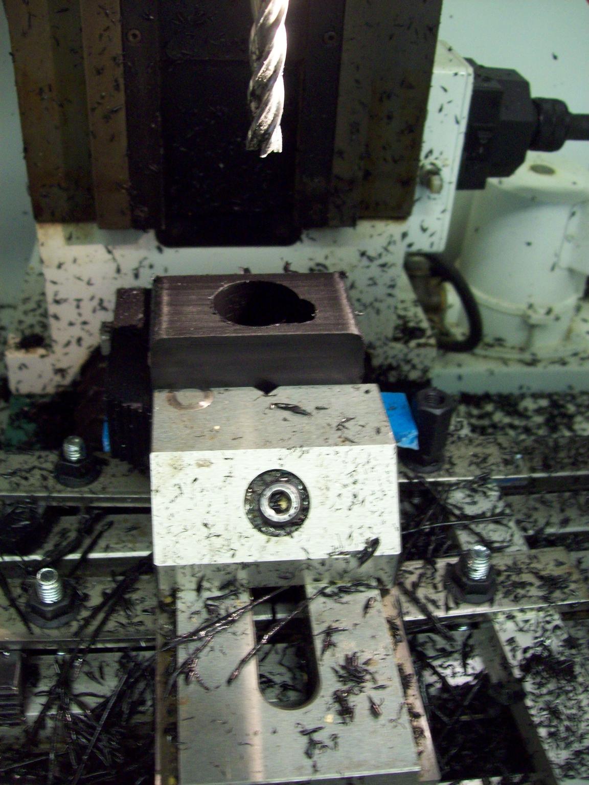

Hi all,
I nearly crashed my machine and have no idea how. Perhaps one of you guys may have some idea what went wrong. I was cutting a circular pocket in the plastic as per the photo. The plastic is 50mm thick I had cut 25mm deep fine in a series of 7 passes, it went fine I then cut another 25mm deep zeroing the z 25mm below the top of the part that was fine but I had not got quite deep enough so I had another go on the 6 or 7 pass things went wrong real quick.
The only thing I can think is perhaps I touched my mouse or shuttle and it override the code if that is possible. The part was secure in vice so it did not work loose. I have tried the code again directly above the part 3 or 4 times I would think and all seems fine. Perhaps one of you guys will know where I most likely went wrong. It dived into the bottom right part of the job an tripped the machine which was very lucky
Thank for any help

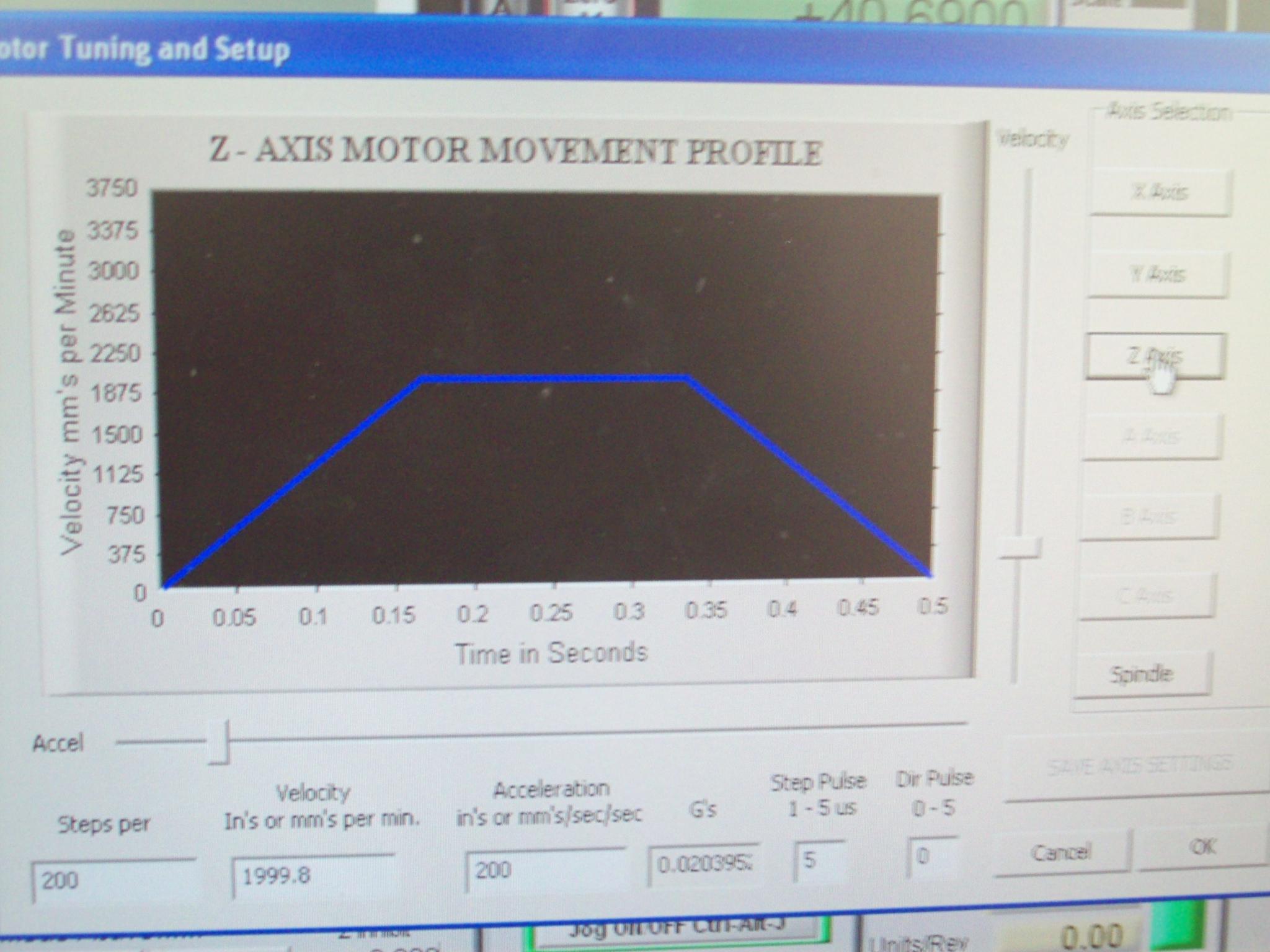

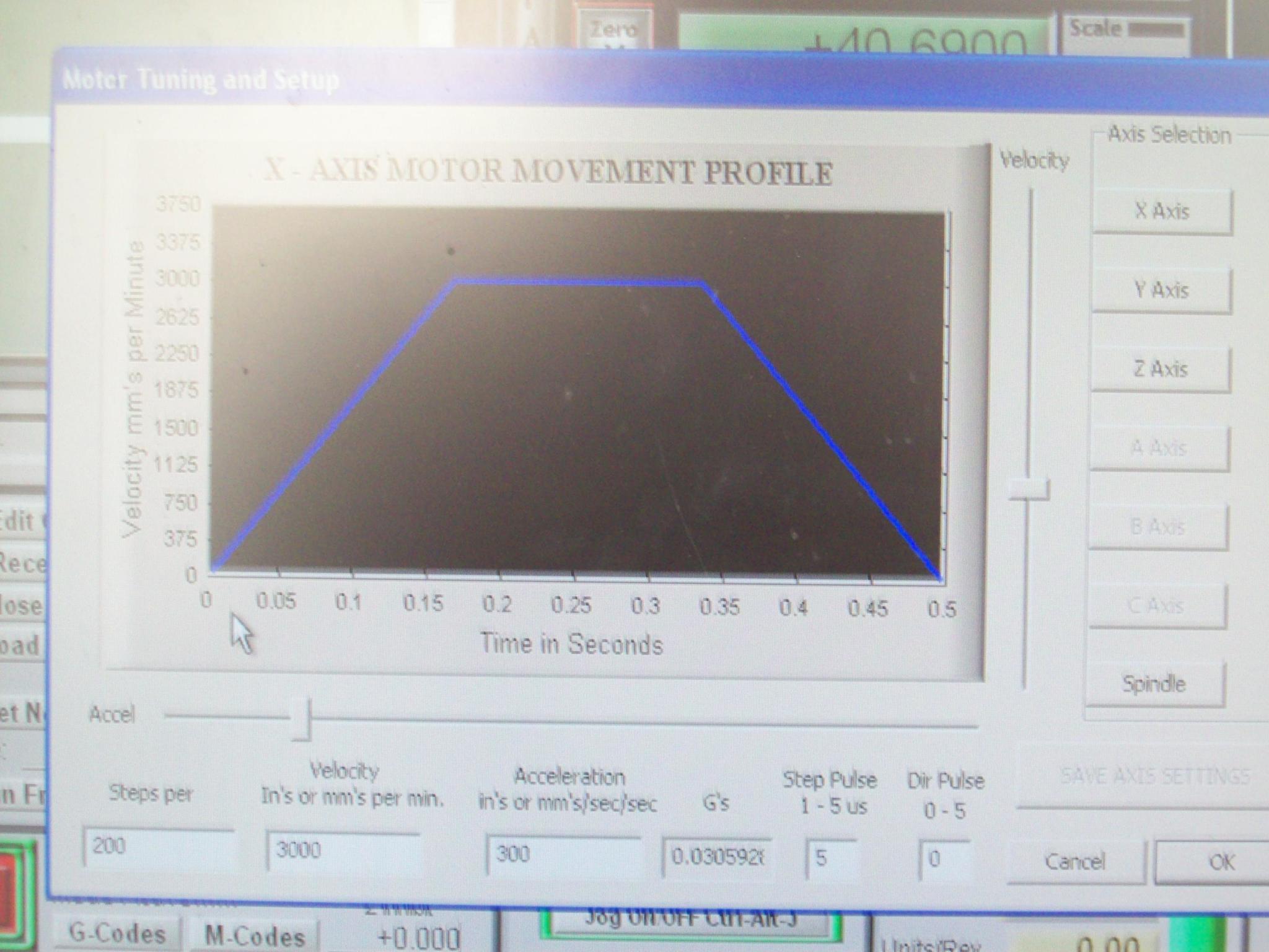

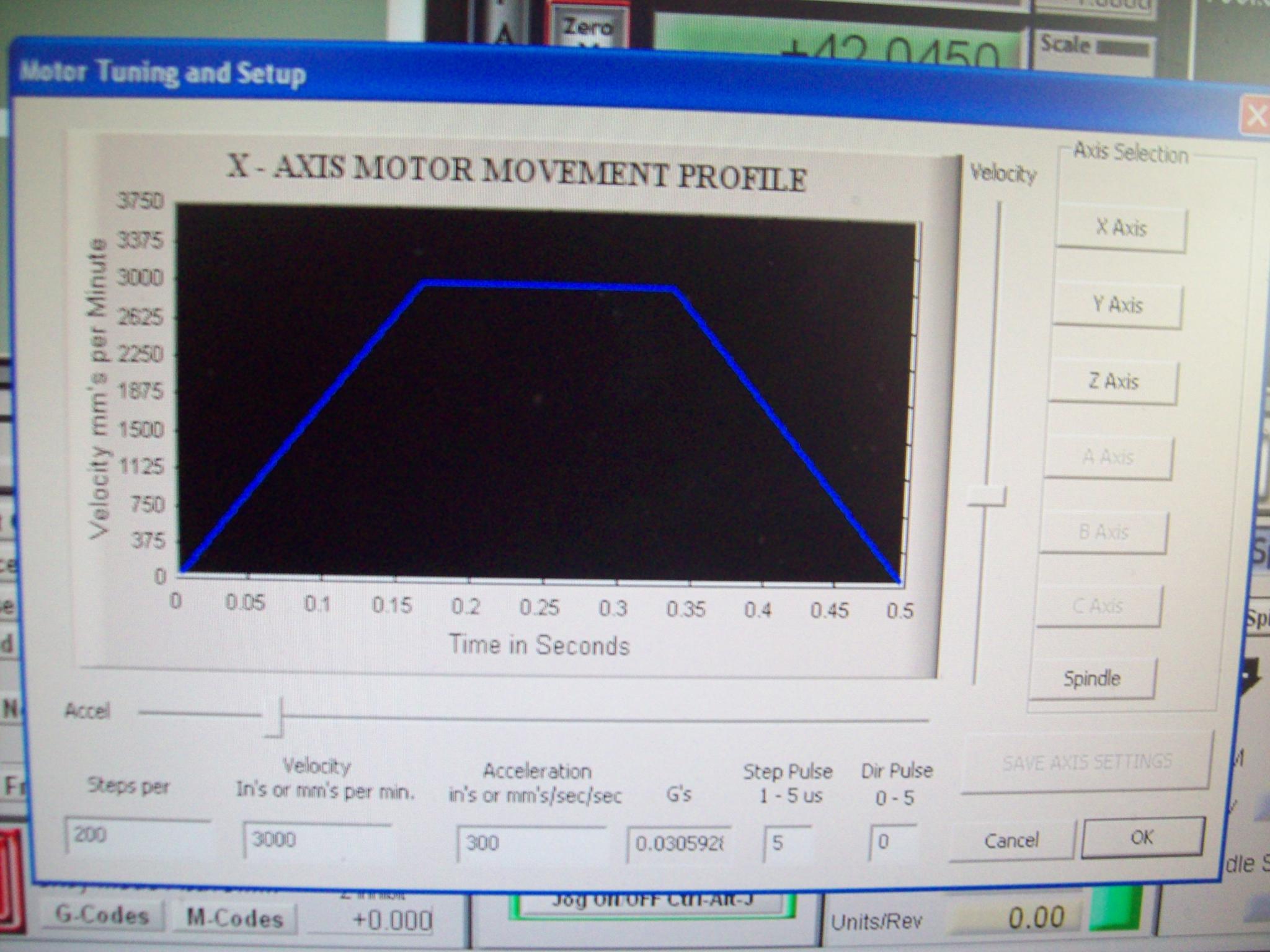

Hi Jazz,
I am well out of my depth here perhaps you can get my head above water!
I have found out some info, as per the manual on the machine max federate is X,Y 2500mm/min with the Z being 1000mm /min.Is states feedrate override potentiometer 0 to 150% but I do not know what that means.
The guy that converted my machine has done many Triac’s and set the X & Y at 3000mm / min, Z axis at 2000mm/min I am asking him for the spec of the motors.
To cut out the rectangular shaped part in the vice with radiusedc orners I used a federate of 1900mm/min, s4000, cut depth 3.8mm per pass.
When it all went wrong the cutter was not cutting anything as it was working down progressively to the bottom of the hole that had already been cut inorder to just cut the last 1mm of the bottom left behind and break through it went wrong on the 2nd to last pass so it did not reach the remaining 1mm to be cut.
I have attached photos of the motor tuning, video of the part being cut above job so motor can be heard, the spindle is a 1.1kw, DC, 1.5hp
The X,Y and Z ballscrews 16mm (5/8”) diameter x5mm (13/64”) pitch
Many thanks
Suesihttp://www.mycncuk.com/attachment.ph...id=15456&stc=1http://www.mycncuk.com/attachment.ph...id=15457&stc=1http://www.mycncuk.com/attachment.ph...id=15458&stc=1
https://www.youtube.com/watch?v=EgFzqQqScPU&feature=youtu.be
Re: Nearly crashed my machine and not sure what went wrong, any help please?
Ok well nothing looks wrong or excessively over tuned here. Thou I'm not a fan of micro stepping at 1000ms (1000/5mm pitch=200 steps per) as I find for some strange reason this setting can give more resonance which can affect motors than 800 or 1600. That said I'm pretty sure this won't be your problem.
