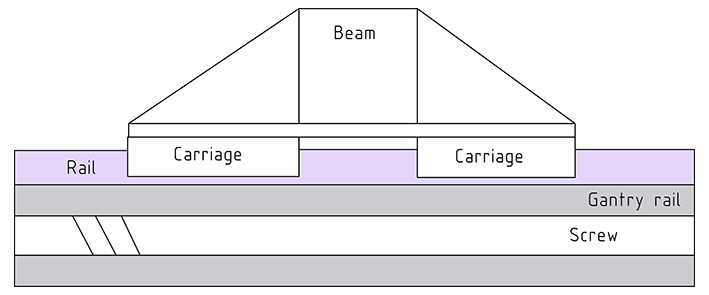

Here's a couple of sketches of the gantry ends, just ideas at present but would seem to fit well..
http://www.mycncuk.com/attachment.ph...id=15629&stc=1http://www.mycncuk.com/attachment.ph...id=15630&stc=1

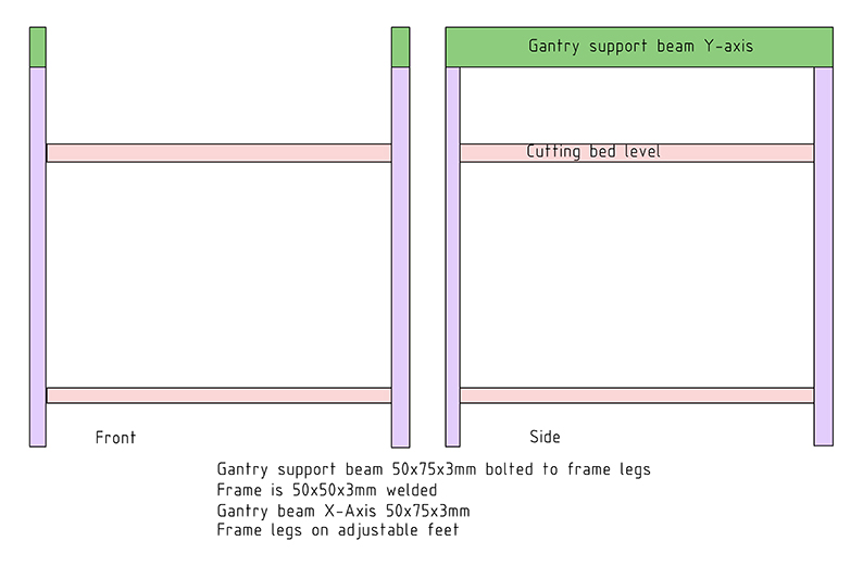

The main table will be 50x50x5mm box section steel, fully welded, the motion supports will be bolted on so I can shim them up and avoid welding warp etc.
The top rails or Y-axis will be above the bed so I can slide a bigger sheet in if wanted, this will also keep the tracks and screws above the pierce splatter.
Drive is with my existing Nema23 3.1Nm steppers, if that does not play nicely then I can upgrade easily to Nema23 servos.
I am aiming to get a speed range of 100mm to 9000mm/min so I can use the full range of the PM45 without messing around.
Feel free to offer any advice :)

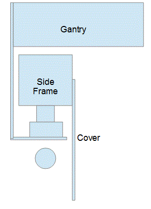

A plasma table has reappeared on my potential project list, and I do have a couple thoughts about mitigating dust.
I wonder if mounting the rails on the underside of the side frame would help dust from settling onto the rails, then have the screw mounted below the rails/gantry/carriage? On the inside edge you can then have a bit plate hanging straight down to stop dust coming of the cutting area, and arrange a couple brush strips on the outside to minimise dust blowing around and in.
Re: Second CNC table build, here we go again....
Yes, that could be a good idea, i'll sketch it up.
it would mean a small loss of Y travel or making the table a little bigger as the carriages will hit the support legs, no real issue there though.

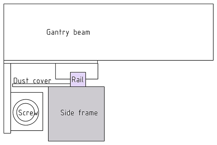

A bit like this?
http://www.mycncuk.com/attachment.ph...id=15632&stc=1
Might be better, Not totally convinced though, the rail is now facing the pierce splatter zone.

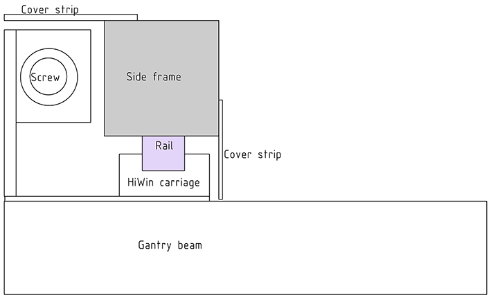

Just done a rough sketch of what I was thinking.
If you wanted to add support to the side rail, you could use a wider box section, and either move the rail nearer the edge and have the legs/supports mounted on the opposite edge, or use a double box section, with the rail on one and legs/support on the other.
Dust could be mostly eliminated by adding a couple brush strips, or suitable strips of metal with minimal gap either side of the rail to further reduce the ability of dust to settle onto rails.
And having just looked at my sketch and thought about how to protect the screw from dust, mounting it at the side of the rail so you only have one 'area' you need to minimise dust ingress might be an option.
Frame bracing???
First frame idea, overall size is around 1500mm x 1500mm x 1000mm to bed level.
Should i be looking at bracing or gussets anywhere???
Davek0974
Aluminium was looked at, and is lighter, but stiffness suffers as a result and I want it rigid this time ;)
Aluminium has the huge advantage that it is usually quite straight. Steel box section can be quite horrendously bent, as far as CNC building goes, but still well within tolerance. Even slightly bent can make it hard to align a rack. I agree with Jazz, belt for a plasma cutter.
