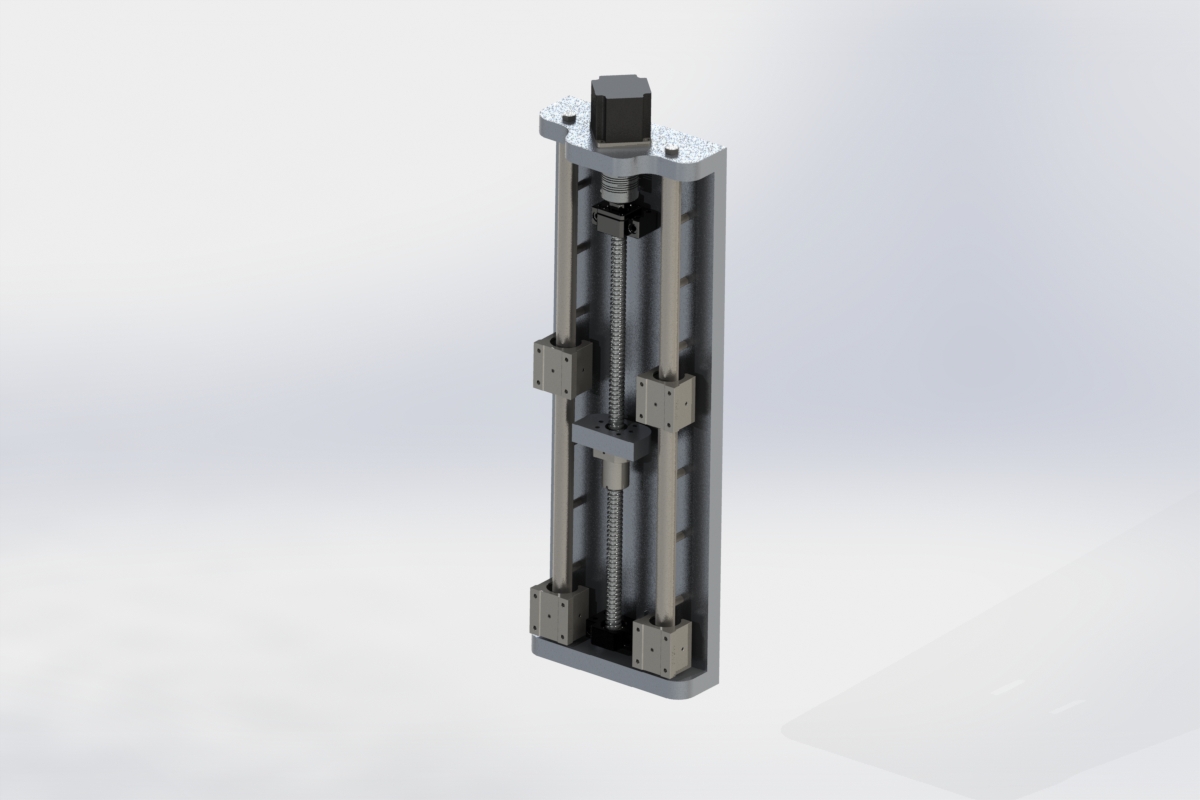

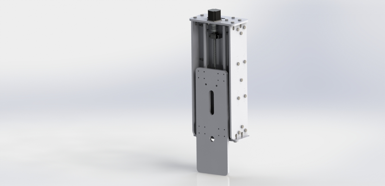

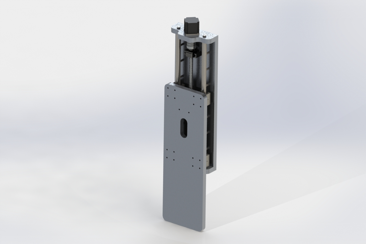

Here are a few renders of the complete Z axis design (calculated weight is 9kg without spindle):
http://www.mycncuk.com/attachment.ph...id=15907&stc=1
Complete Z axis.
http://www.mycncuk.com/attachment.ph...id=15906&stc=1
Inside the frame.
http://www.mycncuk.com/attachment.ph...id=15905&stc=1

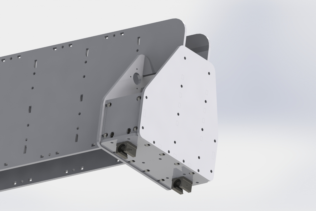

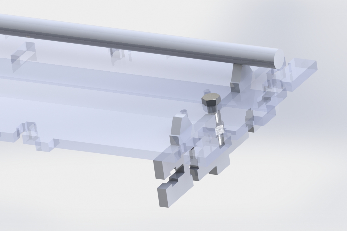

This image shows the steel bolt and nut connection, plus the integrated linear shaft support. You can also see how the connections affect the part by cutting the shape of the bolt and nut, and adding joints on both sides of the bolt. I actually made smart components that achieve this. I have a few different versions and sizes for the connections:
- simple: cuts the shape of the bolt and nut
- single: cuts the shape of the bolt and nut + a "tooth" on one side (sizes are small, medium or large)
- double: cuts the shape of the bolt and nut + a "tooth" on both sides (sizes are small, medium or large)
All cuts have a play of .1mm. Bolts are M10 x 35mm with matching nut (standard, grade or pitch don't really matter as there aren't any tapped holes).

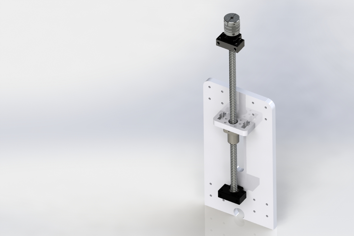

http://www.mycncuk.com/attachment.ph...id=15908&stc=1

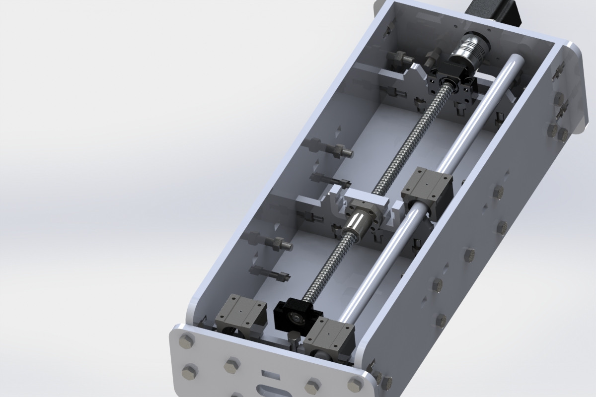

Back of the Z moving plate with balll nut support. All made from 15mm steel sheet.

Re: All steel, no welding, 2000x1300x250mm
It's certainly impressive I can see a lot of work has gone into this.
I do worry about the straightness of the steel to get an accurate machine. May I ask why you have not gone with square profile rails? I look forward to watching this develop. :welcoming: ..Clive

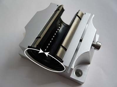

eurikain
Price :) ! The gold was to make things cheapER. 12 SBR20UU blocks cost me $60. Stainless steel shifts will be less than $50 for all axis. Shaft supports are integrated to parts and don't add any cost to the machine but a few seconds of cutting.
Hi Eurikain.
I've used TBR20's on my build and they work well etc. BUT, if I was building it again I'd use profile rail. Why? Rigidity (my rails aren't really long enough for this to be an issue for me) and ease of maintenance. Have a look at the attached pic:
http://www.mycncuk.com/attachment.ph...id=15909&stc=1
The bearing housing in the block will work it's way loose from time to time despite the top and side grub screws that are meant to hold it in place (you can only nip 'em up so far before the unit binds). Once the bearing housing has loosened it will, over time, rotate and eventually the sharp corners of the cylinder will scrape along the rail supports. This isn't a catastrophe, nor should it lead to a catastrophic failure, but it's an annoyance that'll cost you time and an extra thing to watch out for. No biggie for a hobbyist like myself, but if downtime's something you want to avoid then do yourself a favour and buy profile rails...!
Wal.
Hi Wal, and thanks for the input :)
I appreciate the advice ! Though I think I won't worry much about this as this is my first build and as I don't intend to machine things that often (I'm still a student and the machine will only be accessible on weekends). I went with SBR rails because in my humble opinion replacing a $5 SBR block every so often is not such a problem :) The machine design is done so that you can take it easily apart whenever you want and put it back together without loosing starigthness, rigidity or anything, as steel won't move when mounting / unmounting.
May be in a later version of this machine I will switch to profile rails and HWIN blocks though :)

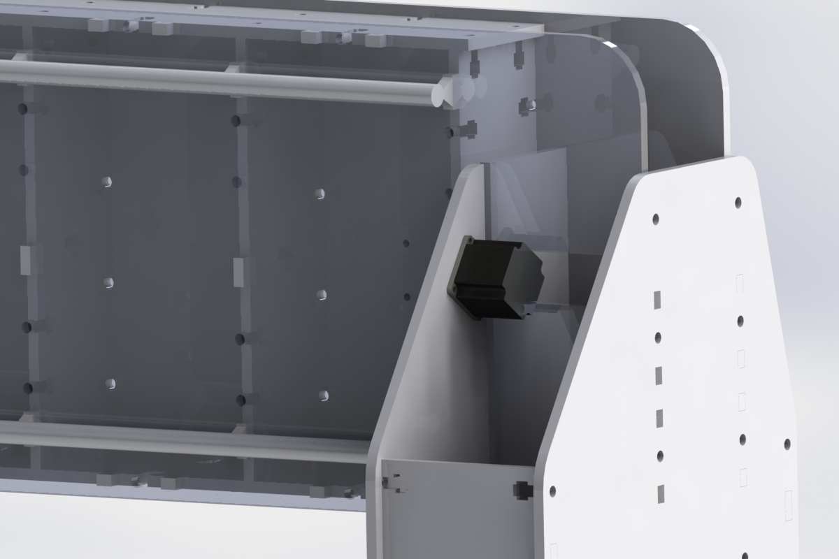

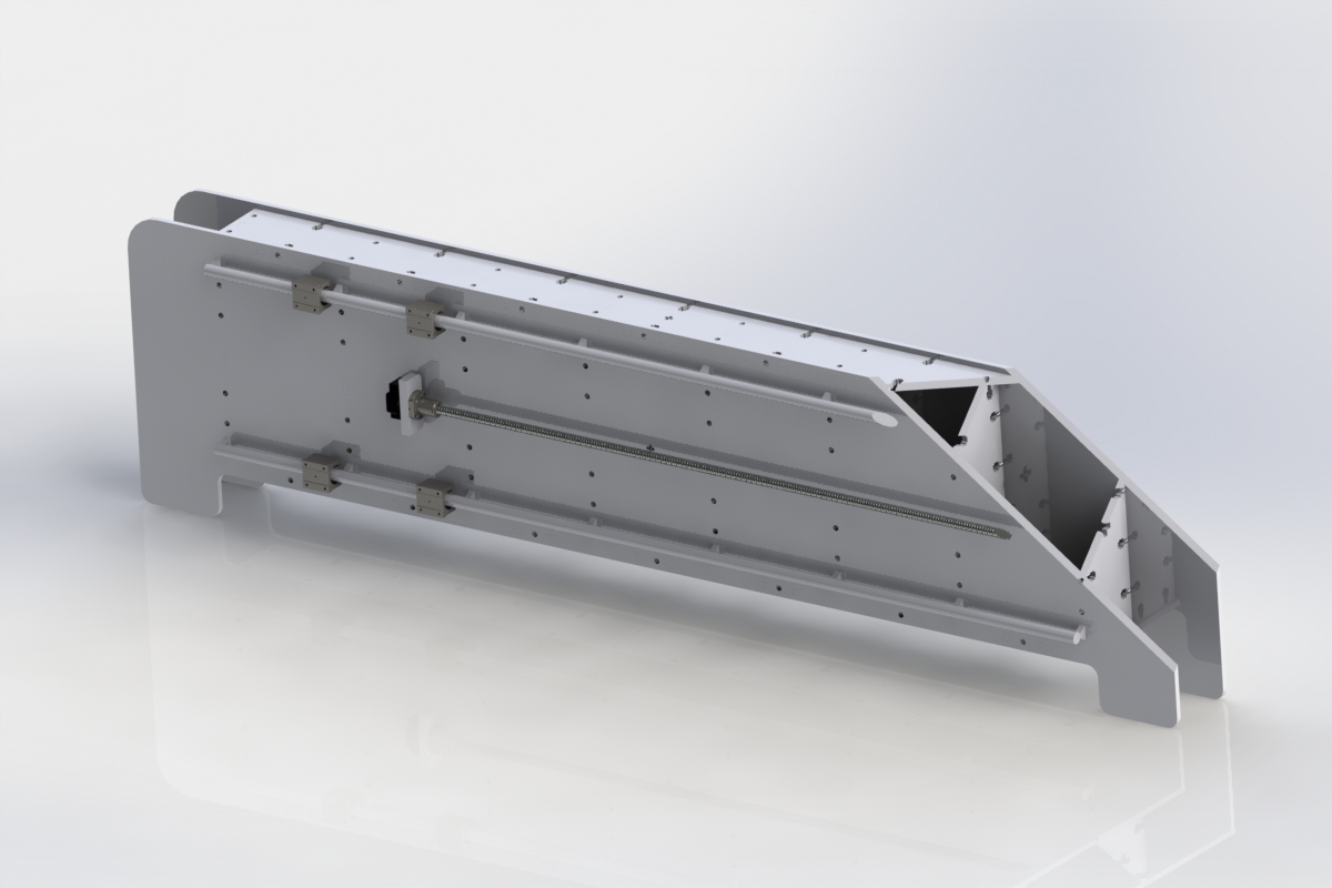

Hey mates ! (hahahahaha for those of you who will get it)

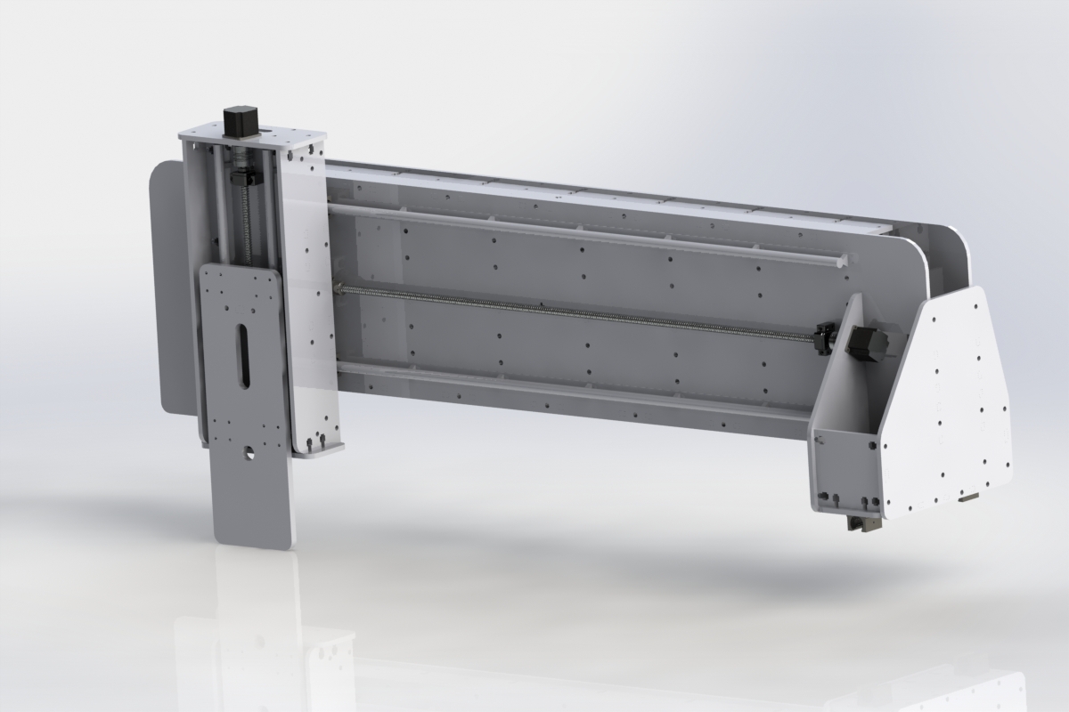

I spent yesterday modeling the Y axis. Today I will make the gantry sides to fix the Y axis, fix its motor, and connect Y and Z if I have the time.
Here is a render of the Y axis with a section view (calculated weight is 28kg):
http://www.mycncuk.com/attachment.ph...id=15913&stc=1
Looking at your renders - in reality, your rails will be supported along their entire length, won't they? Not at intervals, like you've got them in the images..?
Wal.
Wal
Wal.
Wal according to his first post he intends to weld them to the supports so not using conventional rails. ..Clive
Clive S
That's right :) They will be supported at intervals. That's because they are integrated in the design. There is no efficient way to plasma cut full support profiles. Or you would need to cut the profile from lets say 20mm steel and stack all the supports next to each other, but that's just too much of a pain and would lead to alignment inaccuracy.
Supporting them at intervals won't cause binding of the 20mm plain stainless steel shaft, considering that the interval length stays reasonable. Current interval is 220mm on Y axis and 240mm on Z axis.
Ah, okay. You'll need to keep a close eye on those creeping bearing housings then, if one of those housing edges were to catch on a support it could spell trouble, although you'll probably hear them knocking/scraping before it does. Bear in mind that the machine could be working on a small part of a project, going back and forth many times over (with the bearing housing silently creeping out of place but not having to pass a support strut...) before moving on to a different part of a table... If it's crept enough to catch on a support strut... Disaster.
You might want to 'arrest' the housings so that they don't rotate past a certain point, ie. with a blob of epoxy - I don't mean for you to glue 'em in... Just a blob or two on the outside of the housings that stops them rotating past a certain point... [I should probably do the same with mine...]
Wal.
Wait - weld...? Weld the supports to the rails...? Surely you'll be asking those rails to bend...?!
I've just jumped into this thread and I would think twice about welding the rails. They will almost certainly bend out of alignment with the heat and shrinkage, even I suspect with TIG which can be more delicate.
It may also remove the hardening from the local area although that will probably be the least of your problems.
Don't want to knock your ideas but I would seriously check whether this is a good strategy - so buy a very small length of rail, put a bearing on it with a cheap laser pointer aimed a a wall. Mark the spot, then weld the rail to a something to replicate the support post and see what happens to the spot. Then decide if this approach is going to work before spending money on all the laser cutting . . .
To be honest, supported round rail would be a much better option and it is easy to bolt down via the flanges.
+1 - Even if you insisted on not using the supports that the rails comes with, you can unbolt them and use the pre-drilled/tapped holes in the rail to attach your own supports...

Your calculated weight numbers seems to be very low! 10mm and 15mm steel is heavy stuff...
My experience with laser and plasma cutting tells me that positional accuracy is always good but edge is never 90 degrees. Plasma is worse than laser. It also gets worse with thicker materials. Most certainly you will have to use straightening tools since sheets are not flat. But good rubber hammer will get it fixed :D
You have to somehow make the openings for M10 nut pressfitted otherwise the nuts will fall out. That especially when you assemble the gantry...or you have another solution for it?

Then two general remarks on the design:
1: It seems to me that you will not be able to assemble this thing, as the nuts will be falling out all the time.
2: If you add tabs+rectangular holes here and there to position parts, you can probably glue the thing together, if you choose the right kind of epoxy.
If not using epoxy you can still use an occasional spot weld to fix a tab in its hole.
Dont forget to leave space for adjustments. Even if precisely laser cut, sheets bend, etc.
I would say oversize all holes by 2mm diameter
Actually, the spacing between the nut and the part is .1mm on each side. The reason for that is that I want to compensate cutting accuracy, plus tolerance for bolts (I've checked a sample and they're not always the exact same diameter, weirdly).
toomast
I do ! Good old tape ! That will hold the nut while inserting the bolt :)

Who said shafts were unsupported ? They're supported every 220mm. Go ahead and try to bind/bend a 220mm long 20mm thick plain stainless steel shaft. Yeah, probably with a 200kg Z axis, still... As currently designed, the Z will probably not exceed 15kg. Add cutting forces, let's say you go up to 40kgs (and I'm being generous ^^), considering the Z is supported in 4 points on 2 shafts, I honestly don't think binding will be an issue. But go to the end of this post for a proper answer on that :)
Sven
The solution is to assembly it smartly. Actually, two solutions exist: 1. use tape to hold the nuts in place while inserting the bolts. 2. assemble parts in an order that will allow nuts to fall on the ground instead of inside a closed space.
Sven

General answer for the four main concerns:
1. Shafts aren't the way to go, they're bad, bad, extremely bad, up to the point that you'd be willing to whip me if I use them :D
People, I hear you ! But plear hear me too :) I know most of you like the HWIN rails / blocks, and I know for a fact that they are far better than SBR/TBR blocks with round rails. However, my original idea was to integrate the supports in the design, and I don't want to change it. BUT, I am going to compromise with you all: I will keep the integrated shaft supports, go with shafts and SBR blocks (I have already bought them a month ago, plus I'm interested to see how it turns out). HOWEVER, I will add to the model holes for HWIN rails and blocks. IF shafts turn out to be a bad decision or if I'm just not happy with the result, I will cut off the supports, buy the HWIN rails / blocks and just mount them on like nothing happened. I think that will make you all happy ! This is not a waste of money since I've already bought the SBR blocks, and shafts will be and additional cost of $50. This way, I git it a shot, and if it works, it's a $600 minimum savings for me. Otherwise, it's a $0 loss as I will happily sell those blocks to someone here on the forum, and if no one wants them I will keep them for whichever exotic project I decide to work on :)
Now, considering this, can anyone tell me what size HWIN rails/blocks I would need for this machine, so I can get a quote from my favorite AliExpress seller Kevin Ho ?
2. Nuts will fall when assembling.
Tape will hold them from falling.
3. Welding shafts on the supports will make them bind.
Sure, I trust your experience. I will ask the welder shop to make a test with two fake supports and one short shaft. We will then measure the binding. However, I think that you're worrying too much on this. Binding will happen if the shaft gets too hot, which can be avoided by doing very short runs (few seconds long). If all else fails, I will get the shafts and parts drilled and tapped by a profesionnal turner and let him mount them. And if that doesn't work, I'll go with option 2 proposed in point 1 (cut off supports and go with HWIN).
4. Plasma cutting and laser cutting will cause parts to move / bind / shrink, in other words change and cause misalignment.
Sure. I contacted the cutter on Friday and they said they're going to use a water jet cutter. I asked about accuracy and they said they can go up to .01mm accuracy. I also asked about cut straightness, because I've heard that water jet cutting looses accuracy on the bottom of the cut. For example, if you want to cut a 10x10mm square out of 10mm steel, the machine will cut 10.01mm x 10.01mm on top but 10.02 x 10.02 on the bottom. The cutter I called said that it is true but that effect can be overcome if you sonfigure the machine correctly. When cutting the parts, they (and I'll be there to check !) will do some test cuts until they have the right setup.

3 Attachment(s)
Alright, moving forward with the assembled and complete gantry (Y axis, Z axis and gantry sides). I still need to mirror the right gantry side but that's a detail compared to the amount of hours I put into making the sides and assembling everything. Solidworks can be a pain sometimes, and the 2GB RAM of my good old HP laptop are starting to struggle a bit.
Gantry weight is calculated to 39 kg without the second gantry side (@toomast: this is strange, but I've checked again that parts were set to the correct material, may be I can PM you the model and you can check if I have done something wrong ?). The Y axis is securely fastened to the gantry sides and contributes quite a lot to its rigidity.
http://www.mycncuk.com/attachment.ph...id=15933&stc=1Assembled gantry with sides and Z.
http://www.mycncuk.com/attachment.ph...id=15932&stc=1Gantry side with motor mounted on left side plate. Notice the extruded cut in the Y axis front plate to make room for the motor.
http://www.mycncuk.com/attachment.ph...id=15931&stc=1Gantry side. Y axis is fixed at 14 points. Weirdly, I had rendered this with fasteners showing, but they did not appear on the render.
General remarks:
- I got a quote from my seller. He is asking for $886 for the following (shipping not included):
- 2 x 2400mm HIWIN 20 rail
- 2 x 1600mm HIWIN 20 rail
- 2 x 700mm HIWIN 20 rail
- 4 x HGH20CA blocks
- 8 x HGW20CA blocks
Shipping is not included because he does not know how to ship the 2400mm rails. He said the maximum length is 2000mm, but he will be looking for other ways to ship. Does anyone know if it is possible to assemble two HIWIN rails to make one (kind of like @routercnc suggested for round rails) ? I would be worried about the moment where the blocks slide on the junction...
Let's say we find a solution for shipping. You're looking a $1100 at least. Trying the round rails first is just a must now. Unless one of you guys is willing to sponsor me :yahoo:, I'm ready to sacrifice machine quality to the price of 1000 Euros with which I will gladly go on a vacation with my girlfriend :redface:. - I haven't gotten a fastener count yet but once the X axis is added I will post one. I think we're looking at 150 bolts and nuts. X axis will most likely add another 100. But I'm being very generous on these numbers so don't take me at my word.

2 Attachment(s)
Important updates:
Following Boyan's advice, I am switching to a new Z / Y / gantry design, adapting my old one, removing nuts and bolts. I am also switching to ALUMINIUM instead of steel, as this thing is way too heavy. The new design lightens it but going to aluminium will be the solution. I'll be using 20mm sheets, unless you guys think 15mm is better to reduce weight. I'll be adding pockets at some places to lighten the whole thing.
I called the cutting company. They said parts will be water jet cut (I have no choice on that, but no big deal, I've got good prices anyway) with .25mm accuracy.
I keep the round rods, no changes on that. Instead of being supported by profiles, they will be supported by M8 bolts every 70mm plus at both ends.
Here are the pictures of the Z axis, evaluated to 17kg, but that should decrease with pocketing.
http://www.mycncuk.com/attachment.ph...id=15947&stc=1Complete Z.
http://www.mycncuk.com/attachment.ph...id=15946&stc=1Z without front plate.
Cheers.
eurikain
Important updates:
Following Boyan's advice, I am switching to a new Z / Y / gantry design....
What are you doing right now is Not following my advice. Of course its your machine, i am just trying to help. Seems you a missing my biggest point. What i told you before:
Keep the design with square rails! Save from all else. Dont compromise on that. Dont exchange that for a vacation:joker:
Ok i understand - expensive, you want to change the design to round rails. Then read some similar build logs and design much lighter and simpler frame.
Here is my advice:
-make the Z strong. 20mm aluminum plate is Not strong enough if not braced. Ideal will be 12-15mm steel plate, braced and done like#8 here where i explain much better and simpler Z design with the same effort
-make gantry from profiles cut on a Rage saw and soldered. gantry sides also. Look my second project in signature for the gantry sides / 100x100 profile/ Design all machine from one profile, say 80x80x4mm or 100x100x3mm , no fancy plates and crap where you waste money. Order 6m steel box profiles, cut all on Rage saw and solder.
From here you will save the money for the square rails. Difference between square rails and other type of linear movement is like from Ferrari compared to Trabant
-My direct advice is follow my first build and change gantry sides like i did them on my second. Thats the cheapest and strongest machine at the same time possible.
