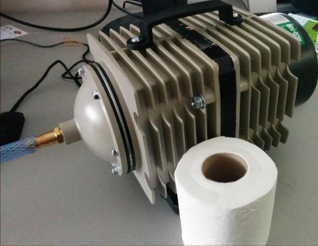

The first part cam in , the Hailea 500 pump. it is a bit bigger than I had imagined.
But being this big it also gives some confidence that it will work good:
http://www.mycncuk.com/attachment.ph...id=16010&stc=1
Re: Ruffel's cnc cutting journey
It is almost as high as two toiled paper roils stacked.
I'm currently thinking on how I'm gonna run my air lines.
13mm ID from pump to the mill head and split it there to 2x6mm ID or do it directly at the pump....
not sure yet , do you guys have tips ?

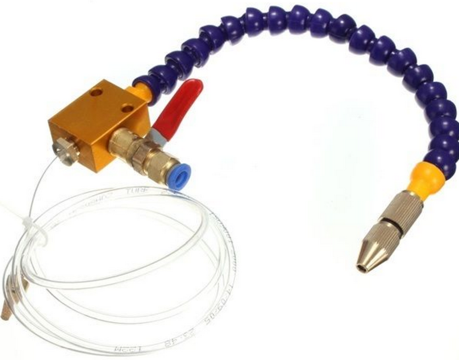

Yes I'm doing an mist system. I ordered two of these:
http://www.mycncuk.com/attachment.ph...id=16018&stc=1
http://www.ebay.co.uk/itm/Mist-Coola.../252043904329?
I did some googling and other people seem to have good luck with these aquarium air pumps. Most of them use the 80 l/min models but recommended going 120l/min +.
So I just got the biggest one. A compressor would be just to loud for my situation. And the paintbrush one's seem to have a hard time to keep up with the airflow.
If it does not work out than I will just return it in 14 days and get my money back. In that case a paintbrush / real compressor will be the alternative.
People who use compressors seem to be running these nozzles <1 bar so I think I'm alright.
As a liquid I'm testing lamp oil or ethanol , these both should work out fine.
The 280 l/min might be a bit much for my two little misting units , so it is possible that I need to add 2-3 more or just some copper to get some more volume trough it.

Last but not least I received the china mist thing from ebay ... but I haven't had much luck with it.
There is no way to adjust the amount of coolant that gets in the nozzle. When you turn the air down and the coolant reservoir is higher than the nozzle you will get quite a stream of coolant coming out of the nozzle.
When the reservoir is just a bit higher or lower than the nozzle there will be no coolant coming out. Does not matter if the system is at 1, 2 or 6 bar. The airbrush pistol that came with the compressor does a much better job. It even has a ionizer pin inside of it. Might hack that up later ....
I would like a fogbuster ... but they are just so damm expensive. Haven't the Chinese copied it yet?
