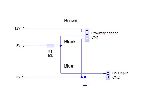

First of all you will need a 12v DC power supply.
The sensor is designed to work from a supply of 6 to 36v +V (Brown wire). 0V (ground) is connected to the Blue wire and the black wire is the sensor output, which switches to ground when triggered. When not triggered the black wire can be considered as not connected to anything internally in the sensor.
You will need a load resistor connected from 5v on the BoB to the black wire and to the input pin on the BoB. I use 10k ohm, the value is not critical but ideally should not be less than 1k or greater than 47k. The blue wire from the sensor should also be connected to ground on the BoB. The BoB must be supplied with a separate 5v power supply and I do not recommend using USB from the computer. This type of sensor acts as a switch between the black and blue wires. I have found that though rated 6-36v they do not work reliably below 10v.
Mach3 sees the input as triggered when it is at 0v.

Re: 3 wire proximity switch help
The Blue wire label should be underneath pointing to the 0v (ground) line.
I put a circuit diagram in here, but it got lost in the post. :disillusionment:http://www.mycncuk.com/attachment.ph...id=16197&stc=1
cropwell
I connected them the way you said and it works. I conected the black wire to the imput and the 5v on the BOB. Now I'm trying to connect them in a junction box and the Y+ will trip but the Y- won't when there conected together. Can you tell what you think is wrong.
I used 1 4300 ohm transistor on the end at the BOB for both switches. I'm wondering if all the switches have to be run back to the board with seperate transistors.
They are the two blue switches on the bottom of the picture.
Yes, each BoB input has to have its own resistor. The resistor pulls up the input to 5v (logic 'high') as its' normal state. When triggered the proximity switch pulls the input to 0v (logic low), so Mach3 has to see the input as 'active low'. Without the resistor you have a 'floating' input and the voltage on it could be anywhere, so it would not be predictable or reliable, and probably not work at all.
No I'm using a separate 5v PS. The lights don't light up when it makes contact either. But when I put the Blue wire on the 12v ps with the + it's lights up brite
I think we have the problem !
The earth return paths are not connected. The blue wire from the sensor should be connected to the 0v (gnd) terminals on both power supplies and also (of course) to the 0v ground on the BoB. This is the most likely explanation of the symptoms.
cropwell
I ran the brown + wire to the positive on the 12v transformer. Then I ran the blue - to the Ground on the 12v transformer and the BOB gnd then I put the black on the input signal and the switch lit up but wouldn't trigger. So I disconnected the blue just from the transformer to the BOB and it now works like it should. It's more sensitive and works great.
So no transistors.
