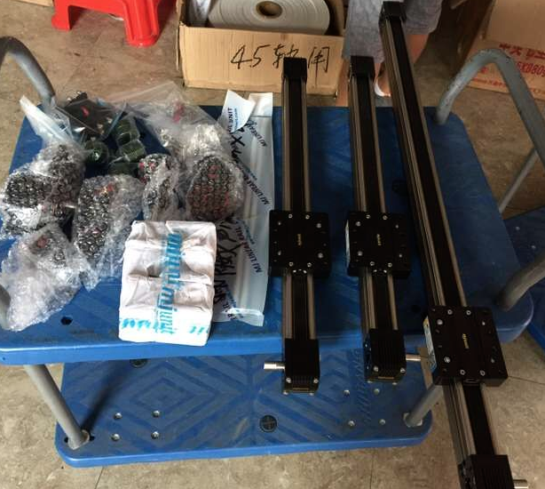

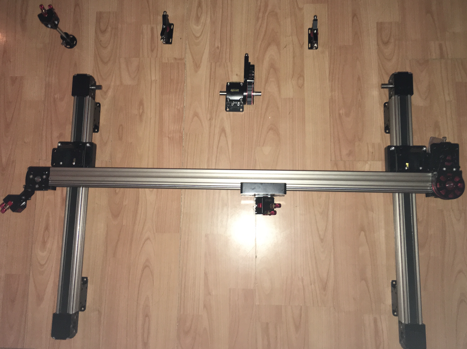

3 Attachment(s)
Re: Thinking box CO2 laser
Just received the parcels today. Well packed.
Attachment 16503Attachment 16504
Here is layout
Attachment 16505
Will build a frame of aluminum extrusions 2020 and 2040.
More later..
PS.
Any tips regarding motors + drivers? ;) It has 57mm mounts.
