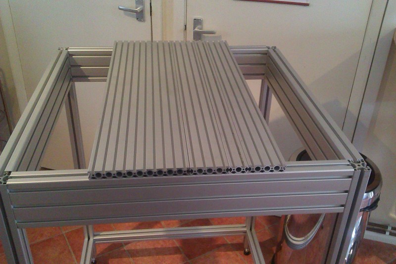

Hi Jazz, completely unrelated to this specific thread but you seemed to be the man to ask. In short I need to source some low profile machine bed extrusion ideally the same stuff as used by Hobgoblin on his 3 axis CNC mill Project: http://www.mycncuk.com/threads/4992-...C-Mill-Project
Attachment 16467Attachment 16468
I presume this is stuff is from China? I really need to source some ASAP for a rush prototype project. This stuff would be almost Ideal unless something thinner is available. Is there a manufacturer, or website you could give me a link to?
many thanks
Try this company they sell 160x16 which is nice sive for bed. Thou I see it's saying Sold out but will probably re-stock soon.!
http://www.motedis.co.uk/shop/Slot-p...91_999993.html

thanks for the responses guys but as well as the relatively flat slim profile its the nature of the circular voids in this particular exrtusion that I'm most interested in
Attachment 16473
I have to produce a prototype of some high voltage electronics which will eventually have 4 off 1750mm long bespoke extruded ally cooling units. but before committing to those manufacturing costs we need to prove and test the theory with something similar in ally, and this extrusion with its circular voids would really work well. So do you know the specific supplier of this stuff or does anyone have contact details for Hobgoblin as he doesn't seem to be active on the forum at the moment. You can Email me externally at [email protected] or alternatively pass that address onto Hobgoblin and ask him to get in contact
thanks again guys
Attachment 16473
thanks again guys
Loving that you're up to on this forum by the way. :rapture:
Ah ok np, I can't give you his email address but I can forward yours onto him and link to here, you should also be able to send him a PM or use the option to email him instead, that's a web based email sending form but once sent it's no different to any other client and should end up in his local inbox [emoji481].

Ok I see.! Well looking closer at the profile and the shape of the slots I would say that it's from a company Called ITEM if you do a search you will find them.
KJN Also sell ITEM profile I believe give them a call. http://www.aluminium-profile.co.uk/
The Link I gave to earlier is for ITEM compatible profile, basicly a copy.

Thanks guys but I found it eventually its a German company called Paletti.de
thanks again
