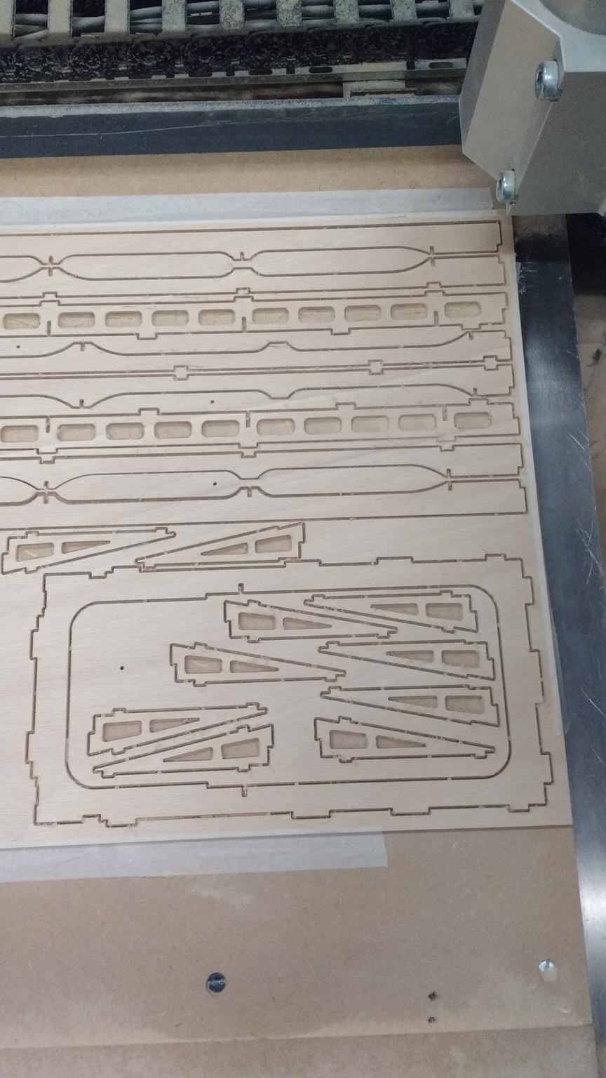

I've just started to look into the g code in the programs (because I wanted to send the machine back to Z25 X0 Y0 (G0 Z25X0Y0) after the program had stopped cutting) so bear with me if I'm being a little thick. It's been 15 years since I've done any computer programming of any sort so am more than a bit rusty!!
I'm trying to drill a few holes in my work piece (3mm lite ply) so I can put some hold down screws in to stop it from lifting (yes I know get some spiral down cutters) but I'm not sure what command to use. Basically I want to spiral drill the holes with the 2mm single flute bit I'm using and then send the spindle back to X0Y0 and wait until I've finished screwing in the screws, then when I've finished I want to be able to click the start button again and it carry on the program. I'm using CamBam but not sure if it has an option to do this?
Can anyone help?
Cheers :eagerness:

Thanks guys, hopefully the below picture will show what I'm trying to do. There are lots of nested parts and I want to put in supporting screws to help keep the ply stable and not moving all over the place so the pieces get ruined, yes vac hold down would be nice but that's not going to happen...yet! Neither do I want to be cleaning double sided tape from the parts.
Dean, #2 is what I want to do. I currently drill the holes (3mm from memory) using a spiral mill operation (I think!) and then want to send the spindle out the way back to X0Y0 whilst I get my cordless drill and screw in the screws. Then I want to be able to set the machine back on its merry way cutting the next operation etc. etc. till it's finished.
Charlie, the M00 option I presume would just pause the program with the tool still over the last drilled hole?
Lee, the feed hold runs on a bit after pressing (tried it a few times...) so not really suitable and I'm not sure I want a timed delay as I know it will either be too short or far too long....

Daft question but why aren't you edge clamping the work and running a job to put in all the hold-down screw holes in one go first, then cutting your profiles?

I do edge clamp it (see above pic, I use masking tape...:hopelessness:) and do the drilling operation first...I want to know (being a complete noob) how to stop the code so I can put the screws in.
I saw the tape and suggested clamping the edges because you were taping, not clamping the work.
Masking tape is specifically designed to be removable and doesn't offer much hold down capability in the face of a persistent force such as the lift from spiral flute milling or routing.
Swapping to a good commercial grade of gaffer tape and ensuring the tape runs down the vertical side of the work and contacts the spoil board at the edge of the work will give you a big improvement in hold,

Hi Nick, plans are to make some ali clamp blocks a bit like inverted T nuts that will clamp the edges which will also mean that I can then machine multiple balsa strips in one go....however as with everything I'm running before I can walk.... I know, I'm heading for a fall! Will be catching up on everything over the Christmas period....[emoji15]

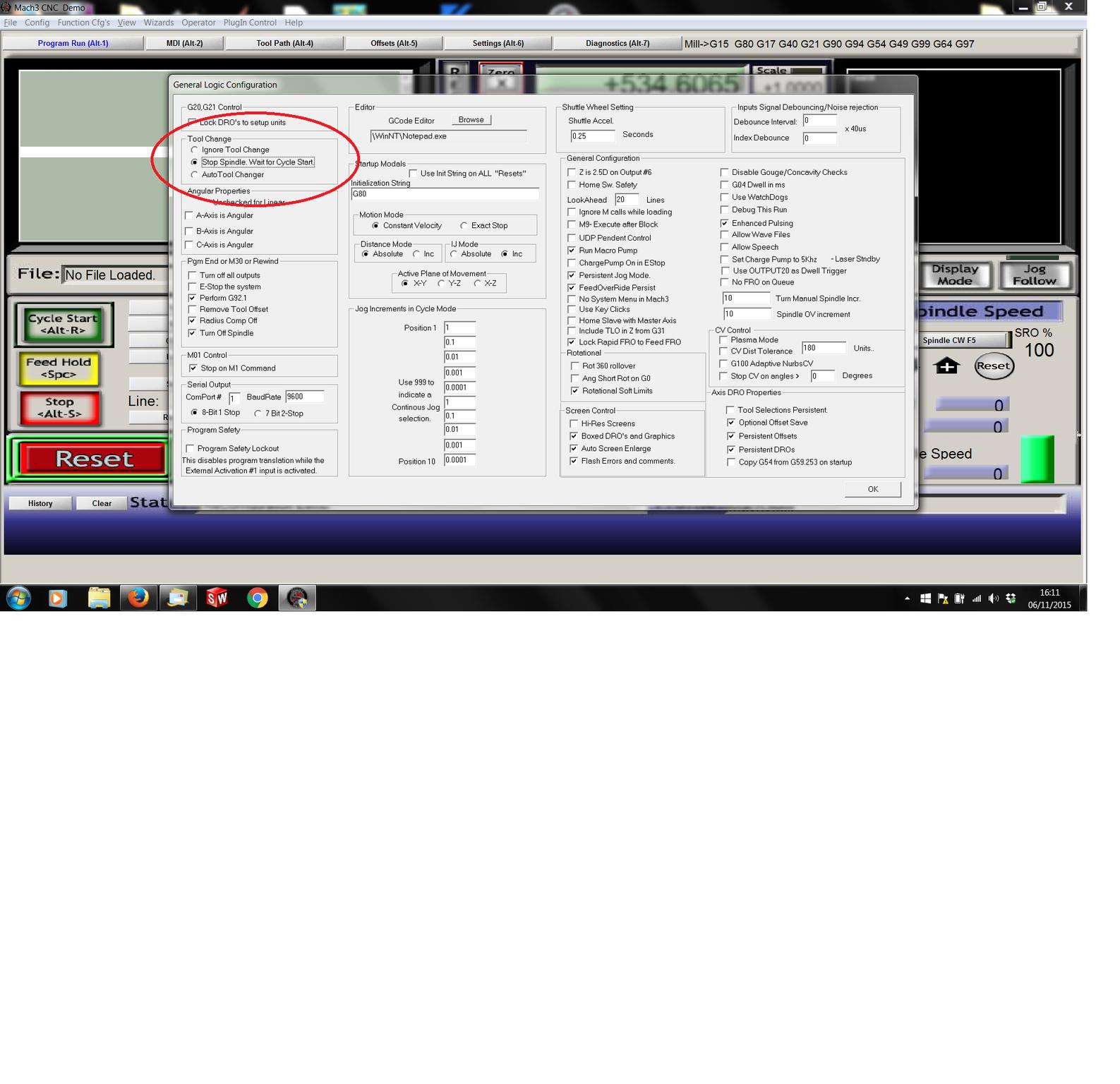

What code do you put in to do that? I put in M6 and it didn't flinch, just ran straight past it?!
Well then your problem is that you haven't turned on tool changes in General Config. See pic.
Attachment 16471
If the file your using is made up of two or more operations, whether that be 2 milling op's or Drill and then mill etc and each operation uses a different tool number then M6 will stop at the new tool and wait for cycle start.
If like in your case your using same tool for both Op's then still give a separate T number to the second tool and it will do what you want and you won't have to mess around inserting M codes etc. (You have to do this to trick your Cam Post processor into inserting M6 other wise it will see same tool number for both tools and leave M6 out because it thinks you don't need to change tools)
Attachment 16471
I've had a look into it and as you say you need to specify the different tools first i.e. T1=1, T2=2 and then It'll wait...if you just put M6 in there like an idiot that I am then of course it won't do anything as it doesn't see a different tool...... :stupid:
No if you insert it your self manually then it should still stop because Mach's STANDARD M6 macro doesn't Know or care about the tool number it just stops and waits for cycle start. Then enters the next tool number has the current tool in Mach's Tool DRO.
It doesn't do any checks to see if the current tool is same has the next tool so if you insert M6 before the next tool then even if that tool has the same number it will stop and wait. Then it enters this same number again, obviously on screen it looks like nothing changed because it's same number but it did still do the change.
It's the Cam post processor that leaves the M6 out if tools have the same number. So if it's missing M6 then it's because the tool change is turned off in General Config.

Dean, as usual you were spot on....went into General Config and changed it to tool change and works a treat...thank you!
