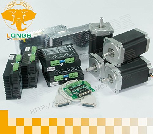

1] 4 pcs Nema 34 stepper motor 1600 oz.in bipolar with single shaft 4 pcs Stepper motor driver DM860A, peak 7.8A, 24-80VDC 4 pcs Power supply 350W 60V 1 pc Breakout board & 1 pc parallel cable. [ will buy from amazon]Attachment 16550

Electrics, don't buy a "kit" of parts from one seller as they're always compromised in at least one area. If you're going to use Nema 34 motors (Z axis won't need it unless you're planning a monster?!!) then they need at least 100V to make them perform, best to use a 230V driver to get the best performance. If you're determined to use lower power drivers then use ones that can take 80V and build your own power supply to get the best performance.

As I said before am really new to all of it and I was under the impression that all motors will be the same to have easier setup. But if that is not the case I would be glad to go with something smaller for the Z axis. When its comes to the drivers and power supply I rather buy these with the advice I get from you all. It will be a bit more money but will be faster to have the build started up early next year.

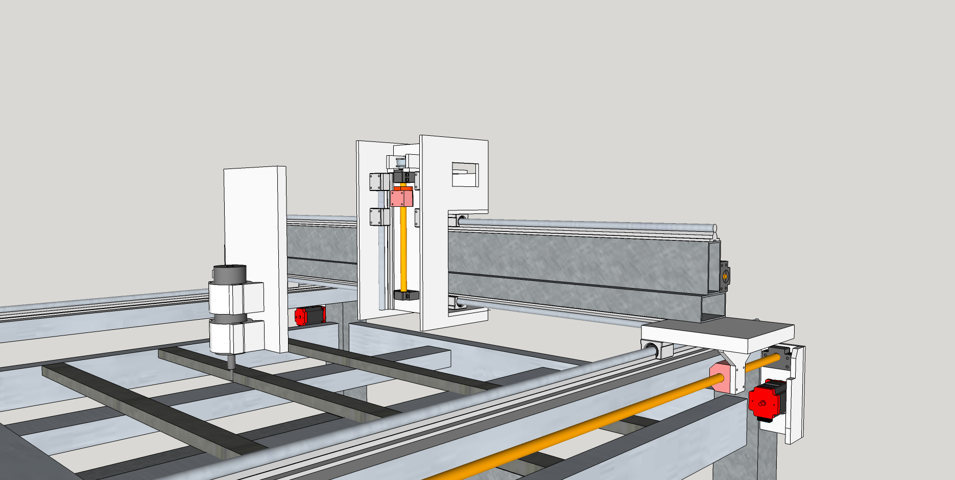

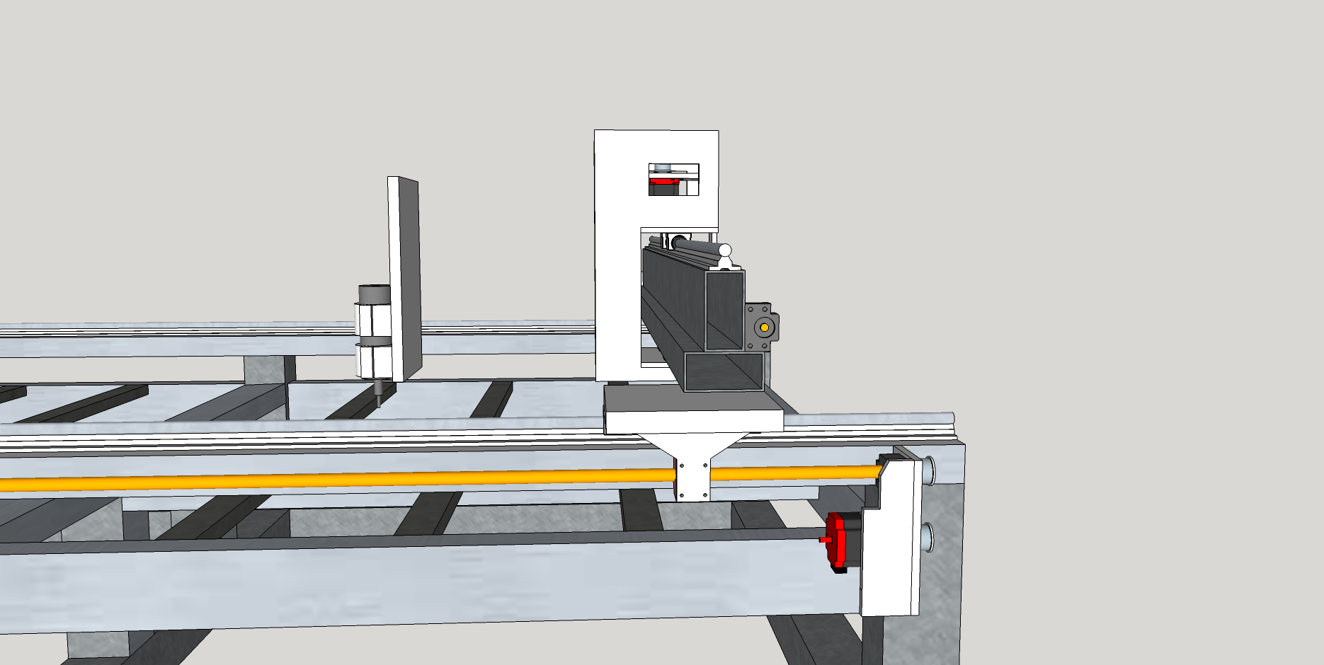

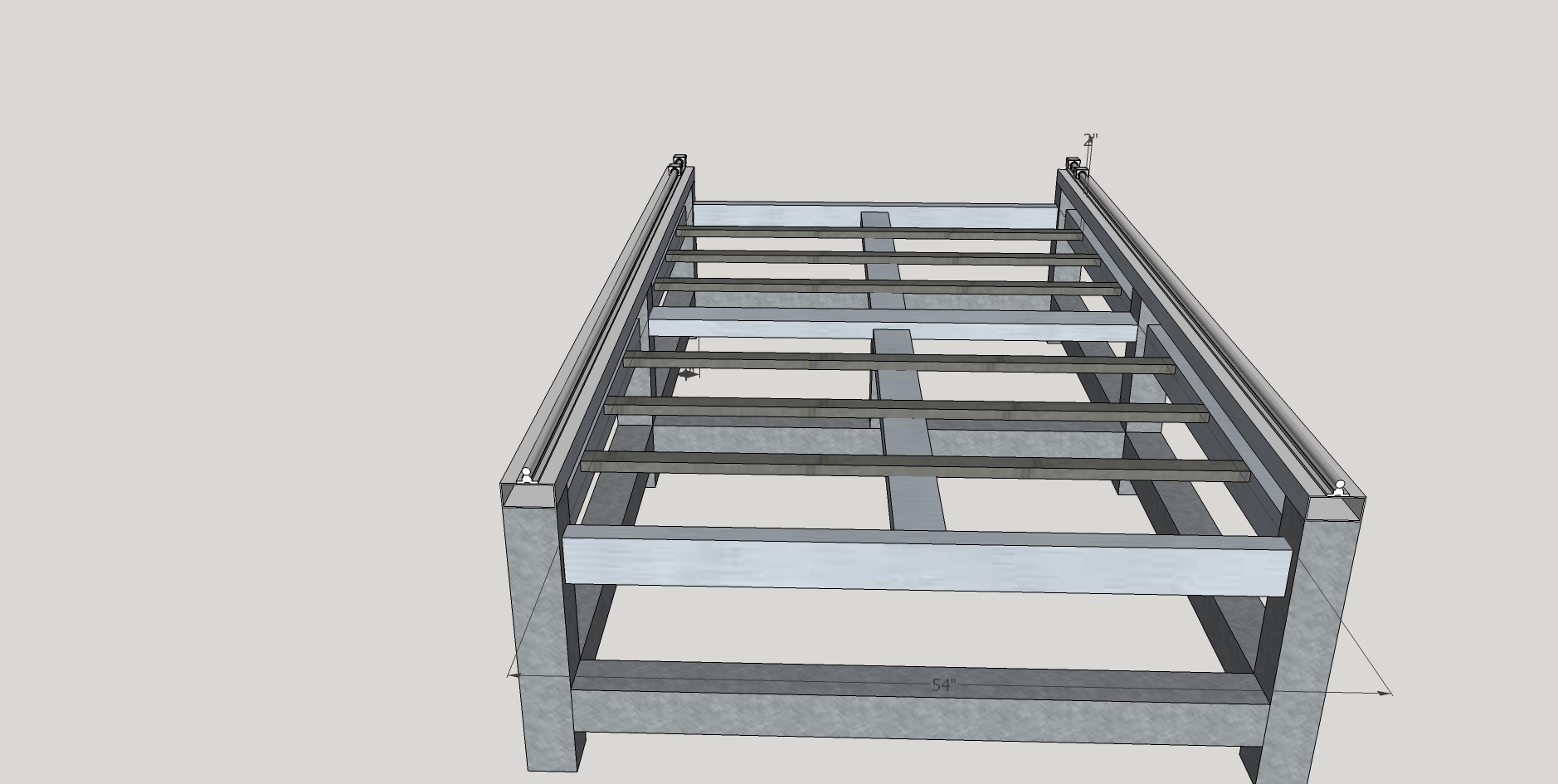

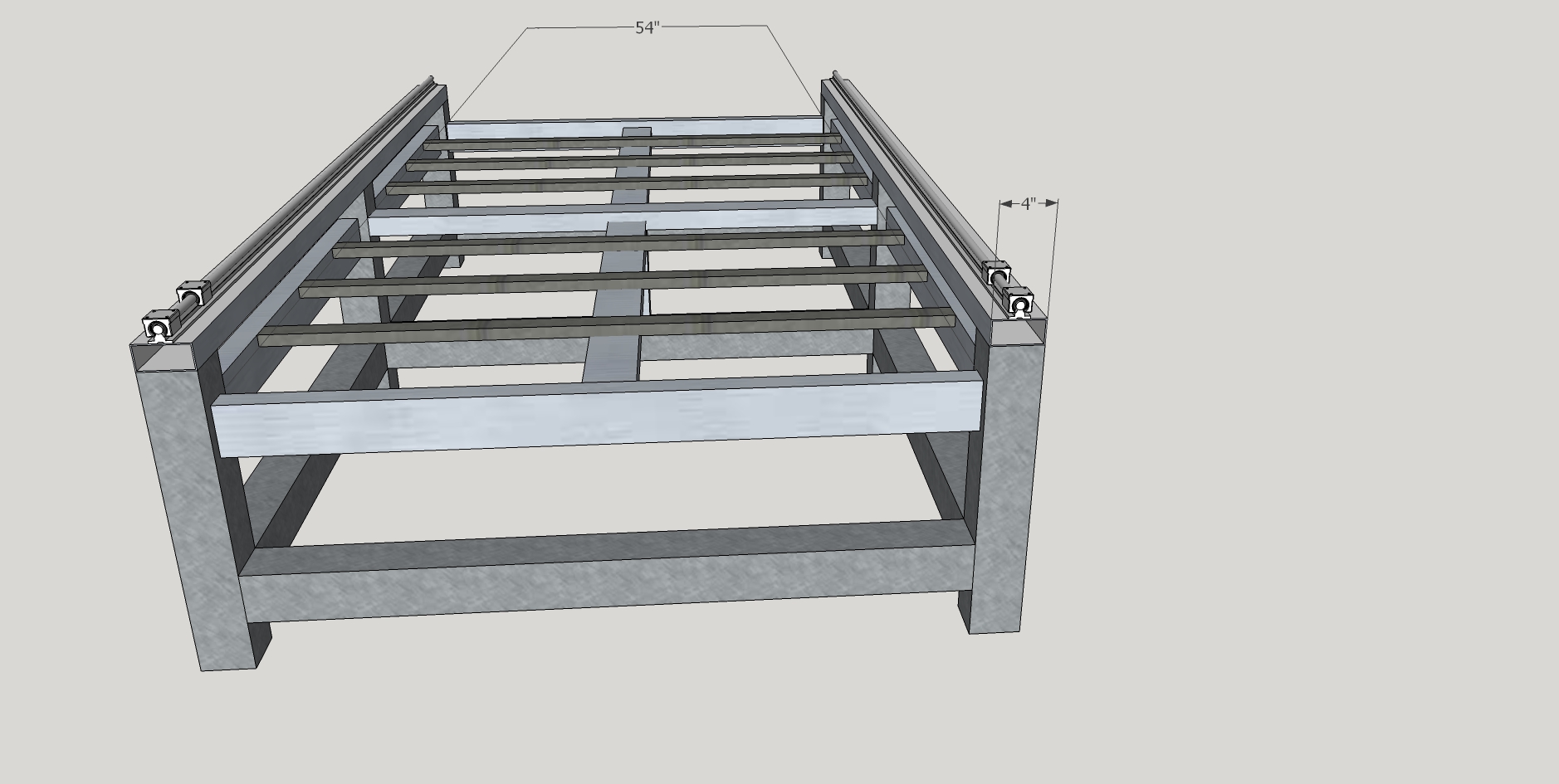

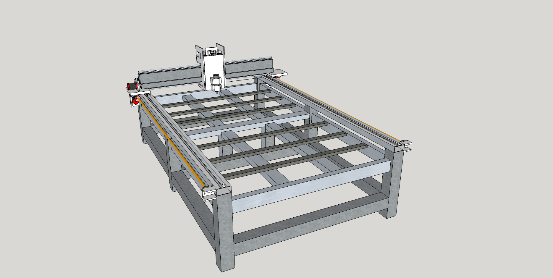

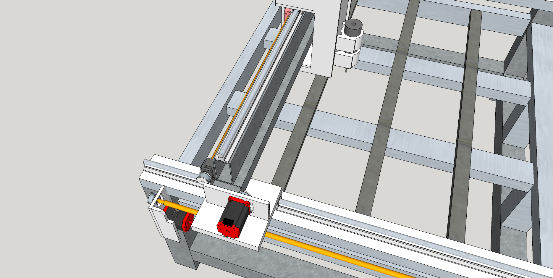

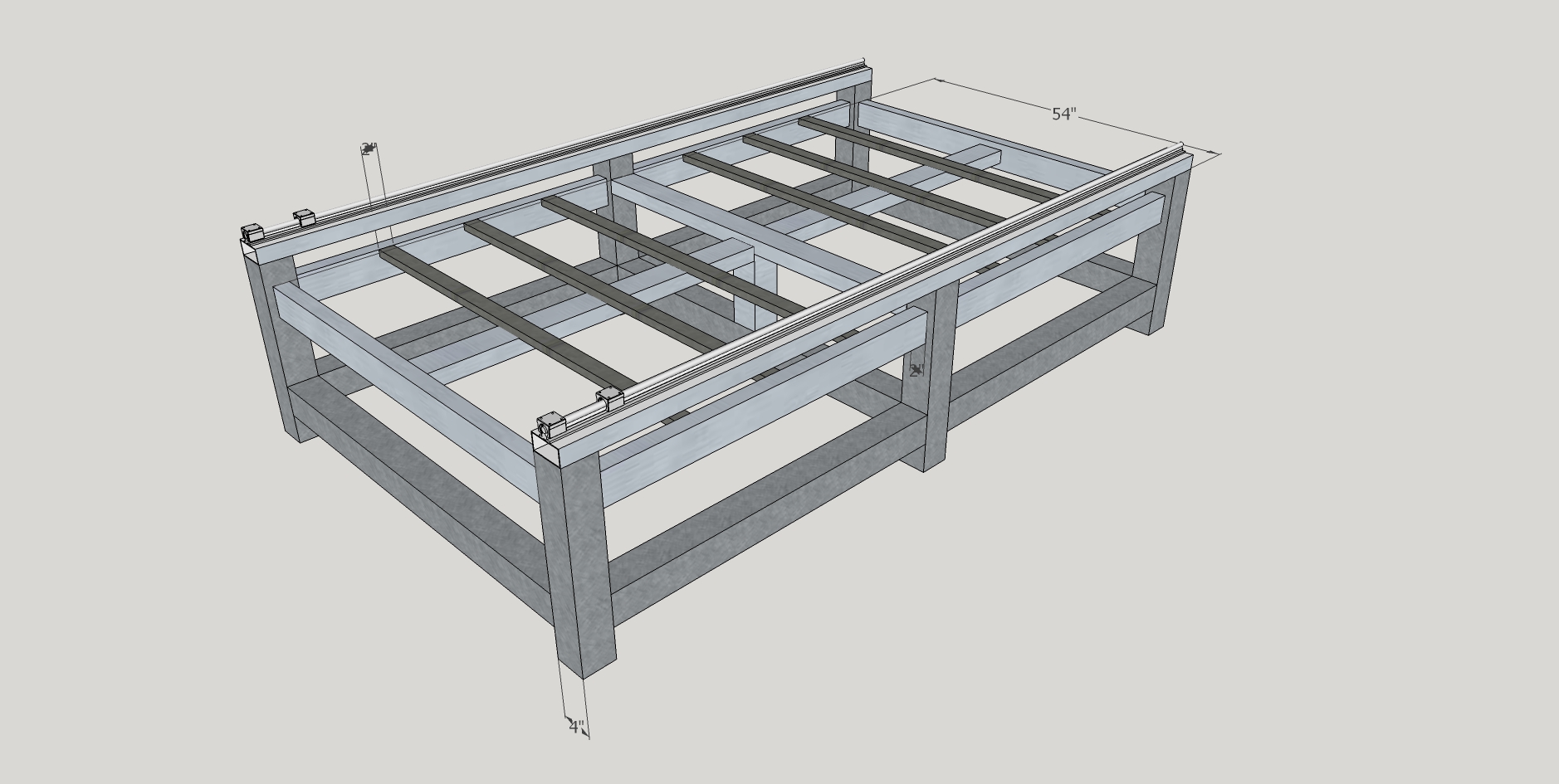

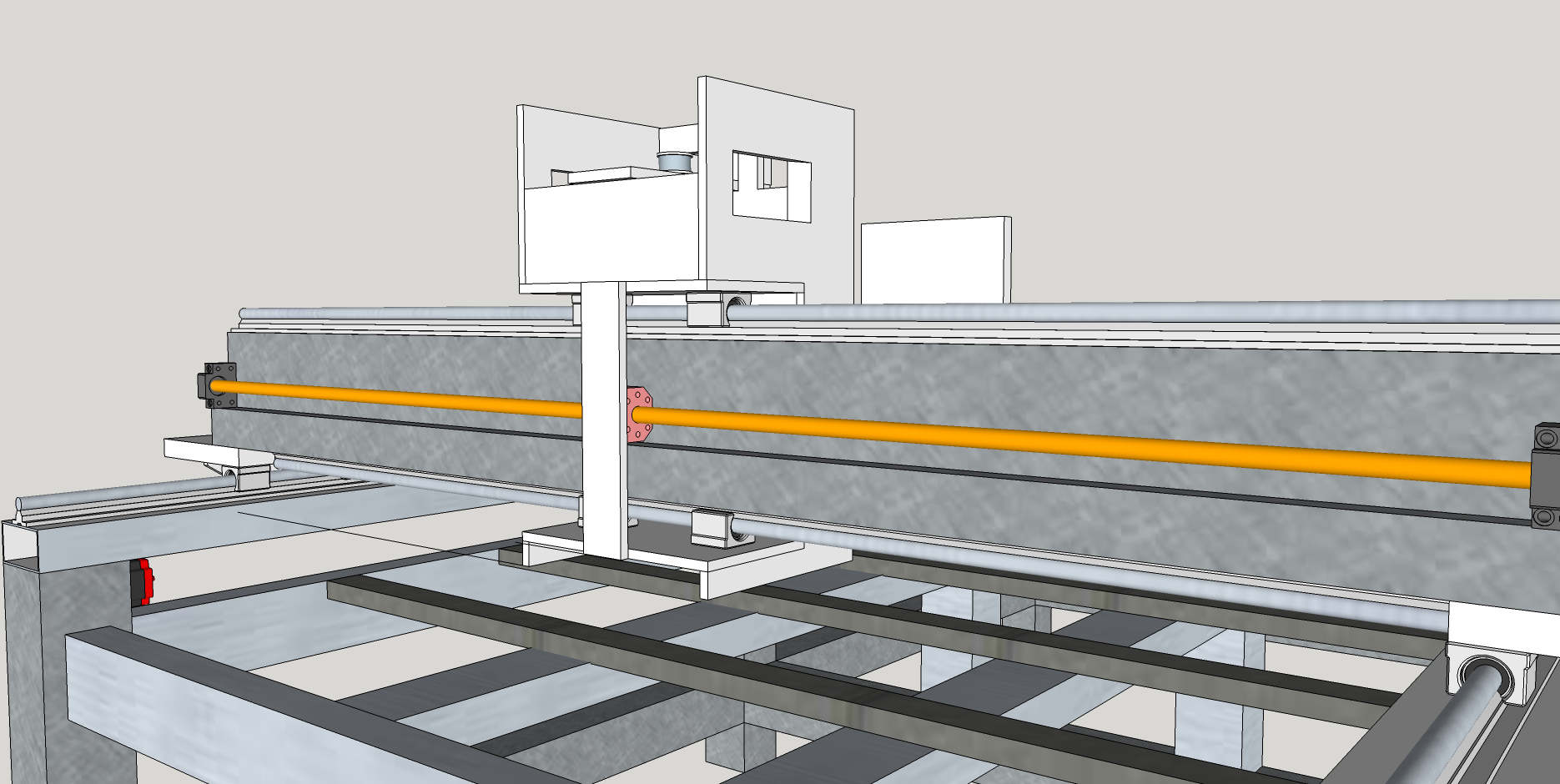

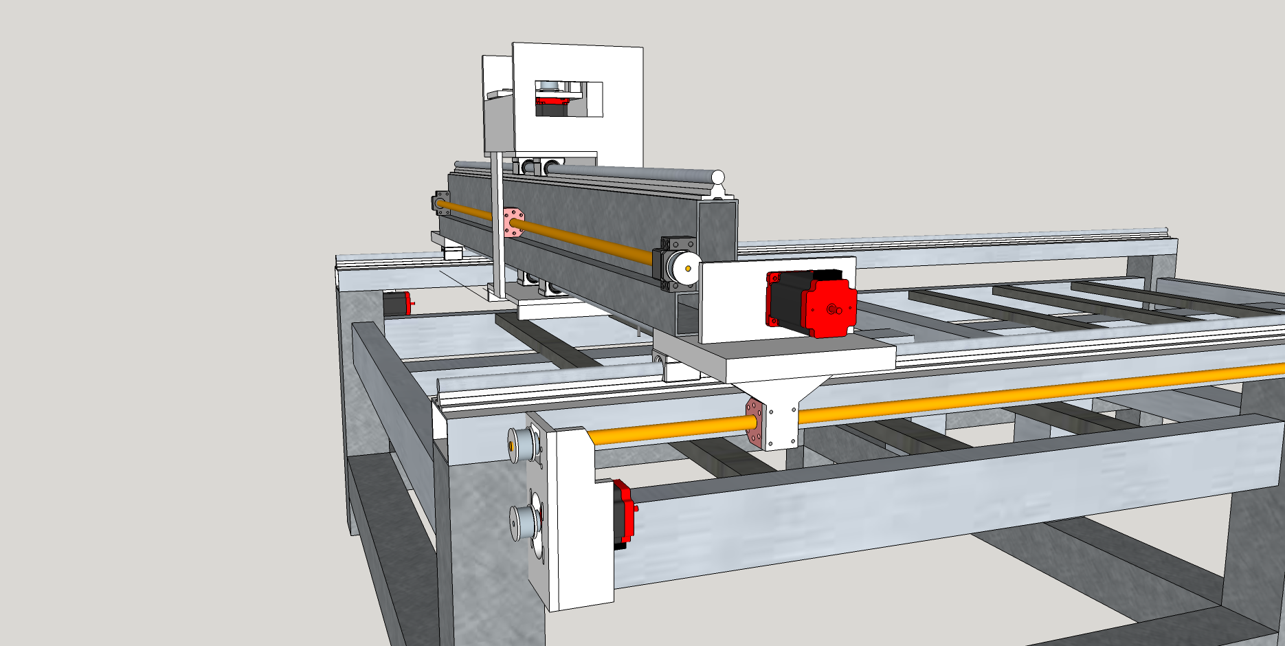

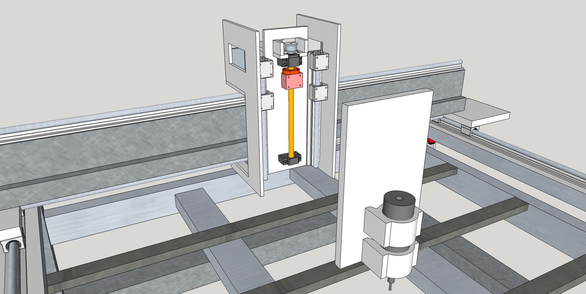

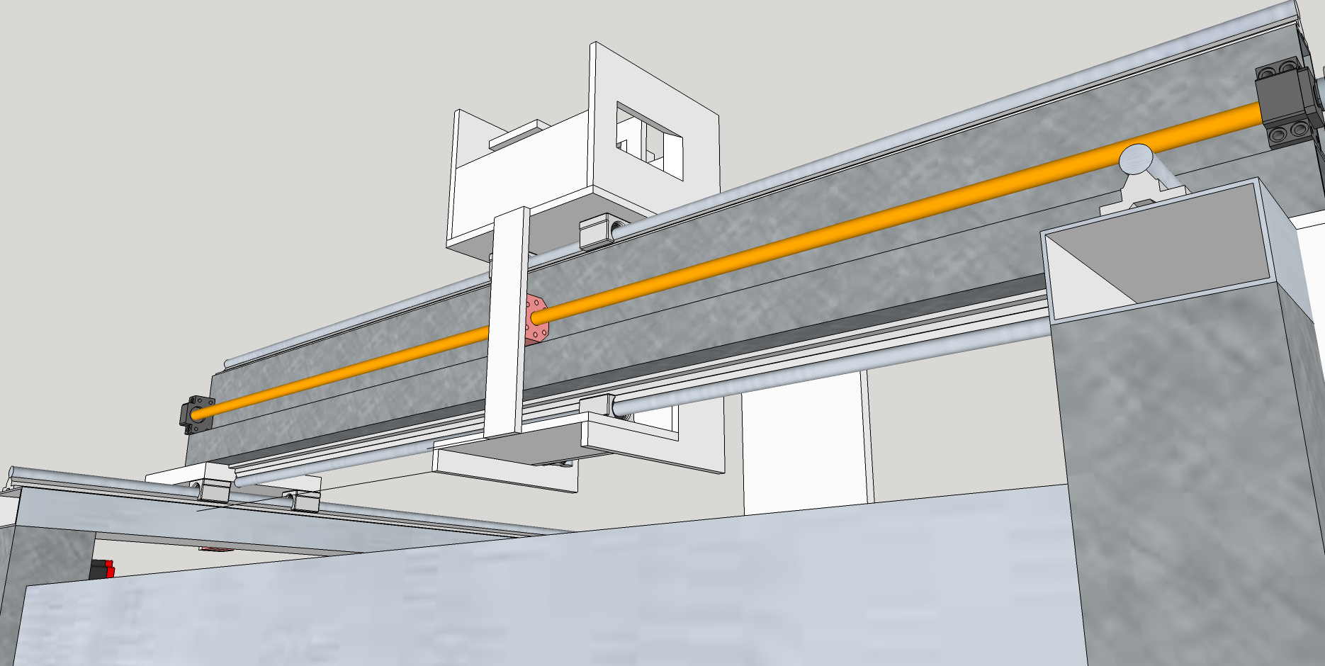

8 Attachment(s)
Re: New member from Trinidad
good day all
Its been a while since i haven't posted anything. After reading a lot more threads i realized i was getting ahead of myself. I have worked on the design a little bit see pics. Also i have decided to put a 4th axis. But this is something i will need help in applying it to my current design. I don't know how to upload my sketch-up to the site. Have a look and tell me what you all think.
Attachment 17698Attachment 17699Attachment 17700Attachment 17701Attachment 17702Attachment 17703Attachment 17704Attachment 17705
If @ all possible ie budget wise i would change your linear rail system to Hiwin or similar profile. X axis top rail put another two pieces (each side) between frame to brace. Z axis it is best practice to use the rails on the front plate to provide additional support.
regards
Mike
